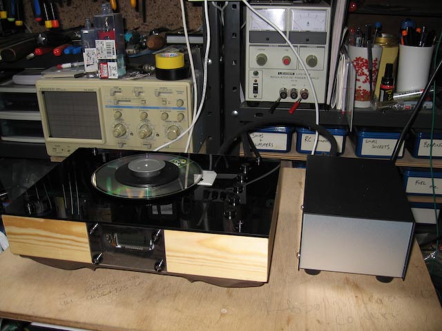

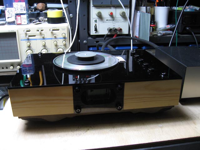

I finally got to a finished (nearly) working model, amongst other things I learnt a lot about acrylic and static electricity! (I need an extraction system for my router!).
It might look slightly familar! My apologies for poorly and shamelessly plagiarising Peter Daniels design. Learn't a lot from my mistakes with this one... hope to avoid them with the next.
The lack of a back light on the Sanyo display is a slight problem... might try an LED 'front light' instead...
Peter mentioned working a 'hand brushed' finish onto black acrylic, any ideas on a good technique for that (Peter or anyone).... I would be (will be perhaps) tempted to try brushing in one direction over 800 grit wet and dry (dry).

Very nice! I think it looks great as is, but you could probably get the acrylic top bead blasted.. I'd not want to try sanding as you propose on a finished piece for fear of ending up with something ugly. Perhaps you could refine your technique on some scraps first which would also help you decide if the resulting look was to your liking..
Your unit looks great as it is. As for brushing, I use Scotch Brite pads which work fine here. You may also use a wooden board as a guide so all the lines are perfectly straight.
I used similar technique when finishing that panel: http://www.diyaudio.com/forums/soli...-mark-levinson-38-preamp-chassis-scratch.html

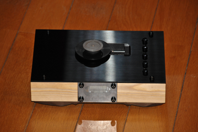

Thanks for the scotch brite tip for achieving a brushed finish on acrylic... worked well.
I also did a quick hit with polymer wax and have a very serviceable finish on the black acrylic! Doesn't show finger marks too much. Still a static disaster zone though!

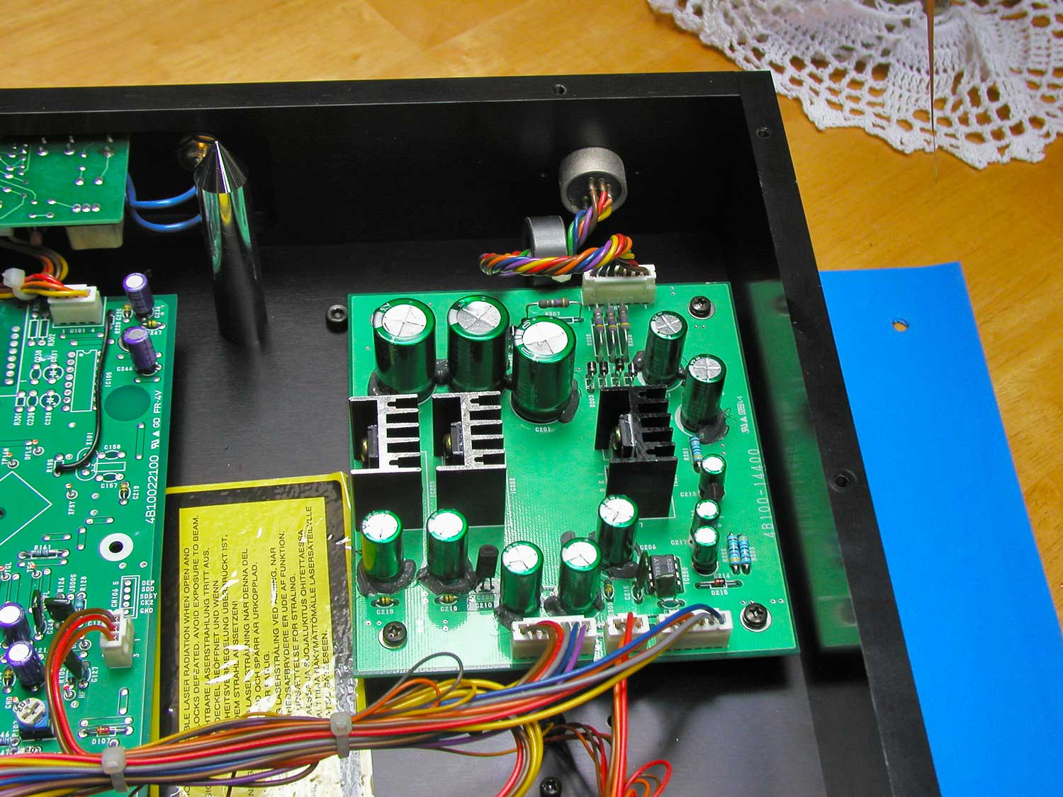

Few months ago I finally decided to "upgrade" caps in my CEC TL0 transport. Based on experience I gathered with Shigaclone I used BG FK2200/35 before and BG STD 1000/25 after regulators.
I left it like that for couple weeks, but in the end couldn't get used to the sound; for some reason the original caps in TL0 sounded much more natural and overall better, so I went to reinstall them back again and I'm completely happy with the sound ;) . Those are the green Nichicon MUSE.
The flash is a bit cruel in this picture....
Bill
You might want to try one of those anti-static sprays used to treat office environments. Just protect the mechanism from over spray. Worth a shot I guess, not sure how well it will work on acrylic.
