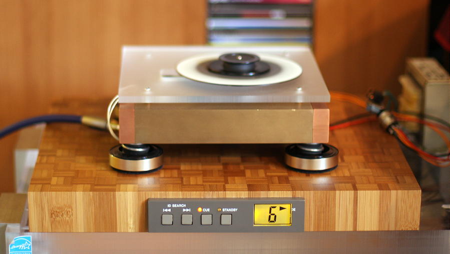

I would love a custom-colored puck, but... considering most people spent less than 150 euro on their entire Shigaclone I think the price really is too much. It is too much for me anyway...
If it was around 50 euro I would probably go for it - not so much because of the sonic difference (which is said to be minor) as for the cool looks 😎. 150 though... I'd rather simply spray-paint my plastic puck and forget about it...
How do you guys get your plastic pucks balanced by the way? Mine has a circular magnet at the centre that's kind of loose fitting - I want to glue it in place, but don't know how to balance it properly... Any suggestions?
You don't need to glue the magnet, just centre it properly and tighten the screw. That should fix balance problems to certain degree. Some pucs seem to be slightly better than the other.
Please listen without magnet.
Make something without that it wobbles and it must be stable , and remove as first the magnet.
We have multiple people are listening and they found it all sound better without magnet.

The main requirement is matching of the motor shaft to the disc table. That can be done on spot, with motor supplied to the fabricator.
However, how this turns out in real life, when disk is spinning, can be only assessed in a working transport. This is a tricky part and I don't think it can be done without trial by error 😉
150 Euros for two turned parts based on a sketch with no mechanical tolerances ?
This is the machine: YouTube - CNC machining of a small demo vise made of brass
Nice machine, but tolerances should still be specified. If you don't he may not ream the shaft hole but simply drill it. This may or may not yield acceptable results. Tiny tools tend to flex. A drill could wander so you want to use a boring bar. With a boring bar you need would likely need to use a pin set to sneak up on the diameter. Using a reamer would ensure that the diameter is spot on.

There is no mechanical component in this world that does not have a dimensional and/or geometrical tolerance, whether it is manufactured by a 1 million Euro CNC machine in Germany, or by a manually operated machine in India. As long as there is no tolerance on the drawing, then it is free tolerance, which is commonly in Europe +/-0.25mm.
C'mon EUVL, the guys are trying to come up with something new and well made, give them a brake. Obviously they are going to keep trying until their pucks come out spot on.
@BMW850 - I would be interested if such puck can be made of wood instead of aluminum? I would simply LOVE a rosewood puck on my CD 😀
@Peter - Tightening the top screw didn't work for me - the magnet had no contact with the top part at all... And also, I somehow managed to misplace the screw when I was doing adjustments
, so I decided to ditch the top part altogether and glue the magnet after all. I balanced it by spinning it slowly on the CD mechanism and making adjustments until I could not see any movement.
I can't comment on the difference in the sound as I wasn't doing any tests, but the mechanism itself is certainly a lot quieter now. I think the puck looks a lot sleeker too, without that el-cheapo plastic top 😉

In the first few pages of this thread, there were a few questions, and answers about mounting the laser mechanism to the "box".
Could we have some more elaboration.
I've heard about springs, but all but a few of the pictures seem to have been deleted from the forum's web site?
In short, if I have it right: a heavy "box" and suspended via springs from the top of the box is the laser mechanism. This box is then resting on a "plinth" via stiff springs?
This is the best I can figure from Peter Daniels posts.
The original drawing was posted here, with some additional pics: robimy shigaraki transport / CD Flatfish - Audiostereo.pl - strona 52
The tolerance, although not specified, was 0.1mm or better 😉
That looked as in attached pic. I later moved to a more simplified design, which brought similar results: http://www.diyaudio.com/forums/audio-sector/160373-cd-transport.html
