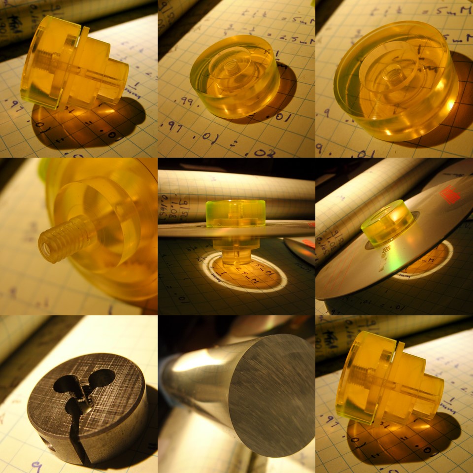

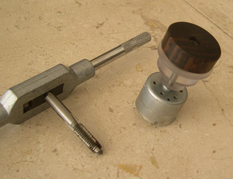

Hi Fran,
As you can see on the photo I am using te Delrin Puck.
I tried everything to get your ebony puck as practical as possible (playing loads of cd's a day) but in the end the Delrin Puck was much smoother on the Delrin Platform. With humidity conditions the puck was reacting a lot.
Sometimes after leaving it a day on it got way too tight.
I obviously made the thread as wide as posible and in the end leaving only a few thread turn in the wood.
In the end I experimented too much with you puck....if you catch my drift
A real pity since I do find the sound of your ebony puck more "natural"
How is your experience. And the inevital question did you try to make an ebony platform...😀

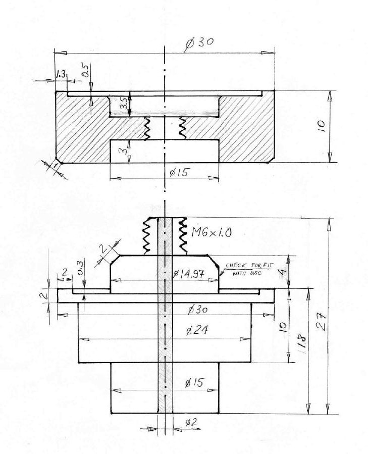

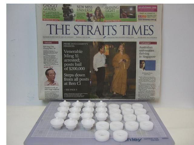

CD Platform with puck.
I have a professional company found that will make a CD Platform with puck.
The first thing he told me that the product Delrin mechanical works, the 14,97mm where the CD around falls he can make it exactly, but later it mechanical works with Delrin.
I got the advice from him, to make the CD platform with puck from aluminum.
Tomorrow morning I have a conversation with the owner of the company.
Would Aluminum be a good choice?
How do you all think about it?

The nice thing about Delrin is that it is dimensionally stable and way stronger than needed for this application. The advantage over aluminum is that when you go to press it on, it will deform as needed and slide on. I would be concerned about getting the press fit right with aluminum. It won't be forgiving at all. This means they will need to drill, bore and then ream the aluminum to be 100% sure it is centered and to size. If they don't you have concerns about damaging the motor putting it on, or it will be loose and need locktite to hold it in place. In which case it won't be 100% on center.
In the end if this is a good place and are able to hold tight tolerances on that bore, you should be fine either way.
It is an absolute requirement that CD platform is machined with platform mounted on a shaft, otherwise you will get wobbling problems. For that reason, it's advisable to machine the parts from relatively soft material, like Delrin or acrylic.
The whole batch of Delrin platforms that is shown in your attachment was screwed up and not possible to use only because the shaft holes were drilled last.
I understood that 47 labs mount the platform on the shiga spindle and then have a little attachment that takes a final shave off the mount and puck so that its centered accurately.
Fran
Fran
I believe that issue can be eliminated if the critical diameters are cut in the same setup as the bore. It will take a bit more material to do it that way, but you should be able to do it.
1) setup stock in a collet
2) drill, bore then ream the shaft hole
3) turn bottom side features
4) turn the top side mating face and center hub ( where disk locates)
5) turn the part around in the collet
6) finish top side features ( thread etc.)
Yeah I have one of those.. 🙁 It was also so slippery that I had trouble tightening and loosening the puck..It wobbled badly. The wood one with brass threaded insert I have now works pretty well, a bit hard to get on and off in winter, but otherwise fine.

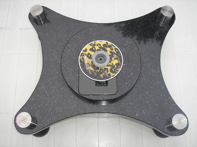

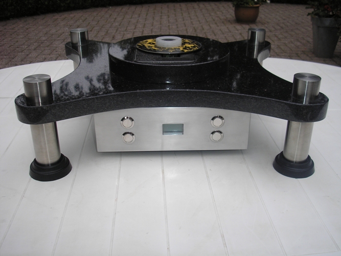

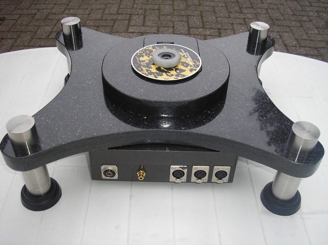

Thank you all for the answers and help, I tell the company about the things you all write here.
The last 2 pictures for the screw puck is the right one I think, you all see here also the pictures how I make the Shigaclone: http://www.htforum.nl/yabbse/index.php?topic=86768.450
Rudy
