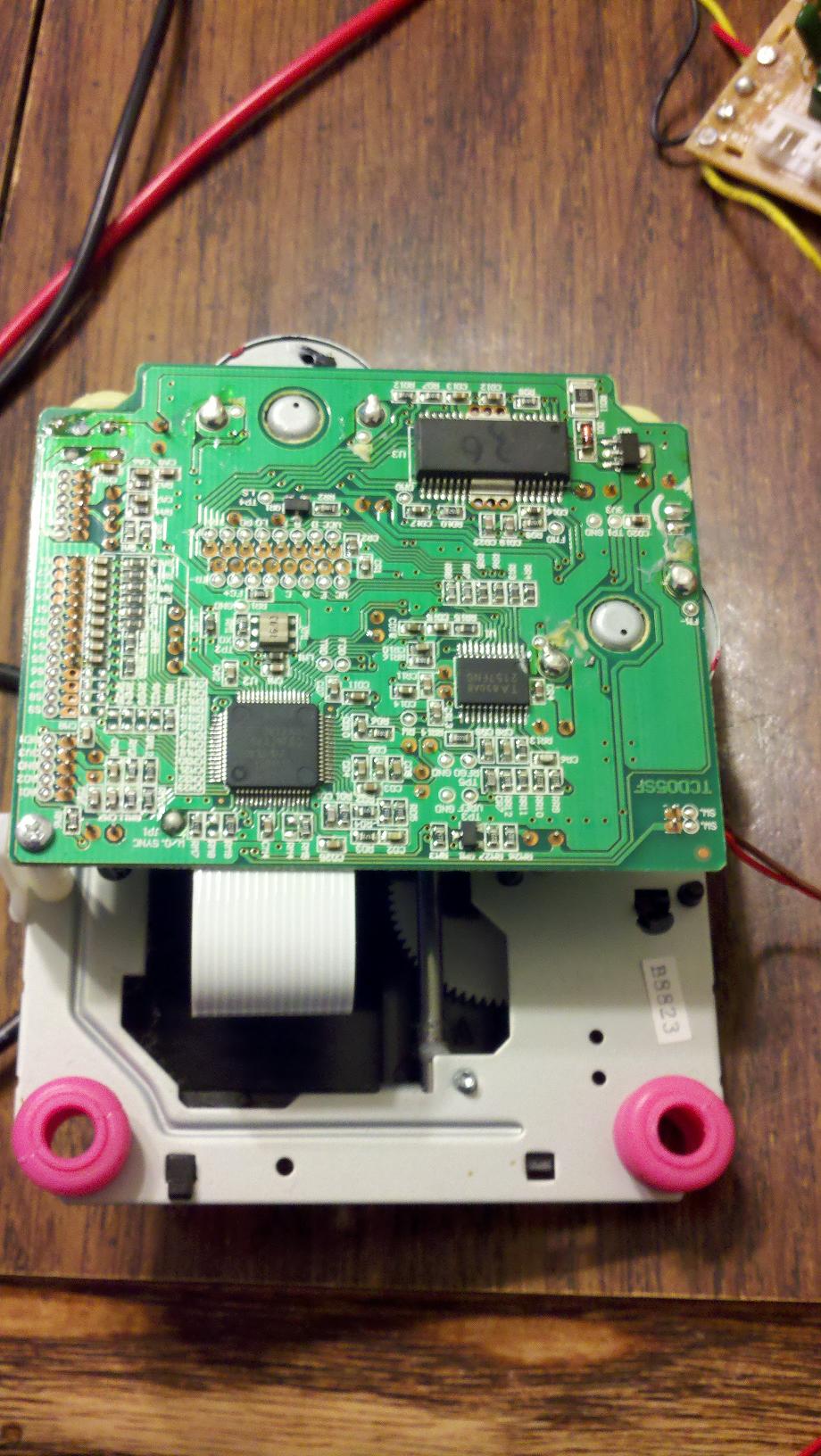

Can you post any pictures of the transport and the board underneath it?
Bill
It would need to use the Sanyo mechanism and the same family of chips. A clue - if it supports mp3 playback it's not the right chipset.

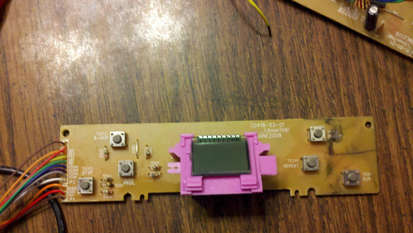

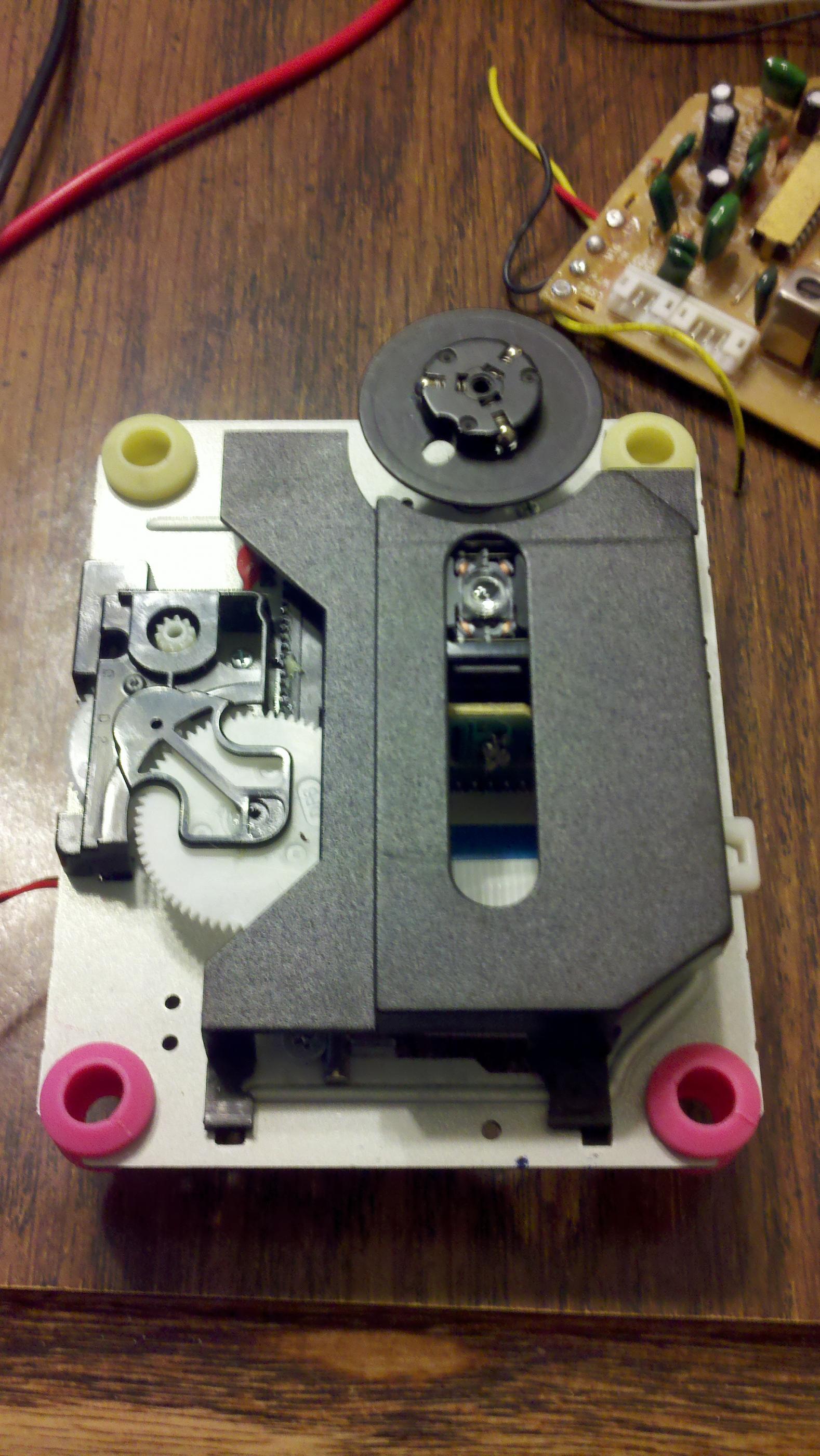

Will this work?
This cd unit is from a cheap boombox player my daughter had. The tray mechanism broke, and we replaced her's, but I thought I could have a bit of fun with this one. I have it running on the parts alone, and the transport is getting 9V so I assume the Shig PS should work fine. The link below is to the pdf of the chip specs (TC94A29FAG). I am not an engineer, so I can't really tell if I can get a digital output from it. It has a 1 bit DAC in the chip, but that isn't nearly good enough. I already have a chassis in the works, but if this doesnt work I can always use it for something else.
Pictures:
Chip PDF http://www.datasheetcatalog.org/datasheet/toshiba/4225.pdf
Thanks, James
Pictures:
Thanks, James
Toshiba chip come with both I2S and SPDIF but unfortunately these pins are shared with LCD display. You need to find a way to activate it.
