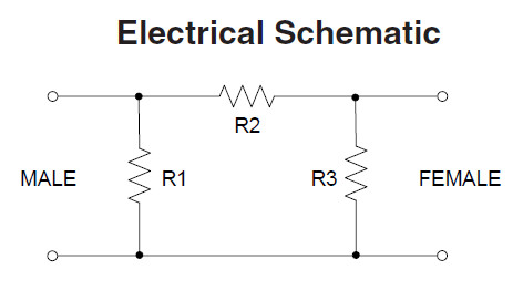

OK, first up, don't shoot me ok? I'm not looking to derail this thread, or spark a believers vs non-believers argument that goes on for pages. I believe that has happened already on this (or the line level forum).
I have had cause recently to use some SPDIF attenuators between my shiga (fully modded, incl Peters reclock from some pages back) and my DAC. I still have the 300/92R on the TTL output to knock it down to consumer levels, but these attenuators are on top of that. What I have heard is a cleaning up of the sound similar to the reclock, but maybe not as large a difference. But for a few quid each, its well worth it I think.
Anyway, I post it here just because I've tried it in my system and like the effects. I would really like if a few more people tried it just to see. Much easier to try this than most of the other mods people have done here and the effect seem to be well worth it.
The attenuators are here:
http://minicircuits.com/pdfs/HAT-6-75.pdf
I use a 6dB one at either end of the SPDIF cable, but experiments of which level to use are to follow. Also removing the 300/92R completely and using these to knock down the TTL signal.

A group of us (about 7) at Fran's heard the effect of using an attenuator on the Shigaclone (& Squeezebox) - it was not a subtle improvement - everybody there said "jeez, am I hearing right"?
FWIW, using these devices to drop from TTL is a far more precise way to do it than the 300/92 set.
Aren't those just resistors in a special package?
Exactly! As a purist point of view, why should one add a resistor to ground in the signal path and also an additional connector?Aren't those just resistors in a special package?
If I can answer on Fran's behalf as I introduced them to him? Yes, Peter, they are BUT I guess they are precision resistors in a precision BNC case - 75ohm.
They certainly improve the sound of the Shigaclone even though there already is a T-Pad in there!
For Leopalour - the reason for using T-pads is to knock down the output voltage to within SPDIF. One side effect of doing this is that any reflections get knocked down by twice this attenuation which helps with a better signal. ( I won't use the word jitter reduction here to avoid controversy).
But again all I can say is that 7 people at Fran's were amazed by the effect these devices had on the sound

I just read jkeny's post and yours Peter.
The truth is, I don't know what's in there. Logic says there must be some resistors, but they could be filled with rocking horse sh!t for all I know. But I can tell you they make quite a difference. And Peter, as you and others who have been along this shiga road will know, the shiga is already a fine, fine sounding unit. This moves it up another notch.
And for not that much more than the price of the rikens (which you can dispense with and use the attenuators to knock the signal down from ttl).

Peter is correct, they are a T-pad according to the datasheet but again it might be the precision of the devices that counts?
