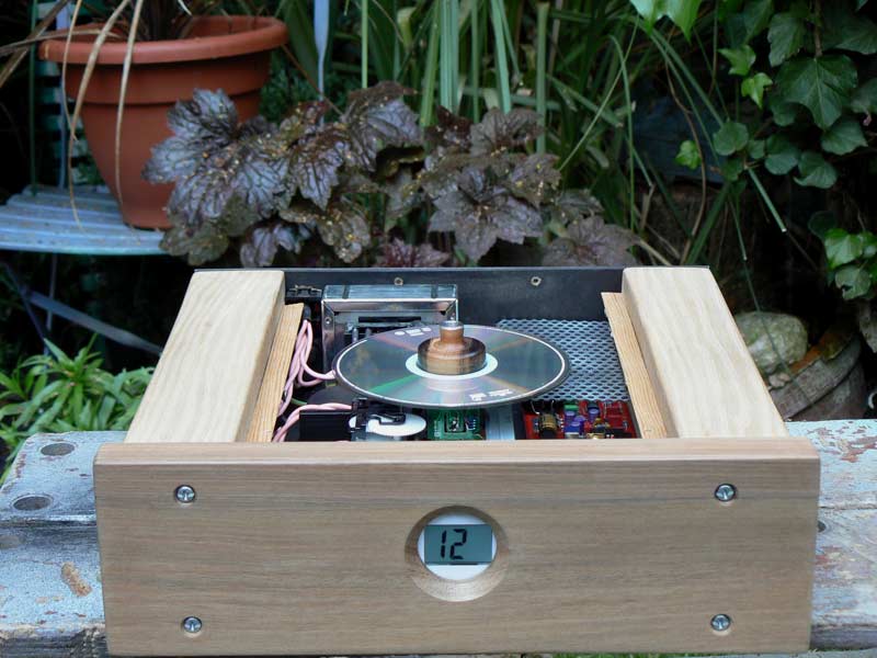

audio1st said:Thanks Erik,
Have got the tricky job of putting a display window in the front panel next....
Here is the top design...
Audio1st,
Nice work!...as usual! :0)
What kind of wood are you using for the frontplate?
Thanks.

Cheers..
Front is walnut, and now has the display cut into it...
