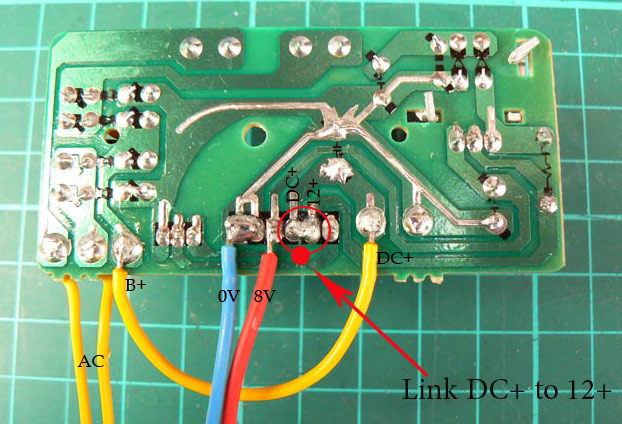

dijke308 said:
I have the same problem: My ps out of the box is dead on 8V and the 12V outupt is about 15V.
15 volts! :O Where did you take your measurements, before or after the diodes?
I also wonder if these could be from a faulty batch or if it is just coincidence? Did you two buy the faulty boomboxes from a shop or from somewhere like eBay, and do you know the date of manufacture or the serial numbers? If I remember correctly the date stamped on the inside of the case of Somak's and mine were between May and September last year and both came from Argos in the UK. I don't know serial numbers. 🙁
dijke308 said:
I have the same problem: My ps out of the box is dead on 8V and the 12V outupt is about 15V. I saw Rikkert had the same problem, but how did he solve it? For now, I think I am going out to buy a spare 51....
I think we have a language problem here. I think Woodturner has built a power supply and has exactly 8.V.
I think you are trying to use the original PS and that needs to be modified to give you 8V.
