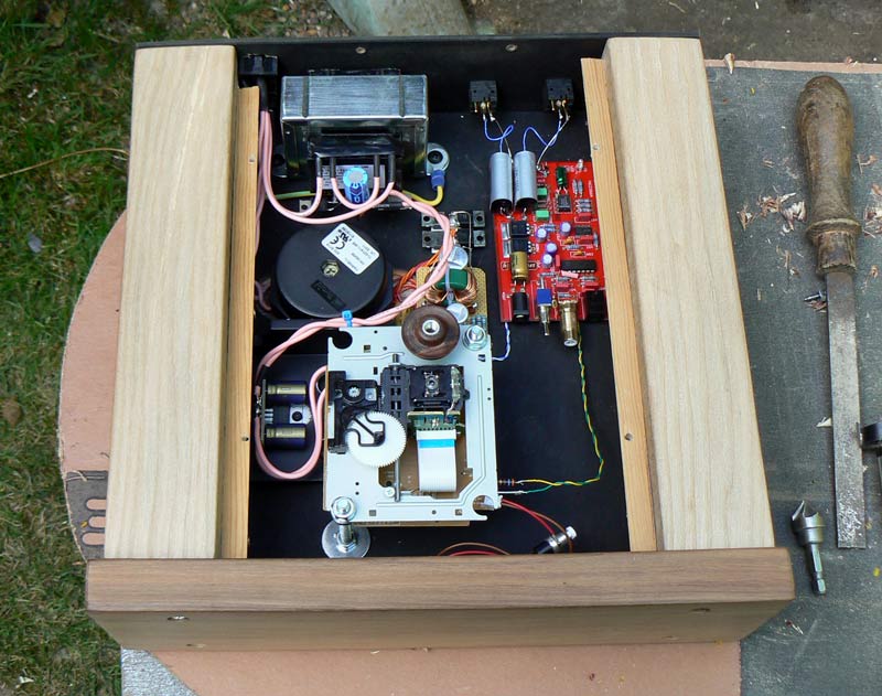

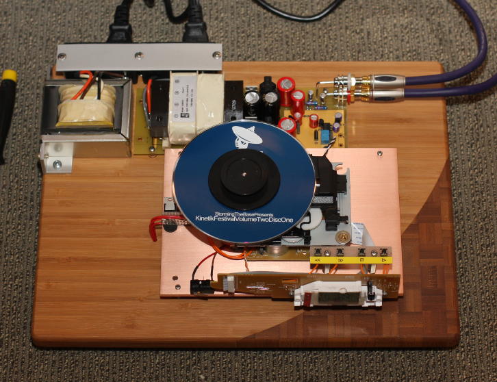

Nice player Peter! Looks sharp. I like your wood cutting board as a base too. Nothing wrong with that in my opinion. I'm going to start using that since my wife likes the plastic cutting boards better anyway.
You said all in one player, meaning it plays SACD as well, or did you mean DAC and transport on one cutting board?
