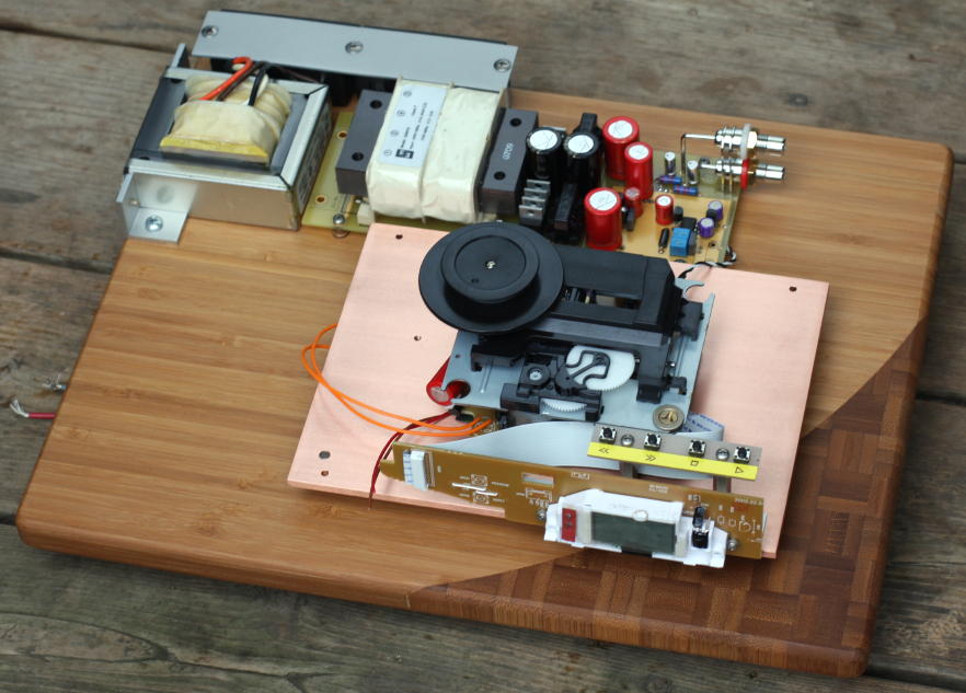

It is my Premium SPDIF DAC with TDA1543 and CS8412:
http://www.diyaudio.com/forums/attachment.php?s=&postid=1170936&stamp=1175179199
http://www.diyaudio.com/forums/attachment.php?s=&postid=1170937&stamp=1175179271
I don't touch the crystal now, but remove the choke.
leoparleur said:...and on the board I suspect you also still replace the crystal E7 and remove choke R4, right?

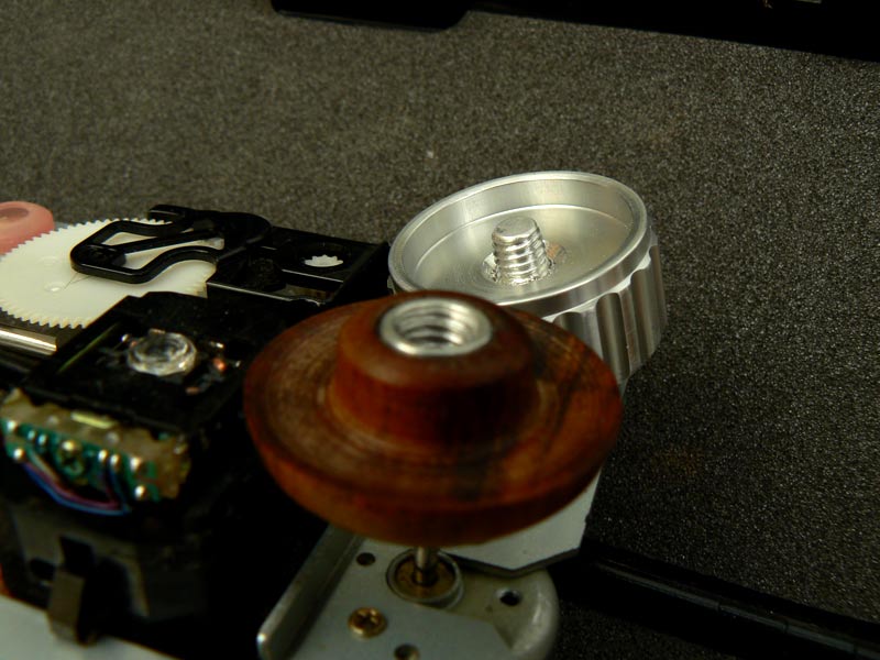

Hi all,,
Have just finished trying to make a CD table and Puck, was not easy. The finishing turning was done by fitting the CD table to the cassette motor and spinning it up with a 12v supply.
The puck is a volume knob..
Hope it gives some inspiration..
PS, Thanks to Tripmaster for the link to the threaded inserts..
