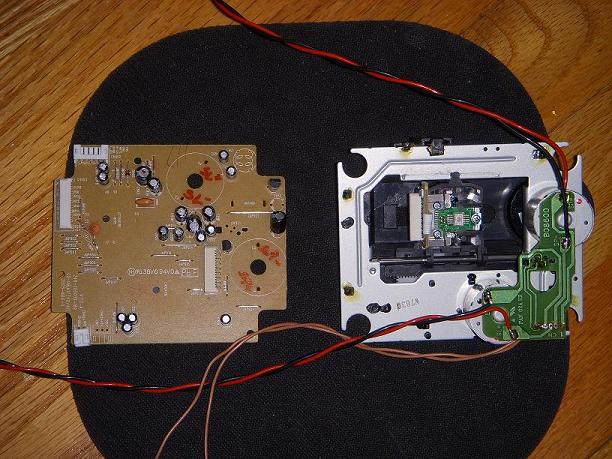

You could also get a laser/mechanics that look like this.
This laser I got out of rcbx33
Kierownik, thanks for your input. In your picture is that the RC-EZ31 PCB or the 33 one? I guess whatever similar cd transport must have this sort of switch.

kierownik said:
Hi Leoparleur
It's ez51 pcb. Laser and motors are also from that unit. Rcbx33 has the right laser but the main board is useless. I just transplanted the small pcb that ties the motors together and locates the limit switch in the right place from 33's to 51's optical pickup. And the rest are just spare parts.

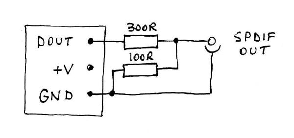

I've looked over the instructions in the pdf, and have no idea what to do with the digital output from the chip. It says that Peter had drilled through the other side to get access to it, then does not say what to do with it.....
just ordering some parts for resistors... not sure about the spdif output,
should i be putting a 291ohm resistor in series and another 100ohm shunt resistor to ground after it?
does this need to be done on both spdif connections i.e. core and sheaf?
and i am ordering from farnell who only have 294R and 100R, i presume this is ok?
and do i need to be buying any particular kind of spacers/ standoffs to mount the whole thing?
cheers stuart
cheers stuart
No need to drill anything. There is a spot for an onboard socket as in attached schematic; this is how the output should be connected.
I use 300/100R combo (Dale) and the values here are not really critical.
As to standoffs, I find 1" tall, 3/8 dia work well for me (2 support points only)
Thank you Peter!
So, the minimum work to get the spdif output is to install the two resistors and an RCA jack!
Cool. I can hear it working before any changes get made.... Then make one at a time and evaluate.
I can't wait to get it.... Wednesday May 6 is the arrival date.
BigE said:So, the minimum work to get the spdif output is to install the two resistors and an RCA jack!
Yes, that's it.
