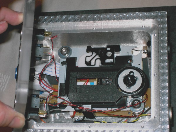

Hi Fran,
Here's a picture of the internals, it's a fairly straightforward build as I pretty much went for a transport based on Peter's first design.
The controller board is mounted fron left to right underneath the mechanism. It was a tighter fit than I had planned but it all goes in. I removed the little push buttons from the board and ran wires up to the buttons on the top plate. The mech is mounted on two rigid supports.
The top plate was polycarbonate which I can recommend highly over perspex. Although it costs quite a bit more it's a much tougher material and thus there is much less chance of cracking when drilling or cutting holes.
The power supply is offboard so this is slightly different to Peter's setup. It's in a cheapo plastic box so I like to keep it out of sight 🙂
The fancy stainless push buttons were from Schurter and cost as much as the boombox. The black gates were even more than this but all in I think it's cost under £200 so not a bad effort.
The cost isn't too bad when you spread it over a few months. The main thing for me is the enjoyment from making something yourself, and if you end up with something that sounds better than what you could buy for 3 or 4 times the price, that's just a bonus.
I'm listening to it through a Megalampizator that I built from the details given on the Lampizator web page. Although the designer doesn't recommend this as one of his best efforts I've got to say I'm very happy with the sound. Very unforced and natural and works well with the pace and detail of the Shigaclone.

Hello, I like this project and want to build one too.
Stupid question from a newbee:
Is the JVC RC-EZ51 regarding the CD part identical with the JVC RC-EZ31 that is normally used for this project?

Yes to the JVC RC-EZ51/RC-EZ51H...
Hi JBdV Hello, I like this project and want to build one too.
Hi JBdV
I am using the RC-EZ51/RC-EZ51H and the CD transport/chipset are identical to the RC-EZ31.
There are a few differences in the layout of the other parts, but they are not used in the shigaclone anyway so not a problem for us. 😀

JBdV said:thanks Jam. Any ida if the service manual of the EZ51 is available?
So far I only found the service manual of the EZ31.Of course that may do the trick, but I like to be precise.
I never found one, but for our use there are only two significant differences between the two.
First the display PCB is smaller on the EZ51 (148mm x 35mm) so no need to cut it down as Peter did with his EZ31.
Secondly, the regulating circuit is on the main board not the rectifiying board as it was with the EZ31. Having said that the parts have exactly the same part numbers so are easily identified on both the EZ31 service manual and Okapi's .pdf
