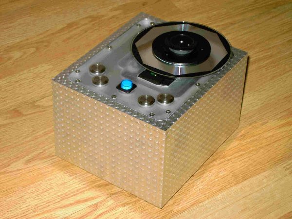

Can I add a picture of another finished Shigaclone.
I machined this out of a solid block of Aluminium, it started out at 7kg and now is more like 5 what with it now having a big hole in it.
I went for a milled dashboard type effect on the outside a bit like you get in old Bentleys and Aston Martins. We have a CNC at work that I get the chance to use out of work time but even so it took quite a bit longer than planned. Working out the program to machine the lid was particularly brain numbing.
I'm thinking of adding a window on the front at some point for the display but this may be a while off as I'd like to just enjoy to it for the time being.
I can only add to the thanks Peter has received for highlighting the idea of making a player from a boombox, it outperforms my previous player (a sony cdp-3000 ES) and hopefully should be my last.

Very original and it does look flashy.....one of a kind...must be great fun to own.
My compliments 😎
My compliments 😎
oooh, shiny!!!
Very nice Zim - any chance of a pic of the internals? What mods did you do?
