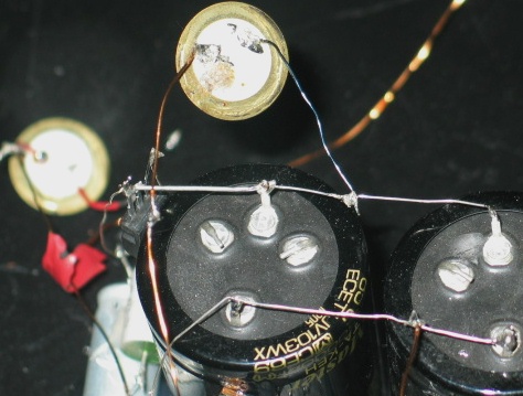

here is my very neat and smartly laid out shigalone power supply with the piezobees incorporated
