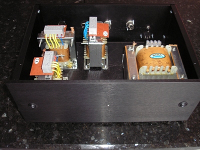

That is quite a nice unit Peter, your professionalism shows from inside out. All details are taken into account. I like to work that way also. Except this time, I'm not equipped with milling tools. While I'm still catching up in this thread (P.42), I'm taking notes during that time about how you guys built yours. I will certainly have exotic wood, Plexi and aluminum extrusion. The extrusion will probably be filled with lead since I cannot afford brass or copper.
After getting familiar with a sound, you may consider further upgrades, but most likely you won't need them.
That's what I though from my readings, many people have pushed it to their limit that I wouldn't even dare on a circuit board. Regarding the cap upgrades, again (maybe) to cut down cost, I was asking myself if I could rather use panasonic caps. What do some of you think about it?
The transformer you mention should work fine.
Since I'm more than curious and want to make shure I understand, the theoretical specs of my transformer mention 10-0-10V, what happens since CT has 0, the Shigaclone requires 12-24-12V? From your hand drawn circuit you seem to have used the CT to ground.
For the PS, what fuse size and type should I use?

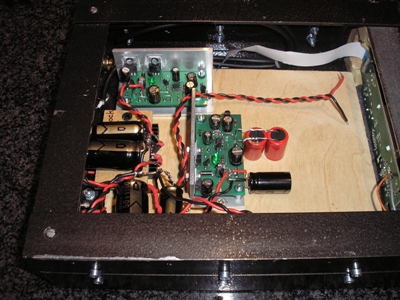

leoparleur said:why is there twice the same PS caps in picture #2350, your hand drawn schematic post #6 refer to 2 different values?
Some of the BG types are harder to source now; 2 x BG STD 1000/25 will still work equally well.

you are doing a great job, keep experimenting with those caps. I am gonna have another look at the schematics and follow those power supply caps and the surface mount regulators as my next target. I changed surface mount voltage regs on my DAC for 317's and got excellent results.

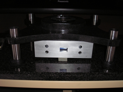

Hello Rudy....Wonderfull faceplate.....that makes it a pro player....incredible difference.....😎
As to reference the measurements I've done:
http://cid-54ea5cde40dc26de.skydrive.live.com/self.aspx/Shigaclone/transformer voltage.jpg
am I correct in hooking up this way. I really not sure about the green and white wire:
http://cid-54ea5cde40dc26de.skydrive.live.com/self.aspx/Shigaclone/my PS.JPG
Thanks!

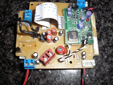

Might i add also to BRGDS's comments that i fortuitously changed a couple of the caps in the power supply line and got very positive results which has driven me to look harder. I will repeat that cap change and post photos if i get the same very positive audible results again.
Waste of time??? I dont think so, but can get expensive experimenting.
