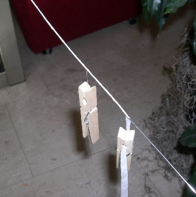

Today I made the siver cable connections from the power supply box to the actual transport...
I am a strong believer in NFO (natural fiber only) and value the reports on Micro Discharge (google)..
Also one of my home-made cables configured that way outperformed the existing ones with a considerable margin.
So I use.....0.8 mm Silver..Ricepaper..Silk..Cotton .
This will be the japanese way to go....Zen Patience is a must here ......it takes me 4 hours for 2 times 0.75 cm...........but what the hell...the weather is awfull overhere anyway.....................
Turn after turn...

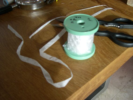

Since there is very little to be found on the internet regarding this technique I hope the ones who already know forgive me going into detail.

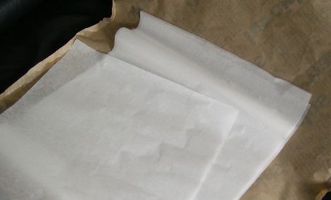

I cut very small but long pieces of ricepaper.
Two will take care of 75 cm single core cable...
I do the same with the silk cloth...
The spool contains the silver I bought quite a lot so I can go crazy...

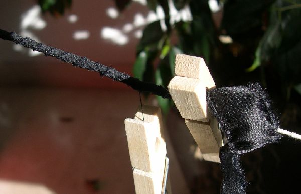

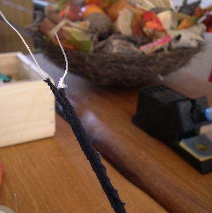

Each new winding goes exactly in the middle of the previous layer this way you get a very even end result which is crucial for its performance....
Over the entire length I tighten everything with a cotton thread.....I follow again exactly every turn...

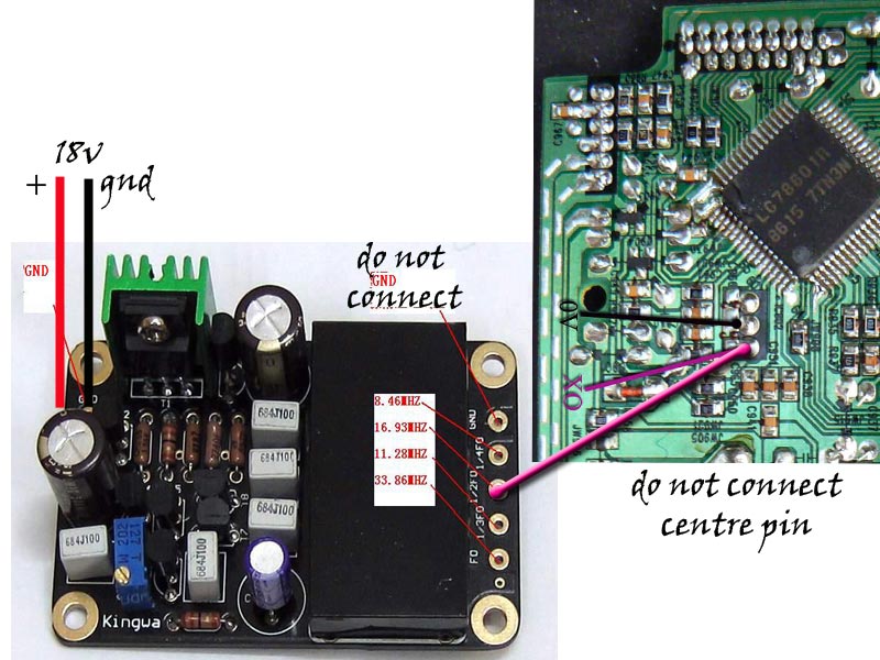

I have this funny problem hope someone could help me.
Occasionally the transport refuse to read the disc. After reset the door switch, the disc keep spinning the the TOC is 00.
Then I switched off the transport for 15 secs and turn on, then it is ok. why ?

It was observed that in some transport, when you replace the crystal, you need to add some capacitance for proper readout. It was mentioned here: http://www.diyaudio.com/forums/showthread.php?postid=1474508#post1474508
I am using an external power clock connect to the mid pin and pin 64. is it the skipping problem can be corrected by adding 10 pF cap in parrallel.
I'm not sure about that. But you may put back the original resonator and see if problem still occurs.

ccschua said:I am using an external power clock connect to the mid pin and pin 64. is it the skipping problem can be corrected by adding 10 pF cap in parrallel.
Hi, are you using the same power supply for transport and clock? If so you may need to disconnect the mid pin connection (gnd). Just connect to pin 64.
What voltage are you supplying the clock with? Make sure the clock power caps are rated at a higher voltage than the supply voltage..
The caps on my clock were 16v, and I was using the 17v supply to power it. I changed the caps to higher voltage rating..
-> So are u saying just connect Vcc of the clock to the transport only (at pin 64) and leave the middle pin ground open ?
-> the voltage is DC 18V. I tap the supply before the peter regulator and supply it to the audio-gd clock. The audio-gd external clock requires unregulated power supply between 10-25V.
My caps are rated 35V
