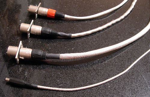

This evening I finished the external cables...a 25 hour-job devided over 4 days ...but I reckon worth it...
I made an exception by working on a week-evening...but that is because I wanna be able to play on a finished transport this year at.........:xmastree:

It is named Glass-Silk....and all I can say is that on one of my tailormade cables (as a total) it was a pleasing effect....in sound and looks
Material is some sort of glassfibers but it looks feels like natural fibers ...very soft and flexible/stretchable.. woven.
...anyway it gave me a much better feel(-ing) than your average nylon/teflon sheathing...
I bought it in Delft (HEC Electronics) but I guess your Radio Shack can supply....

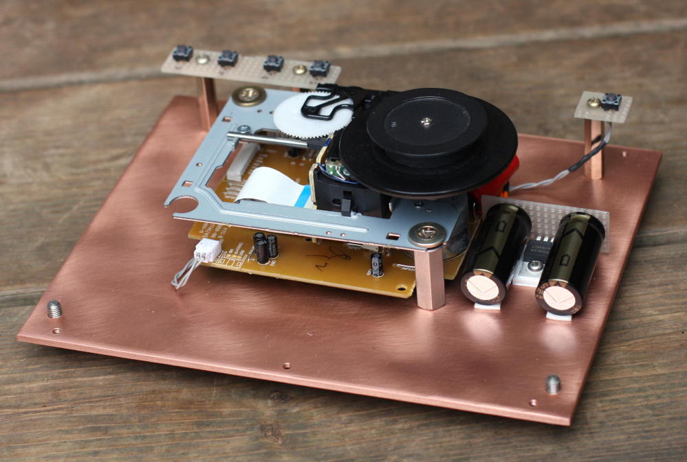

I just put together another transport, the mechanism is mounted on standoffs to a bottom copper plate.
I only replaced PS, as descibed here: http://www.diyaudio.com/forums/showthread.php?postid=1468036#post1468036
Everything else, including resonator, is stock. The output resistors are 100/300R Mills.
The transport plays really good, as good as the original Shigaraki.
In some ways it is better that my prevous built, especially when it comes to raw energy in reproduced sound. The trade off is slightly less refinement and smoothness, but when you get used to it, you won't even notice ;)
I will later post more pics of the inside job.

Duka, I dont think it matter so mutch where you place the output resistors, i will mount them on the board.
Peter Thats an realy nice looking transport, did you mount the mechanism whit no damping/springs ?
Iam planing to use copper in my transport too, its a nice metal to work whit and i have alot of it too about 1 tonn :)
