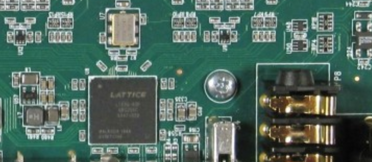

I wanted to try this package on my DAM1941 assuming that the 1021 filters work here as well...welll...error message: "Incorrect Image" when trying to update...is there a pure NOS-Filterpack for 1941 ? IDeally with the first filter being NOS as my friend did not wanted to invest into the font-panel...so he has only one filter, the first one all the time.
Is the difference not the FPGA? In stead of the Spartan there is a Lattice in the DAM 2541

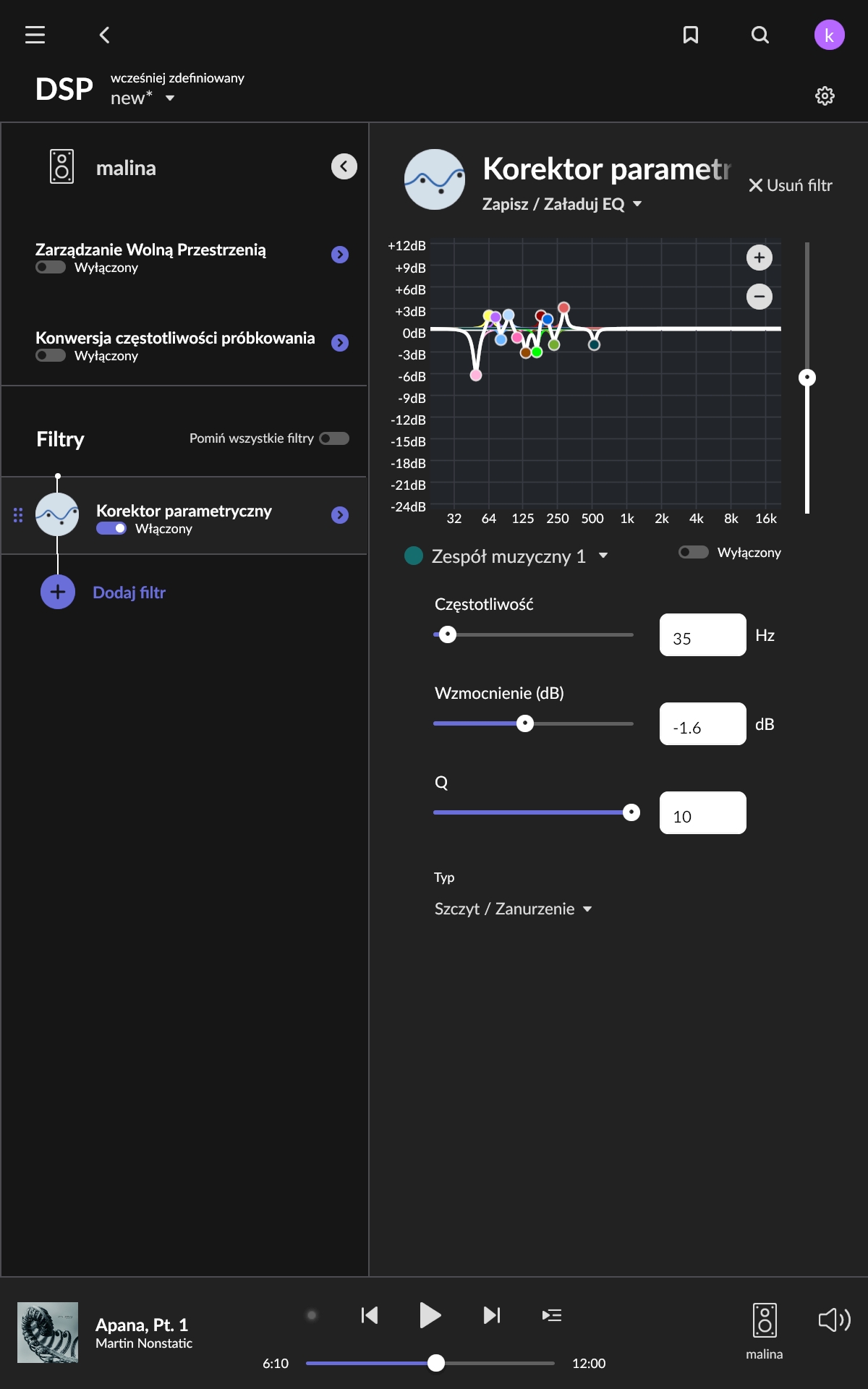

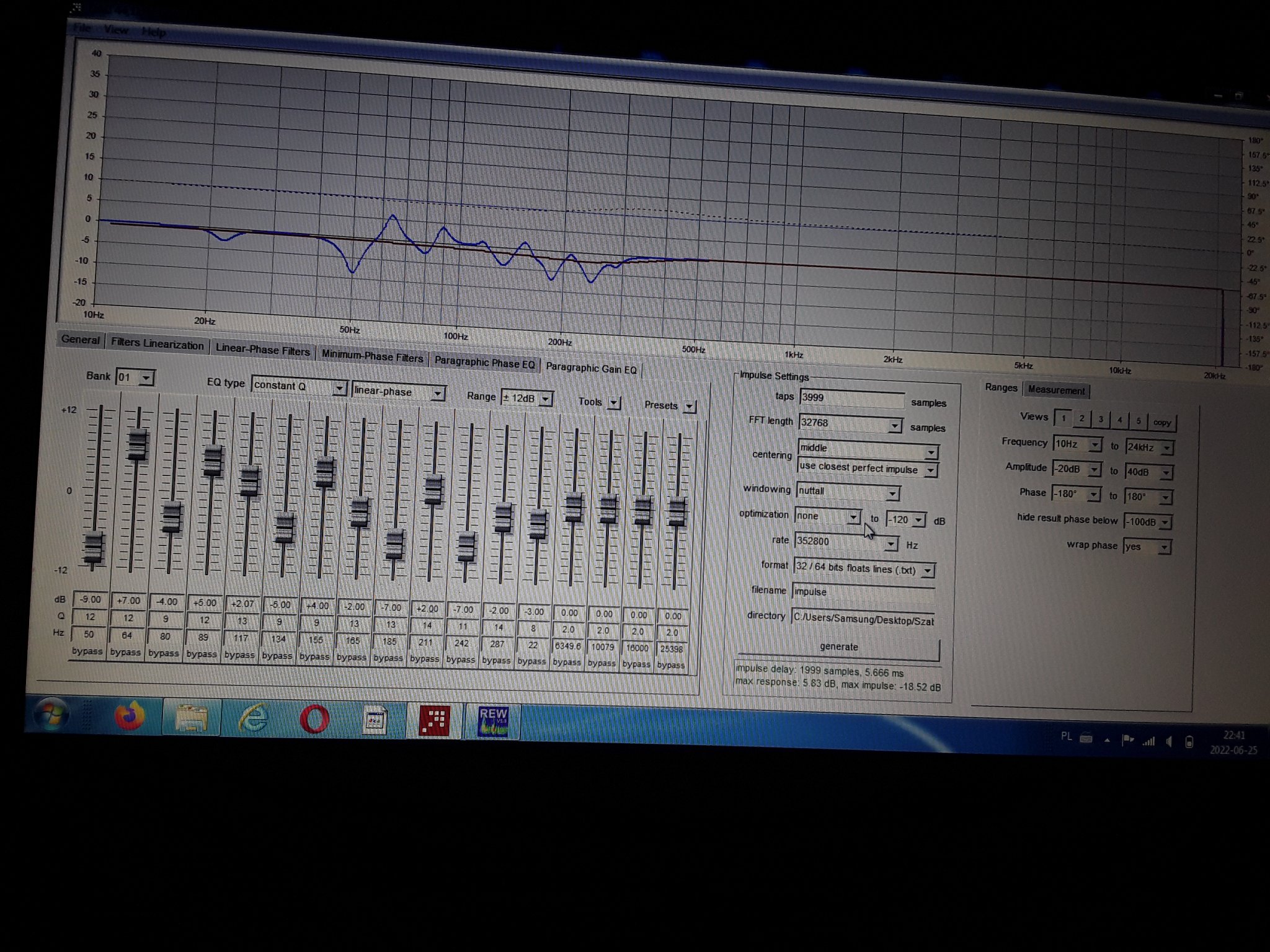

Hello I was trying to do a dsp room corection in fir1 by rephase on 4k tap filters(thanks Marcin for helping me start) Of corse i have don room measurments by rew aqustic. And i want to do something with lowest room mods. Beacuse i dont have no more room for rezonators ant bas traps(rest of room have good quality pasive aqustic. So i was using dsp room correction in roon audio system, but playing fromm cd transportmdont have this correction. I have put corection in rephase,generate impuls and what i get? Red line shows me that i have olmoust nothing. I have done skr file and try this filters. But nothing big i have heard. Inn roon correction when i put some corrections 50 hz.. 68hz.. and more i have get good bas , very good. Can any body help me? Very thanks.
When you hit the generate button in rephrase you see a red trace showing up - this is what you in the end will load. This red trace can differ significantly from what you have dialed in due to that 4k isn't so much capacity. Keep track of that and see what you actually got. Alterations at low frequency is particular capacity demanding.
I have try lots of options in rephase, but for now it is impasible to for example go down at last 5 db on 50hz(this is not humm, this is mood in my room) and go 5db up on 64hz keeping rest off charakteristic flat.. this kind off dsp are pasible to do on soekrisis dacs?
