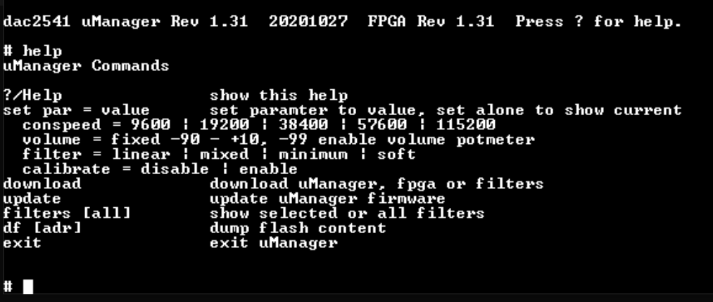

Hey! I'm a newbie and this is my first post here. I have a soekris 2541 dac and have been enjoying it for a few months now. For novelty, I'm trying to install some new filters. I came across TNT's no-DC filter in post #1833, which seems to be among the community favorites.
I did
My assumption was I should be able to see some change in the
I did
download
the skr file to the dac and restarted the dac as well (no update
command, I understand). Now, how do I verify whether filter installation was successful and am listening to the new filters?My assumption was I should be able to see some change in the
filters

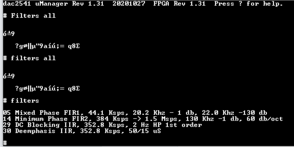

command output. When I play a 44.1 file I see the following, which is what I saw even before updating filters. Am I doing something wrong?To play my filter you need to push the Filter button so that bank 4 is activated. Now you are playing bank 5 (05 Mixed Phase)
But as you see a 29 DC blocking IIR, you didn't seem to have succeeded in loading the file correctly.

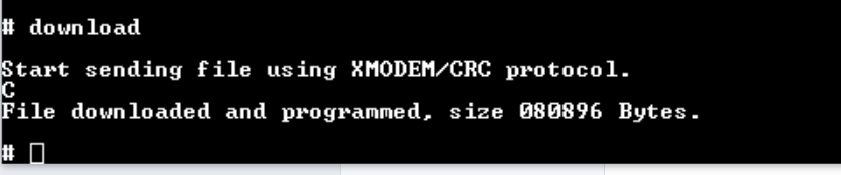

To load a filter file:
When you have promt (#) do command:
Download
and you will see +++++... on the screen - before this times out, using your Terminal application - do "Send file.." or whatever it is called in the app you use.
It should end with something like : xxxyyy byte successfully programmed.
Do a power off/on
If you do "Filters all" you should see the same as in the second attachemnt in post #1833

Thanks for responding TNT. Seems like download is succeeding. However
filters all
command isn't working in my dacSharing screenshot. Funny enough, help shows
filters all
command. Note uManager prints I am on FPGA Rev 1.31, if that's related at all.@trybeingarun
I did the same comment to Søren many months ago (almost a year) about this issues on dac 2541.
Response was : "The dac2541 do not support custom filters yet, it will probably come at some point...."
To reach this point, first we need to have a new firmware but nothing new in download folder......
Søren also was working on new filter on his own but no news either...
Ask about support and report if you have news about firmware and filters ... 'Soren Kristensen' info@soekris.dk he respond
Fortunatelly i still have a 1541 which support filter flashing ! (i use 1541 (usb) with my main SS amp and 2541 (AES) with tube headphone amp and standard black filter is not bad at all)

Thanks for sharing this. I didn't receive any response to my support email request and was assuming I was doing something incorrectly. I'll continue to wait for the new firmware for my dac!@trybeingarun
