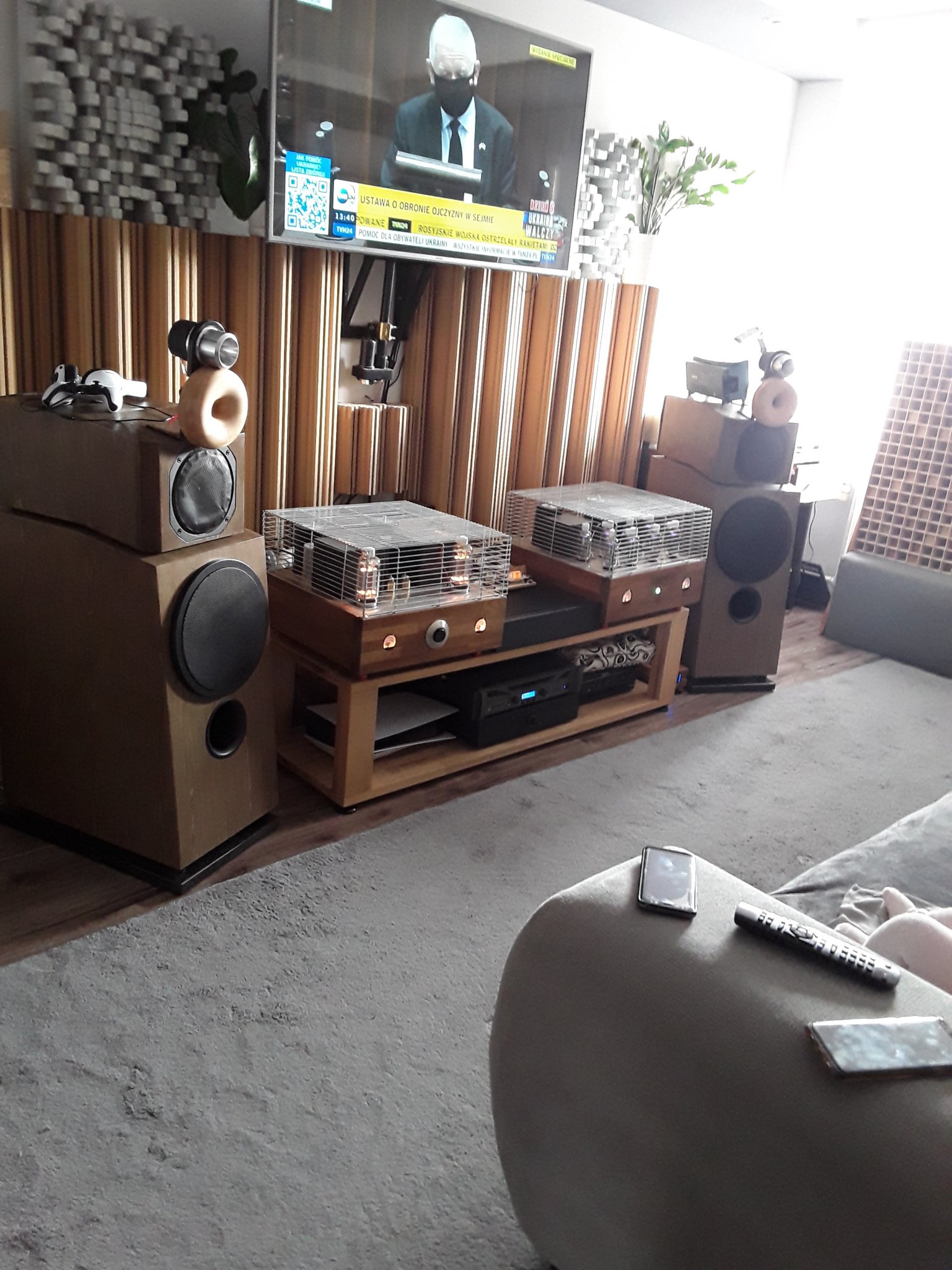

Hehe i have good streaming on roon audio, very complikated system (two pc, 2lps, reclocers etc..) and my new shigariki clone cd plays just a litle better. It is very hard to have good stream when you compare it to good transport. Of corse i can do normal bass traps and rezonators but i dont have space , and my wife... my room is litle overloaded.

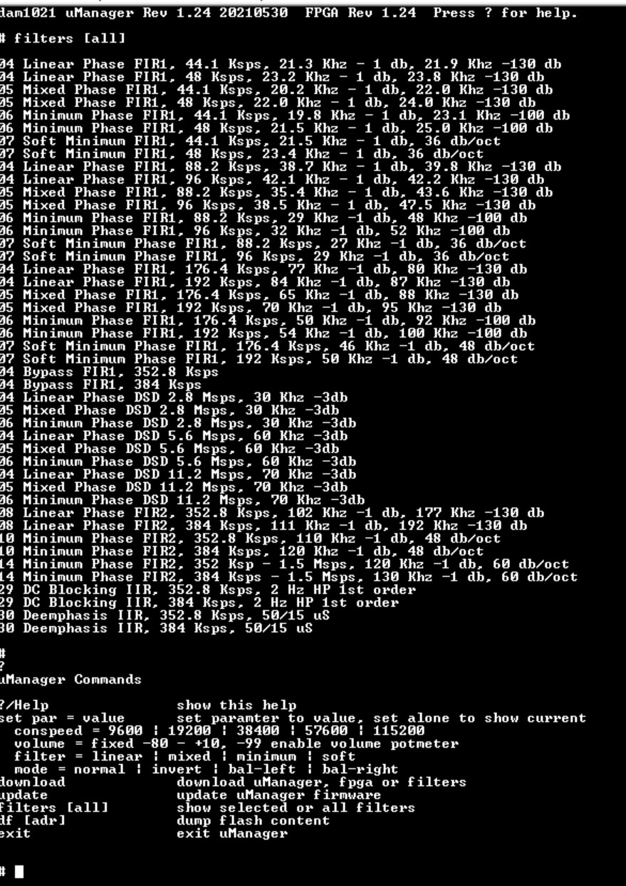

So I have read, and reread, the numerous posts, blogs and guides on how to load custom filters. I read @TNT 's explanation about the odd naming protocols. I was able to download a custom filter into uManager, (29+30). I still cannot get the custom filters to load as the active set.
I see several entries that follow the "Linear", etal... naming protocol. I am assuming that all of the entries, except 29 and 30, are stock filters installed at Soekris. Entries 29 and 30 are the filters that I want to try. How do I select them? I tried "#filters [29]" but that just returned a prompt. How do I determine the currently implemented filter set? How would I delete unwanted filter entries? The "dump flash content" is a bit risky for me to try, given my lack of experience with the DAM1021 uManager.
Here is a screen print of what I am seeing in uManager.
TNT
Joined 2003
It's a "bank" that you activate. The banks are:
04, 05, 06 and 07
they contain filters for all supported sampling speeds, thats why there are mor than one. Filters belonging to same bank has same number in that printout. Other filters in list are not user controllable. Forget them :)
29 will remove any dc component in digital stream and is always on if present in that printout
30 would be activated if a certain bit is present on s/pdif
Now read my other description again :)
