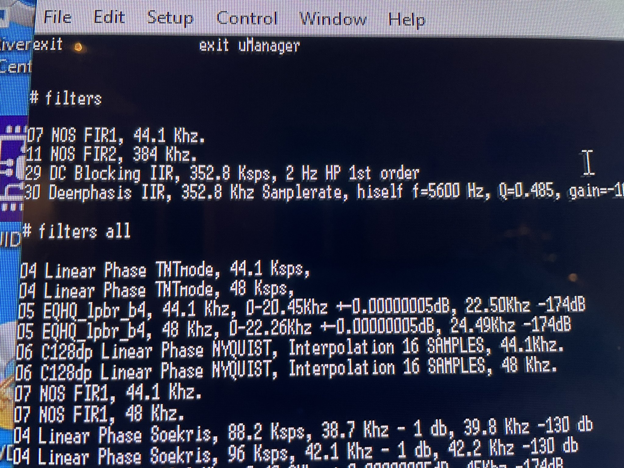

hi everybody;
and thanks tnt, i was successful. could update firmeware to 1.23 and update umanager as well (forget to do #update after firmware download, but could do it a second time...)
not quite clear for me is the behavior of dam and the custom filters: after filter installation, i exited and restarted twice. every time another filter was on first position. (though "filters all" showed all the custom filters) - see jpg attached. (i assume, 07/11/29/30 would be the 4 filter i could switch)
then i tried to enter umanager and do the "set filter = linear" command, and then it switched to your filter at first position (tnt) of the four filters and stayed there, even after rebooting.
what happens now, if i try to switch filter via rotary encoder of the audiozen board? or will now the linear (i.e. tnt) filter the one used?
thanks again, happy to make comparisons now!
kind regards!

Set filter in uManager set it permanent and survives power cycle. Doing just "F5" (etc) when not in uManager changes the filter bank but dont save persistent.
I dont know about your adiozen board but when you play something and in uManager you can do only "set" and you will see the current config. (I think 🙂 )
And doning "filters" in uManager prints the currently used filters - yes!
In your printout you see all the four different filters that make up the total filtering for F4 / Linear. Its FIR 1, FIR2, DC filter. Deemp is only active if you play a CD with deemphasis - forget this...
ah thanks, that one i did not know. i thought these were the 4 filters i can switch between.
makes sense now!
so possibly i can switch (with rotary encoder) now between all four loaded filters, because when i transfer custom filters, the soekris stock filters are "overwritten" right?
so with your custom filters it is:
04= tnt-filter, 05=eqhq, 06=c128, 07=nos id est shown in the display: 4 = linear, 5 = mixed, 6 = minimum, 7 = soft
kind regards, horst

just as an info: if i switch filters via rotary encoder of audiozen board, they change. i will check, which filter is active after reboot, the last one selected or the one programmed via "set filter" command in umanager.
and i have to say, i really like every filter in this pack, yours tnt (f4) seems the smoothest, really analogue sounding (in a good way) very balanced, and i also really like the "nos" filter (f7).
