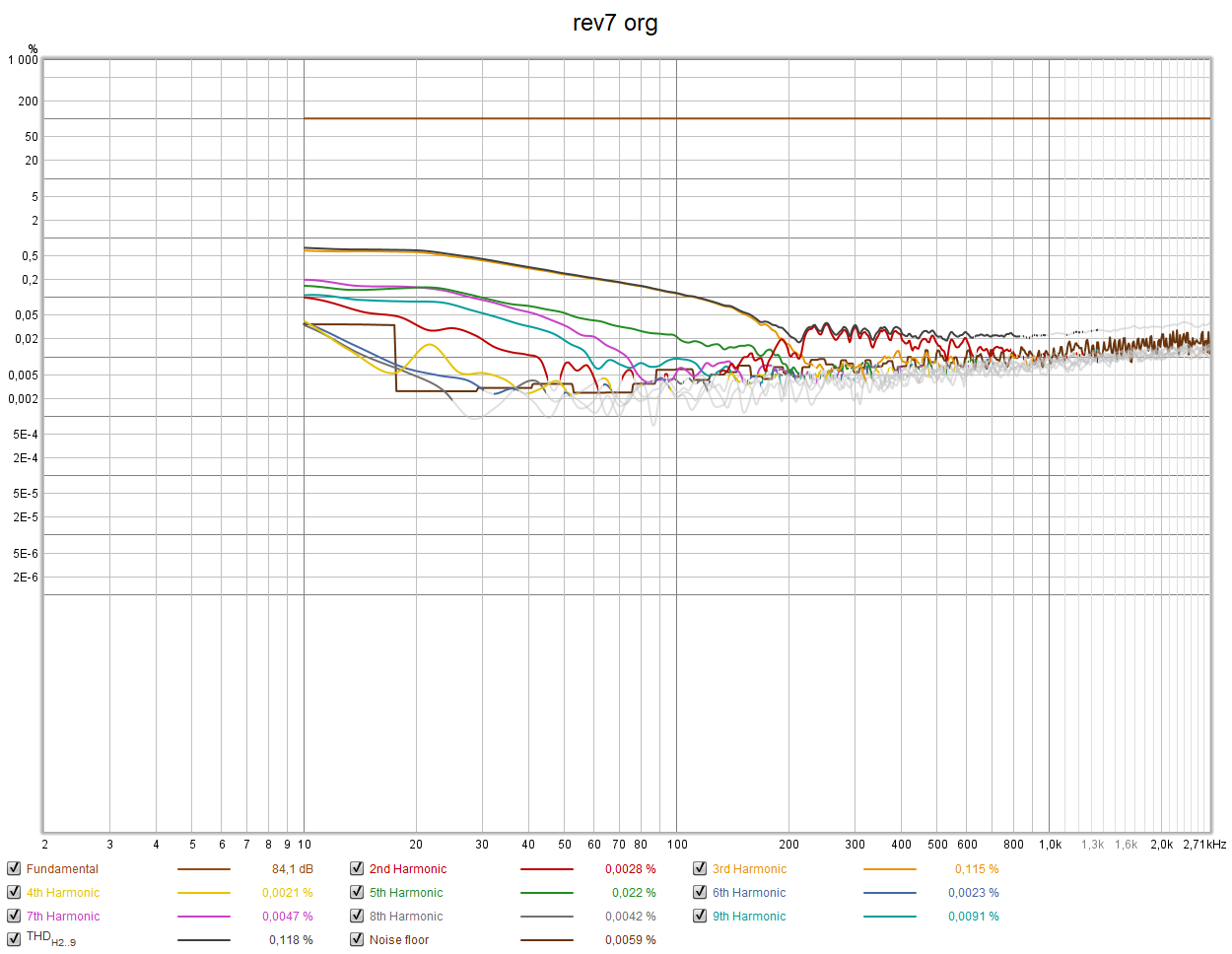

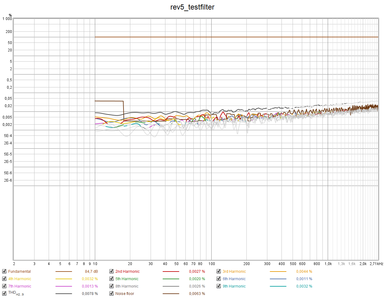

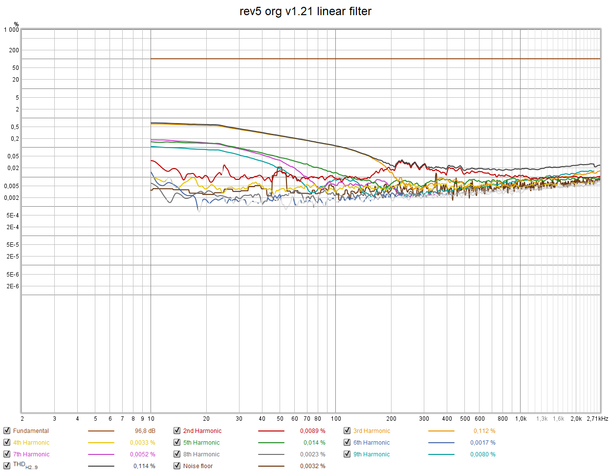

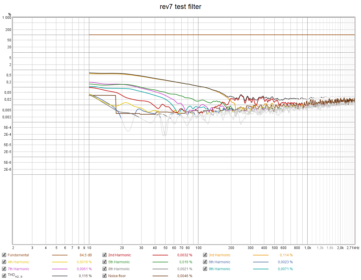

I have two identical builds of dam1021. One rev.5 with resistors 0.05% and new one rev.7 with 0.01%. Older dam is running with custom filters which I was trying to migrate to new version.
Unfortunately I’m not able to achieve same performance in distortion level on rev.7 probably because of lower upsampling factor or some changes about I don’t know. Is it possible to have same upsampling level for rev.7 as it was in previous versions of dac?
