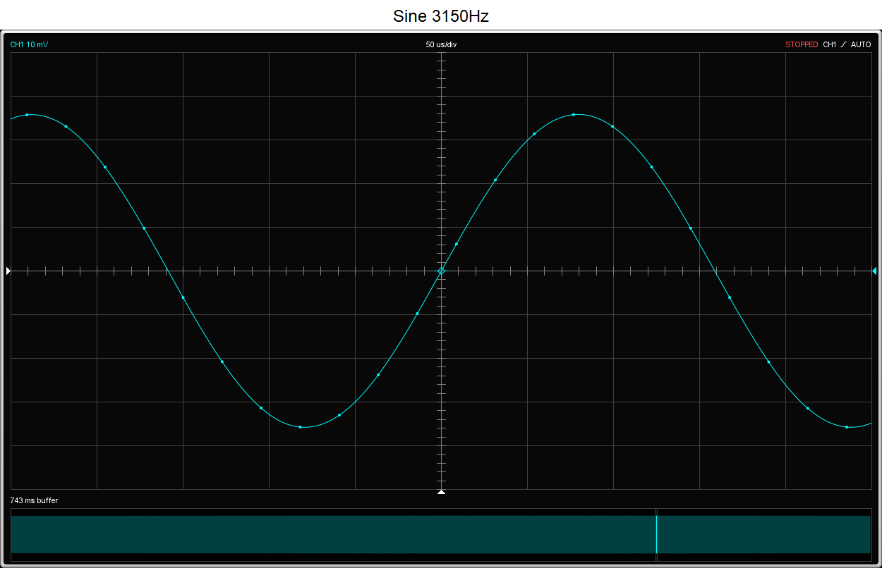

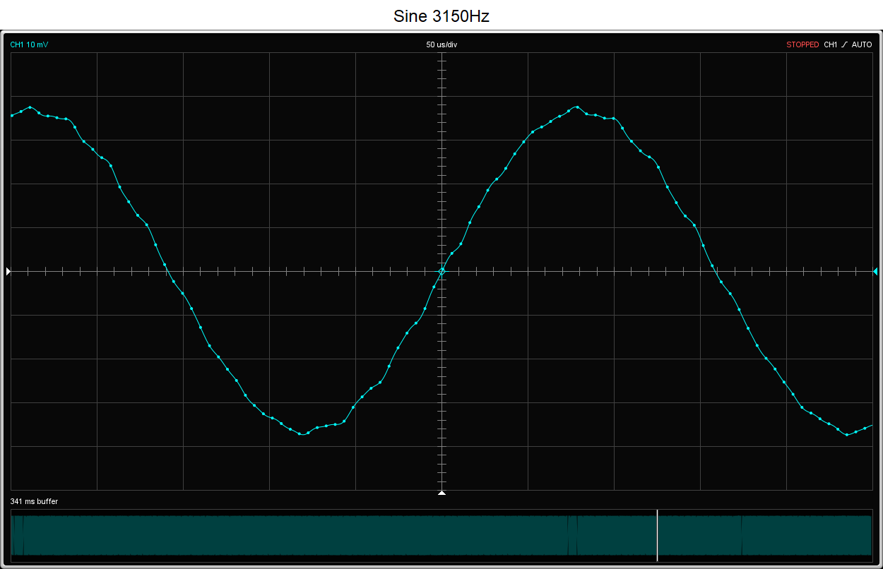

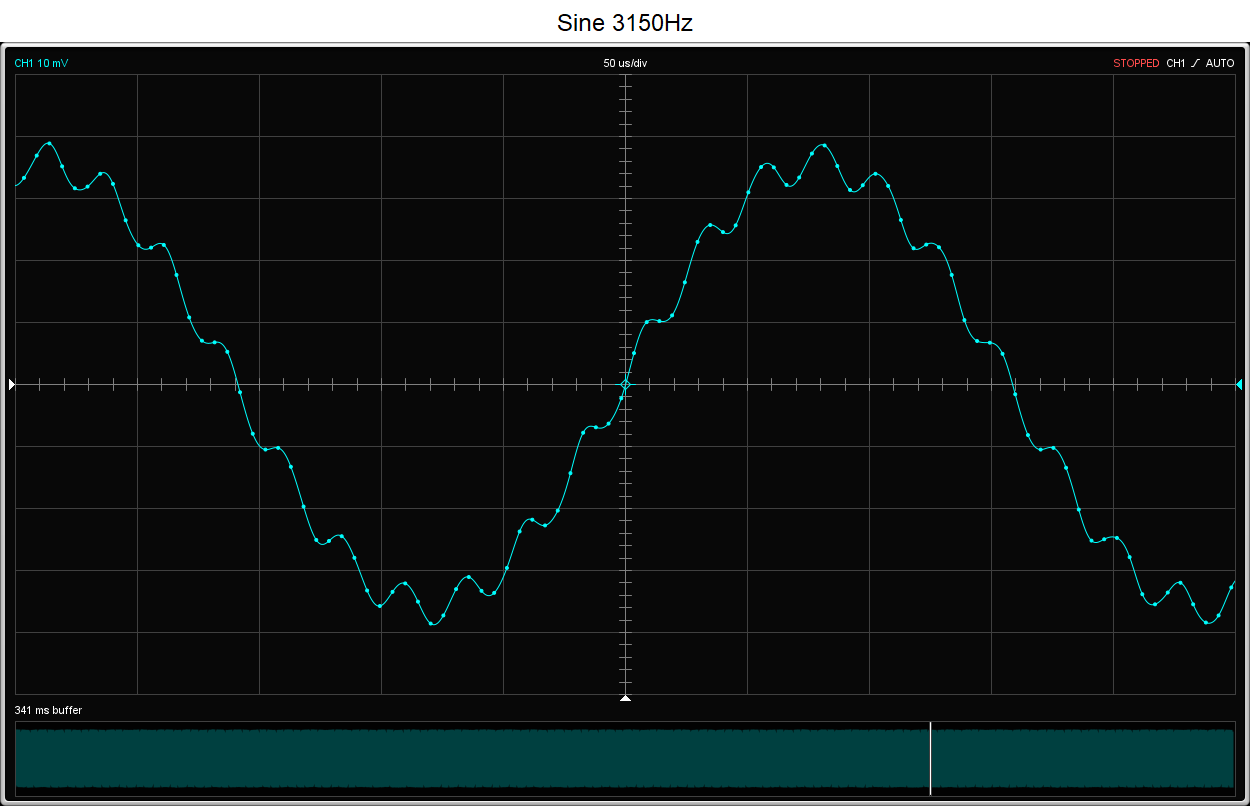

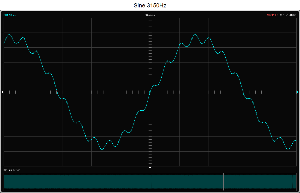

NOS is easier when played(observed) with exactly same frequency as it was captured. When we upsample to higher frequency we have to decide what to do, reconstruct or in case of NOS (zoh), how many mirror images we want.More mirrors wider bandwith, better reconstruction but our staired wave. So we just geting better picture of stairs. So diferences beetween filters are just to find optimal solution for that problem. Holo Dac for instance allow multiple images. F4 is more reconstruction, F5 is native so all images pass just auttentuated ,F6 and F7 is hard limited to just one image. There is some other stuff I also trying after failure with excesive computation and low precision in previous filters.

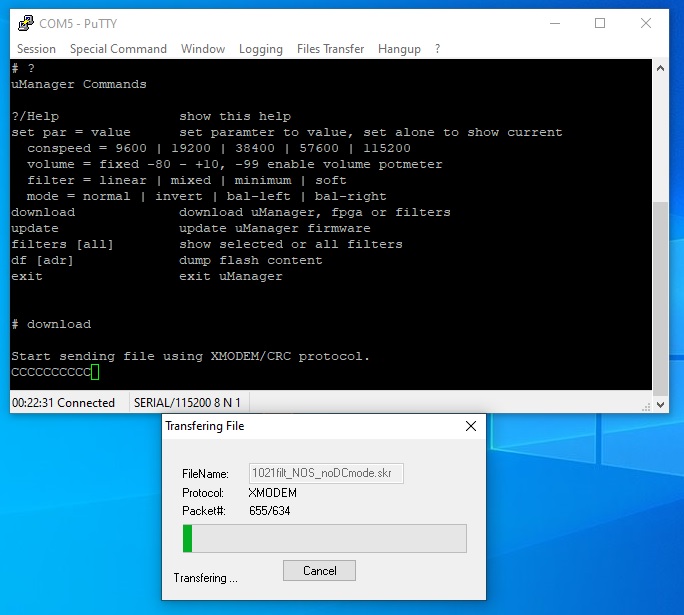

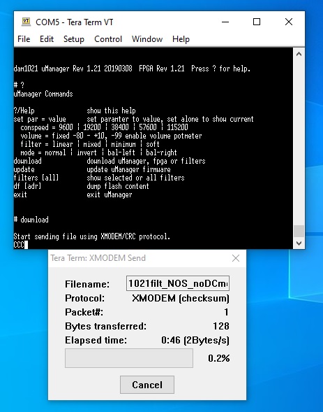

Finally I got the USB adapter working via J3.
I get the uManager and I'm able to download the filter but:
- using Tera Term the data are not sent because file transfer starts and freezes
- using Extra Putty file transfer never ends, it restars as soon as all the packets are sent
Any help?
