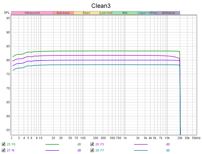

This filters set is consequence of listening my dam1021 on my friend’s speakers, so we have
New IIR filters without ripples
New All pass filter
All FIR1 filters are NOS
New FIR2 filters
Gain is now only recovered in FIR2 stage so no coloring.
The biggest difference is FR roll off between F6 and F5 filters.
F4 and F7 are variations of F6 filter with very small difference in FIR2 stage.
Unfortunately not but still it’s worth to try because on some systems they could sound amazing well. Main purpose of this set was creation of ripple free flat FR with proper gain.
So FIR2 filters are optimized for gain recovery and limiting band because after NOS first stage band of interest doesn’t change. It’s quite challenging with only 240 coefficients.

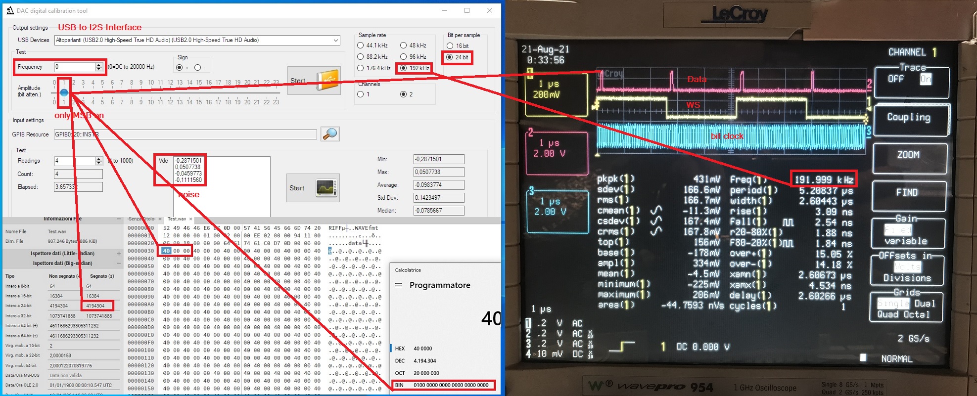

DC samples issue
I have to play DC samples with my DAM1021 so I need bit perfect output without DC filter and without any alteration to play the signal in its original format (picture attached).
Could someone provide a NOS filter without DC high pass?
Thank you
Thanks, but I don't know.
I have to play pure DC samples without interpolations and without DC high pass filter.
In other words when the DAC receives binary 192kHz/24 bit 0100 0000 0000 0000 0000 0000 it should play exactly the original word, in this case half the maximum peak DC output (around 1Vdc).
Someone can tell if it will work?
