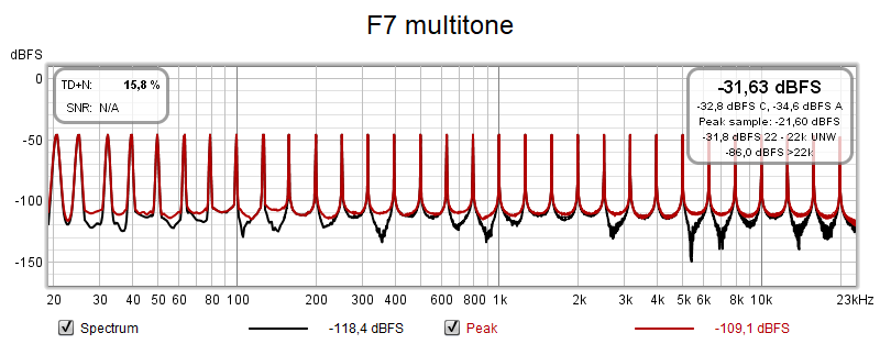

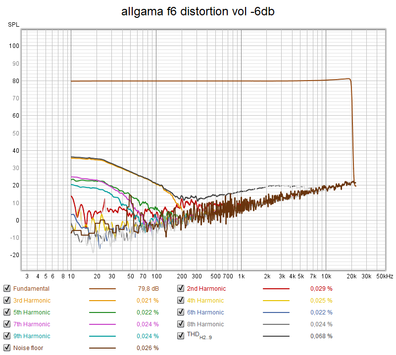

Finally readjusted allpass filter for hopefully satisfy wider group of people. It’s based on one of my early filter, so should be ok but verification is needed.

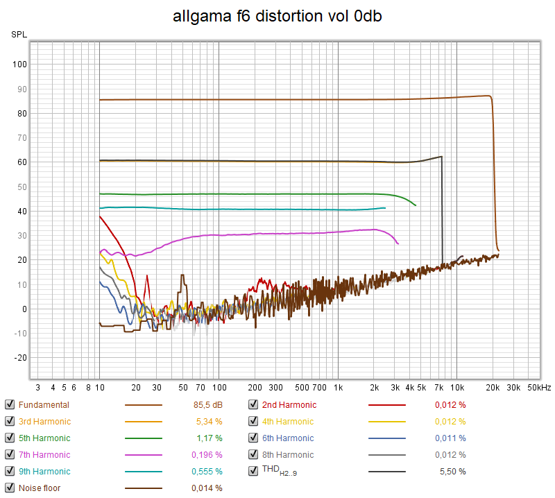

Some more explanation about allga filters family.
F4 to F6 filters stacks are made identically just with small change in FIR2 stage filter which is new 64 coefficient filter.This small difference allow to make adjustment of sound presentation according to preference.

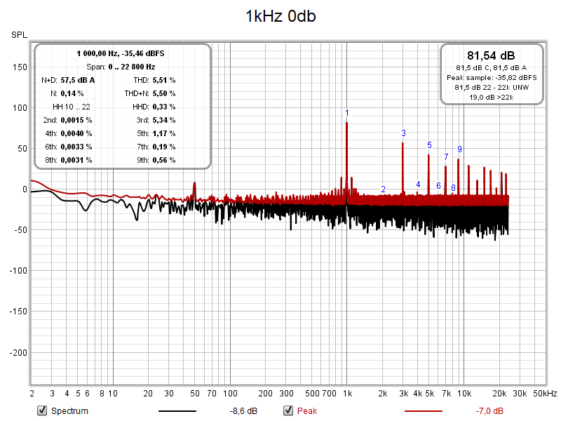

Second thing that is special in allga family is magnified distortion adjustment with volume. If we set 0db on dac we could get over 5% THD. Lowering volume to c.a -6db on dac almost cancel that effect, so we have 0 to -6 db to adjust harmonics to preferred level.

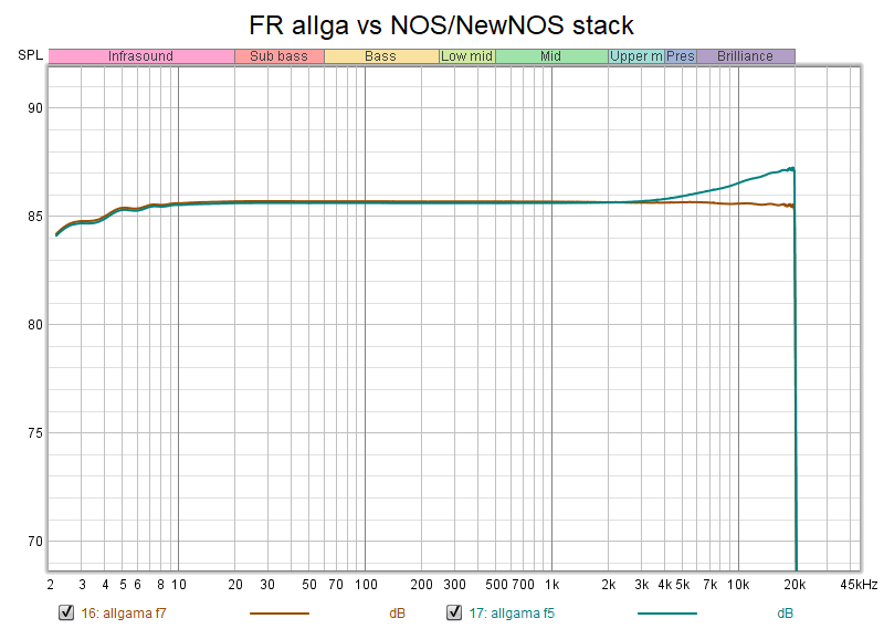

There is FR with elevated high frequency ca 1.5db

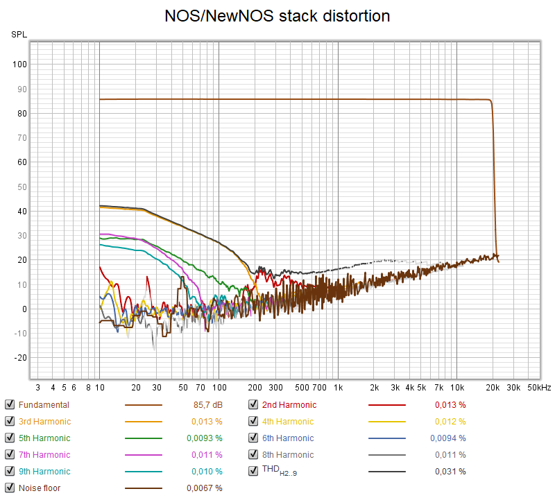

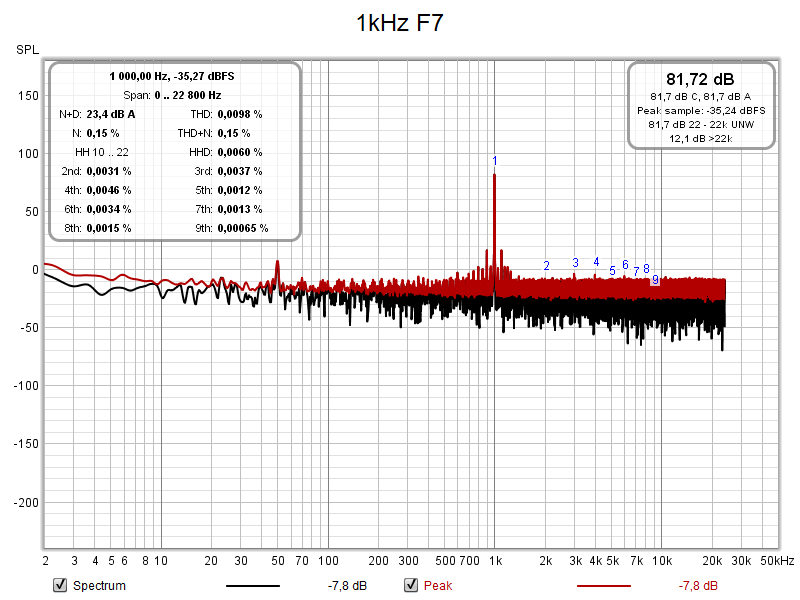

F7 filter is NOS/NewNOS stack for “classical” presentation(volume level works as usually
Anti aliasing for all with IIR filters.

Thanks for these extensive graphs, that's very informative!
Now genuinely curious and not at all intended as inflammatory, I'm wondering what your design goals are for F4-F6? From a measurement standpoint you could say that NewNOS has lower THD even when comparing F7 at 0 dB to F6 at -6 dB. Moreover, the highest spikes are odd harmonics which is generally not what you want.
I've yet to listen to them, and I will, but as you know I like to look from both the objectivist and subjectivist standpoint (call me a "rational" audiophile )
(Also I'm just surprised how low THD and harmonics are on NewNOS!)

F4-F6 filters are designed to make music more alive, present. I believe that harmonics and correct tonal balance are the way to do that. Because we are on different systems and have sometimes completely different preferences I want to create some flexibility.
So now anyone can easily confront pure distortion free filter vs “as much you can handle” regulated distortion filter 😊

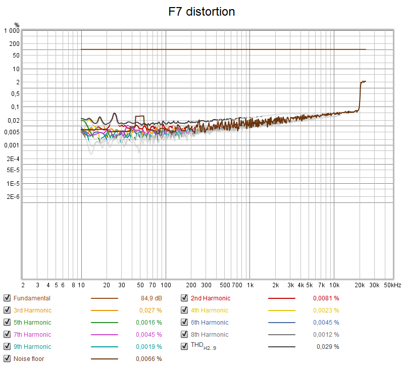

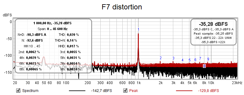

F7 NOS/NewNOS was measured from hybrid tube preamp out so it could be much better on ss. It’s normal for NOS.
Is it so normal? Archimago's Musings: NOS vs. Digital Filtering DACs: Exploring filtering turned off, implications, fidelity and subjective audibility. (Recent BorderPatrol DAC chatter...)
Normally non-linearities from NOS square steps cause all sorts of distortion.
Maybe not so common, but NOS has the best impulse response, so it’s normal. All other problems can be solved by IIR to acceptable level in my case and Soekris Sign Magnitude Discrete R-2R architecture which allow NOS to be civilized. Look at Denafrips Terminator and his NOS, they are exploring this area too.

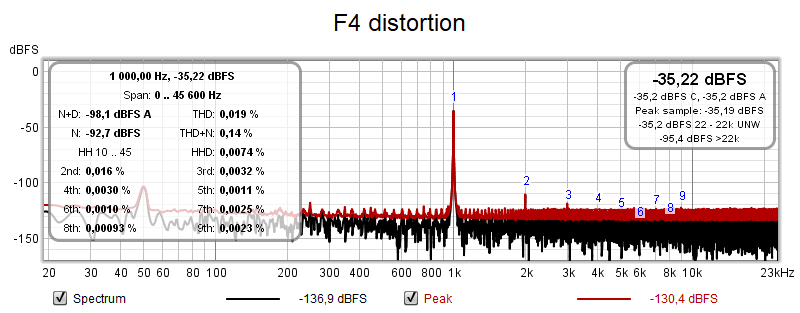

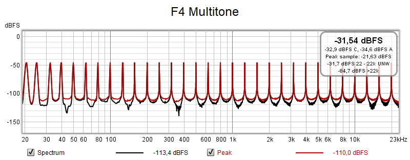

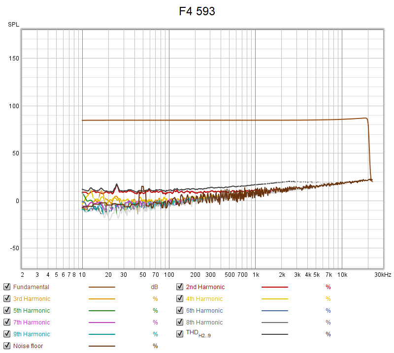

Opposite to last production this filters set is designed as clean as possible. So now the biggest source of distortion is my amplifier power supply 😊
I don’t have fancy test equipment and my dam1021 is 0.05% version. Filters stack structure is similar to allgama with one exception F6 filter on first stage is now C128DP.
Some improvement in tonal balance are implemented.
