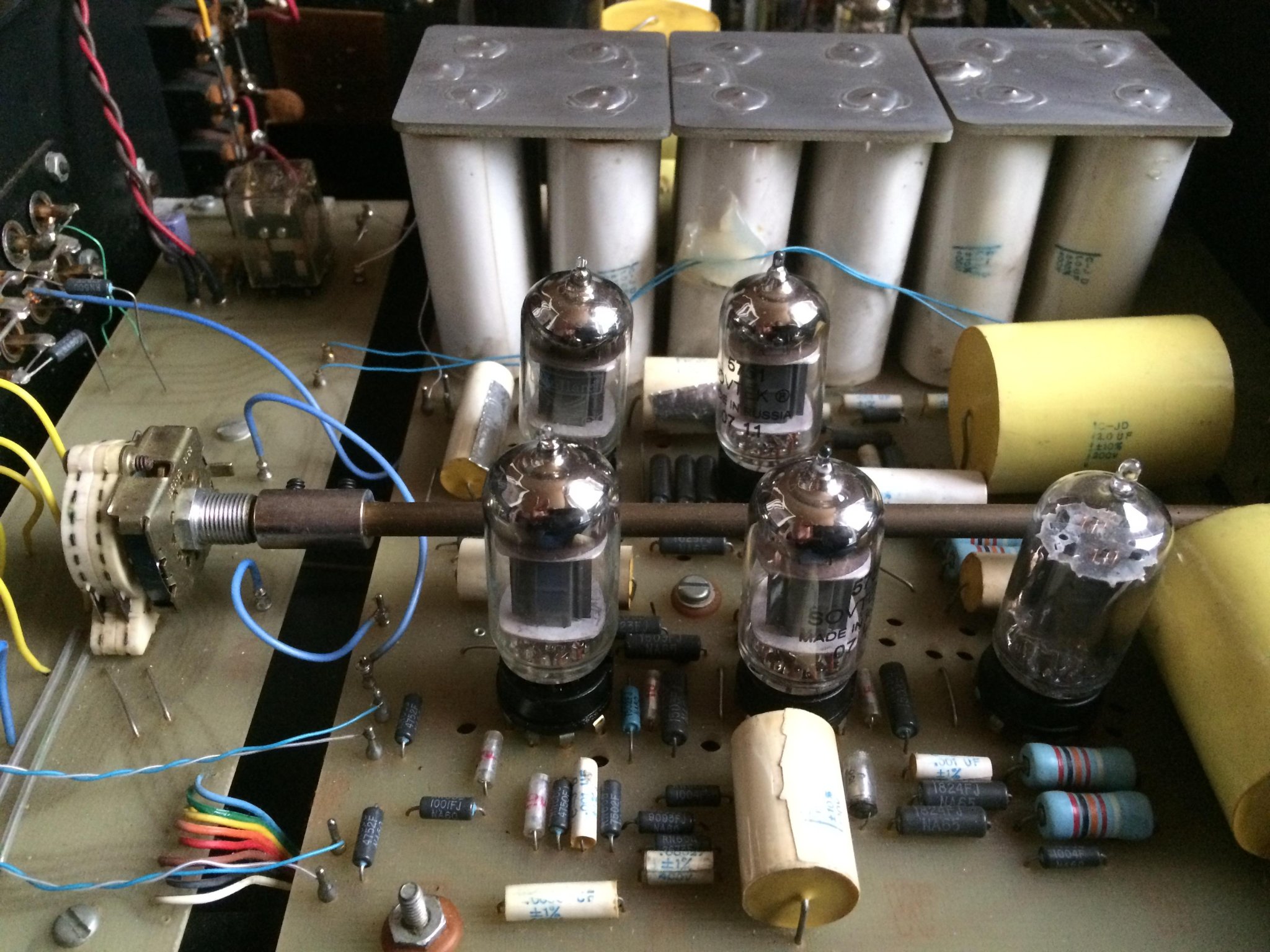

I had a 40 year old Conrad Johnson Premier Three B tube preamp with only filmcaps for PSU duties.

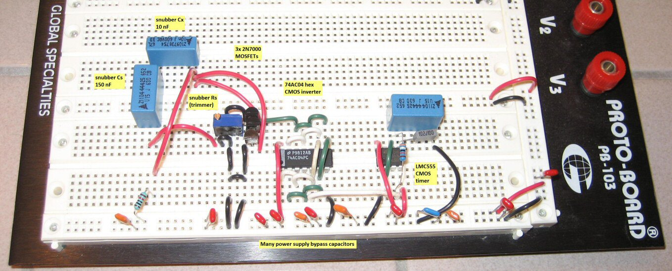

The first prototype Quasimodo was slapped together on a solderless breadboard. Since I had no 1-ampere gate driver ICs at hand, I just used several CMOS logic inverters in parallel. And since I had no power MOSFETs, I just used three junkbox 2N7000s (TO-92 packaged) in parallel.
You, yes you, could do the same on your solderless breadboard. Today.
There is also a stripped-down, lower cost variant here on these Forums. Search thread titles for the word Cheapomodo .

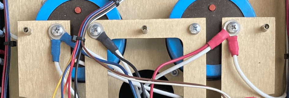

I have an ASC motor run and Solen PP caps in my outboard tube amp PS. I can’t speak to any advantages in terms of sound quality, but the caps will undoubtedly outlast me.
If you can find 30000uF film caps, I strongly encourage you to use them. :smash:
