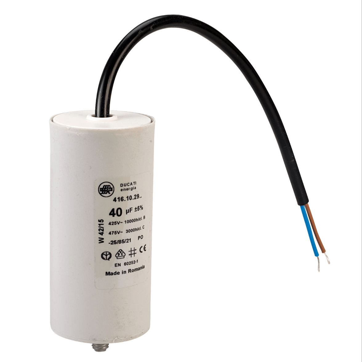

I'm routinely using (semi)easily available in my neck of wood - Icar or Ducati caps
I like them 'Talian, currents I'm putting them on are much smaller than currents they're designed to conduct in few KW motors, so no brainer
just a remark - when anyone sez "motor-run cap", that firmly and logically excludes "motor-start cap"
later ones are made for much greater currents, but for intermittent work ( they're outa circ when motor got to speed)

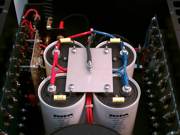

It will also be audible to replace the fat ground plate with wire. And I would also remove the eyelets. They are also audible. Use plastic screws to connect. Then remove the small bridging capacitors. Without replacement. Then put the 2 x 2 remaining fat caps at ONE circuit each!

The picture I supplied is not of the SA/1 amps I posses.It will also be audible to replace the fat ground plate with wire. And I would also remove the eyelets. They are also audible. Use plastic screws to connect. Then remove the small bridging capacitors. Without replacement. Then put the 2 x 2 remaining fat caps at ONE circuit each!

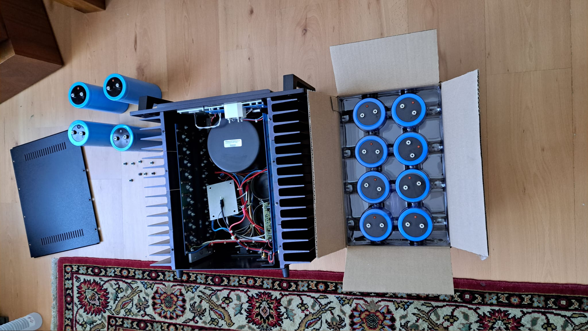

I only replaced the four 29000uF 35 year old Mallory's with fresh CDE 100.000uF and then wondered if I would do some further enhancement with these old Thresholds, hence my question on this forum.
just try it and make your own conclusions

No large metal plates in audio electronics. We do not want to ground bridge piers, but "define current" feasible ;-)

if metal plate is big enough, you'll not hear difference
or you can go total fancy - use that water-jet cutter you have in backyard, and make slits in metal plate, defining current paths

I will make that metal plate (post #1) differently, yes, just for heck of it
feeding GND wire staying in same place ......... or moved right in between final caps
metal plate 20-40mm longer on side of final caps, forming free area ....... then outgoing GND wire ditto on mid of edge

I once had a pair of Threshold S/1000's (SA/1 hardware but then in bridged mode to get 500 Watts at 8 Ohms) that had a hum over the speakers.
I cleaned all GND connectors and surfaces with a contactcleaner going to this metalplate and the hum went away. Just simple as that.
Pray tell us why this procedure could be audible? Also, with plastics screws you can never have enough torque for a tight connection. So, in brief, I wonder what's wrong with the iron?It will also be audible to replace the fat ground plate with wire. And I would also remove the eyelets. They are also audible. Use plastic screws to connect.
