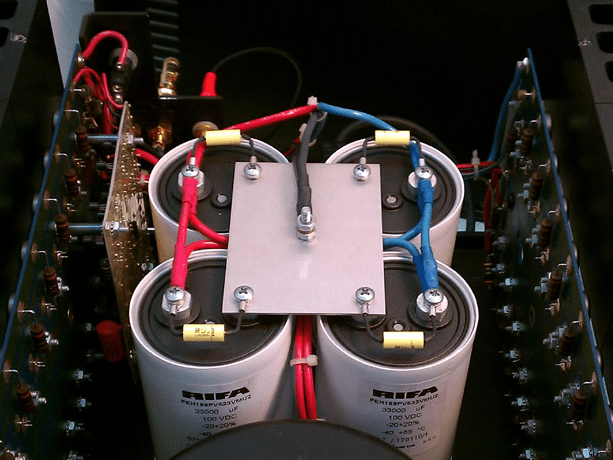

Having a pair of old Threshold amps I wonder if it is a real benefit to install solid caps (that's how ZenMod calls film caps ;)) over the big electrolytic PSU caps like this of course:

Maybe I draw the wrong conclusion here but it seems that NP doesn´t recommend/finds it beneficiary to install solid caps in the PSU over the electrolytics.
I'm curious what is your opinion in this matter.

I agree with ZM that I hear a difference. It's hard to say though how much is from interaction with inductance, mains noise suppression, or rectifier noise suppression. For that matter, I tend to prefer having the caps close to the load. If we are eliminating noise or inductance, we might as well eliminate it from those longish loopy PSU wires too.
I have to say though that the difference is much smaller when you have applied a proper snubber to the PSU/rectifier. Which makes me think that the rectifier noise and ringing kinda swamps everything else. Mark has also done some awesome job in that area with his Quasimodo snubber.

I knew that was coming and you're right! Isn´t there an acceptable solution without first installing the Quasimodo board, I mean I kind of rule of the thumb for the bigger Threshold powersupplies like the ones in the SA/1, S/1000 and S500?

A well-designed amp has local decoupling with film caps where it matters, right at the stage or device. If you put a film cap at the supply, the low inductance is easily swamped by the inductance of the leads from supply to amp stages. If you use them, use them where it matters, and that's not in // of the big supply elecs.
BTW if an amp goes unstable with some film caps in // of the elecs, its designer should go back to school.

Acceptable in what sense? You have to qualify your expectations. Using a single film cap next to the electrolytics, you might hear a difference, but it won't be because you solved the high frequency inductance problem (you haven't). You are also not handling any ringing on the rectification.
It's probably more filtering and/or ripple handling. That is why the motor runs make some sense in that position. They work nicely at 50-60 Hz to help with rectification ripple, and they have nice beefy leads to match the high currents in a PSU. Clarity caps and the like (like you have shown) might have some effect, but their construction and long thin leads is more suitable for coupling duty where inductance is pretty much irrelevant.

What I ment if I could use a combination of a carbon composition resistor and a cap for ringing on rectification that has already been implemented by owners of one of the Threshold amps I mentioned?
Okay clear and understood.
