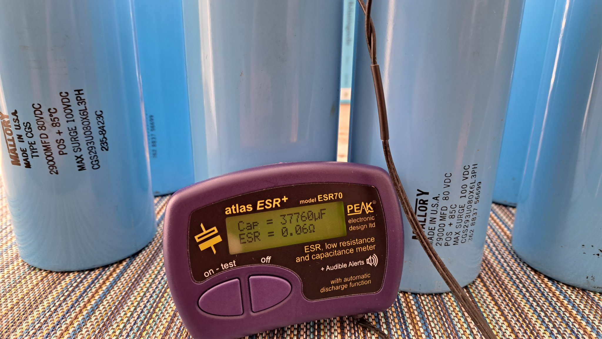

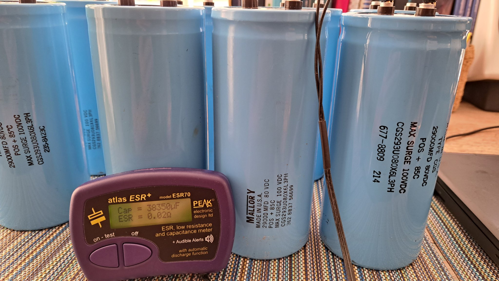

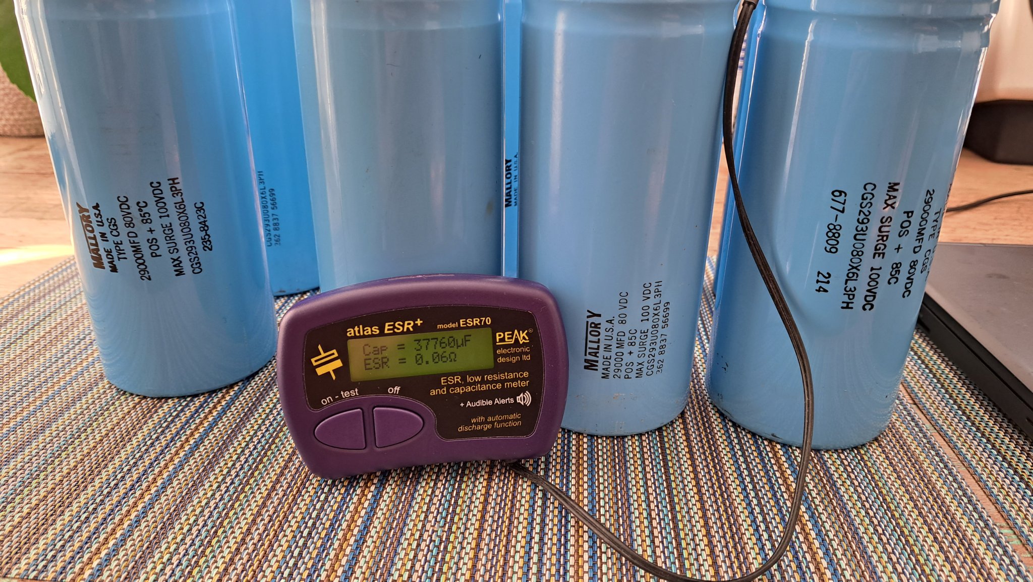

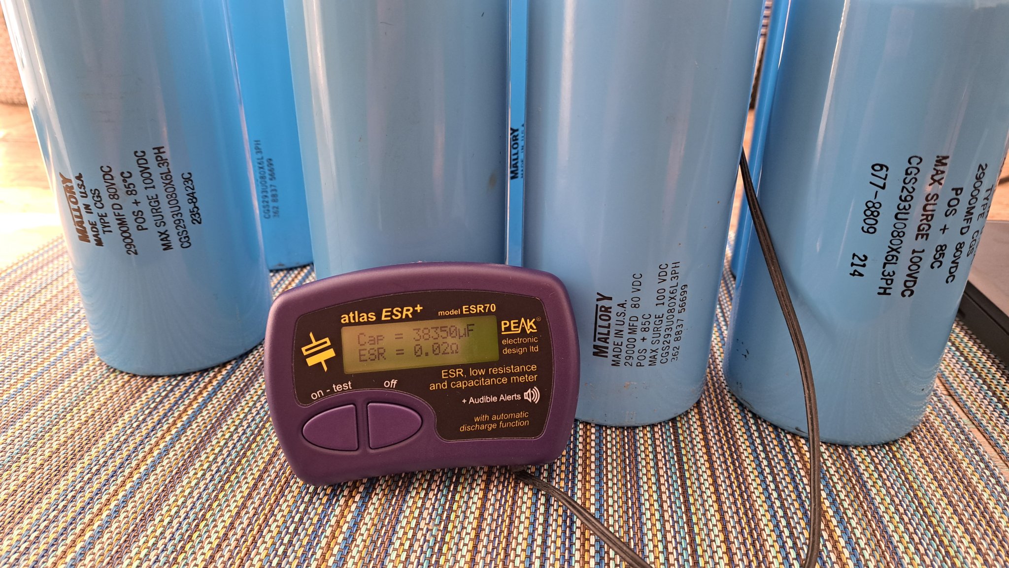

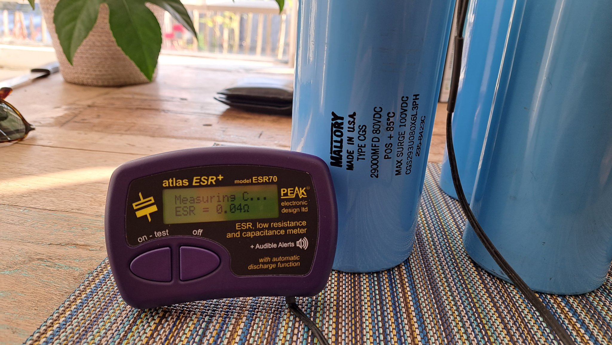

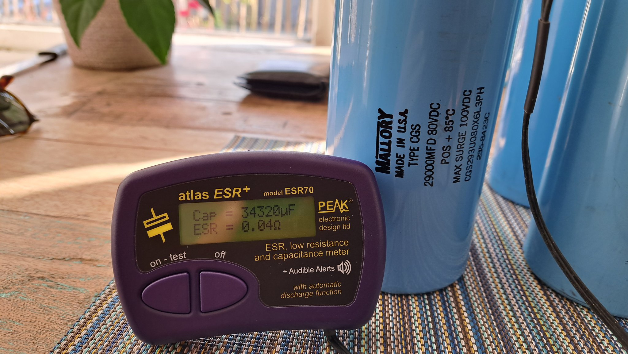

I'm curious, you could compare the values with the datasheet specs. Unfortunetely, the ESR70 upper range is 22.000µF. Don't know about the Mallory's.

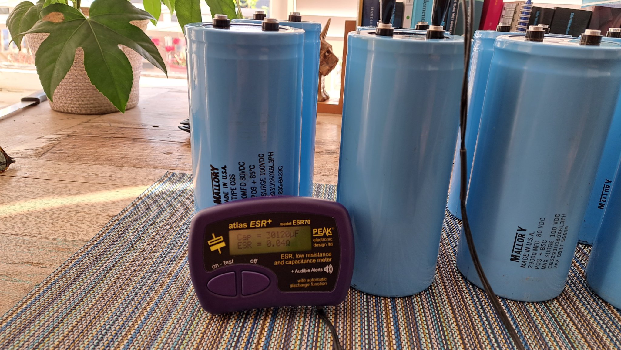

ESR between 0.02 and 0.06 Ohms and Capacity between 30,000uF and 39,000uF
I read somewhere that and the end of life the capacity gets larger and the ESR rises also.
Mallory CGS Series with datecodes from 1988
Thank you.I read somewhere that and the end of life the capacity gets larger and the ESR rises also.
That is mostly correct, capacitance also tends to deminish.
The specs for the new Mallory CGS from roughly the same capacitance and voltage rating are 0.019 ohm at 120Hz.

Still, I would consider these caps as pretty good, taking their age and the hard work they have done in Class A amps into account which I thought the Threshold is.
They are indeed 35 years old and the Threshold SA/1 is a complementary (push pull) amplifier as all Threshold SA series were (and nowadays the XA Pass Labs Series) marketed as a Class A amp for its 8 Ohms rating which is 160 Watts in the case of the SA/1 (SA/2 100 Watts and SA/3 2 x 50 Watts).Still, I would consider these caps as pretty good, taking their age and the hard work they have done in Class A amps into account which I thought the Threshold is
Than I put them back! No, the CGS specsheet says for caps with voltageratings below 150V capacity can be -10% and +75%.Capacity gets lower and ESR rises.

The Mallory pullouts still weighed in pretty much to my idea. The electrolytic fluid will probably evaporate through the safety vent very slowly?Capacity decreases when the capacitor dries out:

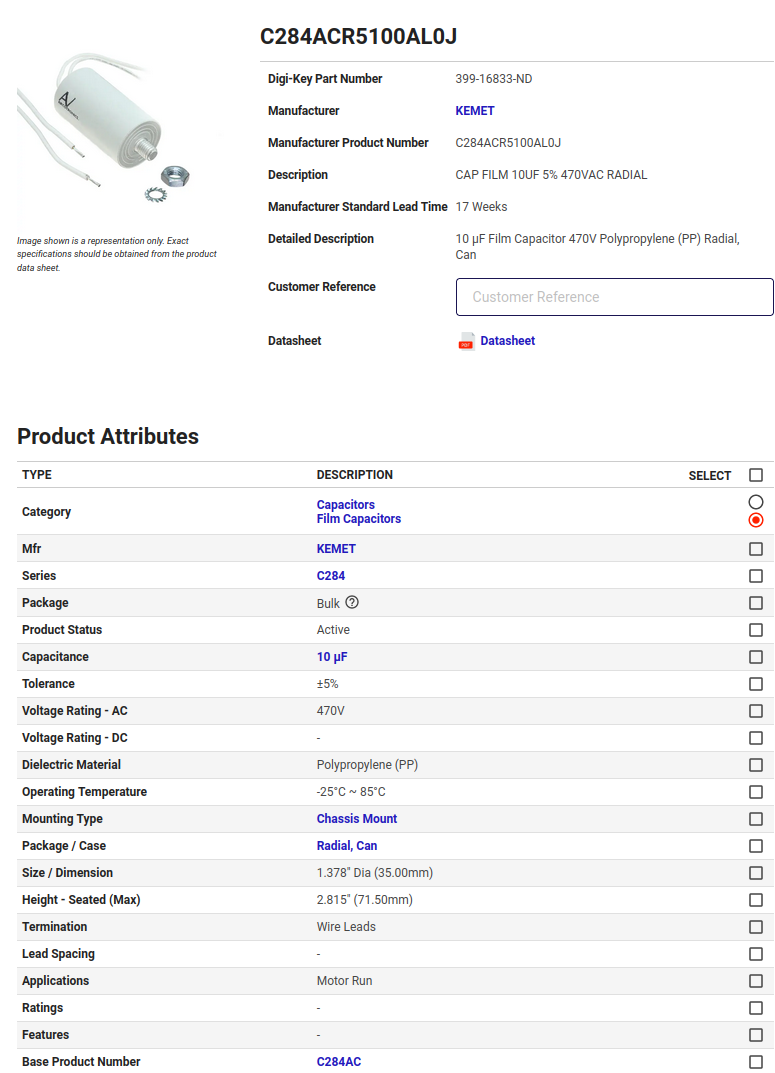

My primary question was if it is opportune to mount solid (film) caps over the electrolytic psu caps.
I feel after all that has been stated that there's no need to buy expensive caps and that if I decide to try it I should use motor run caps like these:

As for the motor run caps: I wouldn't do it but if it makes you feel better,.. 😉
You certainly are correct that expensive caps makes no sense.

Motor run caps or any solid caps?50uF and up, that'll cover your effort
bellow that, use any sissy-sized ones
