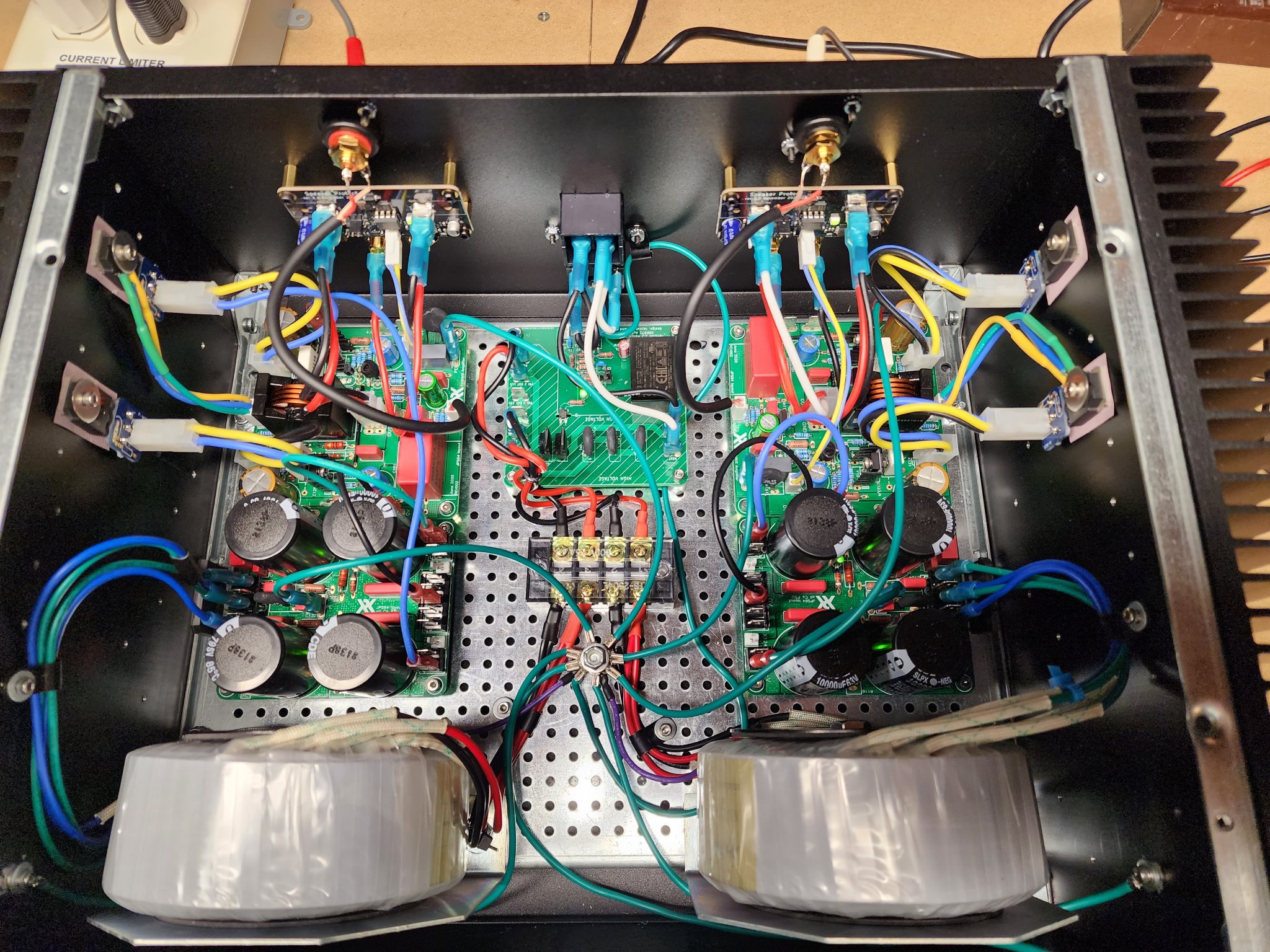

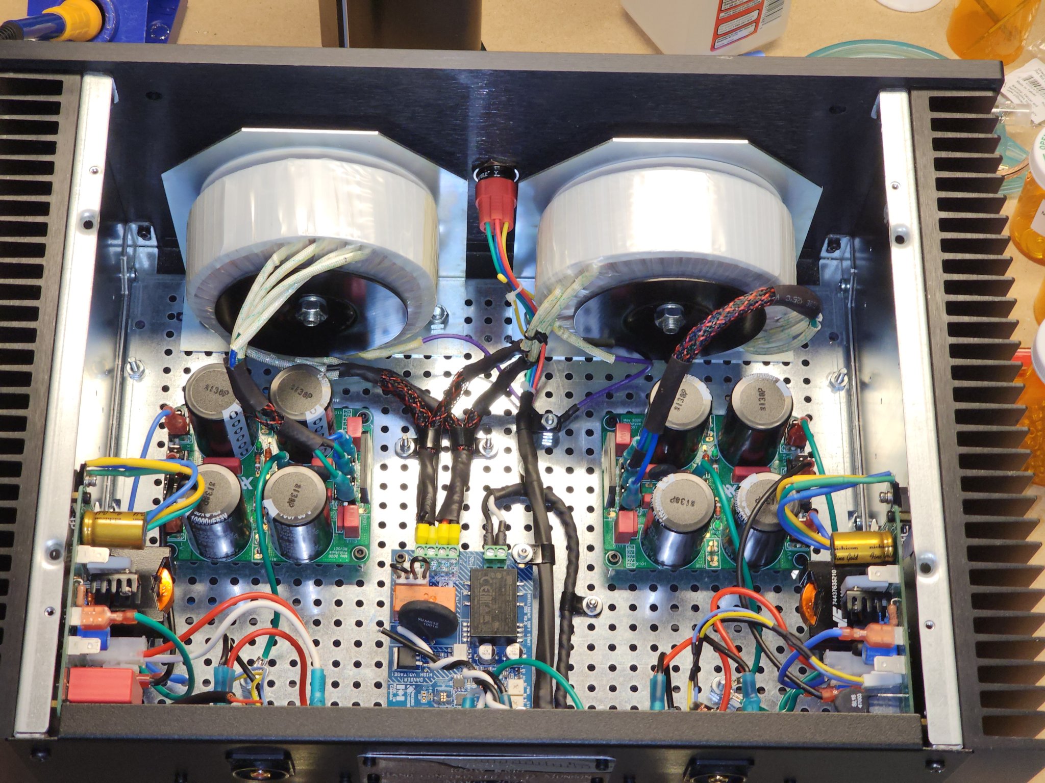

Hello Forum Members,
I've completed rewiring my FH9HVX. I've attached before and after pics.
AC level mains have been confined to the center of the chassis. They have been twisted, covered in heat shrink, and (for the most part) covered in PET braided sheathing.
Amplifier boards were mounted directly to the heat sinks which necessitated new output transistors. In a stroke of luck, I managed to catch Mouser when they had both varieties in stock.
Other wiring was shortened when possible. I used two star grounds, one for each channel.

Gorgeous!
What a huge improvement.
That looks like a few evenings work.
Super tidy wiring is hugely enjoyable imo.
Take your time, listen to something, maybe a bit of your favorite poison on the side. Down right cathartic.

Kelly T, UncleMud,
Did you run 2 IEC ground wires from the mains inlet for the 2 separate star grounds to keep them completely separate?. Hard to tell from the pic's. I also have to redo my wiring at some point to solve hum problems.
Kelly T, UncleMud,
yes that is what I did, I also put the purple shielding wire on the star grounds, I do not know if that is necessary, but I have always set the ground up that way. It is the way 6L6 did it in the Aleph J build guide. I have not built FH9HVX, my build have been limited to a hand-full of class A amps at this point, so I am no expert.

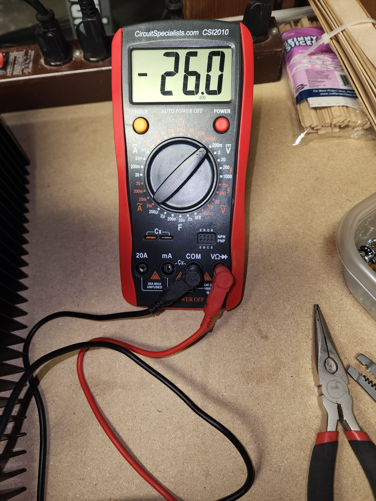

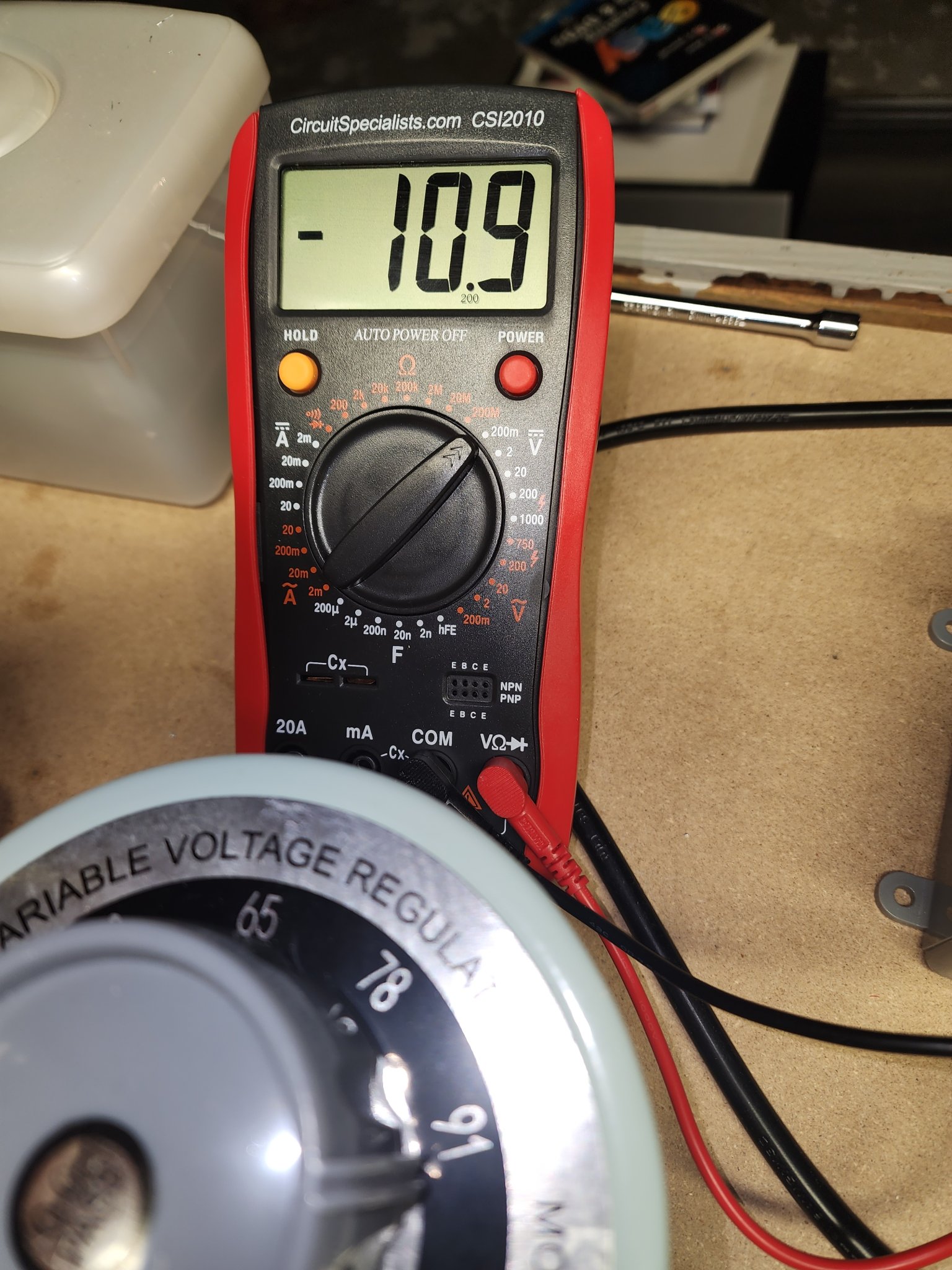

My FH9HVX powered up just fine except for some confusion getting the switch wired to the ISS correctly.
Quick question: The left channel dialed up to 26.0 mV DC with -3.5 mV of offset. However, when I brought the right channel up to -26.0 mV, the offset was -10.9. With the DMM set to the 200 mV scale this should still be well within limits correct? Can I get a thumbs up or down?
(It's quite early in the morning and my mental conversion skills are not fully functioning yet).
I found the answer online folks. Sorry to bother for something so trivial. Next step, speakers.

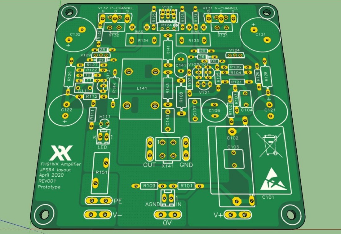

The Alpha Nirvana and FH9HVX PCBs both have options for externally mounted MOSFETs but that’s about all that’s in common. You could use the same MOSFEts and chassis but the PSU voltages are different. The FH9HVX is a wonderful sounding amp and capable of 150w output. Some people need that extra oomph with low sensitivity speakers.I always thought this amplifier PCB is 100% compatible with the Alpha Nirvana or the same. (I have a set of PCB of this amp).
