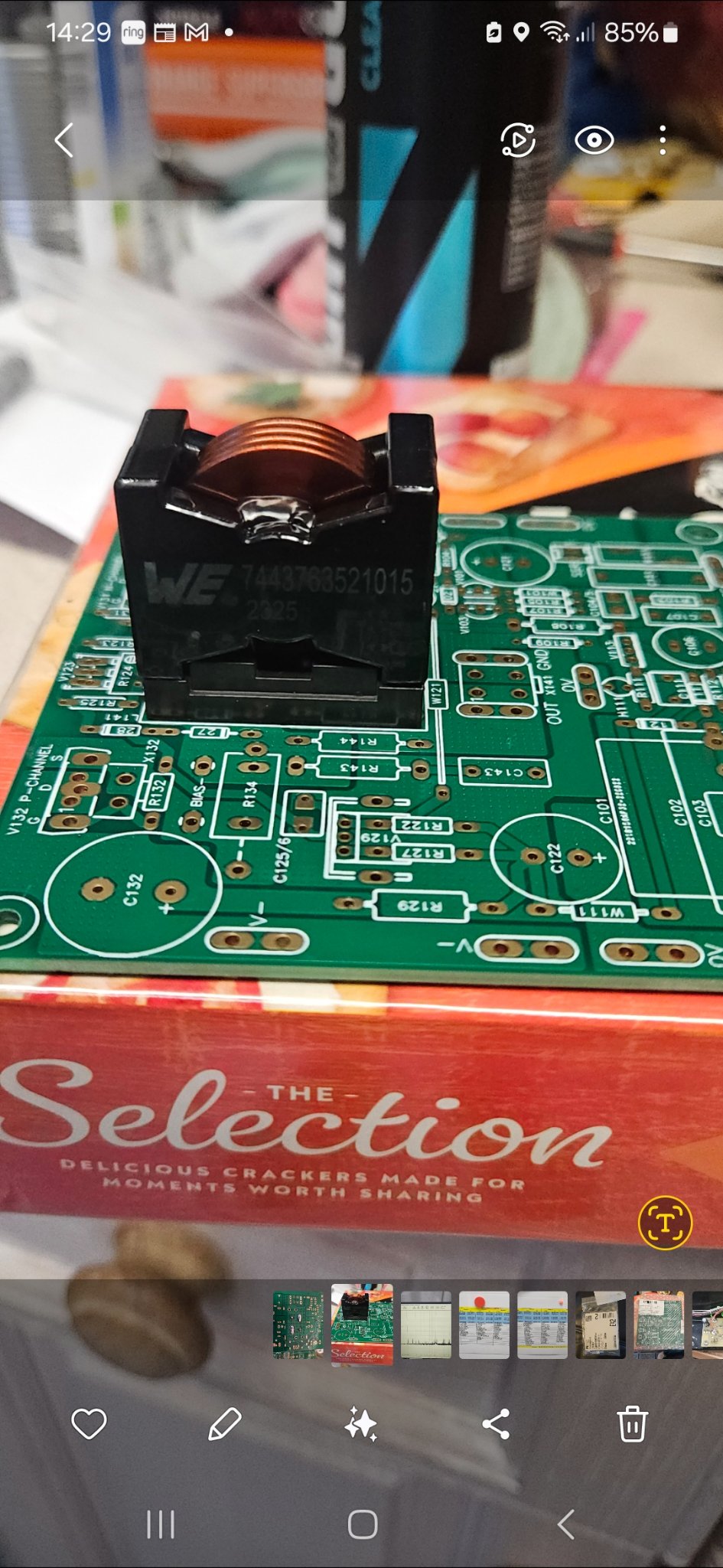

Good luck with your build. It’s a straightforward amp to assemble. Soldering the big inductor on will take a big iron. Preheating the board with a hot air tool will help to slow the solder.

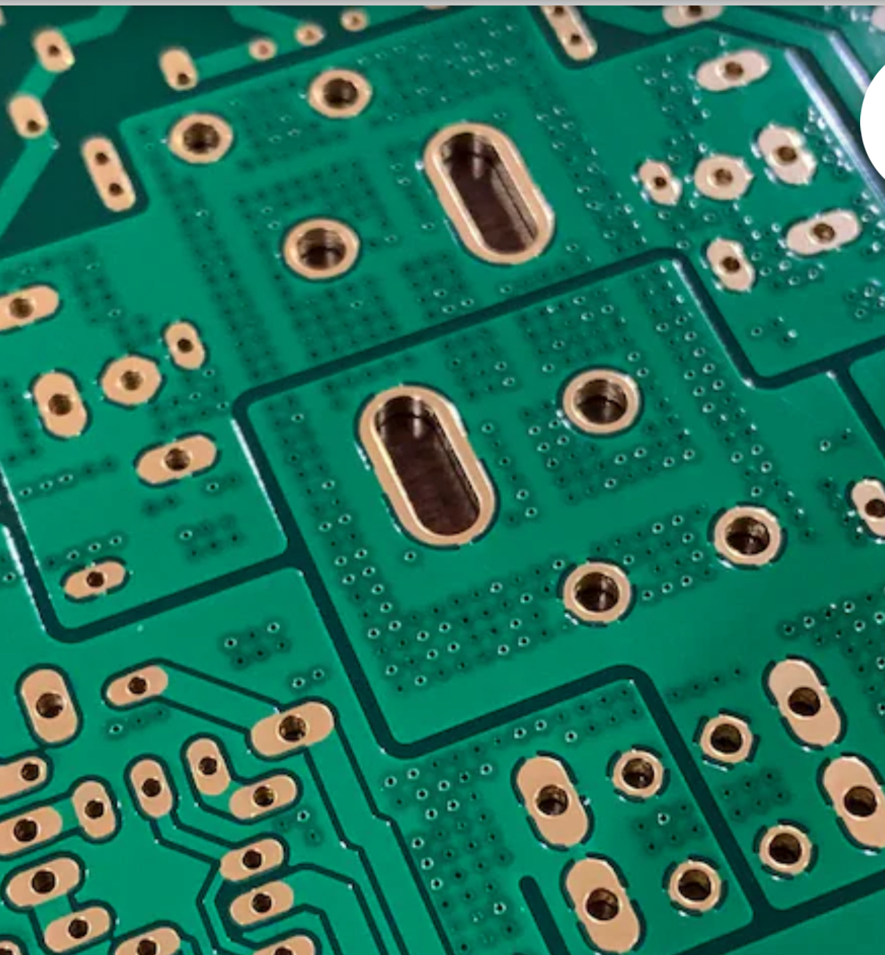

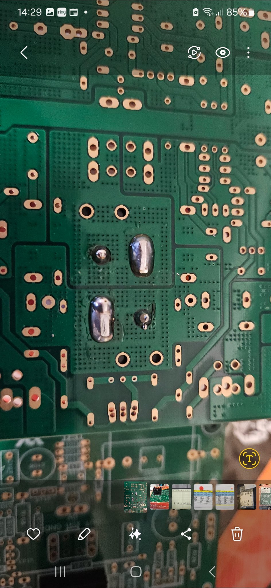

I did try and solder the inductor with a 5mm spade bit on a weller station, successfulish, now waiting on another 5mm bit to attack it with an iron on both sides! On the inductor I take it that the larger rectangle pins are for mounting only?
It’s been a while but I don’t recall extra mounting tabs in the inductor. The flat copper wire was so substantial. But if there are more than 2 solder contacts then the two not connected are extra.
If you look at the layout the two big rectangular slots are the main connections for the Wurth inductor. The smaller pins ones are for home wound round wire inductors (18-16ga 12-15 turns around 0.5in mandrel).
2 of the holes are not connected and for stabilization of wire wound shielded inductor.

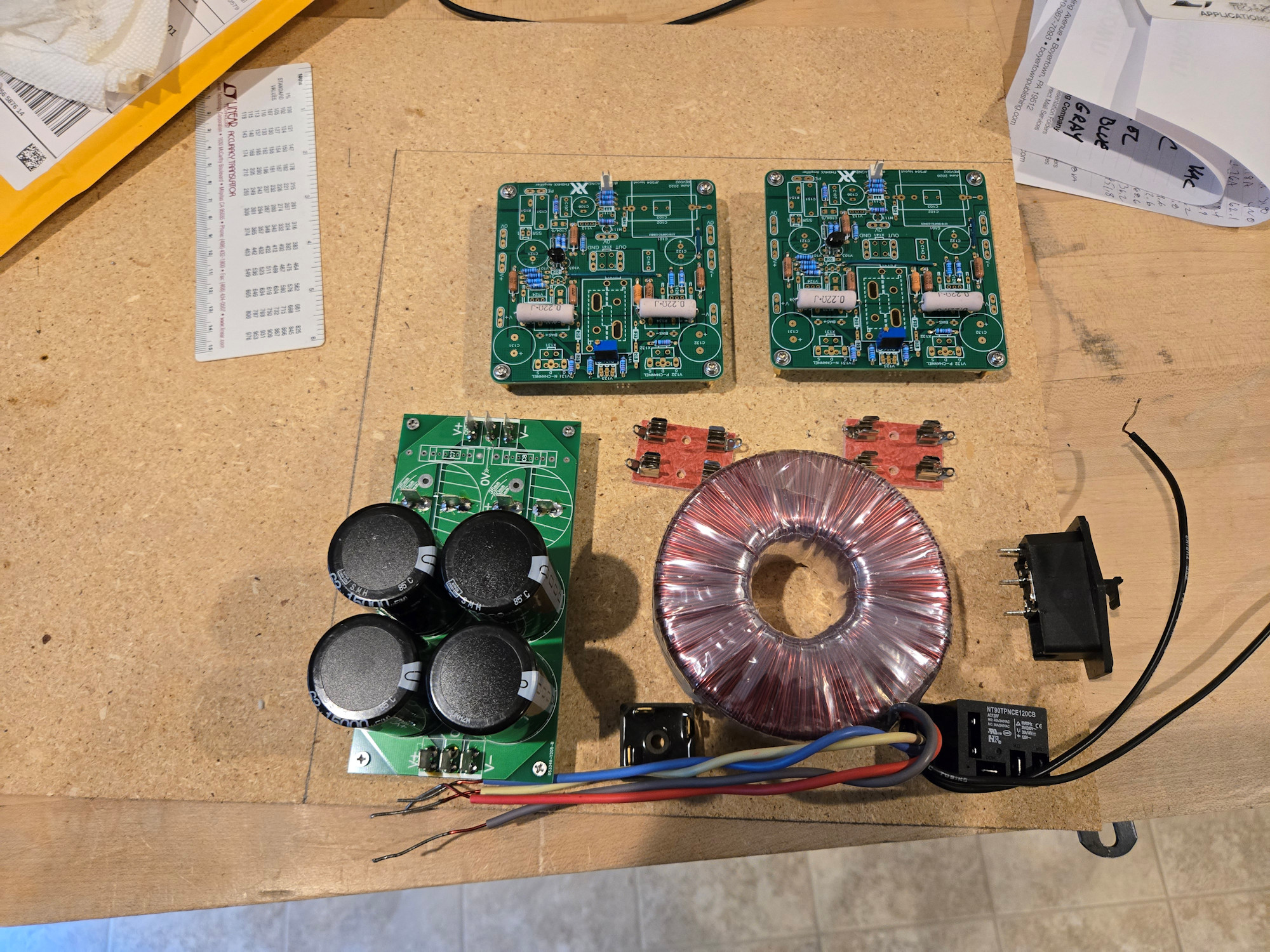

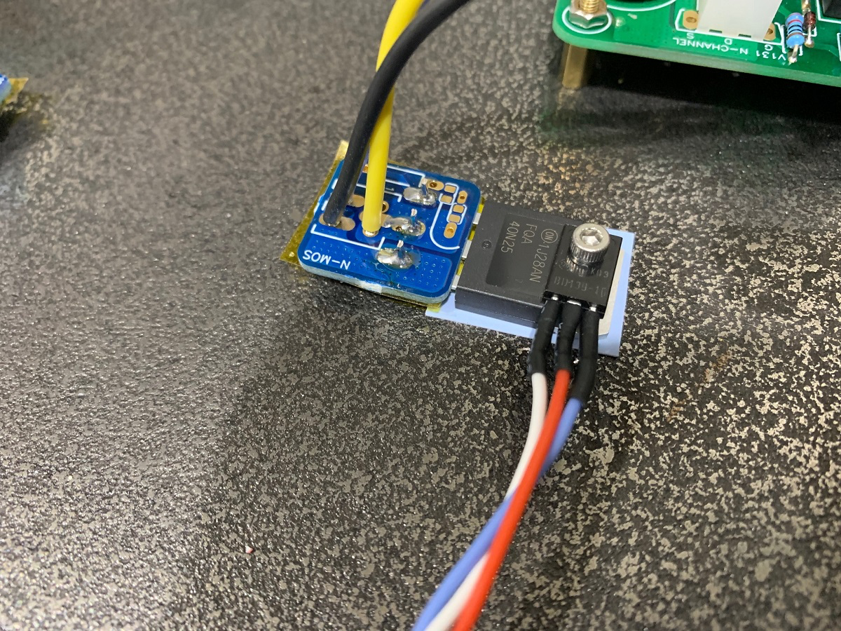

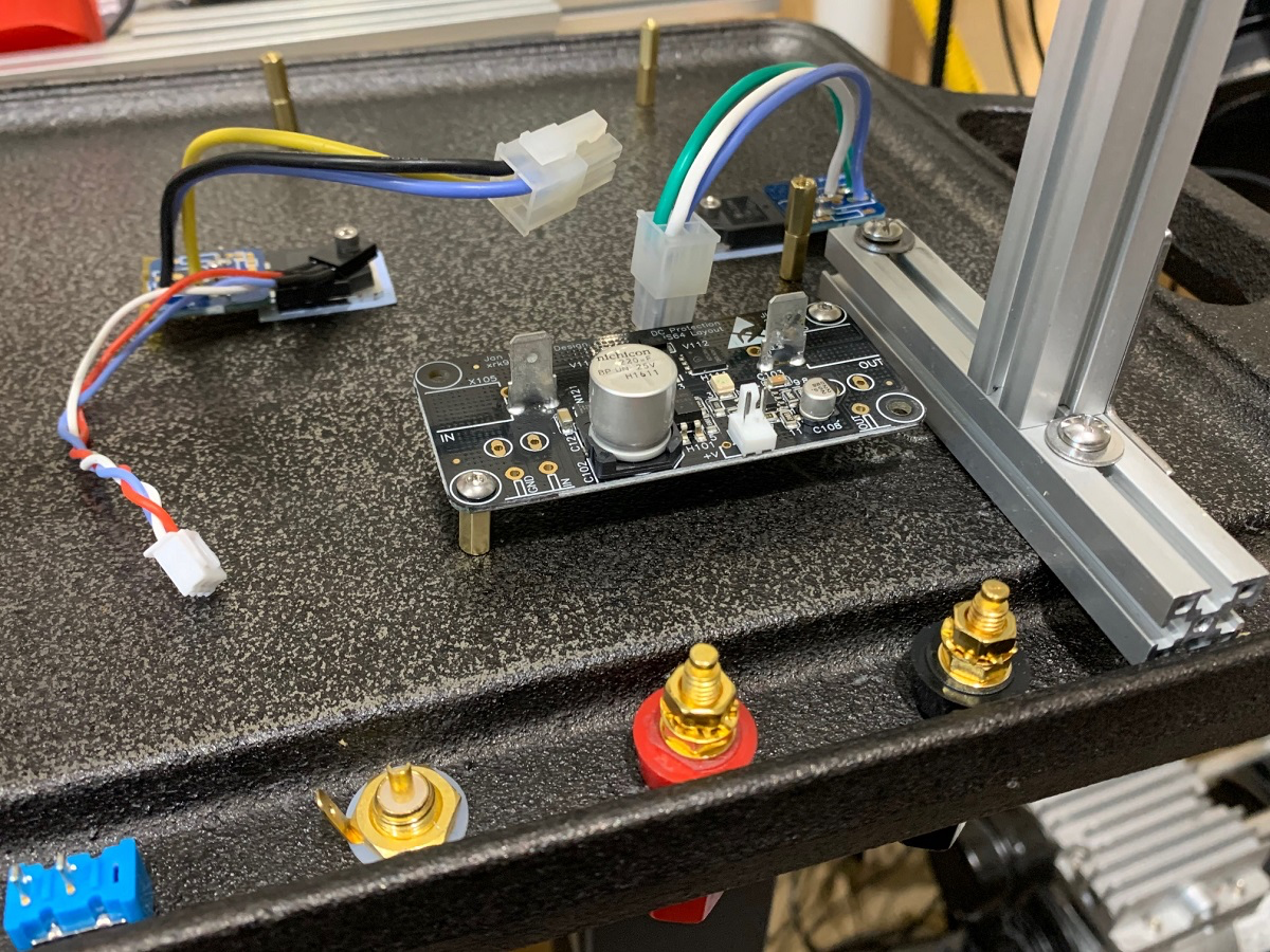

Pretty much assembled the boards now just sorting the molex sockets from the premium bom, just to check the fly wires to the Fets I take it 18awg is OK as that's the limit on the pins linked for the Molex connectors?
Also what wire size for the connector going to V123?
18ga silicone jacket high strand count RC battery wires is what I use.
Double check to make sure you have correct pins on wires. And correct N or P MOSFET installed.
V123 is the temperature compensation transistor. Only small gauge needed. I typically use 28ga silicone wire.

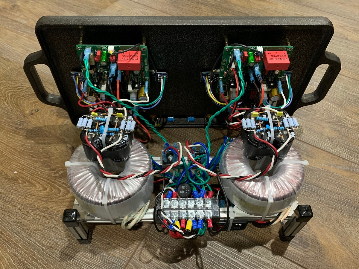

The griddle amp thread has some nice pictures of the FH9HVX build in case you haven’t seen it. Here is how I mounted the MOSFETs and the tempcomp.
Perfect thanks I've ordered some.
That's what I'm building a 'griddle' amp, just wondering looking at your pictures why are you doubling up on the ground wires?
Trying to reduce impedance to chassis ground to reduce EMI noise. Probably not necessary.

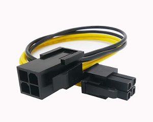

I skipped the crimping part for the flying leads with something like this off the shelf part - you can consider this if you already haven't ordered the crimping tools:
https://www.amazon.com/ZLKSKER-Extension-Desktop-Computer-Connector/dp/B08R36YKPB
Keep the male part and connect the wires on the opposite end to your MOSFETs; there are 4 wires, so you need to cut off the one. And for the remaining 3 wires, you will be left with 2 wires with the same color - so put some different color heat-shrink tubing on it so that you have the MOSFET pins connected properly.

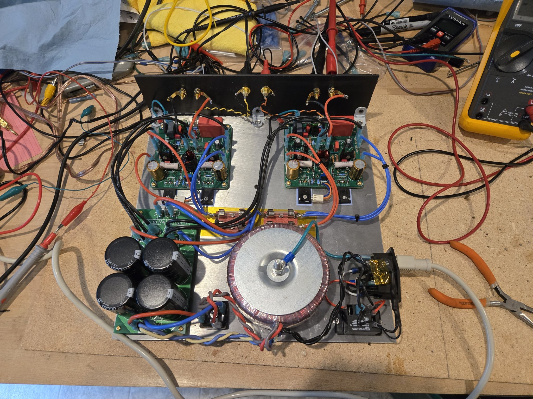

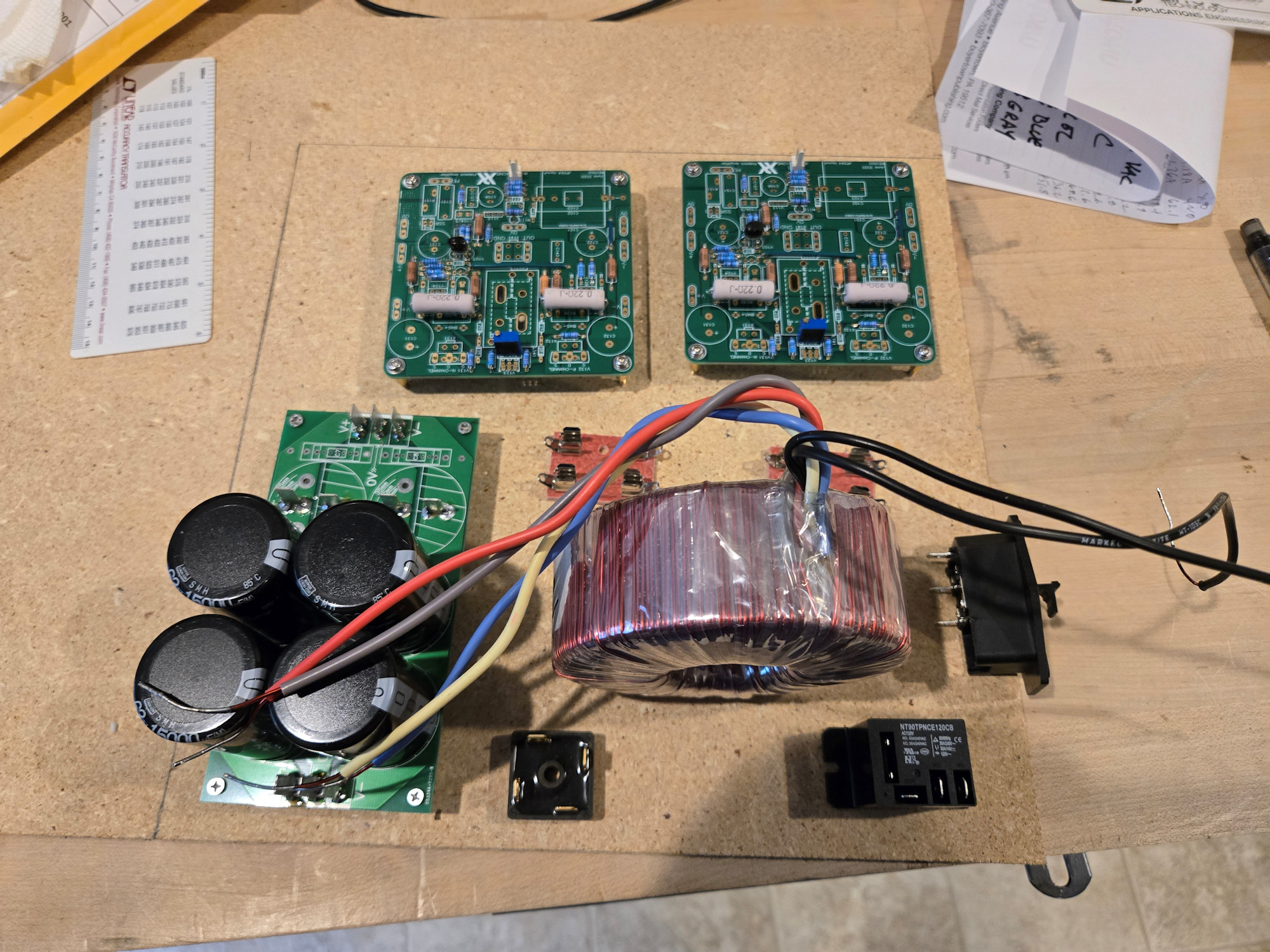

I'm working on the layout of my amp, it's going in a hidden area so I'm just going to build it on a 12 inch by 12 inch aluminum plate, kind of like the griddle amps. A question I have to answer is how to orient the transformer - horizontally or vertically.
Horizontal should allow me to fit on the plate with no problem.
But vertically would allow a bit more room and potentially orient any stray flux away from the PCBs.
Opinions?
Opinions?

Anyway I went with the horizontal transformer orientation. I have 1 channel finished, it checked out perfectly. Dead silent with the input shorted, I actually thought something was disconnected at first. I'm now away on vacation for the next 3 weeks, when I return I'll finish and post pictures and measurements.
Strange, but I didn’t get a notification on this or must have missed it. Regarding orientation, it depends on the overall system and layout. But I often use horizontal because it is the easiest to implement. Glad that it worked out being quiet for you. What is important is to keep the input signal wires far away from the trafo.

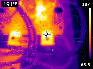

I did some temperature testing, and the results weren't good. There's a much bigger temperature difference between the output FETs and the aluminum plate than I expected. At 10 watts out I was seeing the FETs hit almost 200 degrees F while the plate was barely above room temperature. Look how distinct the temperature line is from the backside of the FET to the plate instead of a gradual fade to ambient. It looks almost like there's no thermal conduction at all!
To the best of my ability to visually observe the plate looks flat and the FET is tight against it. My first suspect is the insulators I got from Amazon since I couldn't find any thermal data on them. So I ordered some silicone elastomer and mica insulators from Mouser to see how they perform.
