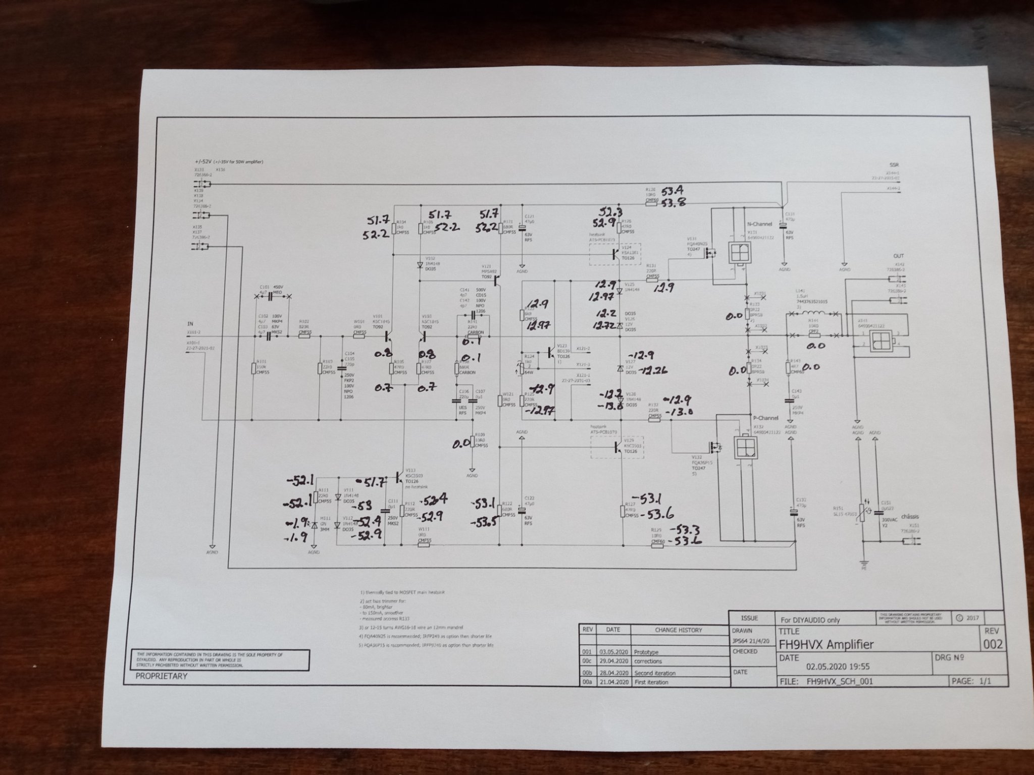

I did some voltage testing on the good and the bad pcb and the readings are fairly close to each other, so I think I can continue and construct with the new transistors. The image below shows the voltage from the good pcb near the top of component and the voltage from the bad pcb near the bottom of component. All measurements are DCV and referenced to ground. Comments and thumbs up to continue appreciated.

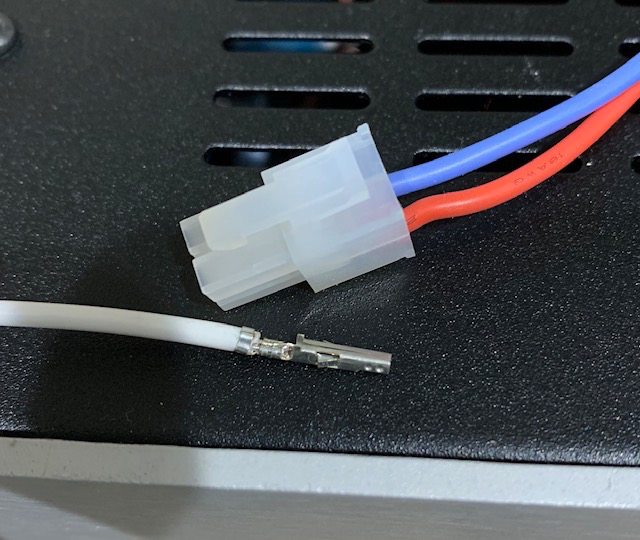

This video is a good explanation but I actually use the gull wing crimp for the wire insulation as well. Just larger. This allows the crimp tabs to reflex and bite into the insulation to hold it from slipping versus pressure alone.
Here is closeup of my crimp job on 18ga silicone wire and Molex MiniFit Jr pins

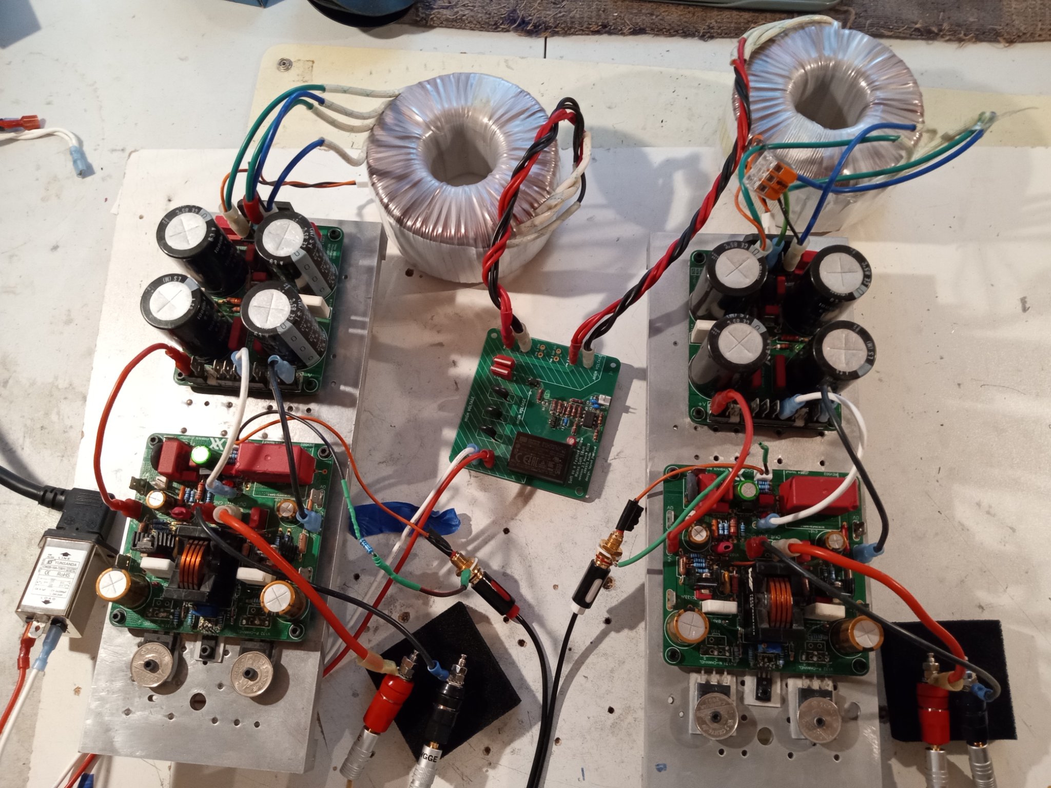

Hello Everyone,
After changing from the flying leads set up and changing the IRFP's to the FQP Fairchild's, I have successfully powered the system and set the preliminary bias and voltage under no load conditions. I took the bias up to 180mA and let it cook for awhile to see if their was any bad effects. Heatsinks and transistor's warmed up nicely. DC offset was about 10mv on each channel.
I then hooked up the inputs and the binding posts. I used my chromebook / Amazon music on battery as my source and powered up into my test speakers. Well, I was greeted with some wonderful sound. I did not play very long, just long enough to get an idea that it works OK. I am happy. I have attached a pic of the test assembly.
