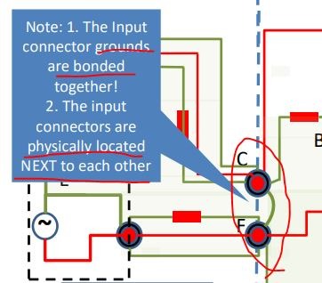

So you made sure the input connector grounds were grounded together and you also used an HBR?.
Did you also use a ground lift mechanism?

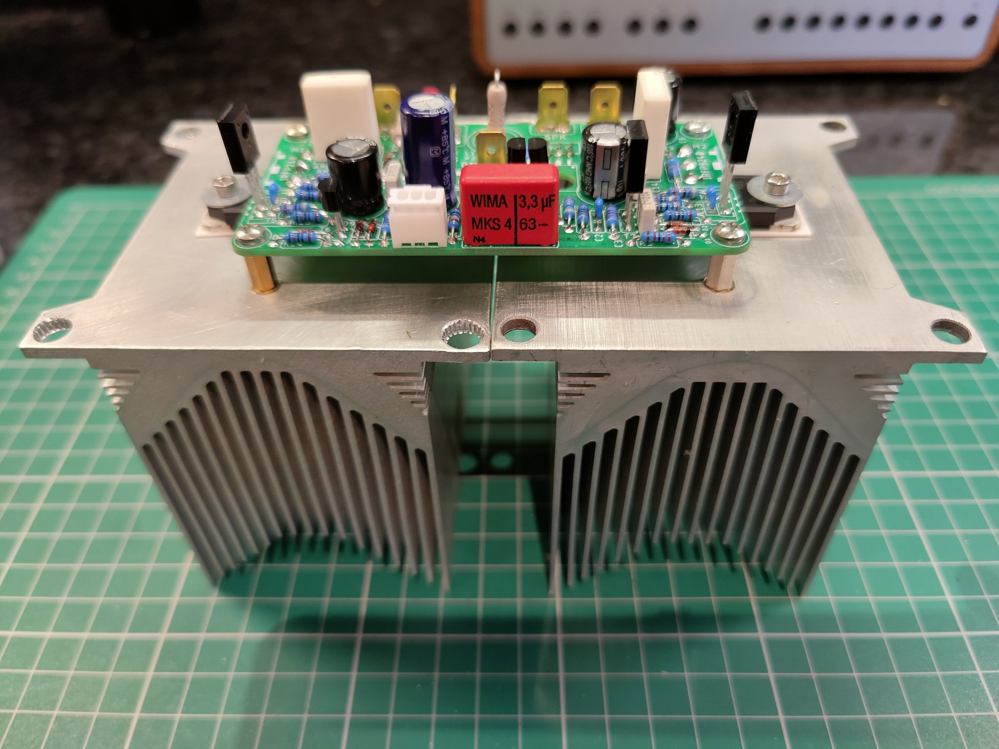

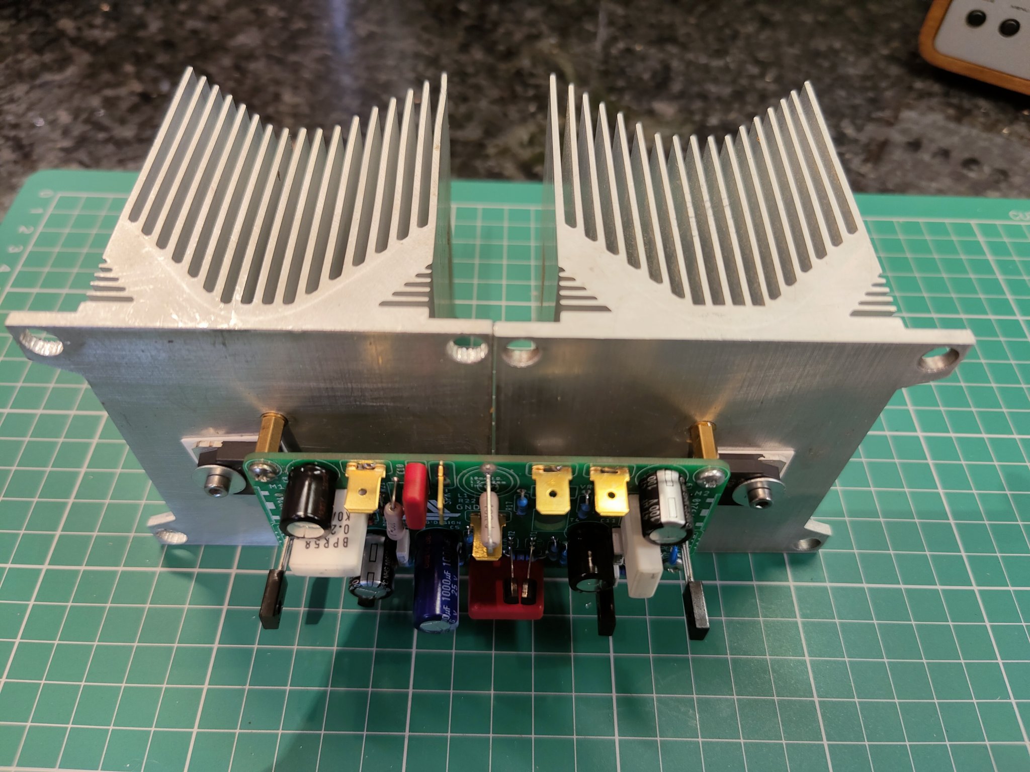

Slowly getting there with my FH9VX. I built the Prasi stereo board a good while ago but decided I couldn't get a satisfactory layout chassis wise, so have built a pair of monos.
Not sure if these sinks will suffice. More aluminium to add to join them together yet.

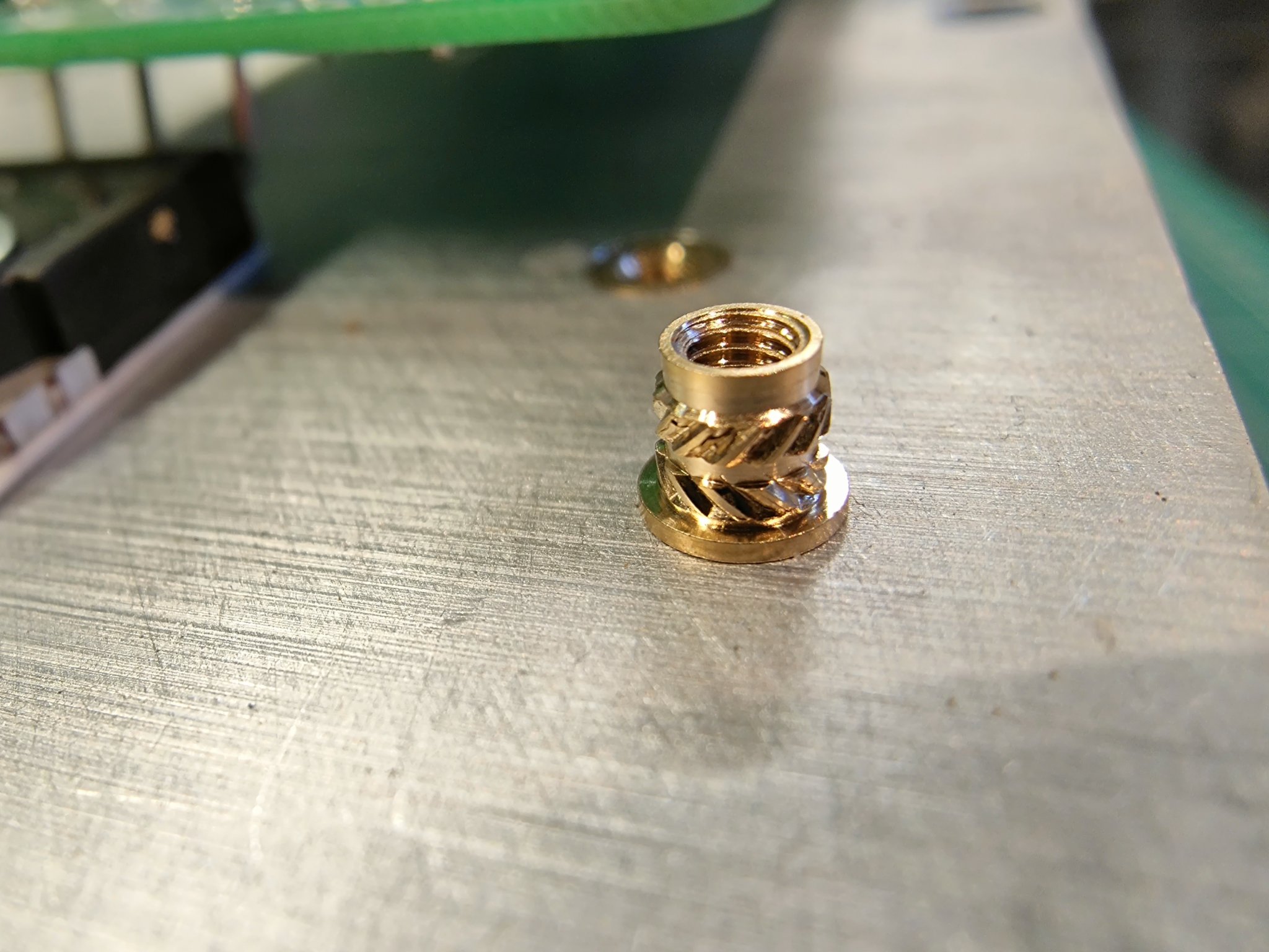

Found these nice little M3 inserts. Good time saver for those that don't like drill and tap. I don't mind that but thought I'd try them. Might be handy for copper CPU coolers. Didn't use them under the output MOSFETs though.

I have used similar Dell CPU cooler on a Class A amp with a fan. For Class AB, it might be enough for low level playing. If running high power maybe add a small fan.
I think those brass inserts are for installing in plastic to give them thread hard mounts. Those ridges on them are for melting into the plastic substrate. I have used them in my 3D printed parts.

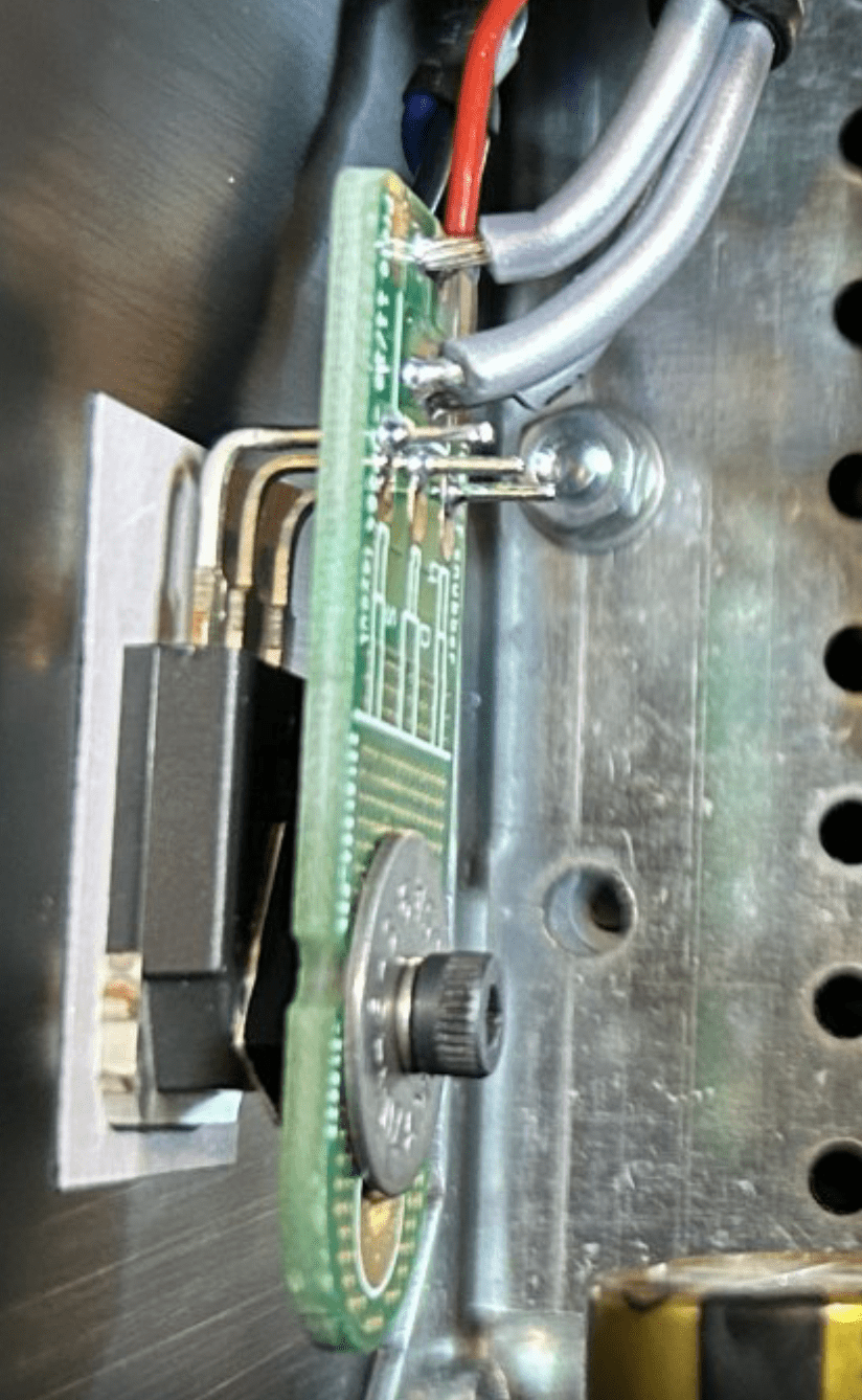

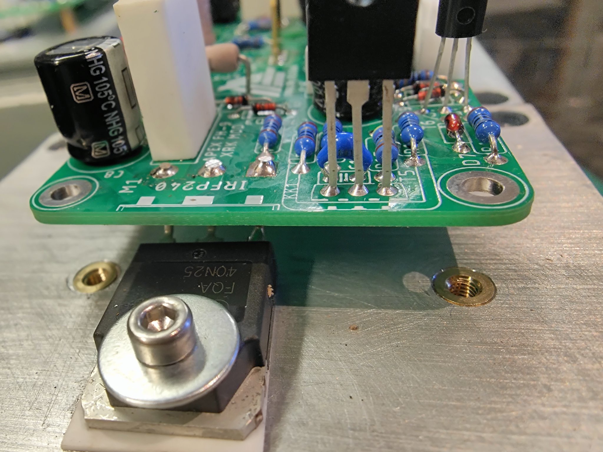

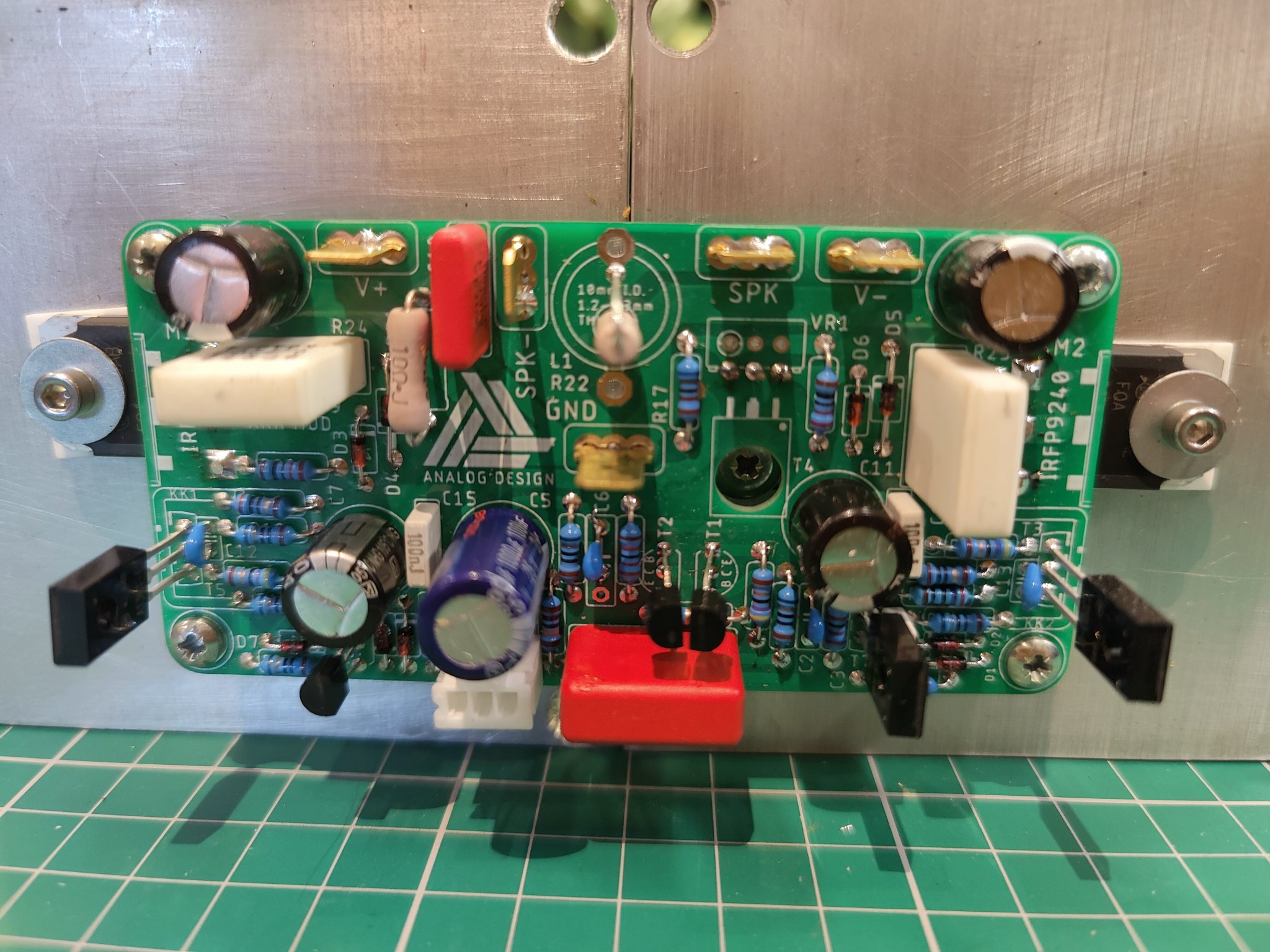

Well that was a torrid few hours. got my PSU nicely built and giving 52.8v or something like that. First channel on test....quite a bit of DC and no current flowing through the output devices and bias won't adjust...hhmm.
After some reading I may have got T4 in backwards. I think I misinterpreted Prasis silkscreen. Swapped that over. Still no dice. Even more DC and still no bias current. Thought id try the other channel and it blew a cap on the neg rail which took at an R in my CRC neg rail. What I didn't realise is it also took both output FQAs. 😫.
Messed some more fixings the PSU and then managed to blow 2 more FQAs on the other channel.
Would not appear to be my day.
Anyone got Prasi single channel boards working?
Sorry I can’t help you there as those are not my boards. The XRK FH9HVX boards have been tested and guaranteed to work if parts properly installed.
When things don’t work, it’s generally MOSFET or BJT N or P mixed up or a resistor is off by 100 or 1000x in value. Or a diode or electrolytic is backwards.
Thanks X yes I appreciate that and understand this is your commercial thread. I found some members have the Prasi boards working fine so it must be me.
I also agree it must be an active in wrong or a diode backwards etc but I spent another unfruitful day removing the dead FQAs. Did some more tests. Replaced with IRFPs, which instantly blew.🙁
So I have had to take a step back from it for now for sanity.! I was pretty thorough in checking all the resistors so I'm a bit at a loss. I'll probably end up populating fresh boards but at the moment I'm not filled with enthusiasm for it!🙂
Jim,
When you have some time, please post what your current board looks like, and also Prasi’s layout of your board if possible. In post 1533, I see that VR1 is not populated and I am not certain if T4 is mounted in the proper orientation. My recommendation is to have T4 mounted directly on a P-channel or N-channel MOSFET. For reference, I mounted my BD139 transistor directly on the N-channel Mosfet for accurate thermal tracking.
