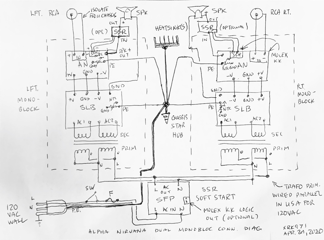

I was going to ask you if you tried using nylon standoffs on the SSR speaker relay protects. A ground short from analog 0v clean ground to chassis dirty ground will cause hum.
The fact that connecting both of the RCA grounds causes hum indicates a signal ground loop.
Look at the wiring diagram on my Alpha Nirvana. See if you have significant changes. There is probably a difference in the SSR PSU section.
Thanks X, giving your diagram a study, I have what I believe are only three minor differences.
- My RCA jack shields are tied together
- 10nF ceramic cap from each RCA shield directly chassis
- My SSR boards are powered by low cap PSU's, low cap PSU's are powered via trafo secondaries, so definitely a difference in SSR PSU, I like the low cap PSU's ability to prevent turn off thumps

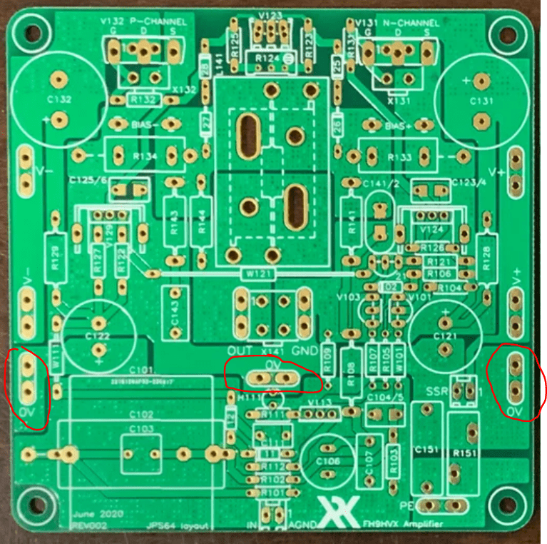

@namghiwook
The three (0)V pinouts are there for convenience. They all serve the same purpose.

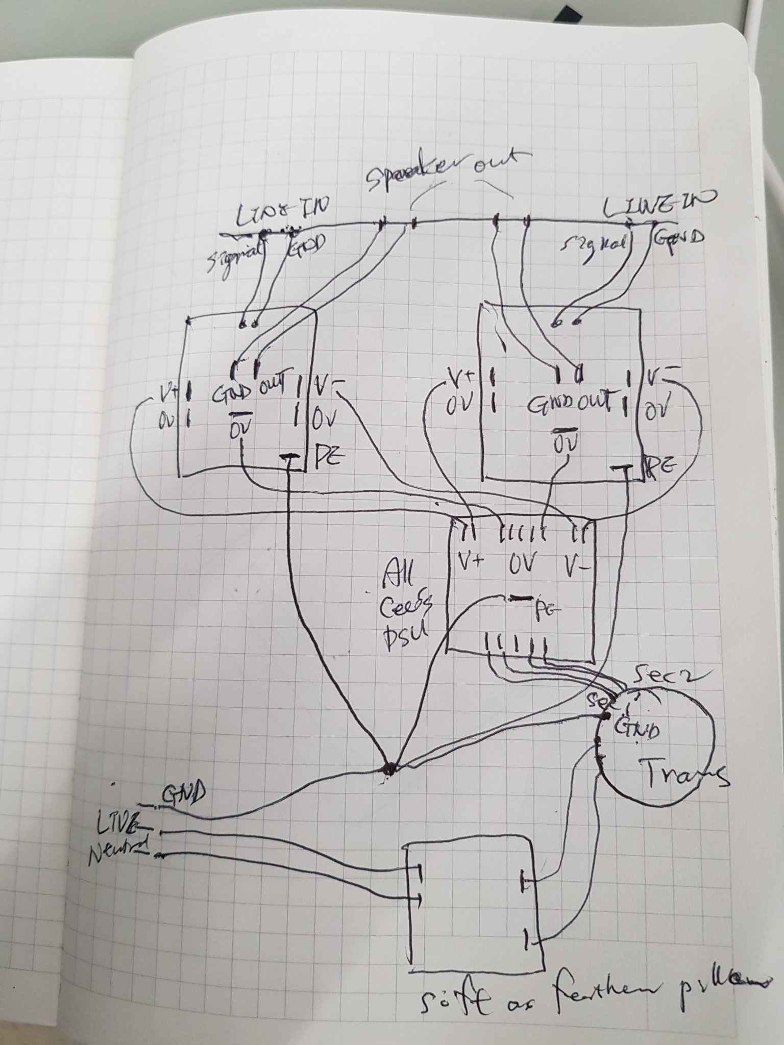

Anand has good suggestions. Look for inadvertent connections between 0v and dirty chassis ground without a ground loop breaker (NTC etc).I like sound of this amp.
But I'm experiencing some hum.
The wiring of my amp is attached.
When both channel line-ins connected (either from a mobile phone or a preamp), hum occurs.
When only one channel line-in connected, hum doesn't occurs.
Are your RCA jacks 0v insulated from chassis ground? Some don’t have plastic insulator bushing.
Is your speaker output -ve insulated from chassis ground? Try connecting speaker binding post -ve directly to PSU CRC 0v tabs.
Use small dia coax (RG-174 for example) for connections between RCA jacks and input connector on amp PCB.
Try adding ground strap between 0v GND of RCA jack to each other.
Next, try connecting RCA 0v to PSU 0v. This can be defined as the star hub for 0v analog ground.
There is a ground loop between the two amp boards through the ground of the RCA connectors.
The trick is to break that loop. You might even resort to not connecting one of the RCA shields to the amp. Just leave one channel 0v from RCA unconnected.

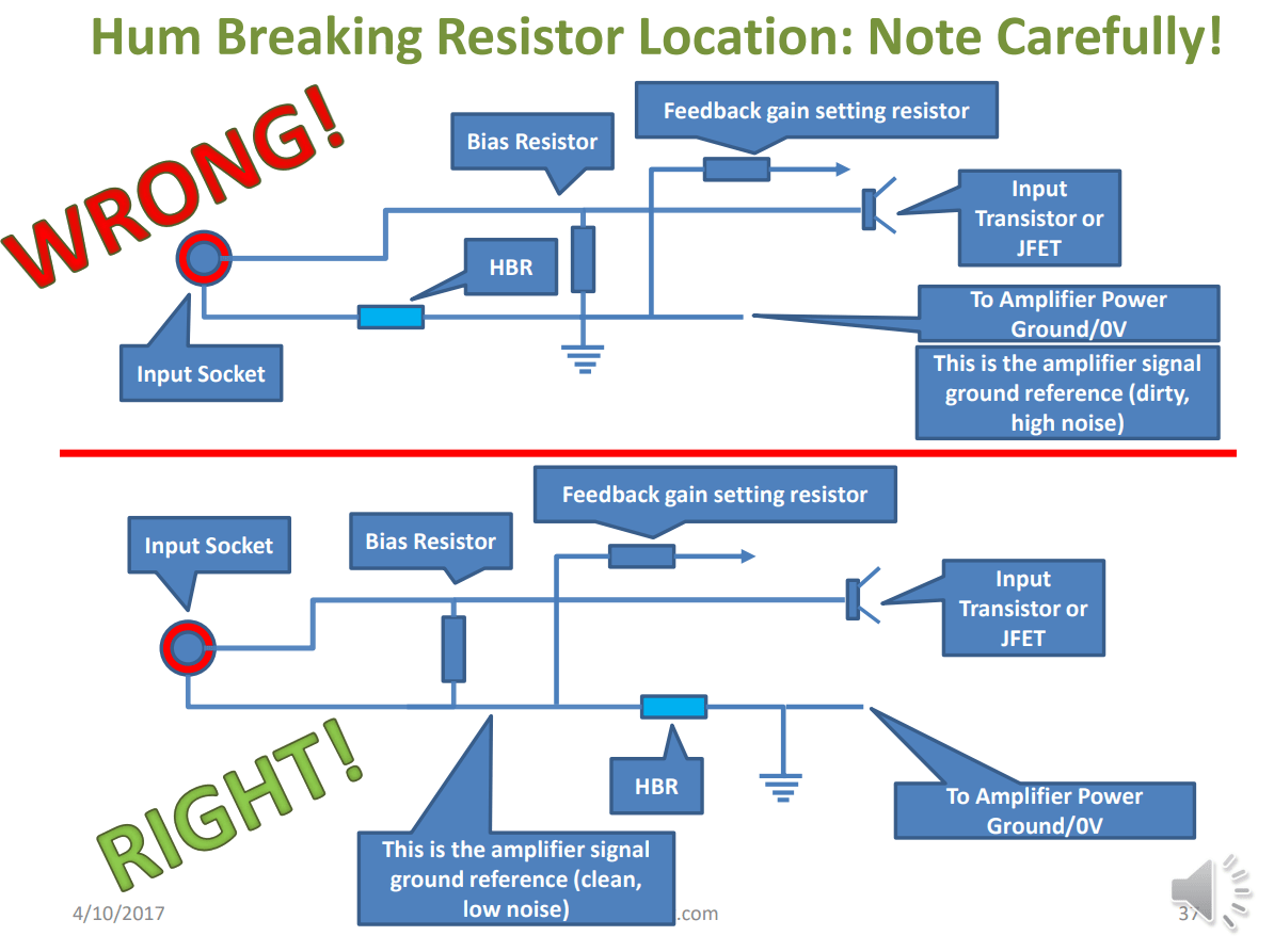

Did you ever resolve your hum issue?The pdf (How to wire a audio amplifier.pdf) shows HBR (hum breaking resistor) location.
It seems that it does not recommend the way of placing a resister between ground of RCA and input ground of amp board.
I have often found the most common source is a ground loop formed by the common ground (shield) of the source (RCA). It allows a ground loop to flow between the two (previously isolated) mono blocks and the common ground of the source (DAC or preamp). It’s like one needs monoblock preamps and DACs as well. Or… use balanced output DACs and preamps and a galvanically isolated input buffer.
One way to eliminate this is to use a DAC or preamp with a galvanically isolated power supply. That is, the 0v reference of the DAC or preamp is floating relative to the mains protective earth. You can do this with a battery powered device, or an isolated transformer powered device (PE not connected to 0v), or a device with an isolated DC/DC power supply.
The BTSB buffers / preamps that I have on my shop use 5kV rated electrically isolated DC/DC power supplies. They can be powered from a 12v wall wart - which is then isolated from the buffer 0v. The BTSB is now a floating device and poses no ground loop threat. Furthermore, if you use the balanced input of the BTSB from a balanced DAC, then use the single ended output of the BTSB to the FH9HVX, you are essentially breaking up any possible ground loop issue in the most common source of ground loop hum for an amp.
I think Anand (@poseidonsvoice) uses a BTSB with his implementation. It’s not a bad idea because it makes the amp very flexible with respect to any inputs (balanced or single ended) and numerous gains (0/6/14/20dB) or custom value is possible - as Anand used on his.
Without using a BTSB, really the only way to unconditionally eliminate input source common shield ground loop is to use passive signal transformers. Those can be pricey and add their own signature to the sound. Typically third harmonic dominant.
