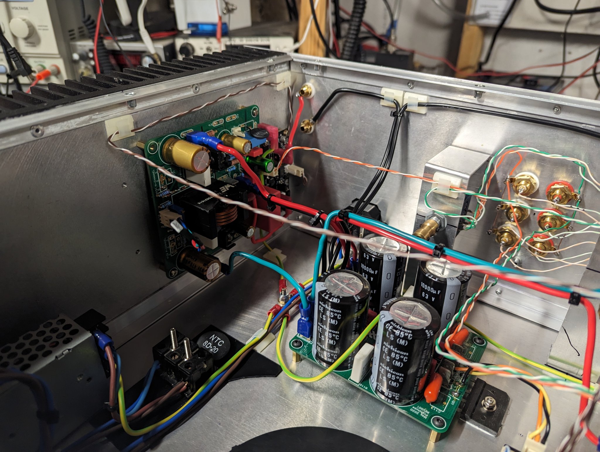

Settled in at 44mV nicely. 1.5mv DC offset.
Man, this Amp combined with the FAST TL speakers is a potent setup. it PUMPS!

Nice setup! I have said this before: if the FH9HVX and the FAST TL’s were the only amp and speakers that I have from here on out, I would be perfectly happy and not need to keep looking. Enjoy your setup and have fun listening to your music collection.
You also got a RPi zero in that build with a DAC hat cool 😎Hi.

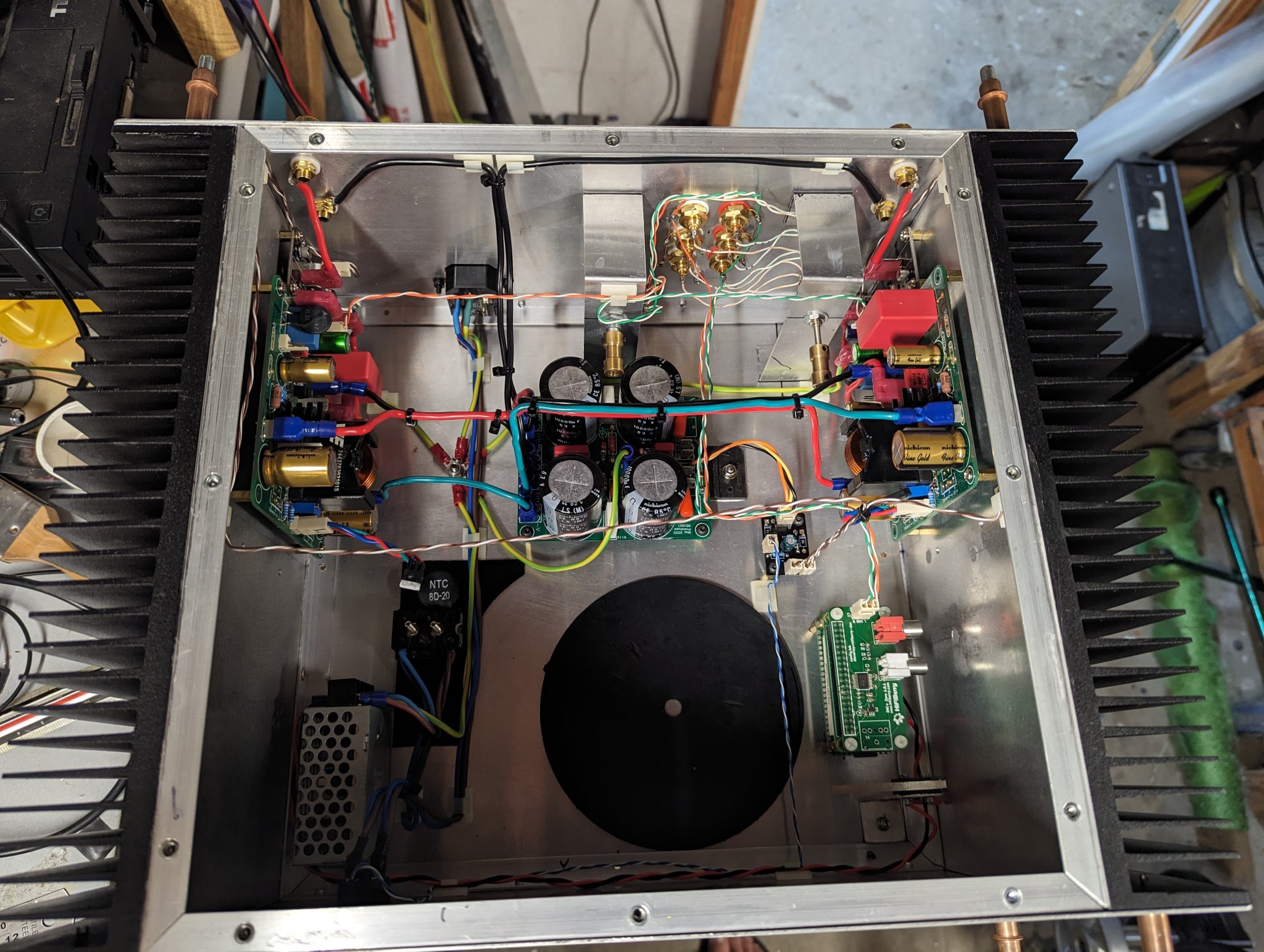

Almost done the new chassis with big heatsinks l, just waiting on thermal pads then I can mount the new FETs..

Hi,.
Yes to the pPI/HiFiBerry running Spotify Connect. It's better than Bluetooth as multiple people can connect, and isn't locked to one family members device... I have a super capacitor and voltage sensing to enable safe shutdown on amp power off. Also there is a cam and microswitch on the input selector to only power the Pi when it's input is selected.

@nikpolini cool choice. I am using a 7” screen attached with a Hifi berry DAC + ADC pro. Connected to ri4. - I have to make a new case for it.

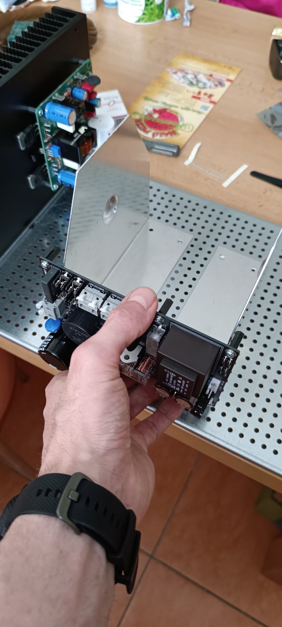

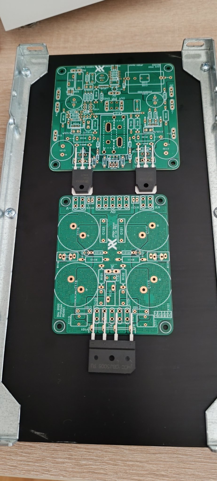

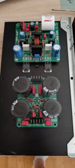

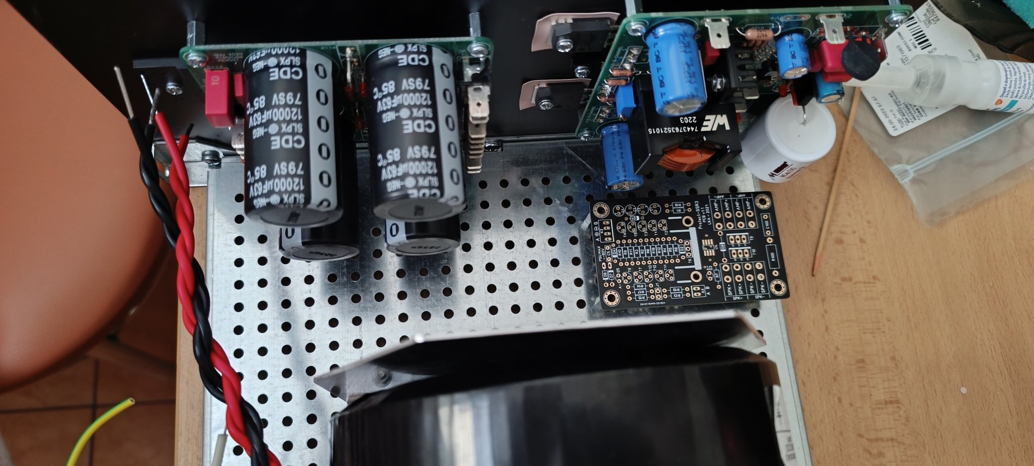

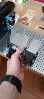

Now I've made the layout the way I want it, and it's going to be to millimeters so I can fit the toroidal transformers (2x 500W) side by side standing up. It will be in a 4U box 300mm long. Tomorrow I will drill the holes for the FH9HVX board and cut the threads. 🙂
Friends, a little progress, ...
On Friday I managed to complete FH9HVX as well as All Cee's (Vishay BC, Audio Note, Mundorf & 4x12.000uF CDE) I managed to mount the FH9HVX on the heat sink over the weekend.
Next I played around with the layout in the box, the best solution I came up with was this: toroidal transformers facing each other and the softstart pcb will be placed on an extra subpanel in front of the transformers.

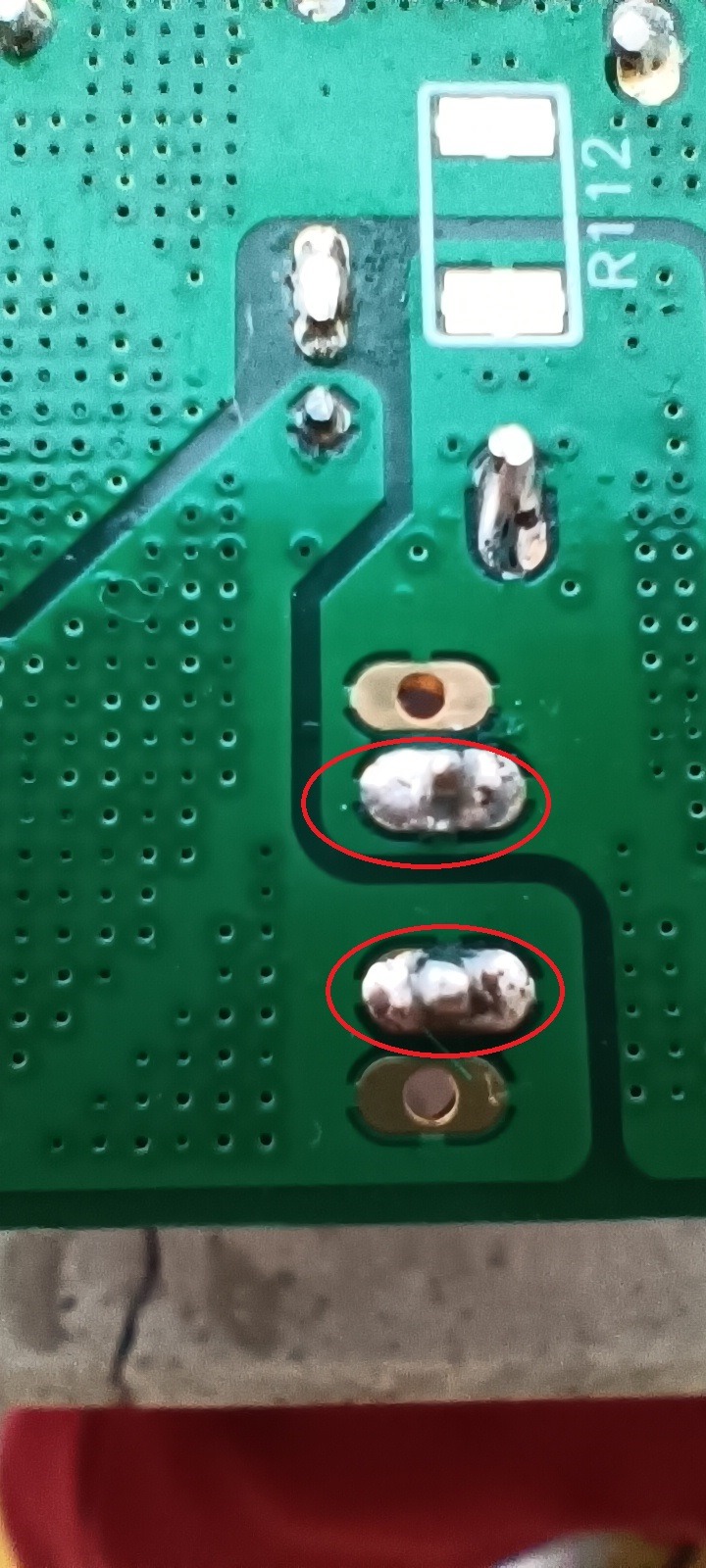

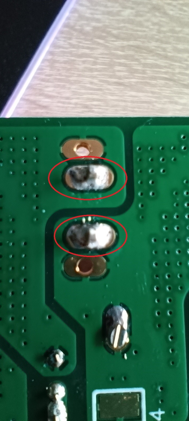

Friends, I have 1channel ready, I wanted to start setting up the bias, but my power supply is not working. I used faston jumpers (CC) and found a board fault in the negative power supply. The negative power supply did not work for me, ...
Hi HRDSTL,
Sorry about that - that’s a known error of an orphaned pad. Please connect with solder bridge. Scrape away solder mask around the orphaned pads and apply solder to bridge.
https://www.diyaudio.com/community/threads/all-cees-psu-for-class-ab-amp.358478/post-6476101
