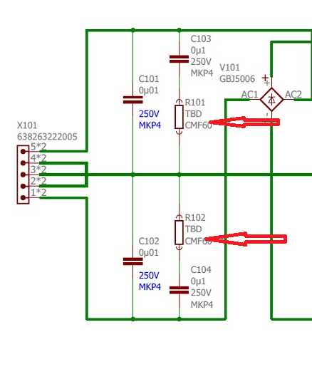

R101/R102 values are measured using the specific transformer for the build with the Quasimodo Jig and oscilloscope. If this cannot be done, just omit snubber components.

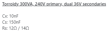

Find the three transformers in the vast table of Quasimodo Results (ONLY), which resemble your transformer most closely. Similar weight, similar physical size, similar VA rating, exact same construction method (EI / Toroidal / RCore / FlatPack / Talema sealed). Take the geometric mean of their Rsnub values. Done! You'll get a pretty good amount of resonance damping, which is immensely preferable compared to no damping at all.
Geometric mean of three numbers A, B, C = (A * B * C)^(1/3) . . . . . the cube root of the product of A, B, and C.

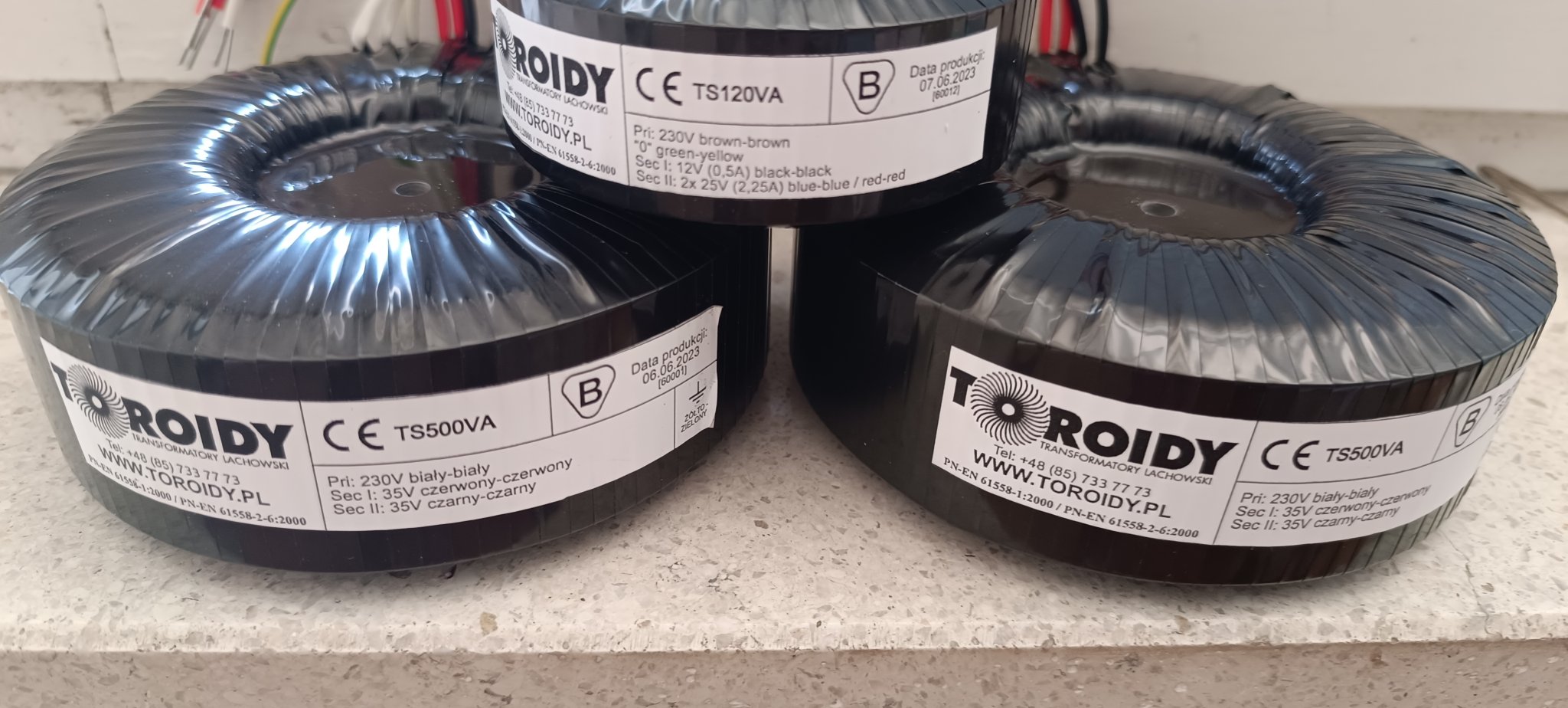

I found a toroid similar to mine
My toroid parameters:
Torroidy 500VA, 230V primary, dual 35V seccondarries. Now I don't know if I can use an approximate RS value, or if the transformer power also plays a role.
As I live close to a transformer station the mains voltage is 237V AC. That's why I ordered transformers for 35V, at the output I will have approximately 39.5V AC. After rectifying the voltage, I get somewhere in the range of 52 - 53V DC with a sufficiently hard source 4x12.000uF/63V - per channel.

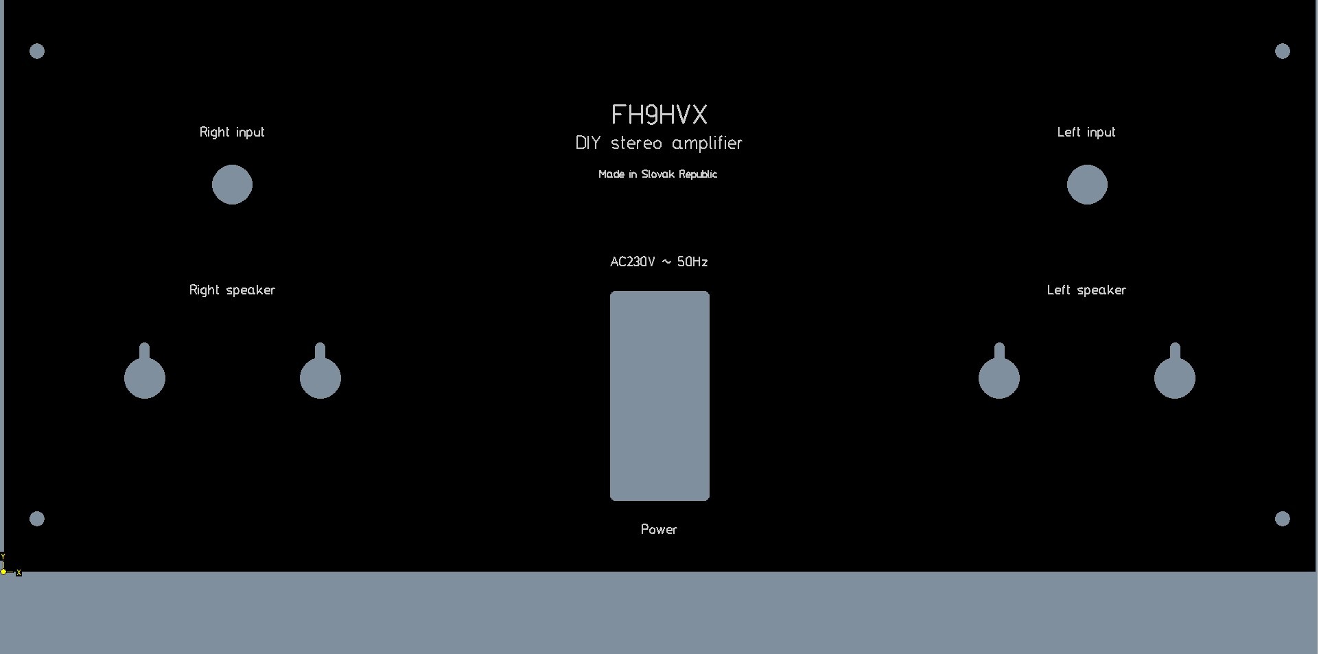

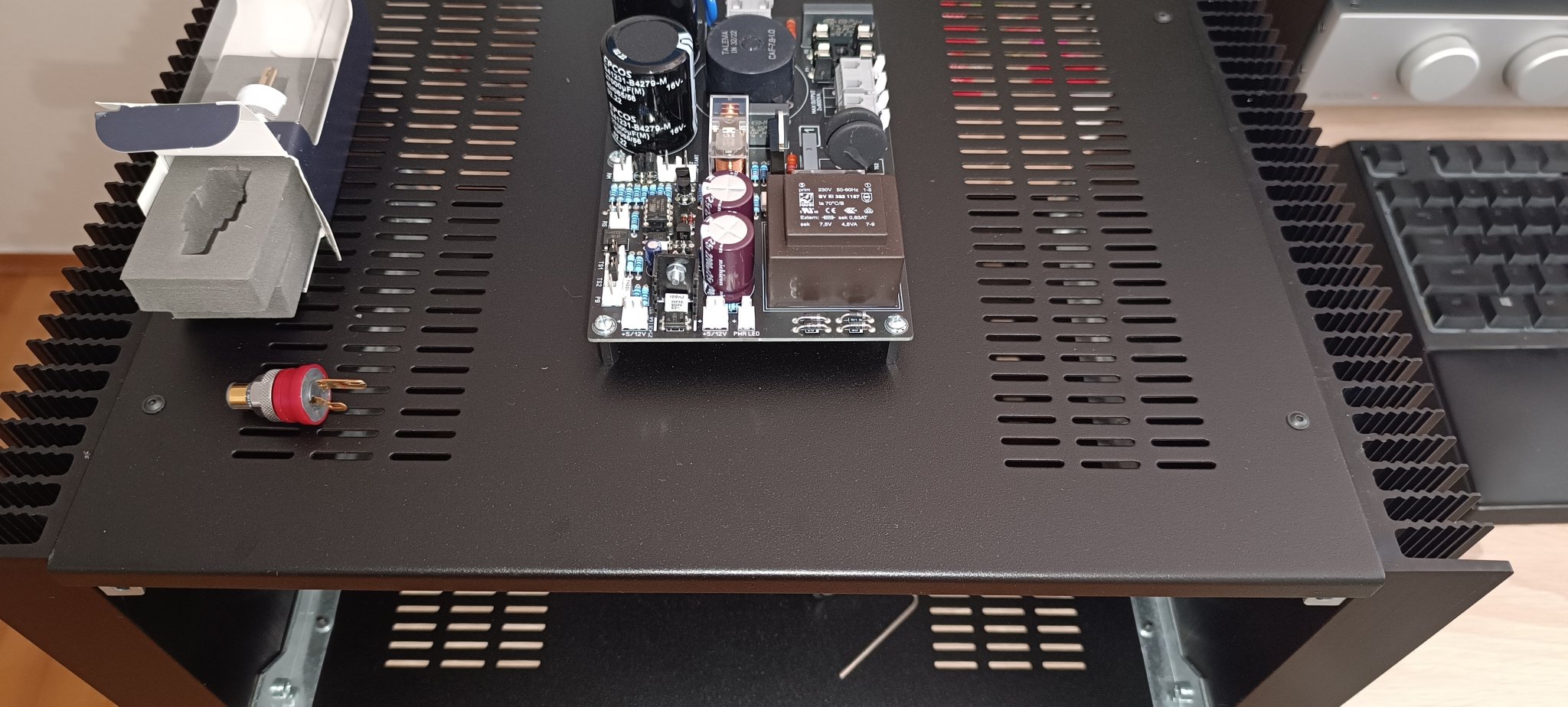

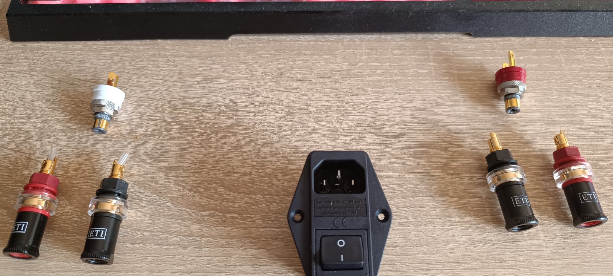

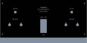

The toroids arrived today, the smaller one for Nelson Pass HPA-1. I am waiting for subpanel for 4U modushop box and L bracket for toroids. When the pcb for the power supply and the FH9HVX arrive, I'm working on the design of the front and back panel, which will be engraved.
