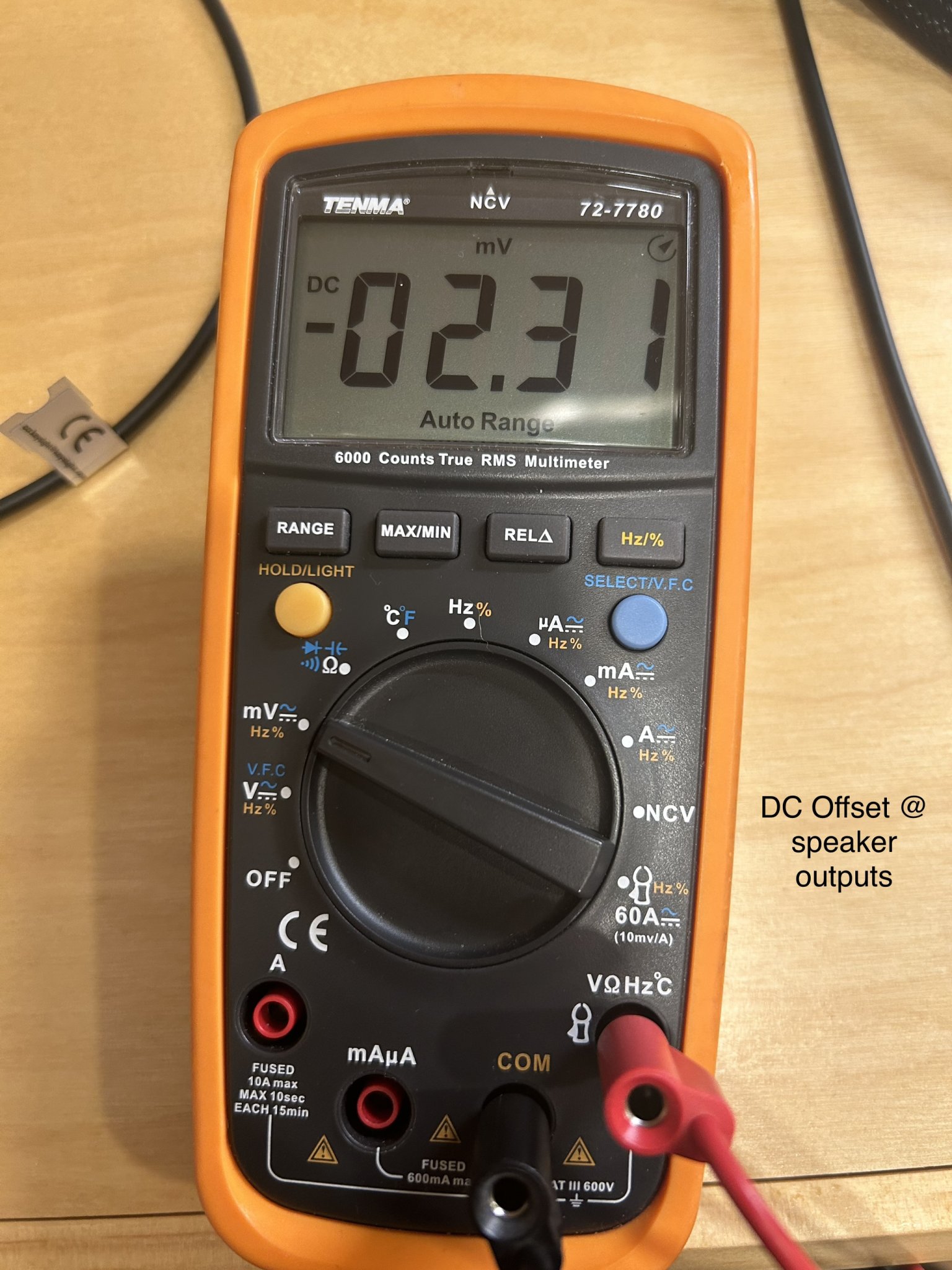

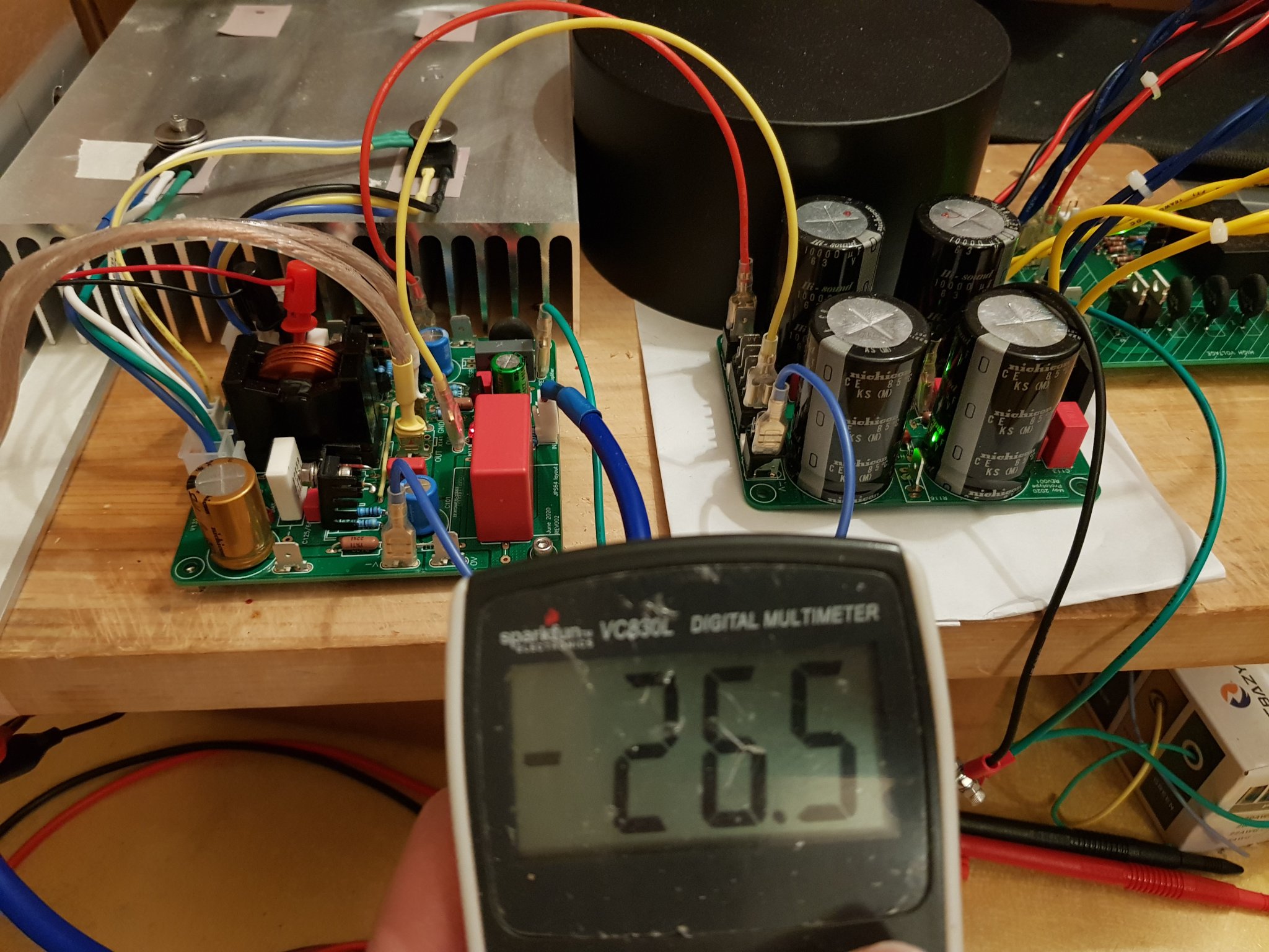

@namghiwook
On your DMM, turn your dial until it points to the “200mV” setting not the “20mA” setting and again do the same measurement. Assuming that your blue potentiometer on the main FH9HVX board is oriented correctly, and completely turned counterclockwise, start to turn the pot ‘clockwise.’ Keep turning the pot a 1/4 to 1/2 turn at a time until you see a change on the DMM. Do it slowly and take your time.
Assuming you used 0.22 ohms for your current source resistors then use V= IR to calculate the quiescent bias current. Start at 80mA. So that means V = 0.08A * 0.22 ohms = ~18mV on your DMM
For 160mA (which is where most folks are setting the bias), that would be 36mV. X’s advice to set it at 26mV(~118mA) is also good advice. You can judge the sound at all these bias points and pick the one that you like the best.

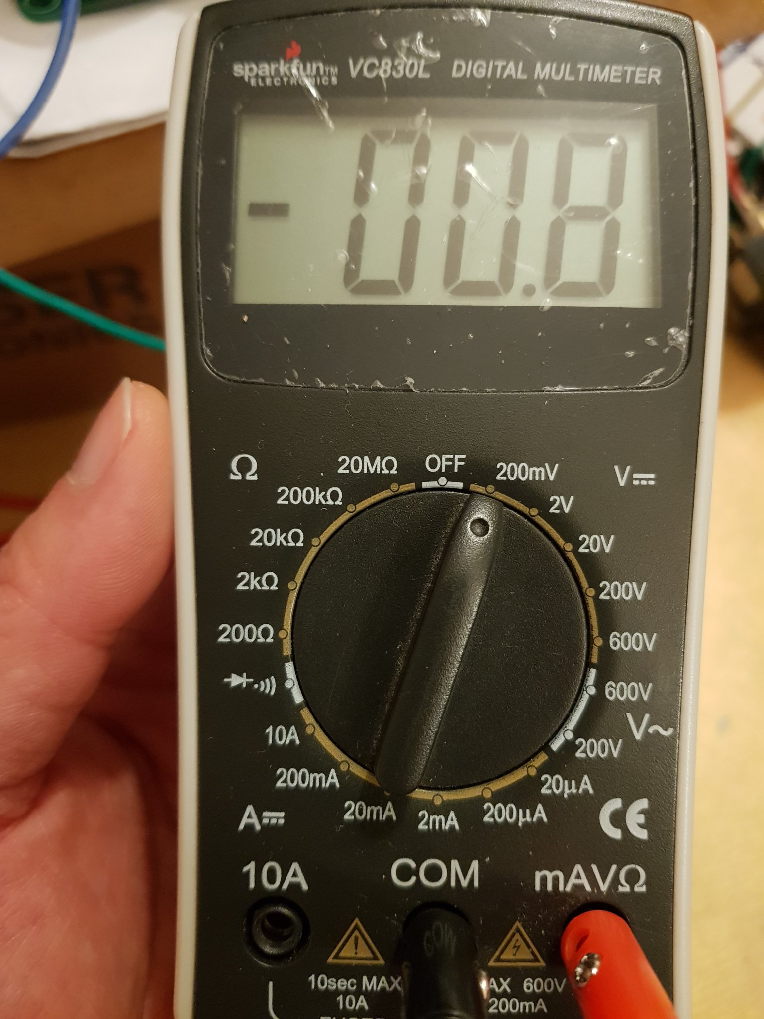

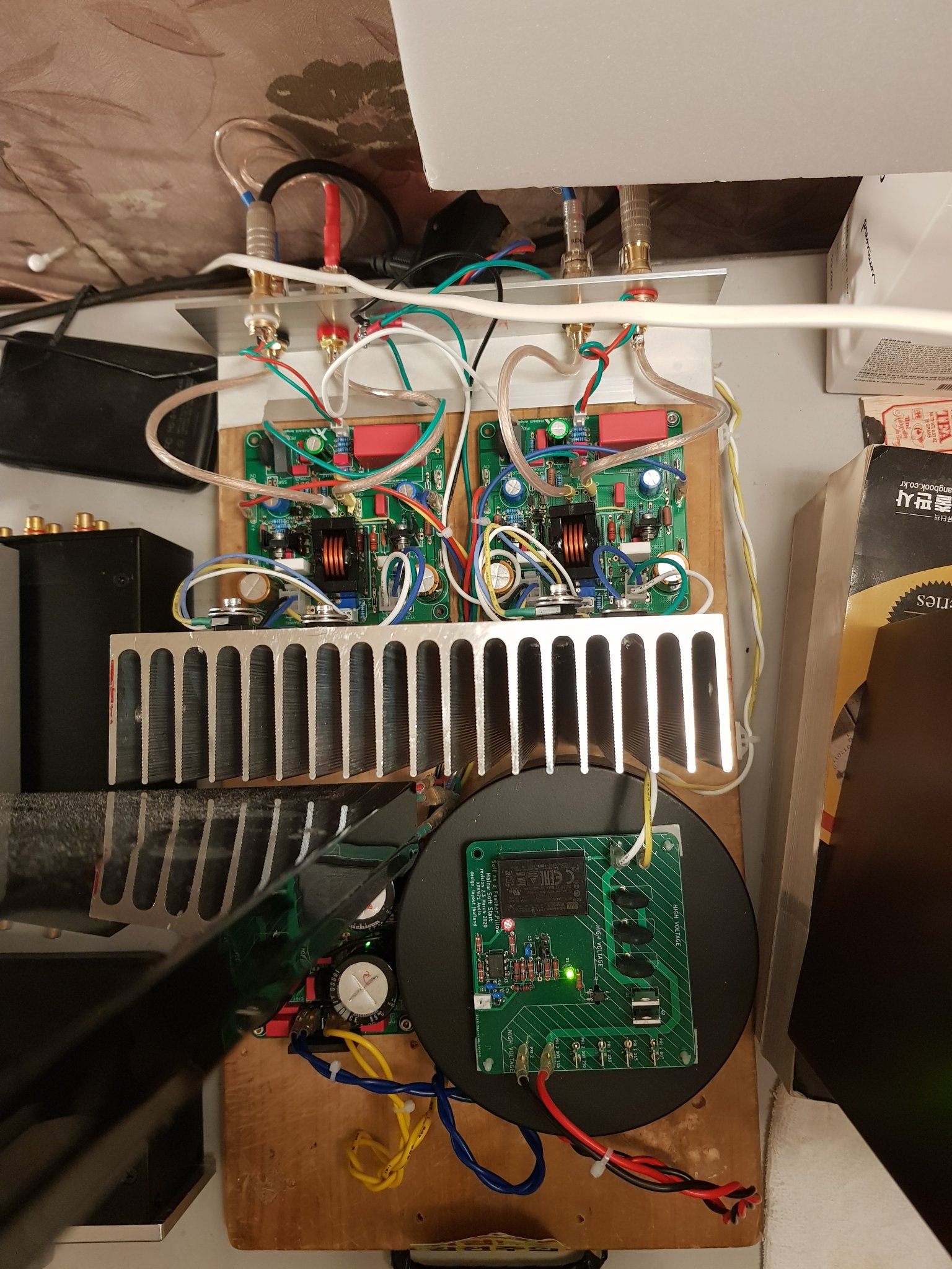

I've adjust the R124 trimpot to 500ohms (half value of 1kohms) before installation.
The value of R133 resistor is 0.22ohms.
I connected the amp with a shorted input RCA and a real speaker.
I adjusted the dial to 200mV range of the DMM and checked the bias with test points (x1031 - x1032 and x1033 - x1034).
The DMM read -00.3 <- minus value
I turned the trimpot clockwise about 3 turns and the DMM read -00.8
I felt something was wrong then stopped it all.

If the scale is 200mV then 0.8 means 0.8mV. I think you want about 20mV to 26mV. You can check this by putting it in plain V mode and see if it reads 0.8V. That would be 800mV and bad (the resistor would be smoking).
I personally think you are getting 0.8mV.
Keep turning it to get about 20mV. Look for heat and smoke as you turn it and go slowly. Shut off main power of you smell smoke, hear something burning or popping etc.

@namghiwook
I agree with X.
Also, if you don’t want the (-) number just switch the leads, then it will read + 0.8mV. Keep turning it slowly clockwise and the vBe multiplier circuit should kick in as the bias current increases.
You also don’t need a speaker connected to the output when adjusting bias.

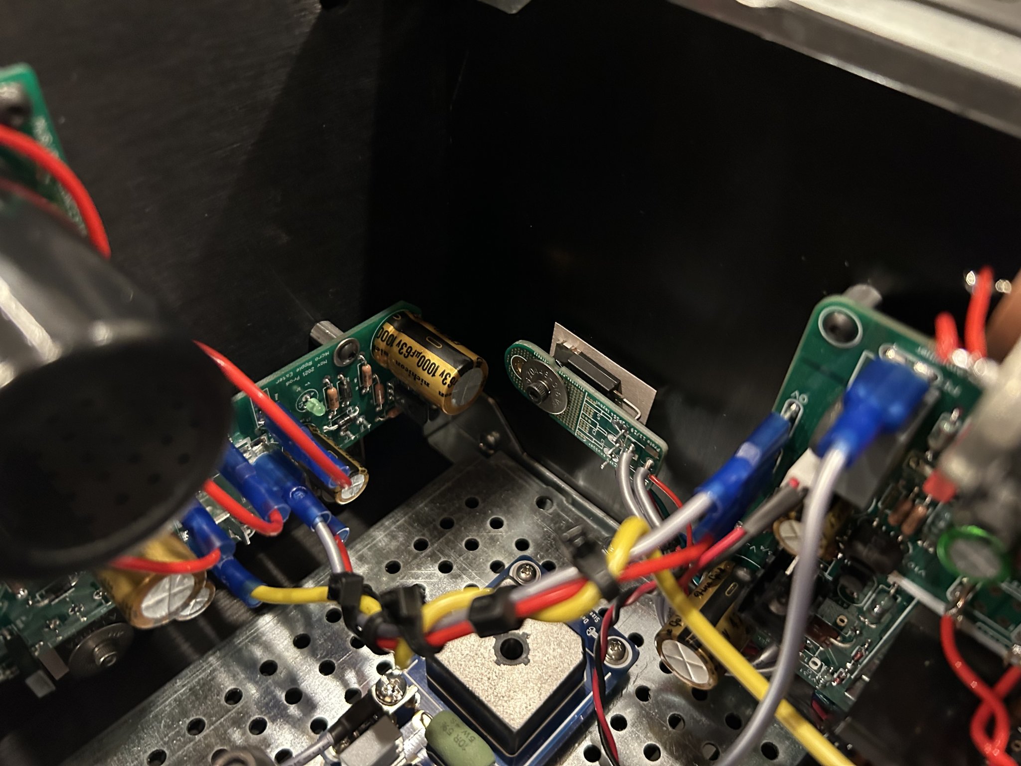

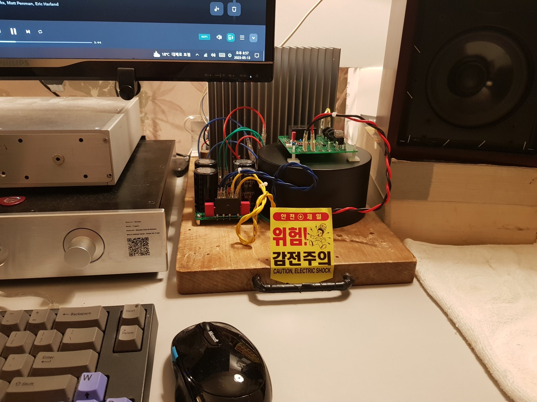

Great news. Looks like you have a fully functioning amp. Please connect to a speaker and source and enjoy the fruits of your labor.
Yesterday, I connected both channels with 8ohms speakers and listened 4 or 5 songs without any problem.
But today when I connected this amp with my soundartist LS3/5a (11ohms), there were smoke and popping sound on the speaker .. so I turned it off immediately.
The current source resistors seemed to be burnt. I could see cracks on them... so I changed resistors with new ones.
... and I powered it up again with a dim blub tester, but it stayed on brightly.
I found that the leads of both N and P mosfets of 'the' channel amp are shorted and mosfets seems to be destroyed.
Question:
The impedance of speaker is concerning issue?
Question:

@namghiwook

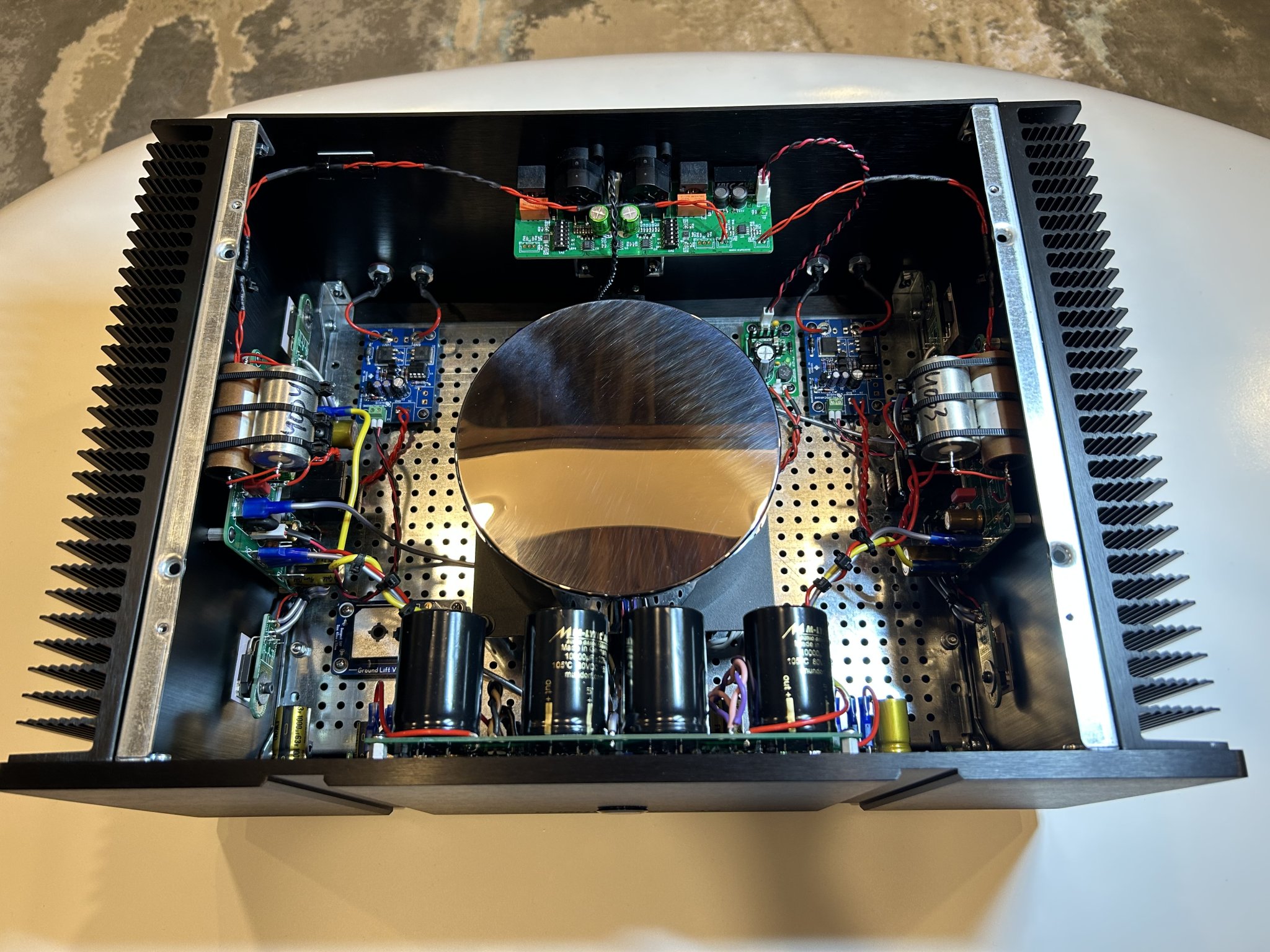

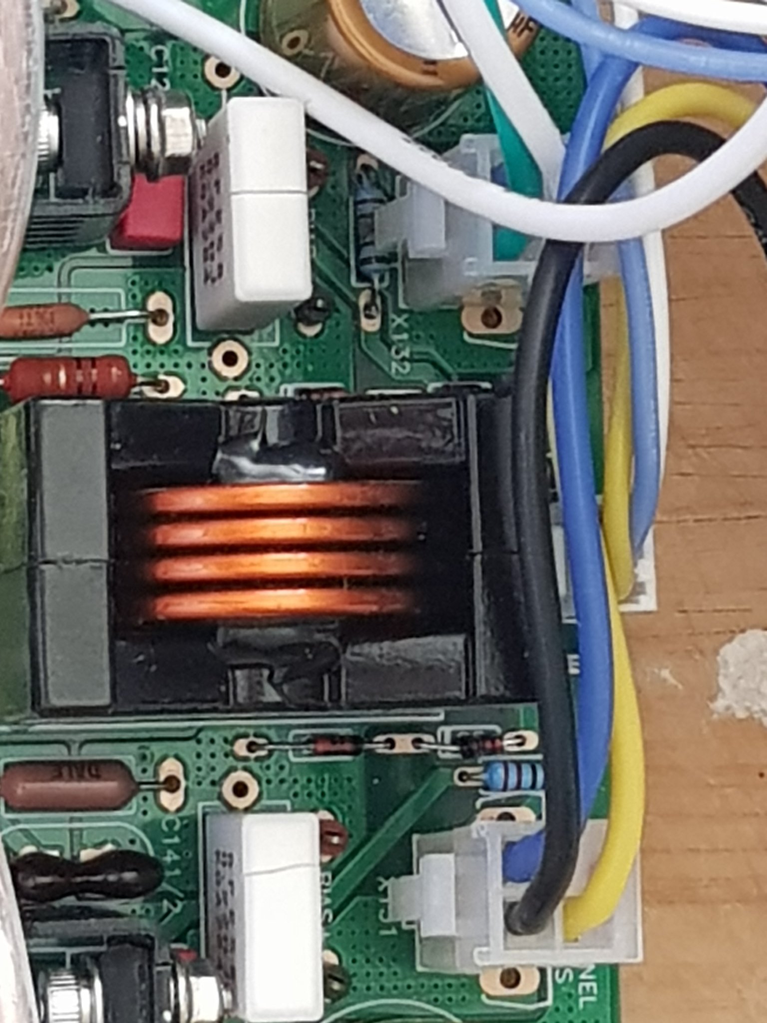

Looking back at your build I did notice something.
Both of your N channel and P channel Mosfets which appear to be nicely wired and do have insulation pads are mounted to the heatsink. But there is a problem. You have long lead wires going from the main PCB to your Mosfets. And your Mosfets are not connected to a ‘snubber’ circuit to deal with oscillation issues that can occur with long lead wiring. You need to be careful about this. This is bad practice.
Either attach the MOSFETS directly to the heatsink and hence directly to the main amp pcb or use a snubber circuit along with your longer leads.
The pcb snubber circuit is here: https://www.etsy.com/listing/766648...95&click_sum=6891b22e&ref=shop_home_active_22
You can probably ask X what the values are, or look at the circuit drawing here: https://www.diyaudio.com/community/...-8ohm-class-a-amp.344540/page-96#post-6839191; the same values work with either Alpha Nirvana or FH9HVX.
The other place where the Mosfet snubber is explained is the Alpha Nirvana GROUP BUY thread here:
https://www.diyaudio.com/community/threads/alpha-nirvana-39w-se-class-a-amplifier-gb.346033/
Pay close attention to the orientation of the Zener diode on the snubber board. It’s different depending on whether the board is being used with N-channel MOSFET vs P-channel MOSFET. There are plenty of pictures online to show this and on XRK’s etsy site.
The location of where to mount the MOSFETS on a heatsink is an option with the FH9HVX (unlike the Alpha Nirvana which is only Class A and runs much hotter). Most builders will mount the MOSFETS directly to the main pcb and directly to the heatsink without any long lead wiring, so no need for a snubber circuit.
But for others…the Mosfet snubber is the best option to eliminate oscillation risks.

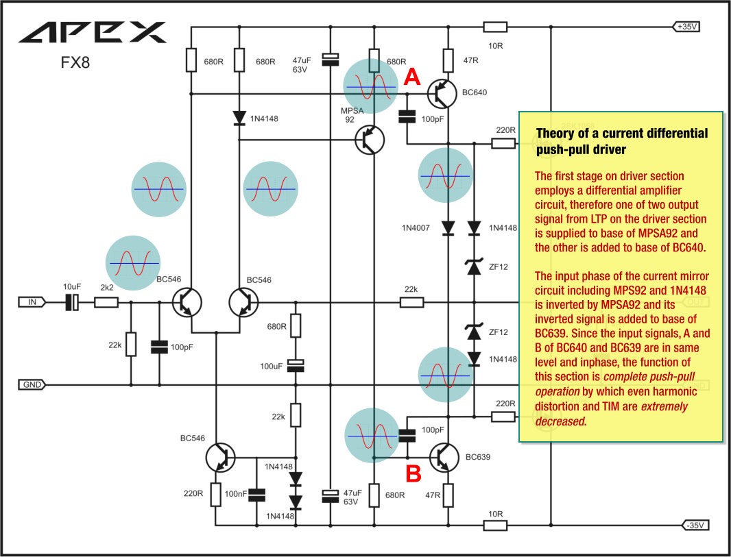

As I was perusing the big 100W Class AB amplifier thread linked above, I ran into this diagram which describes the design topology quite succinctly and elegantly:
Observe the change in absolute phase as the AC music signal traverses its way through the amplifier. This happens to be pretty basic and is a very frequently seen design topology in all of amplifier design starting from the differential input amplifier/LTP on the left and ending with a pair of N/P Mosfets comprising the push pull output stage (not shown clearly above, it comes after the push pull driver stage).

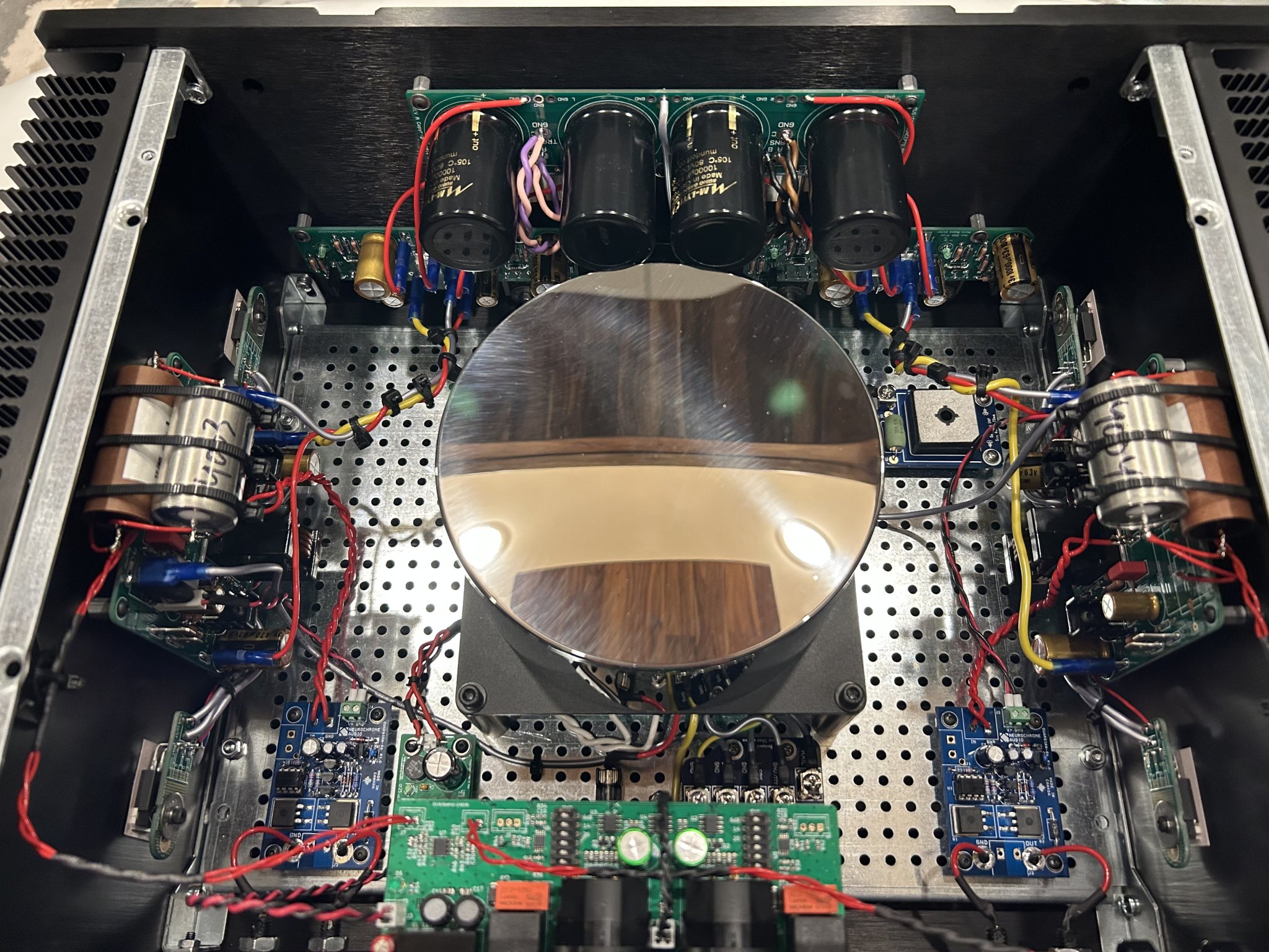

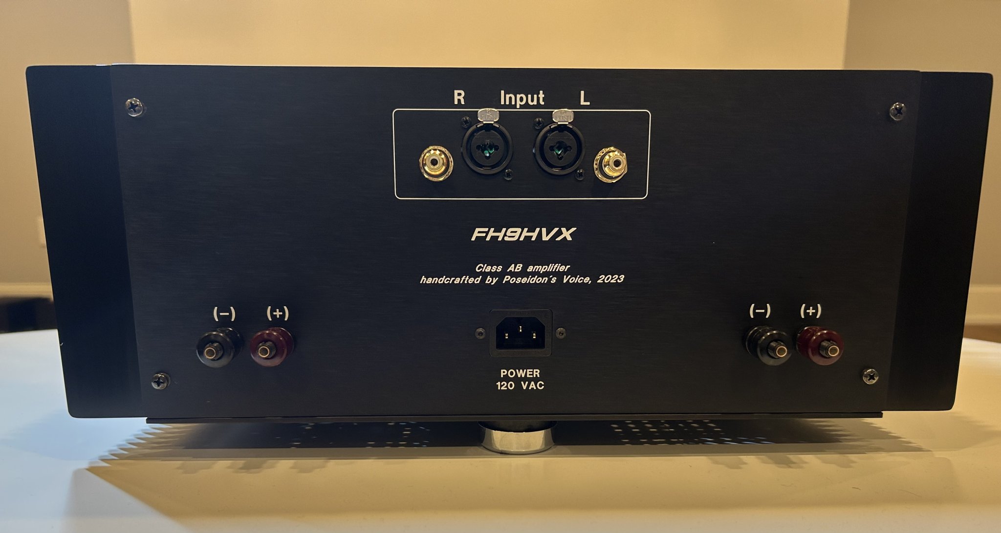

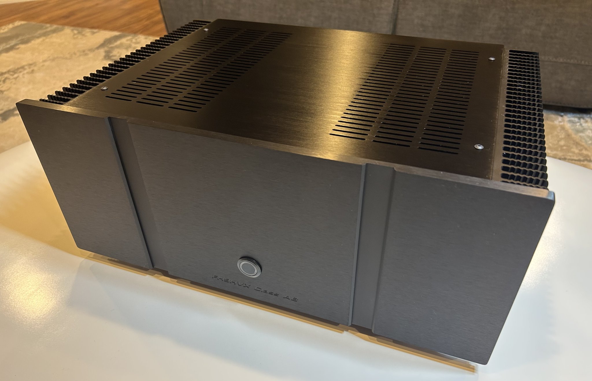

I became interested in this design only in the past year and because I wanted to build a standard issue 3-4 stage Class AB discrete design. Lord knows I don’t need yet ANOTHER amplifier but as we all know, I have a strange affliction, I mean addiction. And so here we are.
Theory of operation
Ingredients

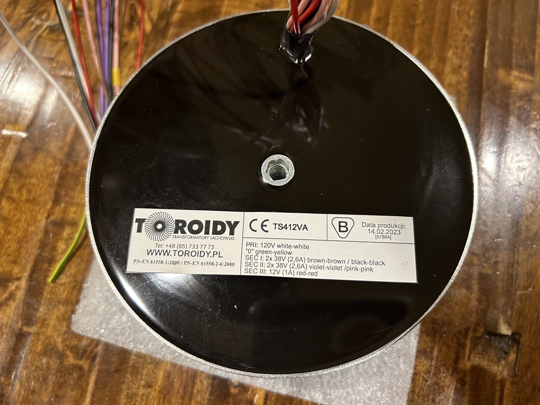

Toroidy 412VA w/quad 38V secondaries, and a single 12V/1A secondary
Softstart module w/Yakamoz latching push button switch
Dual Mono Power Supply composed of HexFred bridge rectification in a center tapped format with (4) 10mF Mundorf 4 pole capacitors
Hifisonix/Andrew Russell’s MRE (MicroRipple Eater) with Sanken transistors, one for each channel
Panel Mount BTSB using Susumu resistors in the signal path as well as -6dB modification described here
AMB Sigma 25 w/Sigma 78 low noise voltage regulator supply boards
FH9HVX main board with Vcap ODAM/Miflex input capacitor, Takman metal film resistors, and Mills non inductive wirewound resistors, biased at 250mA/ch
MOSFET snubber boards using dual 18AWG wiring for Drain, single 18AWG for Source and single 22 AWG for Gate

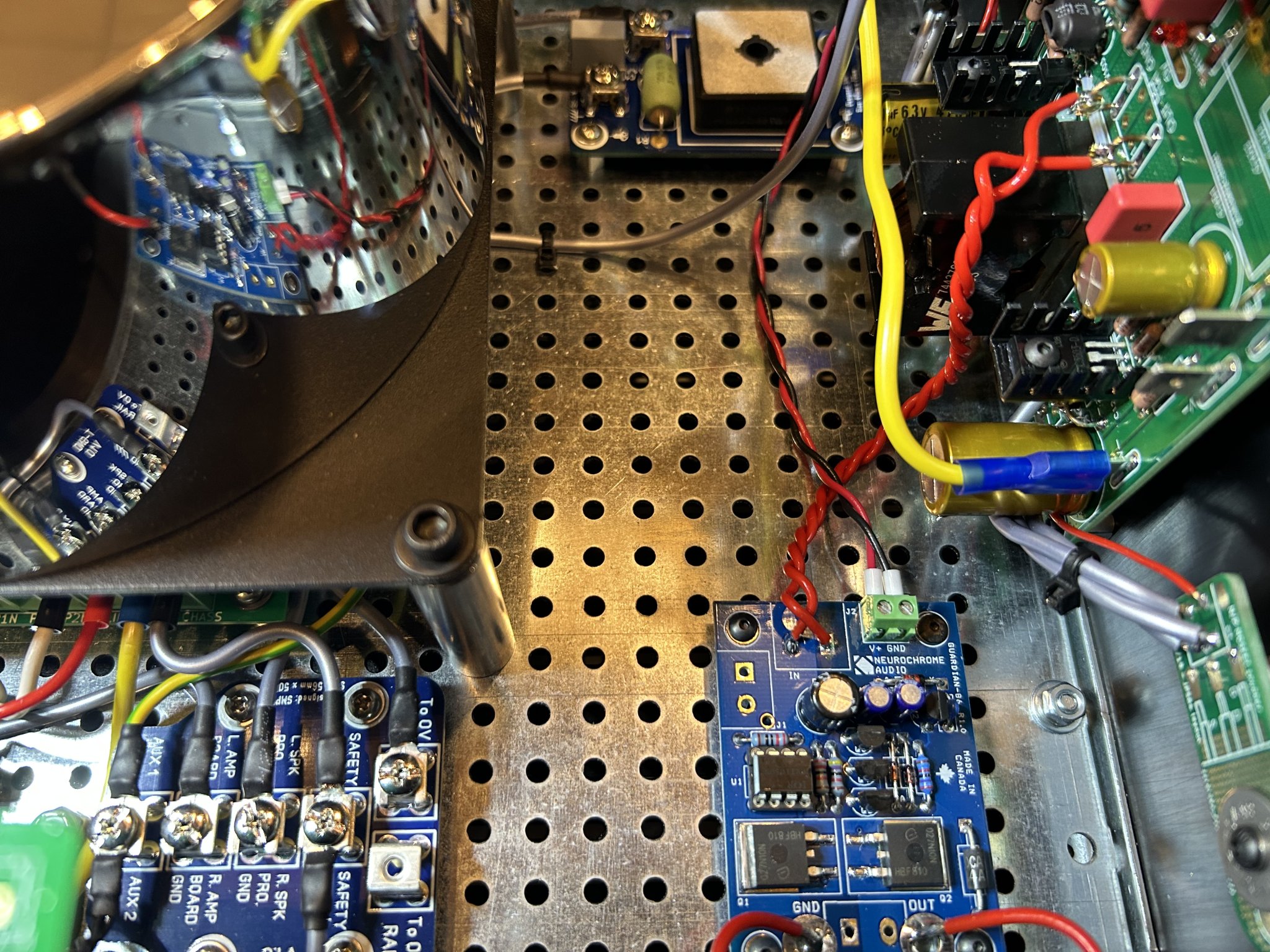

Neurochrome Audio Guardian-86 speaker protect boards

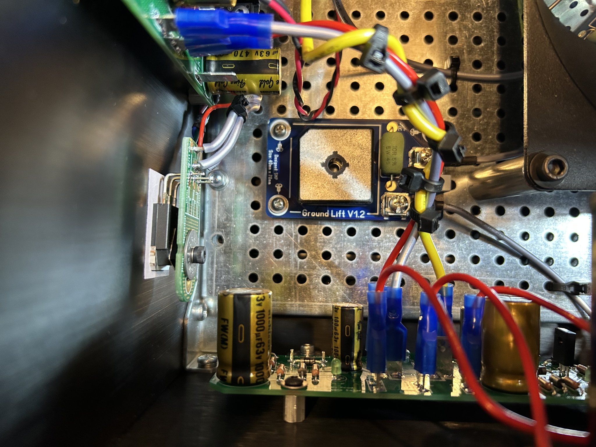

Ground Lift circuit for main power supply
Composite Ground board
KLEI Classic Harmony Binding Posts
Furutech FI-06 IEC
Various gauge wiring (16AWG to 24AWG) from Neotech
Customized Modushop 4U/300 Dissipante chassis

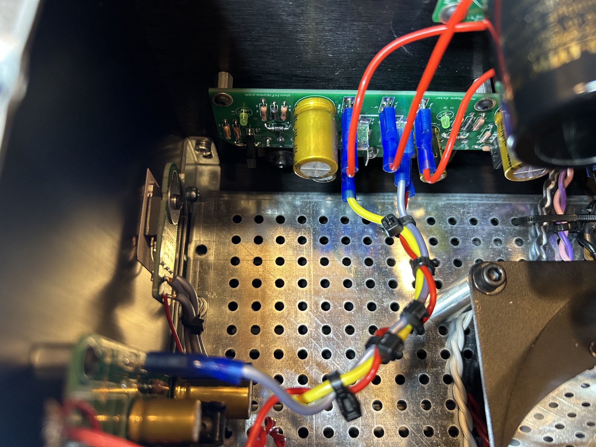

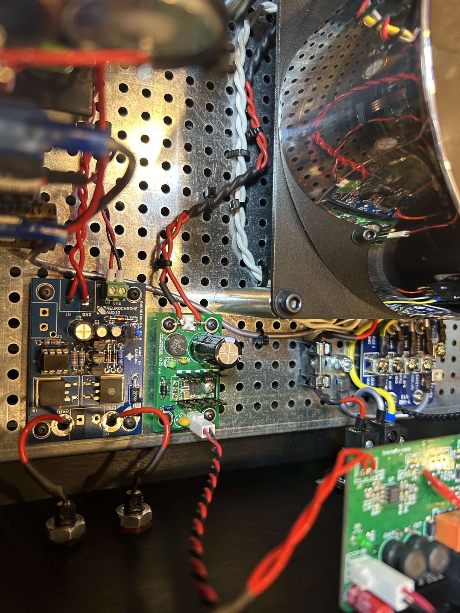

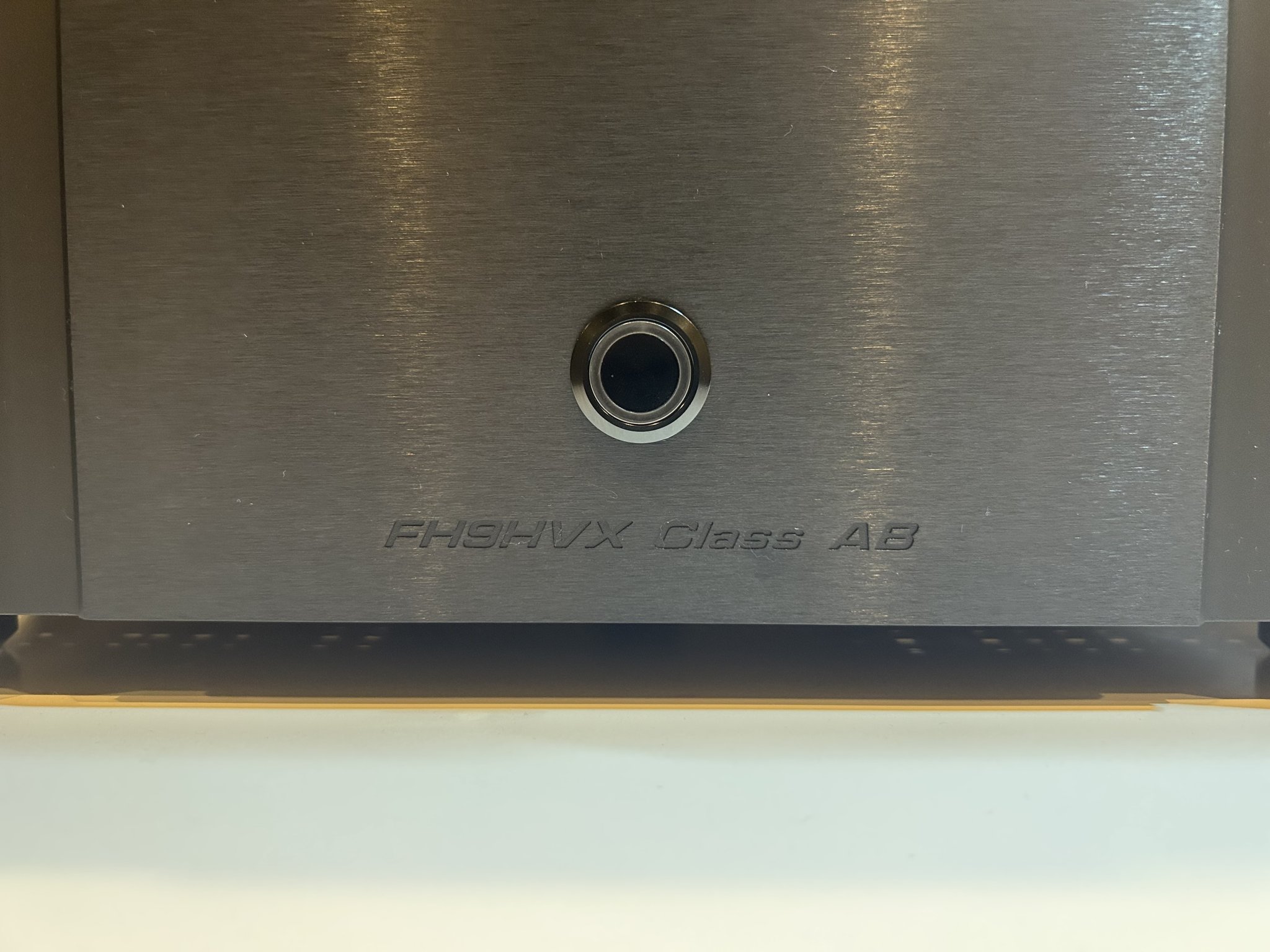

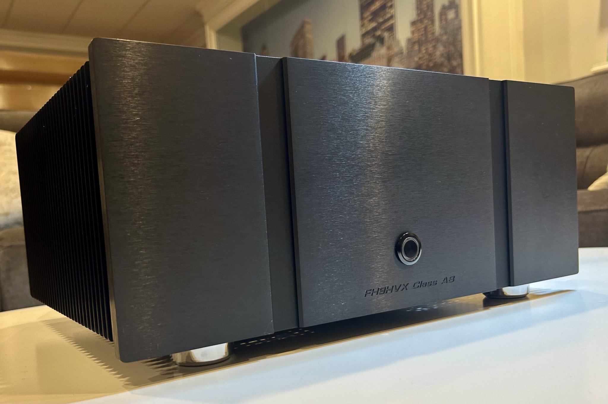

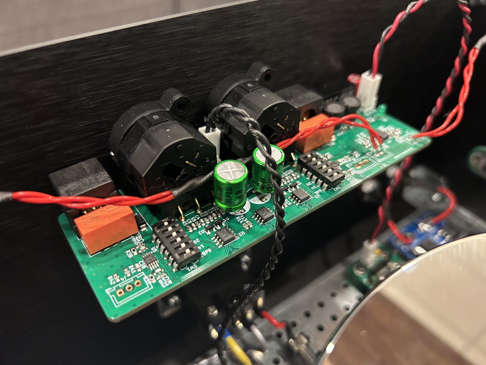

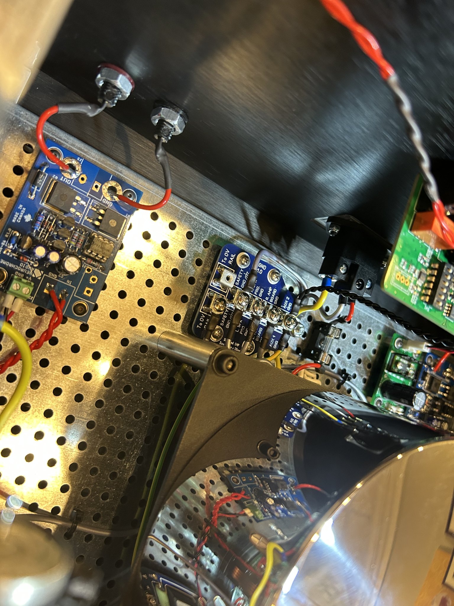

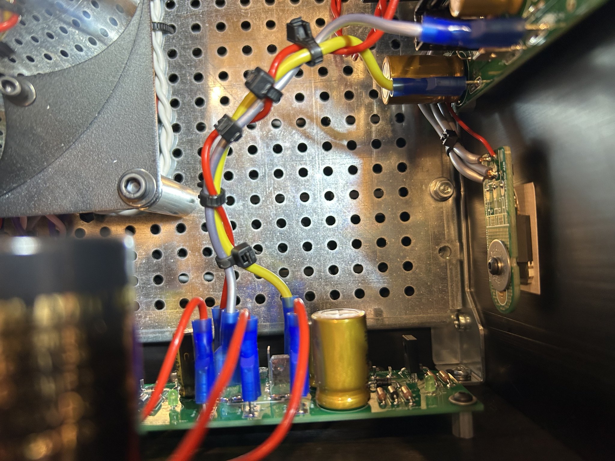

More pics attached…

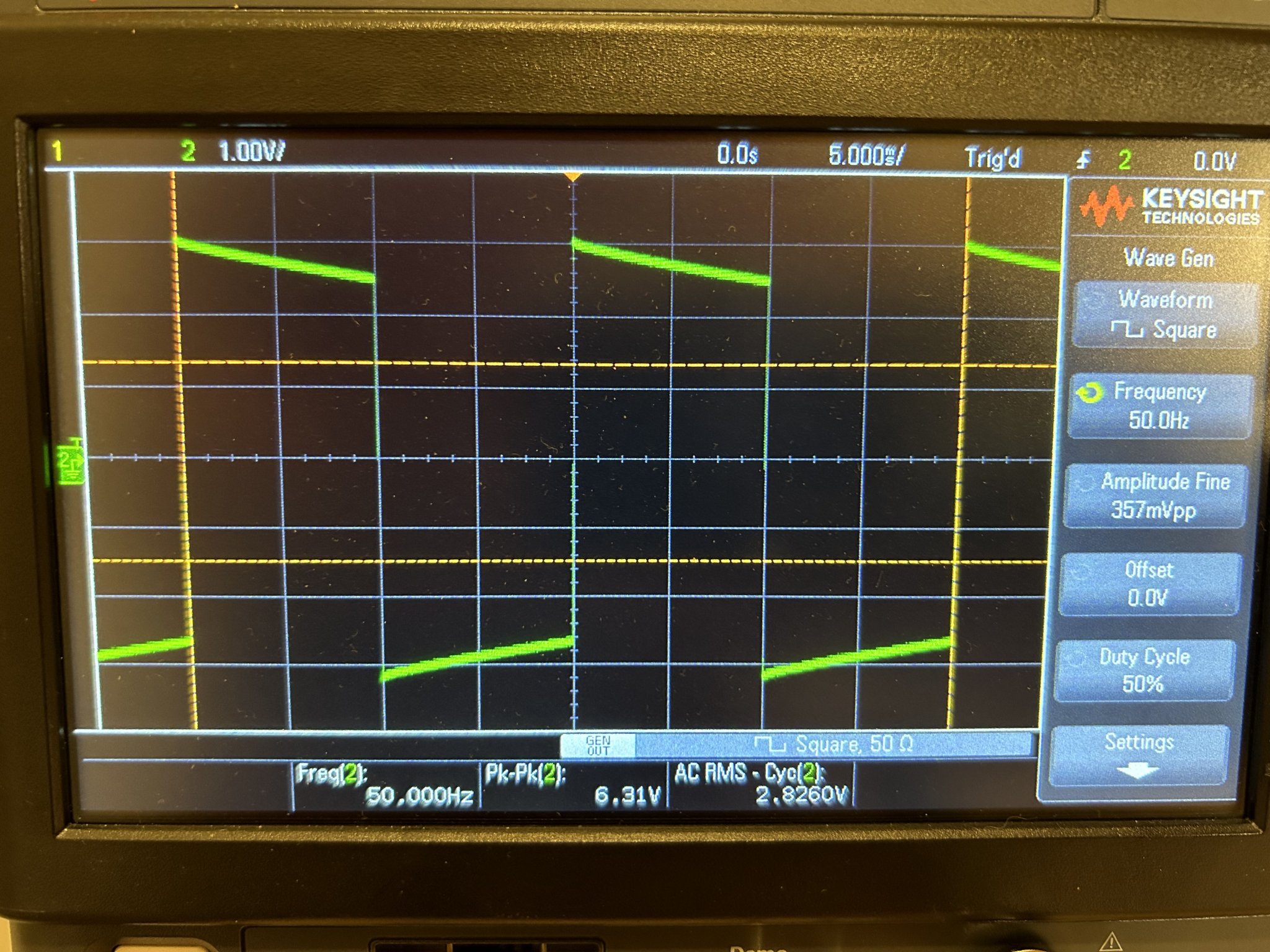

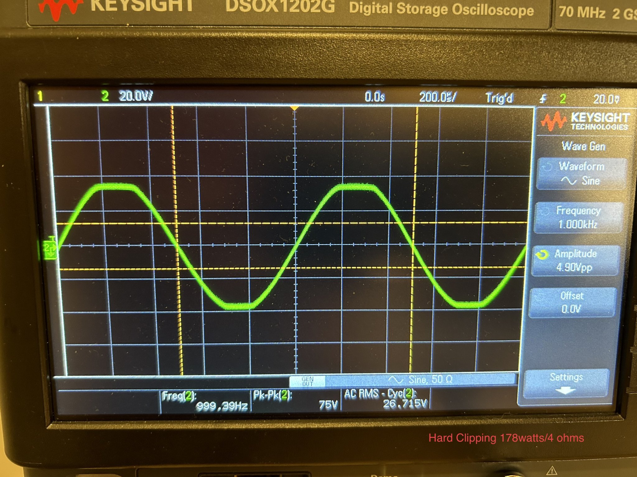

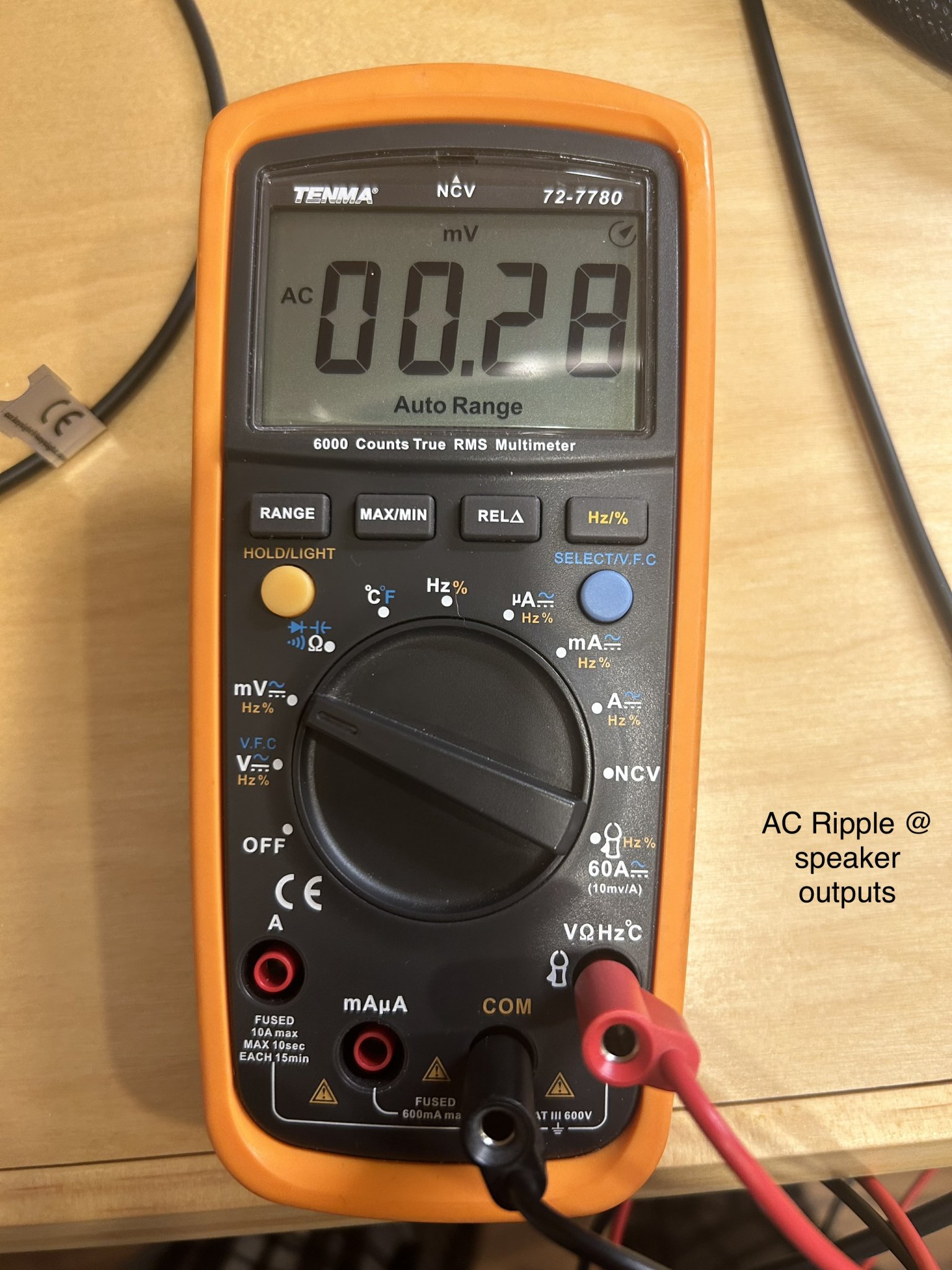

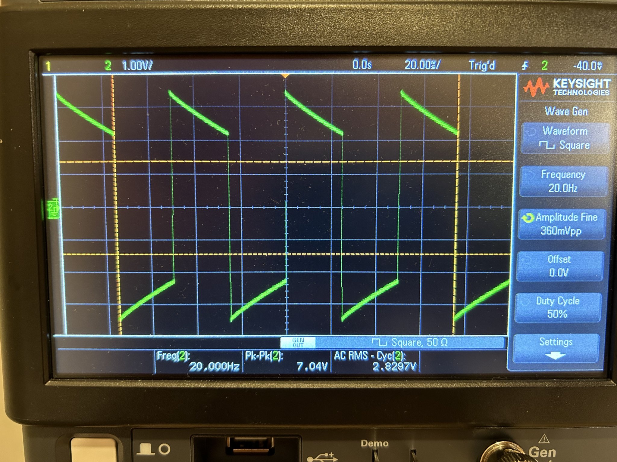

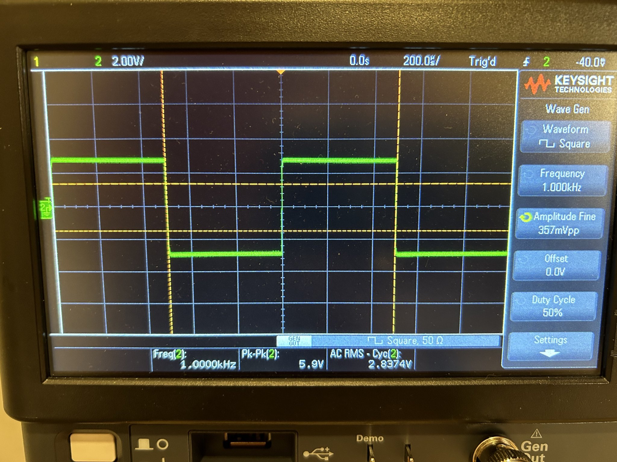

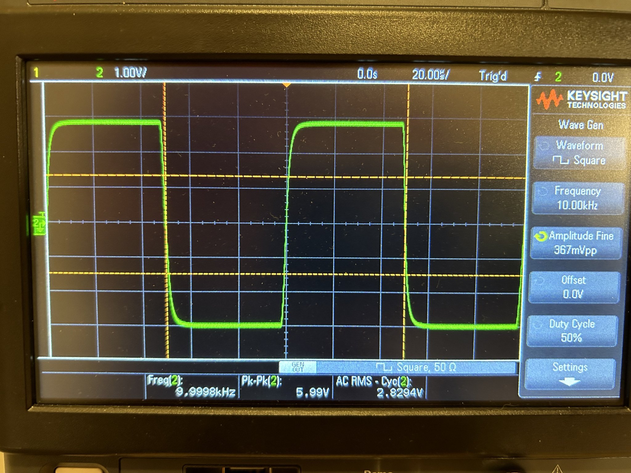

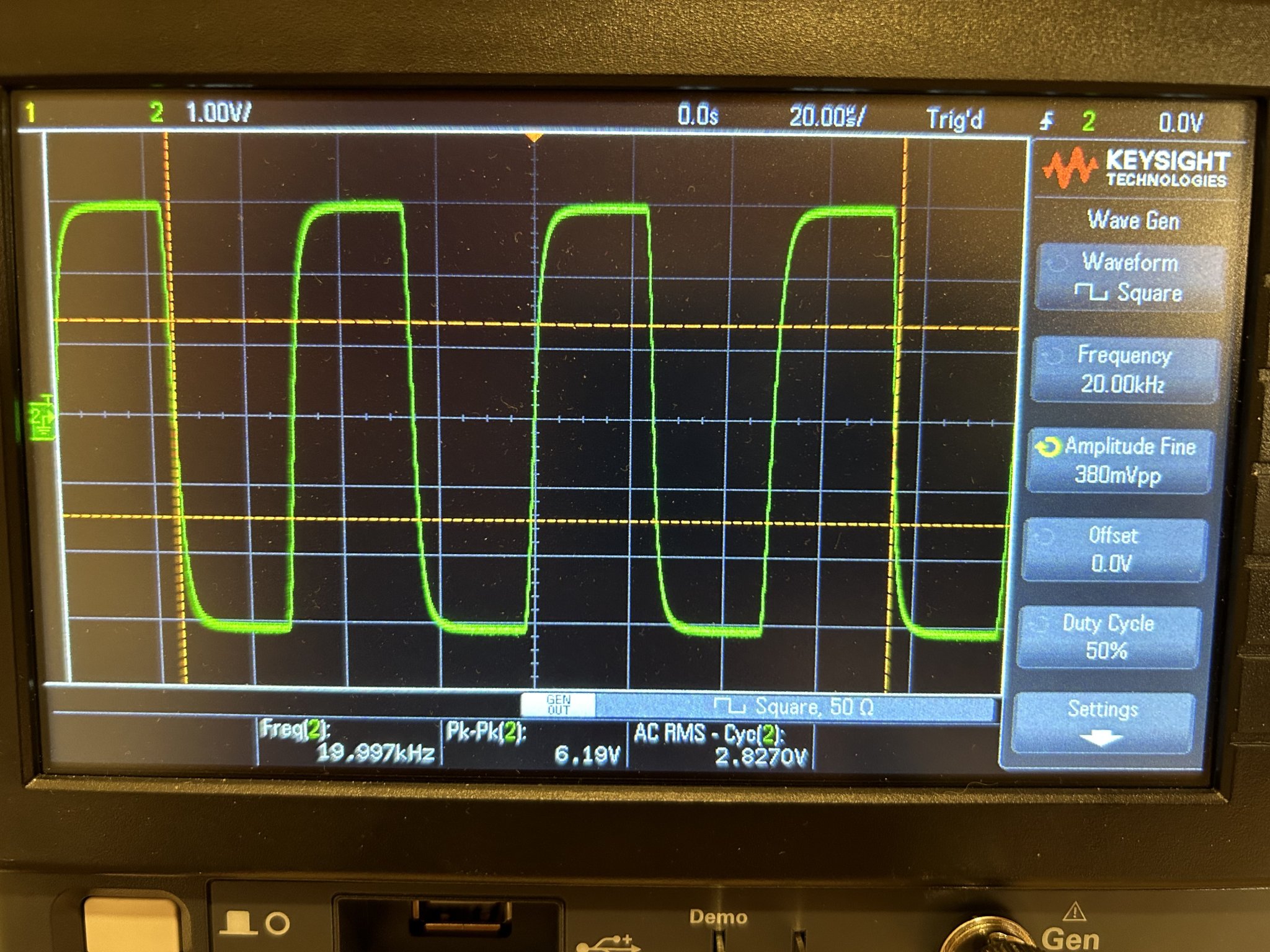

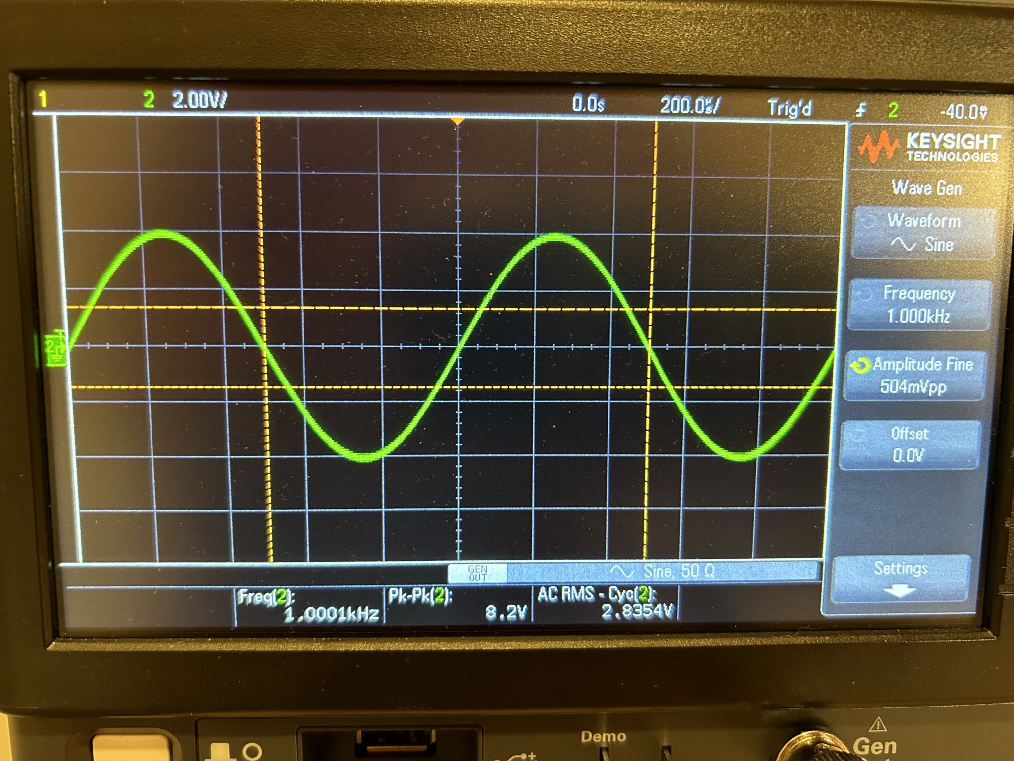

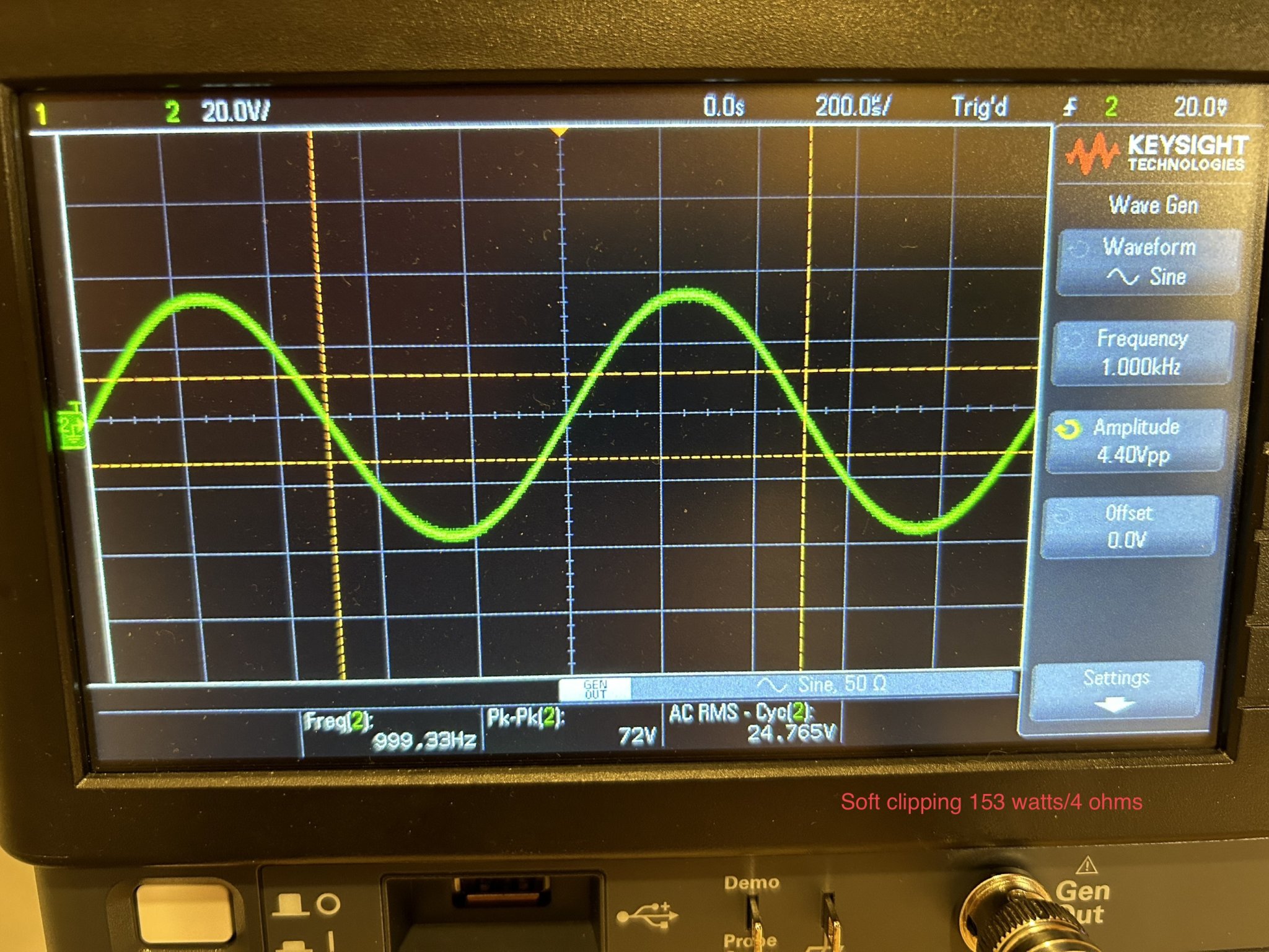

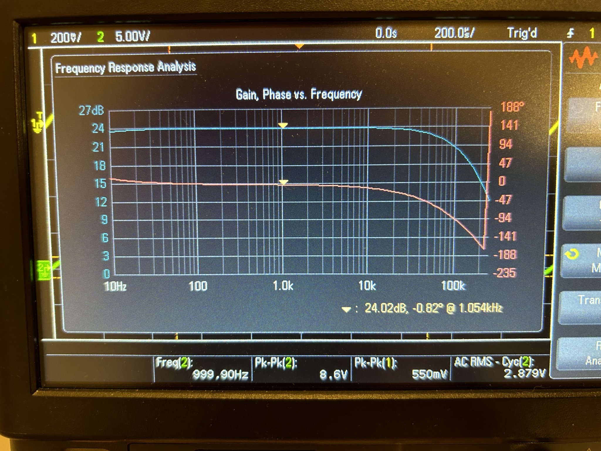

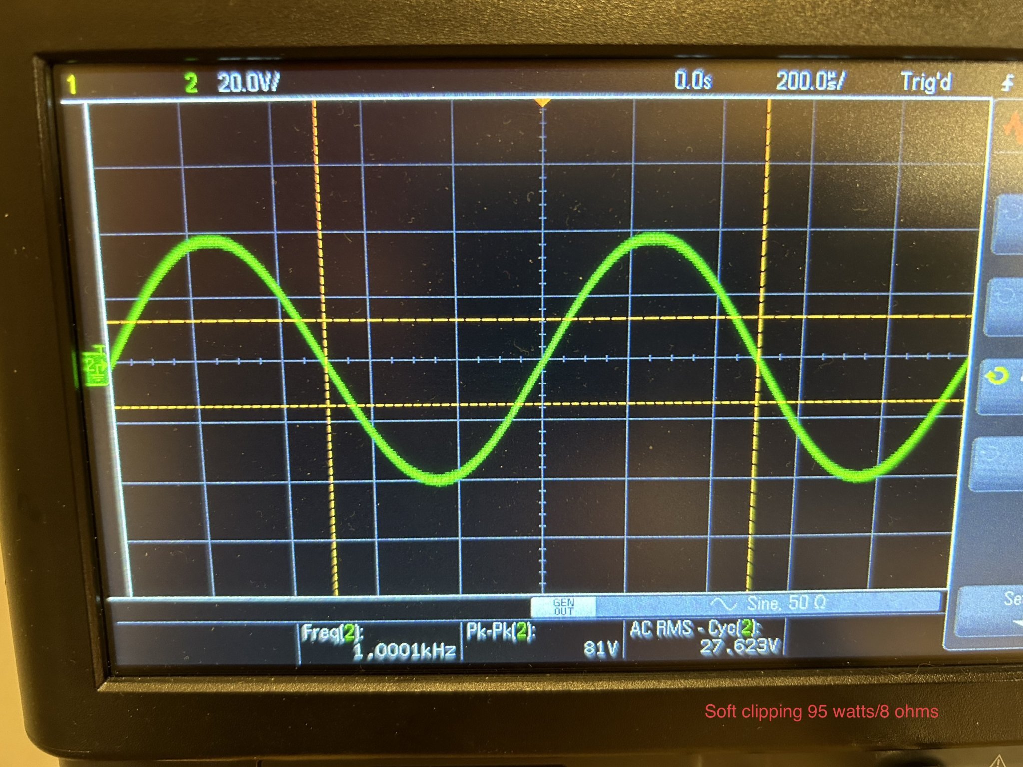

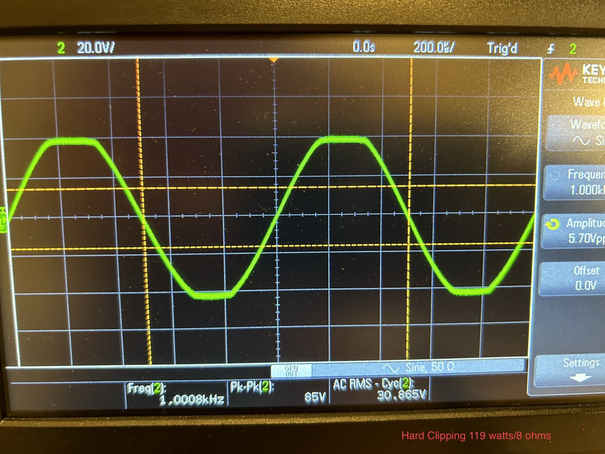

Measurements attached (remember my overall gain is only 24dB in my build, since I have implemented the -6dB option for the BTSB):
Sonic impressions forthcoming. I have several loudspeaker setups to evaluate this amp on which I will most likely compose and write up in about 1 month or so.
If any of you have questions/criticisms or need something clarified in my build, please let me know.
