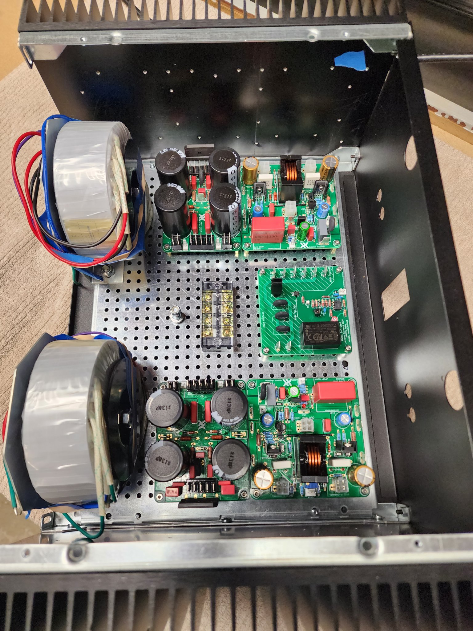

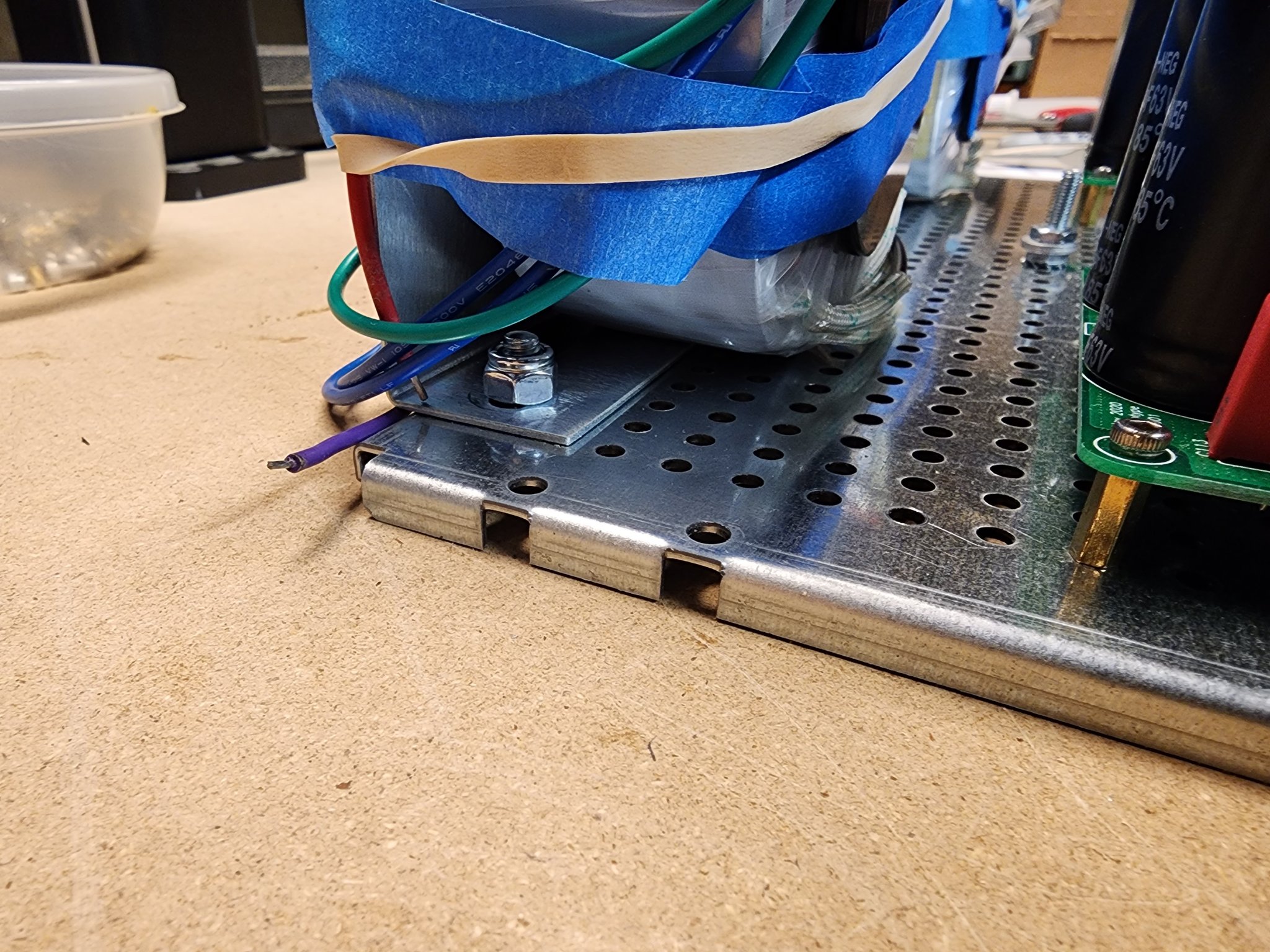

Progress report on my FH9HVX build. Progress has been agonizingly slow. As I alluded to in my last post, I junked the original toroid brackets. They were too flimsy. I decided to go with the L-300 brackets that Bloqhed recommended. Although it was a bit of a wait for them to arrive, they turned out to be the clear ticket for my vertical installation. Fastened to the base plate with 1/4" bolts and lock nuts, those toroids aren't going anywhere.
I planned on moving the amp boards up to the heat sinks but that didn't go so well. I was trying to tap the mounting holes for the standoffs when I realized my tap had too much of a taper. It was bottoming out before it was creating any useful threads. Obviously, I can only drill the holes a few mm deep without drilling through the other side. After deliberating whether to look for/order/wait to arrive/ another tap, I returned to my original plan of trying to make it all fit on the baseplate. Some clearances may be tight, but I think I can make it work. For what it's worth I have a good supply of high-quality insulated female spade connectors for those connections.
Sounds like the RTR SSR speaker protection boards from XRK's shop should arrive just in time for me. I hope to begin making basic connections soon.
There you have the latest. Thanks everyone. Dave M.

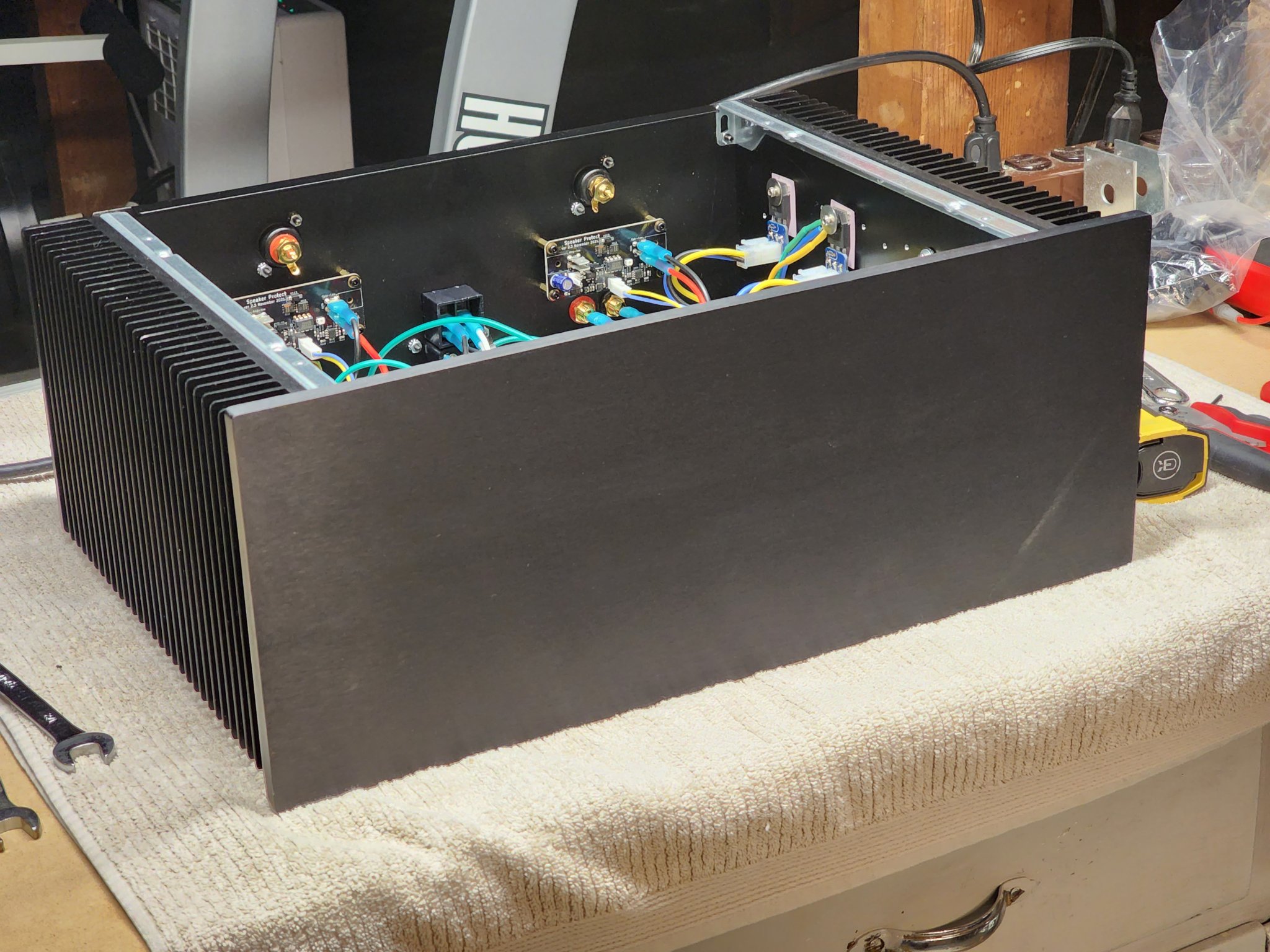

It took some time to assemble my project in the enclosure with much putting together and taking apart again on this, my first high power amplifier build. It was quite a relief to see all of the LED's light up when I powered up the variac.
Bias is currently running about 26 mV with about -8.5 mV offset. (No variac, straight into mains outlet). I am currently playing music with a FiiO digital music player for testing purposes. I will offer some listening impressions in the near future after I nail down some minor issues. So far it sounds awesome. Stay tuned.

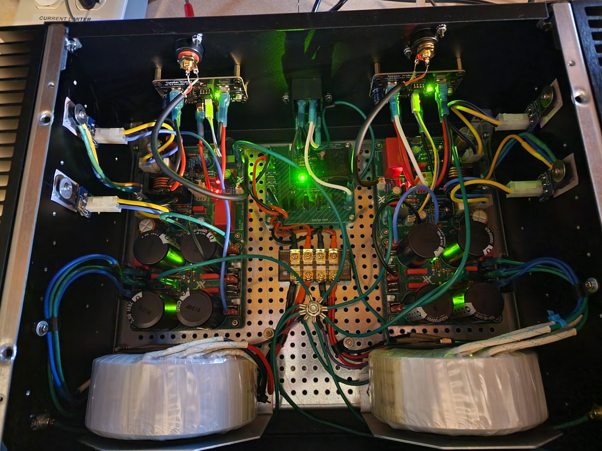

Hello forum members,
Well so far, so good. My FH9HVX continues to pump out the music, although I'm lacking a proper preamp.
I was quite pleased with a fairly trouble-free start-up. Initially, I was unable to obtain any bias voltage reading on the right channel. This turned out to be a poor connection between the board and the voltage multiplier connection. Easily repaired. The only thing I hope to add at this point is an amber power LED. I'm hoping I can access DC voltage from one of the positive rails and use a resistor to bring the voltage down to the proper level for power.
The sound? Excellent. I really am impressed with the clarity and separation between instruments in some of the studio recordings I've listened to. I can't wait to connect a quality preamplifier to this amp.

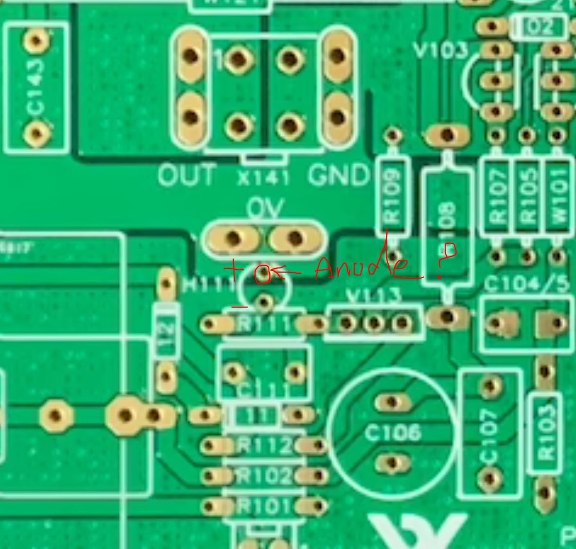

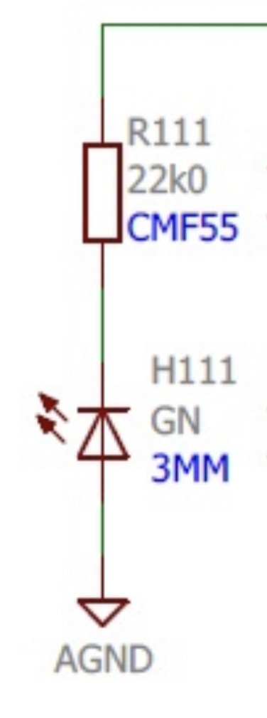

@namghiwook
That’s correct, cathode (-) connects to R111. See schematic on 1st page of this thread.
Best,
Anand.
Best,
Anand.
I agree that the cathode bar on that LED could be made more clear but use of schematic is also easy.
