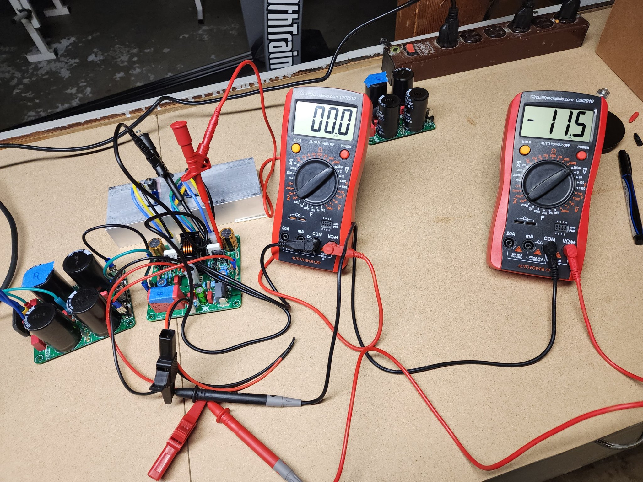

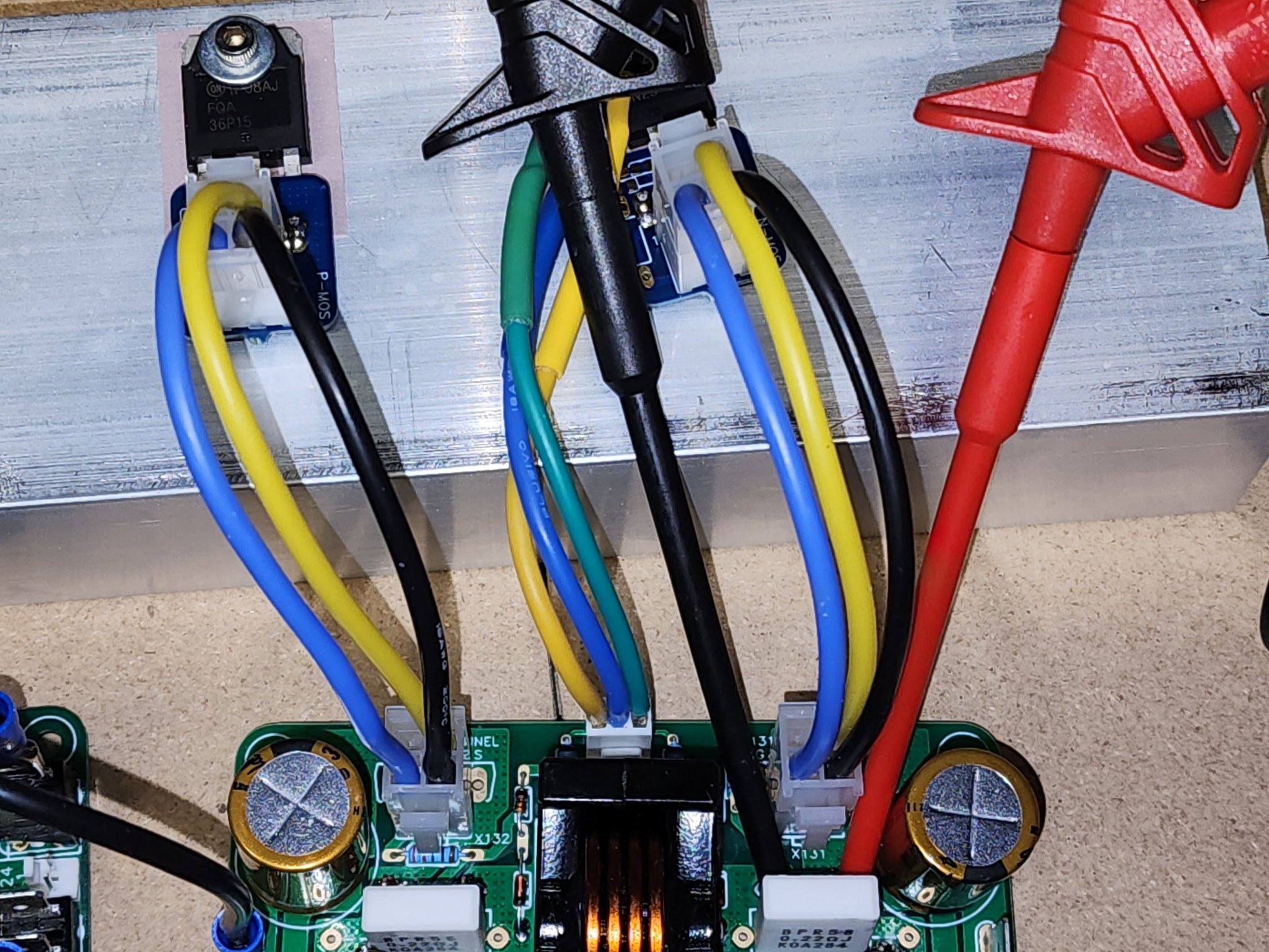

Hi guys,
I ran into a little bump in the road with my testing of the first amplifier board.
The set-up:
I tied both input leads together but had no load attached. The left DMM was hooked to the test points. The right DMM was hooked up to the output. I slowly ramped up the variac to 115AC. No reading at all on the left DMM and a reading of -11.5 mV on the right DMM. Both DMM's were set to the 200mV DC scale. Interestingly enough the LED on the amp board glowed bright red.
Even with my limited understanding I recognize the open circuit as there is no voltage present at the test points.
As one would expect, my dim bulb tester did not light up and both MOSFET's remained cold to the touch.
Any obvious places to begin looking? I double-checked my power connections just for good measure.
I would be grateful for any insights or suggestions. Please know that I may be away from my account from time-to-time today and probably won't have time to implement any suggestions until tomorrow morning. Thanks! Respectfully, Dave M.

It looks like everything is working. If I understand you correctly the left DMM is connected across the output Source resistor to measure bias current and the right DMM is measuring DC offset.
The 0mV probably means the pot had not been turned enough to allow current to flow. Slowly adjust it to get about 26mV for 120mA across 0.22ohm. The 11mV offset is normal range.
The MOSFETs are cold because no current. At 120mA they will be a little warm as dissipating about 2.75W each.
If DC offset goes above 0.5V something is wrong and turn off and debug.
Good luck!

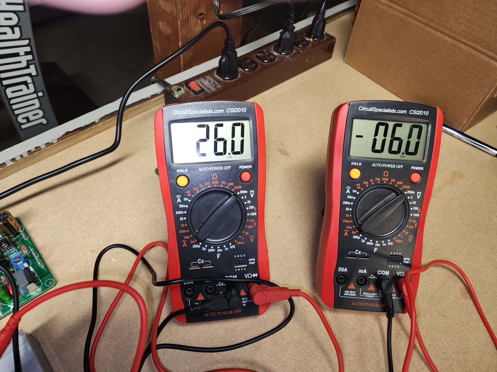

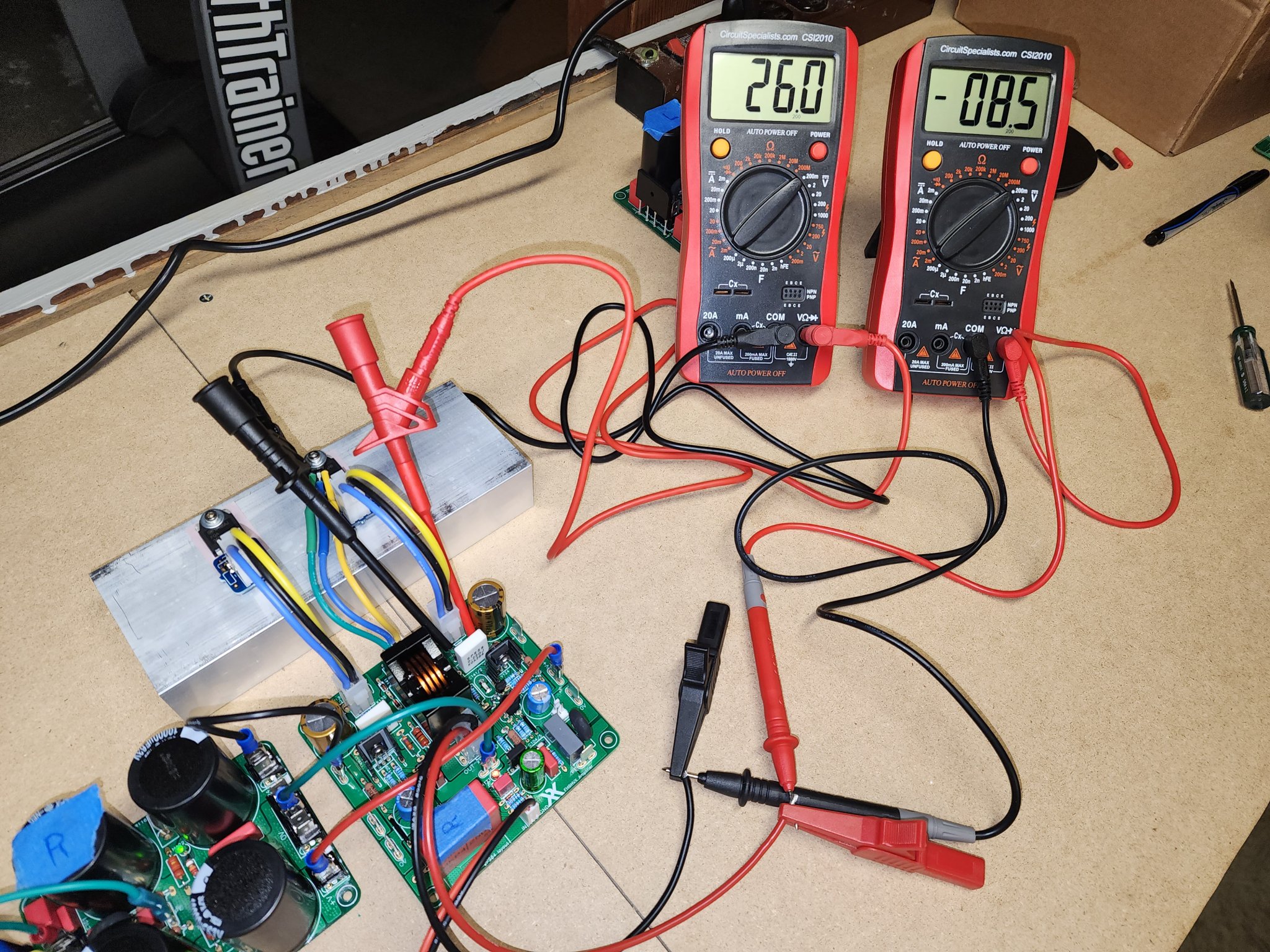

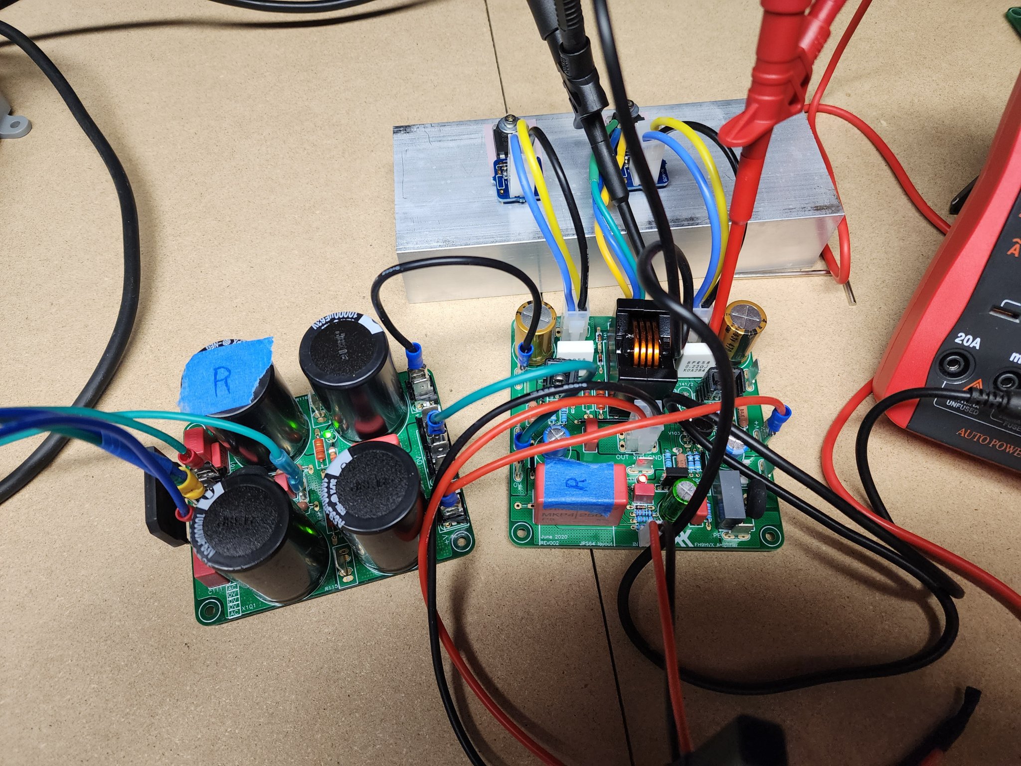

Hi guys,
An update on my amp board testing and hopefully a clue as to the source of my bias problem.
As suggested by X, I powered everything back up and turn the adjustment screw on the trim pot. Left, right, many turns, still nothing. I have DC offset but no bias current.
As a little experiment I replaced the amplifier board with the other board. Same exact problem. I had -10.0 mV offset but no bias reading. I doubled checked to make sure my left DMM was making good contact with the test points labeled "bias."
This got me thinking that the issue must be something basic that I screwed up. Then when examine my flying leads I noticed that the Vbe multiplier lead had a twist in it. This would effectively result in it being wired backwards. Could this cause my lack of current to the MOSFET's?
If anyone has any insights I'm totally open to feedback. Thanks in advance. Respectfully, Dave M.

Definitely yes if the VBE multiplier is backwards. It is the master controller of the bias current. You have a BD139 which is pinout ECB, flipped is connected BCE so all wrong. Please correct and it should fix it. Luckily nothing blew up. But please check to see if the pins follow ECB. I can’t tell from photo how it is attached at the BD139 as it is obscured.
Hello fellow forum members,
Thought I'd post an update on my FH9HVX build.
The problem I was having with lack of bias current did indeed boil down to my error in wiring the Vbe multiplier female receptacle backwards. Once corrected I was able to bring bias up to recommended levels and tweak the settings as the MOSFET's warmed up. I ended up with a reading of 26.0 mV of bias on the left channel with a DC offset of -6.0 mV. The right channel settled in at 26.0 mV of bias with DC offset of -8.5 mV. Is it normal to have negative DC offset readings?

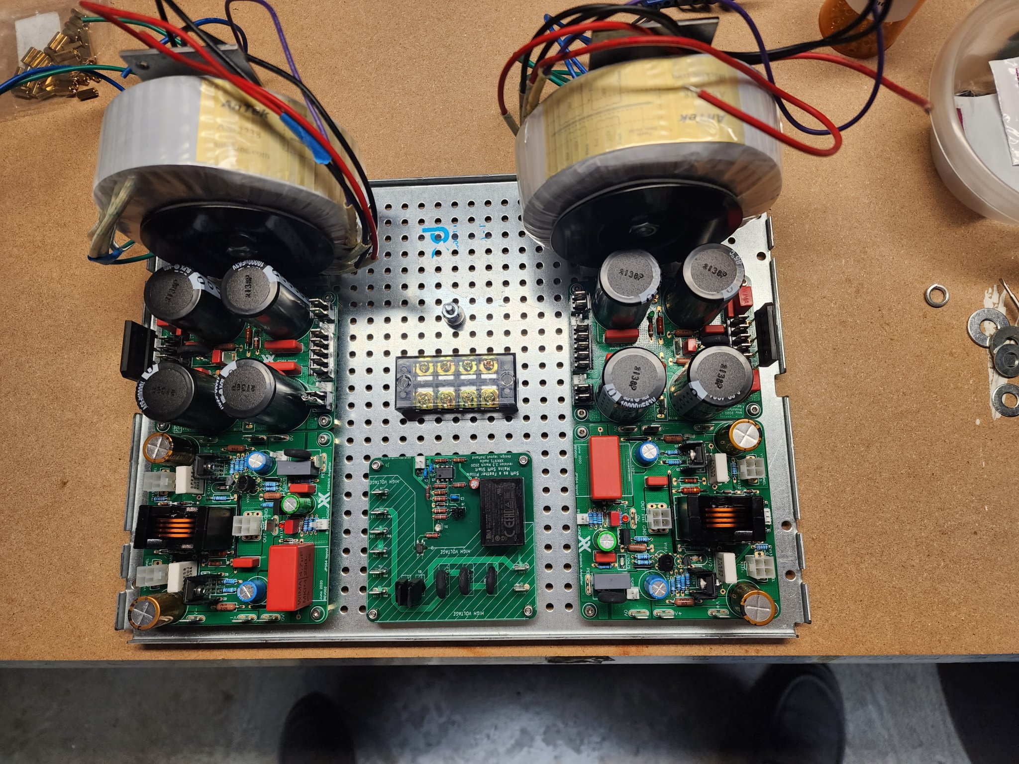

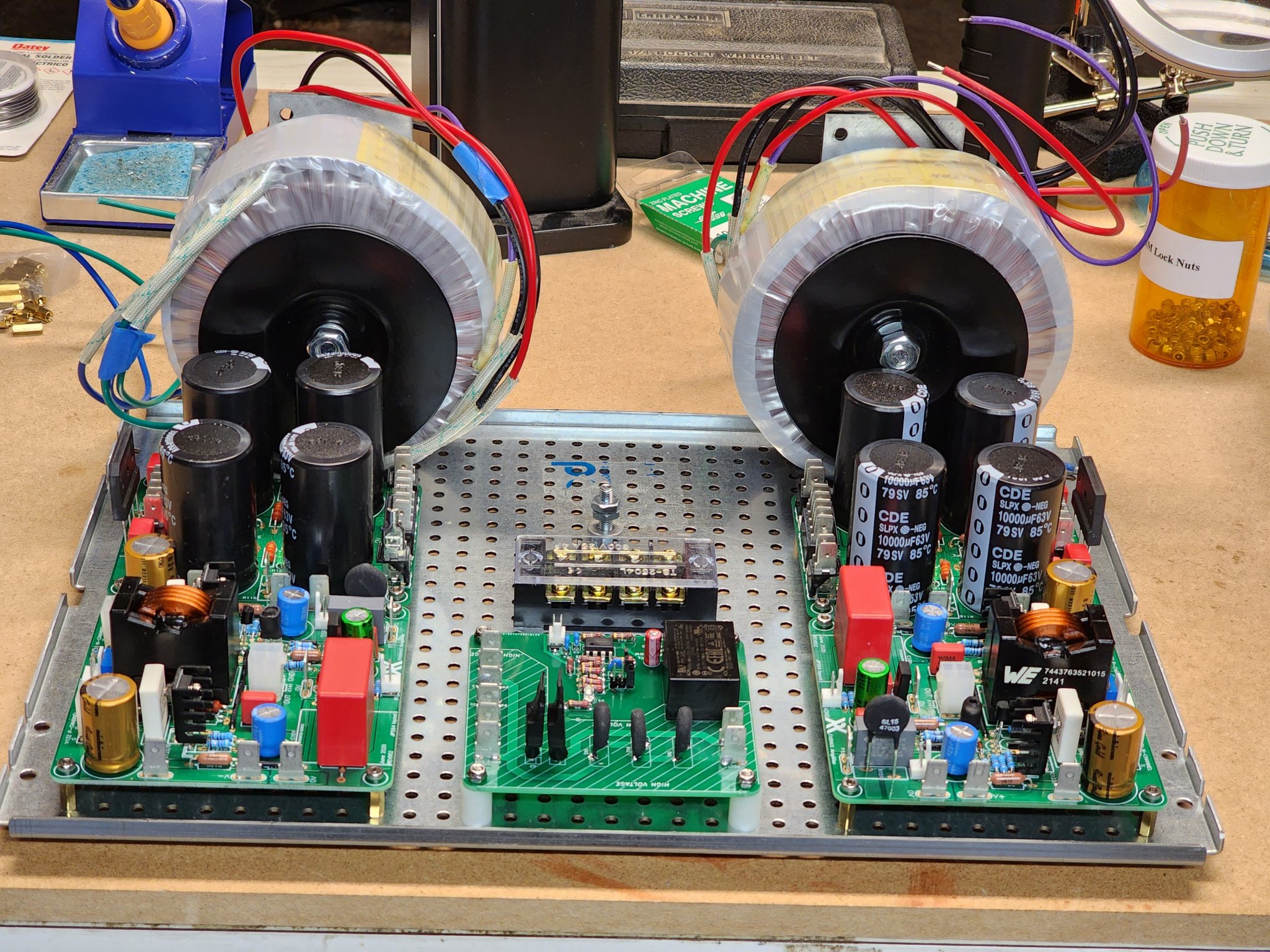

Good morning DIY'ers,
Progress report on my FH9HVX build.
Now that I've moved on to mounting my PCB's to the chassis. I'm making good progress. However, I do have a concern. As you can see from the pics, space is at a premium with the dual mono option.
My specific concern is that in order to fit everything with this layout choice, I have the PSU and amplifier pcb's basically touching each other. I can't imagine this is ideal. Are the traces sufficiently recessed that it's a non-issue? Could I put Kapton tape along the edges? (Or is that a cheap hack for a poorly designed layout?) I'm sure this is a basic question but this is my first amplifier build.
I could mount the amplifier boards on the heat sinks if I have to. I don't have a good reason not to, as they are already drilled and tapped. Thanks in advance for any experience/advice you may have.
Dave M.
Dave M.
@UncleMud
That looks like you have a very nice build going there! Just make sure all you V+/V-/G connections on the boards are insulated. The space between the electrolytic caps on the All Cees board and the amp board where you will have insulated Fast On connections may be a bit tight - hard to tell from here.
I personally like to mount amp boards directly onto the heatsink in order to relieve space inside the enclosure (for extras if needed). But that’s a personal preference. This is up to you as you already are using Mosfet snubbers for the build. Make sure the connections to the Molex connectors are nice and tight - i.e. not loose. If in doubt, direct solder but since you already tested/biased the main amp boards with the Mosfets on the snubber pcb’s, I am thinking you are good to go.
The pcb’s touching - I don’t see that as a problem.
It would be most preferred that the L-brackets where the toroids are mounted don’t touch the front panel. There should be an airgap. This is to prevent shorted turns. This is less likely given that the front panel is anodized. If in doubt use some nonconductive piece of adhesive/plastic/kapton/something to prevent that! The L-brackets should be tightly adhered to the steel sub plate with locknuts. In other words, if you were to pick this amp up and shake the hell out of it, the Toroids don’t physically move or move as little as possible! In some builds, I have seen two L-brackets per toroid primarily for this purpose. This might not be too much of an issue for DIY builds but in commercial builds, the Toroids can shake loose in shipping - so keep that in mind.
Make 150% sure that the final nut on the chassis ground connection is a locknut. Think of it this way. Imagine if your amplifier was thrown from a building (which is what shipping companies do!), everything might break but the final connection between IEC ground and chassis ground should never break. Make sure that that wire is of a sufficient gauge. Don’t use a tiny 24 gauge wire. I usually go for 16 or 18AWG, whatever comfortably fits. I am happy to see that your chassis ground connection is a dedicated connection. All too often I see diy’ers attaching the chassis ground to the IEC terminal mount or a Toroid center mounting bolt which is completely wrong. It should be a dedicated connection solely for that purpose. It’s a safety thing!
I am very pleased you are using a terminal board with a cover - that’s great for safety, and accidental hand waving, cat crawling, etc…
Best,
Anand.

Hi UncleMud,
Anand is spot on. I would mount amp PCBs on heatsinks to free up space as well. Keep amp PCBs close to heatsink to minimize wire length to MOSFETs.
Were you planning on using RTR SSR speaker protection PCBs?
Those are now in stock.
Great work!
Great work!
Thank you XRK and Anand for weighing in with your thoughts. You've both been a ton of help to me and I'm grateful.
I've decided to make some changes based on concerns I already had as well as your feedback. First of all the amp boards will be moved to the heat sinks to free-up space. More importantly, the L brackets are coming off and being replaced with a much heavier pair I considered but passed on. I don't think there is any chance of the toroids touching the front panel, but I was already on the fence about the strength of the current brackets. I want my build to be rugged and 100% safe. Regarding the wire I plan on using for wiring to safety earth I purchased some high quality 16 AWG so I should be good.
Lastly, I do plan on using the RTR speaker protection boards I ordered from X. Sounds like they should arrive in plenty of time. I plan to mount them directly to the back panel if space allows. I may be offline for several days while I make these changes. I'll keep everyone up-to-speed though.
