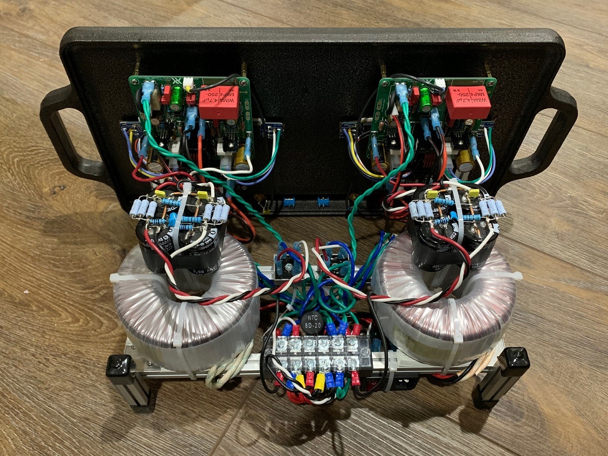

I used L brackets from toroid.com, they are pretty heavy duty. Specifically the L-300's.
https://toroid.com/l-bracket-mount-toroidal-transformers/
Good plan to put the amp boards on the sinks. However, it looks like one other option may be available to you. Thinking "inside the box," you might have enough vertical space to add the modushop riser panels on standoffs and put either the cap boards or amp boards on top. In yet another orientation, the riser panels could be mounted on their sides to the base plate and the amp boards attached to them.
Very interesting possibility von Ah. Thank you for pointing that out. It seems I have a number of options available.
https://diyaudiostore.com/collections/accessories/products/riser-panelsGood plan to put the amp boards on the sinks. However, it looks like one other option may be available to you. Thinking "inside the box," you might have enough vertical space to add the modushop riser panels on standoffs and put either the cap boards or amp boards on top. In yet another orientation, the riser panels could be mounted on their sides to the base plate and the amp boards attached to them.

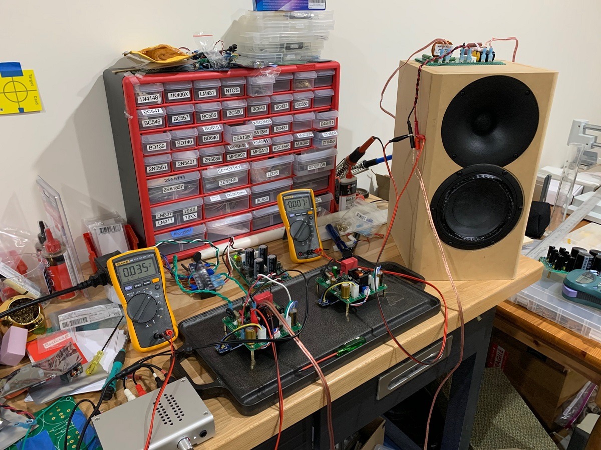

I’m surprised no one has tried the griddle amp chassis for their FH9HVX. $10 heatsink is hard to beat.
I think a griddle amp with a neat plexiglass shield to protect the components would be slick.
Took the FH9HVX off the stand today and put in a tiny bit of work.
First, I put some shrink tube on the 2 input KSC1845's, not too bad on the module where those BJT's were at the top of the chassis, but the other board took some finesse with tweezers, I really didn't want to disassemble the whole chassis for that.
Secondly, I moved from 33mV to 44mV, it's only been a few minutes since I buttoned it up, too early to comment on the audible changes. However, the heat sinks are still barely warm. Idle temp is about 31C. Idle energy consumption per a TP-Link HS110 is ~58w on 120vac.
Even a wooden crate with some vents can work. The amp doesn’t get that hot so should be easy.
Matching the input transistors can help reduce the dc offset. Although anything under +/-50mV is fine. Use a transistor tester to find a pair with very close Hfe. You’ll need about 20 to really get a good match. But it’s not going to make an audible improvement IMO.
Good point on the dc offset, I have a gigantic bag of shrink tube and figured why not since I am in there. Completely agree on the lack of audible improvement, I think I dropped the offset maybe 0.5mV, negligible to be honest.

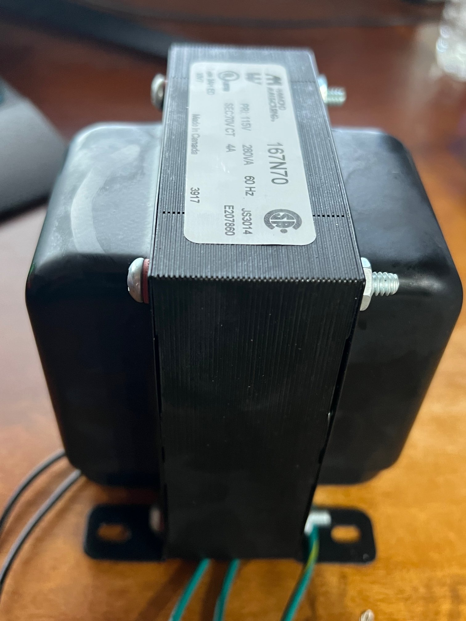

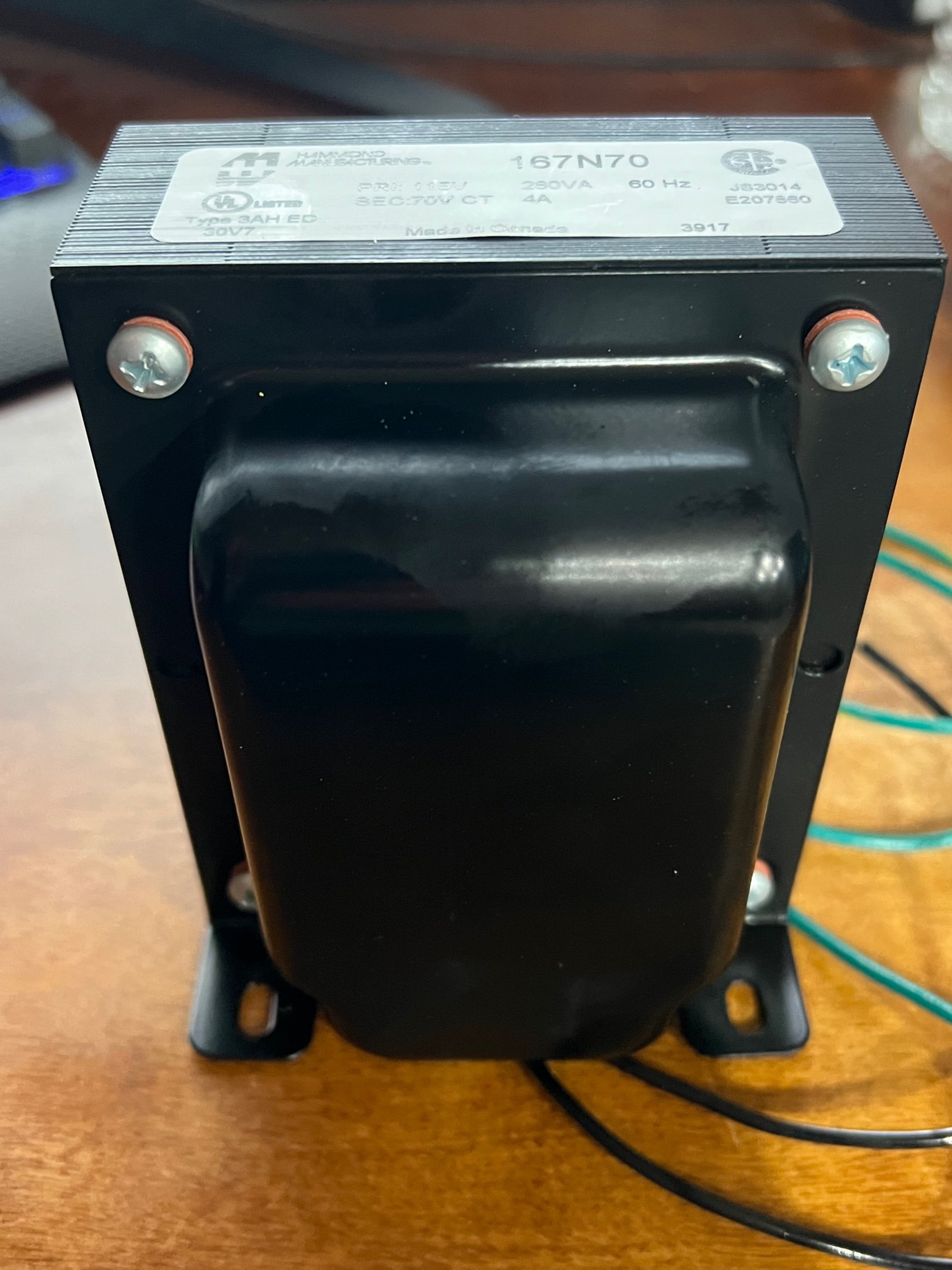

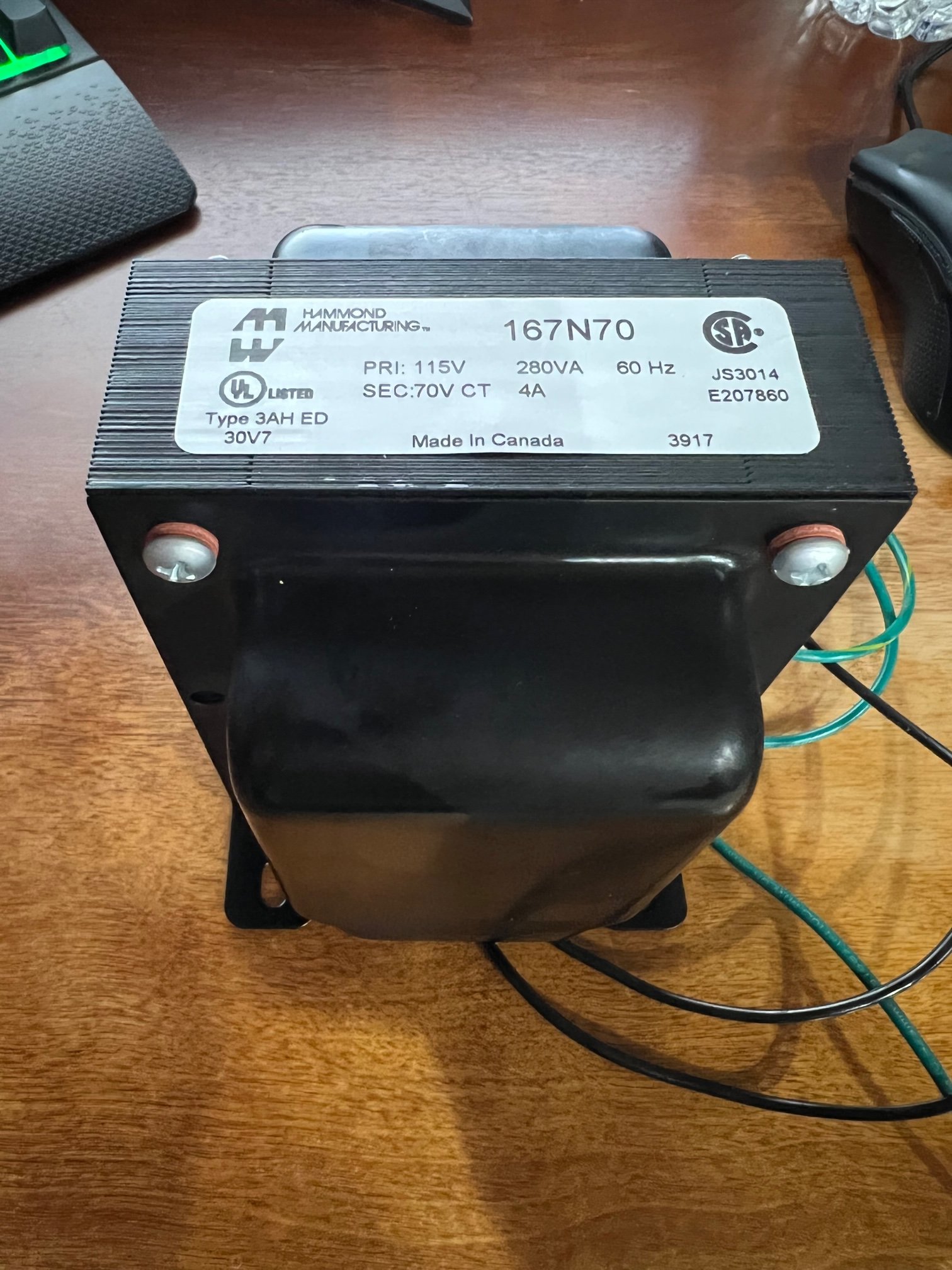

Toroidy has arrived.
Enclosure is next…
Best,
Anand.
And manufacturing date was just nine days ago! Amazing.
Also: congratulations!
