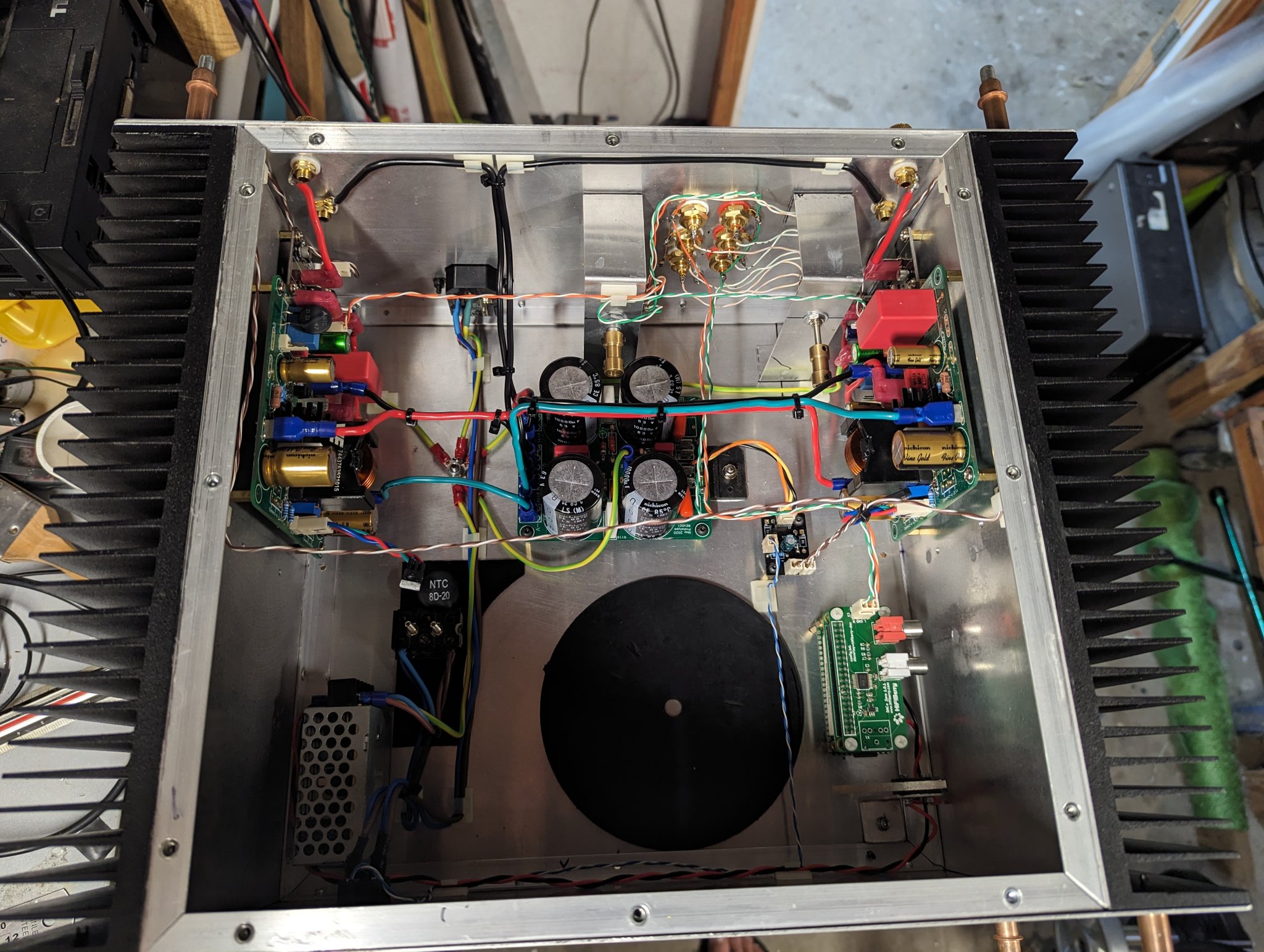

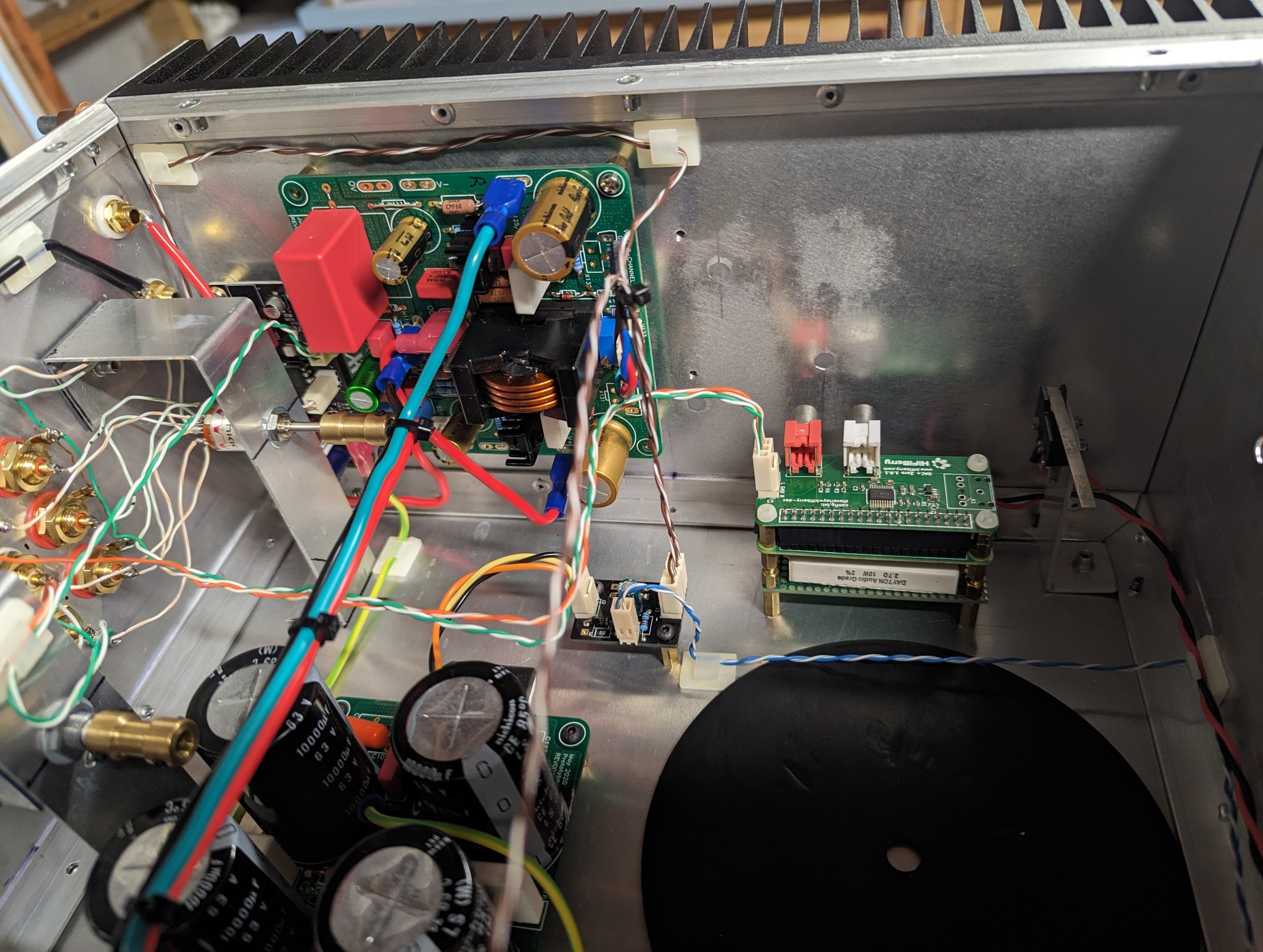

Might think about placing the two RCA inputs next to each other, you can reduce the loop area that way. Also allows you to connect both signal grounds, to also reduce loop area.
I believe HRDSTL is building a dual mono psu, in that case you wouldn't want to connect the input grounds together.

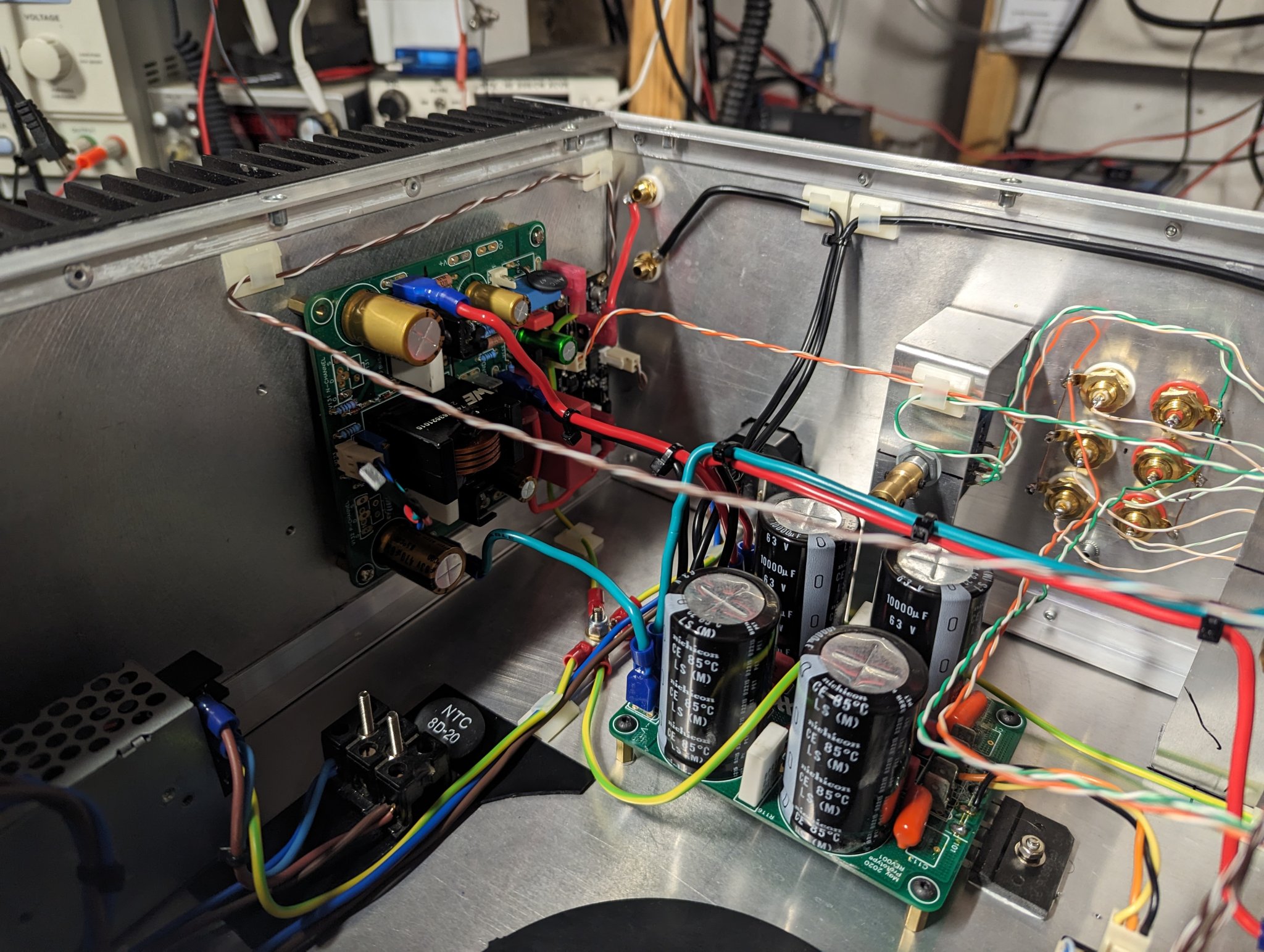

Today I got 2,5mm2 cables from aliexpress, hard clumsy, ...they ended up in the trash.
So I ordered Mogami 2919 (6x 2,5mm2), proven quality. I have to strip them of the outer wrapper, and they will be twisted. I'll probably use the black and red for speaker output. The rest will be used for the power supply part.
For the signal part I ordered MOGAMI 2514 in several colors and I will either make a version with two twisted wires together or I will use a high quality shielded MOGAMI 2803 (I have this one at home).
Many of us on DIYA use “RC Drone / Helicopter” battery wire for amp projects. It’s very high strand count copper wire that has heat resistant soft silicone insulation. Designed for high current situations and places very little mechanical strain on joints since so flexible. Available like tap water due to $B drone industry.

Hi.
Almost done the new chassis with big heatsinks l, just waiting on thermal pads then I can mount the new FETs..
Cheers.
Cheers.

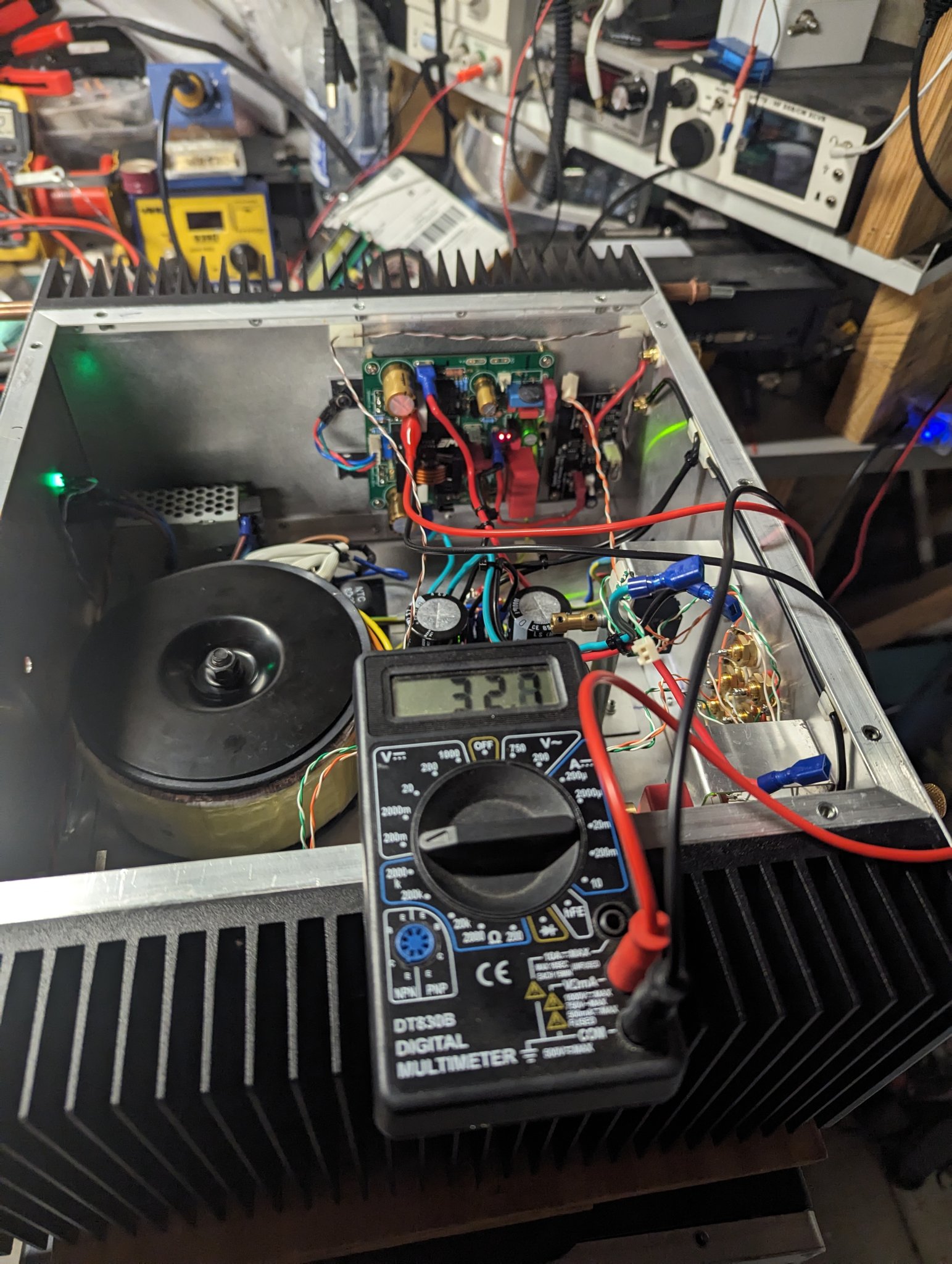

It's alive!
I must say the IRFP FETs are much nicer from a mechanical point. There are no sharp edges on the backside like the FQA devices.
Shooting for 44mV or 200mA bias.

Nice, ...personally, I would not put the transistor for temperature stabilization over wires, as it is very close to the power mosfets.
32 mv DC offset?
32 mv DC offset?
I have a feeling that DMM reading is across the current source resistors. See how the leads swing back into the enclosure.

Yes you are right, .... but in that case 32mV =145mAI have a feeling that DMM reading is across the current source resistors. See how the leads swing back into the enclosure.
Yes, but remember he said he was “shooting for” 200mA bias, which means he was in the process of reaching that value (at the time the picture was taken 😉).Yes you are right, .... but in that case 32mV =145mA

HI.
Yes, still in the calibrating stage.
I have had the amp running for 6 months before and then the FQA on the left channel went POOF for some reason. Now I'm running the IRFP as the FQA are end of life... I also used much bigger heatsinks now,
I love this amp, very dynamic sounding, strong base. Suits me perfectly...
Best of all I am able to repair it and it still cost me less than a low/mid end commercial amp. (Yamaha Pure Direct anyone?😏)
