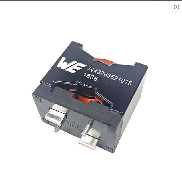

18ga minimum and 12- to 15 turns around a mandrel. I use a AA battery to wrap the wire.
Or buy the premade Wurth super inductor. That’s super heavy gauge and looks cool.

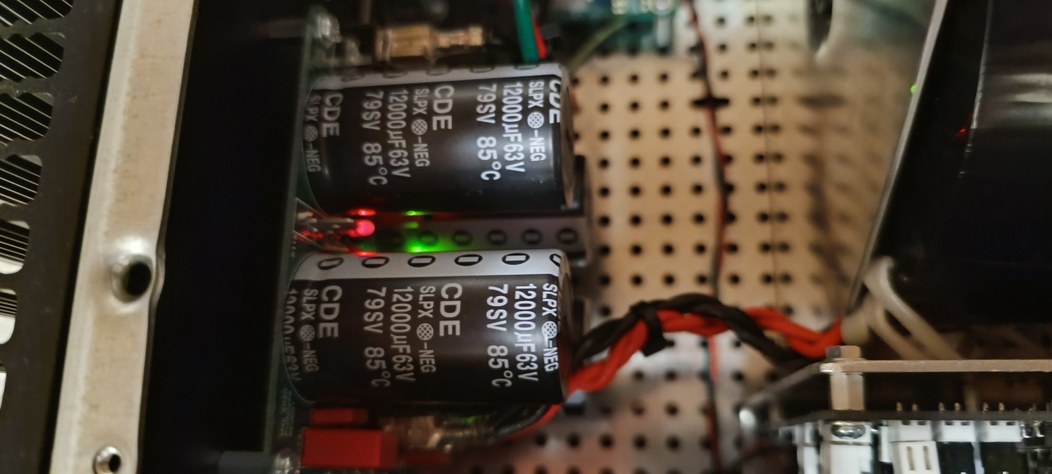

I'm about to build this amplifier as a vacation project and I go for the budget friendly version. That said, it won't be nearly as cheap as the outline on post number #1. Price hikes on electronics, inflation and a weak currency takes it's toll. I just now finished ordering a the components from Mouser, and cheap it wasn't... Earlier I bought the PCB:s from X via Etsy.
That said, I will reuse as much components I have as possible. The transformer is a used 2x ~36V, about 240 VA I already have, discrete diodes as well and then a pair of used Kemet PEH169 10 mF caps for first stage in PS. Second "stage" will be another (cheaper...) 10 mF per channel close to the main PCB:s.
Chassis will be a home made "temporary" thingy build on a wooden board. This is until I can decide what to use for a permanent solution. There will probably not be enough cooling for maxing out this amp as the cooling fins is something I got on surplus many years ago.
Pictures will come as the build progresses.... slowly.

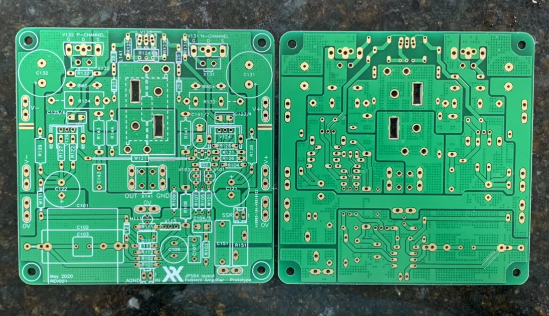

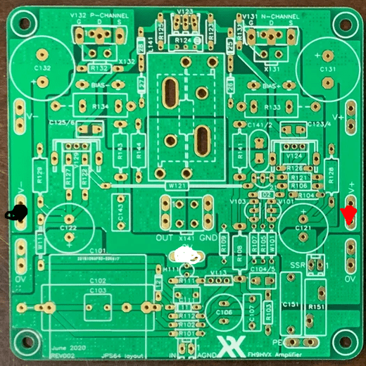

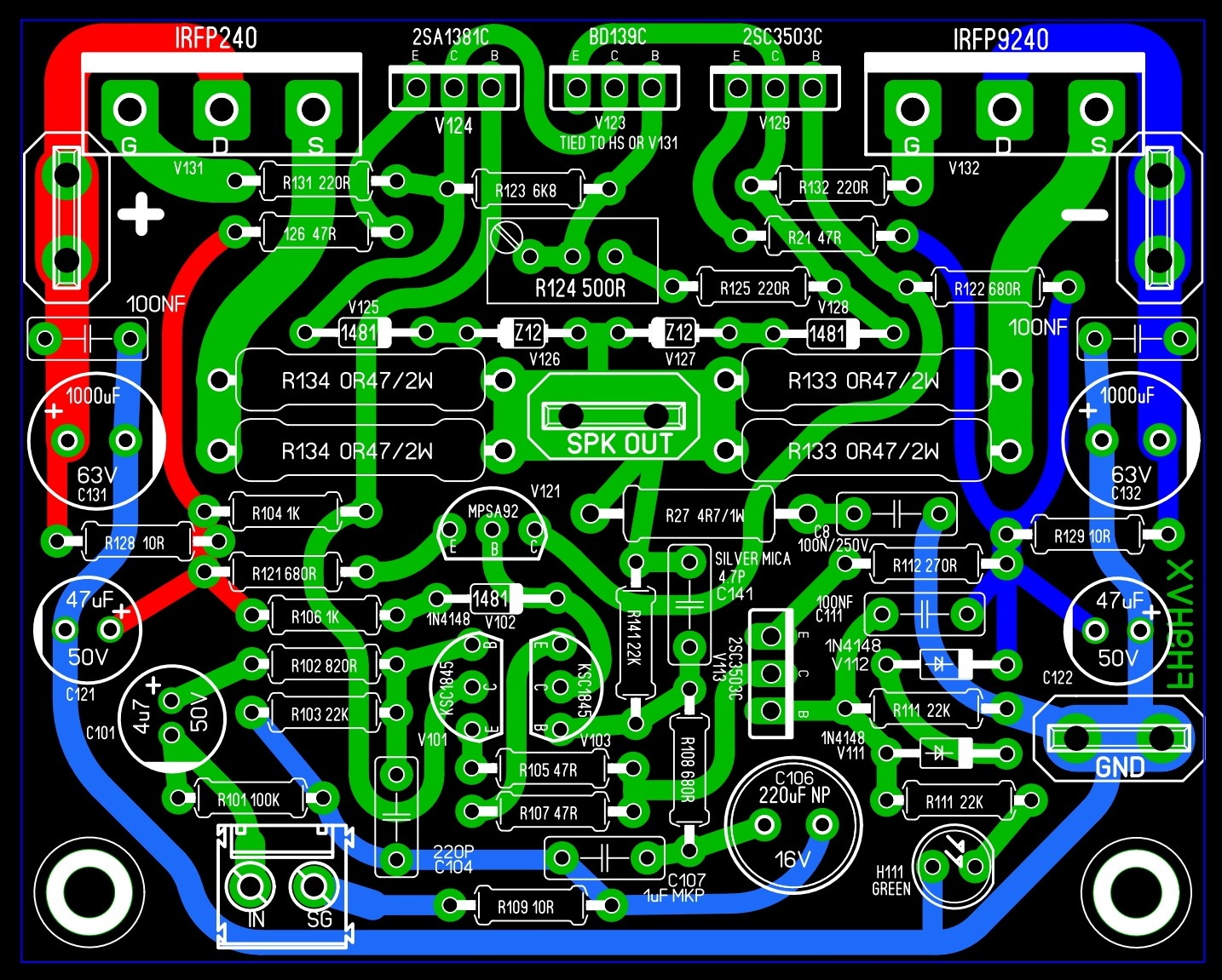

I modified the pcb for mosfet version
Thank you x
Not sure I follow you, the FH9/FH9HVX has always been designed for TO-247 style V-MOSFETs. The layout above looks very similar to the FH9 layout done years ago by S.K. Kachhap (Sonal K):
The current layout of the FH9HVX by JPS64 provides added benefits of via-stitched low impedance double traces on both sides for high current paths, optional external flying leads MOSFETs, and a spot for a Thiele output inductor, among other things.
Hi x,
yes it was from Sonal K pcb design.. what i meant is the small transistors track was rerouted to replace it with KSC1845 and 2SC3503C. I also add the green led.
Hi Coolet,is it gauge 18? 1.2mm in metric?
Thank you x

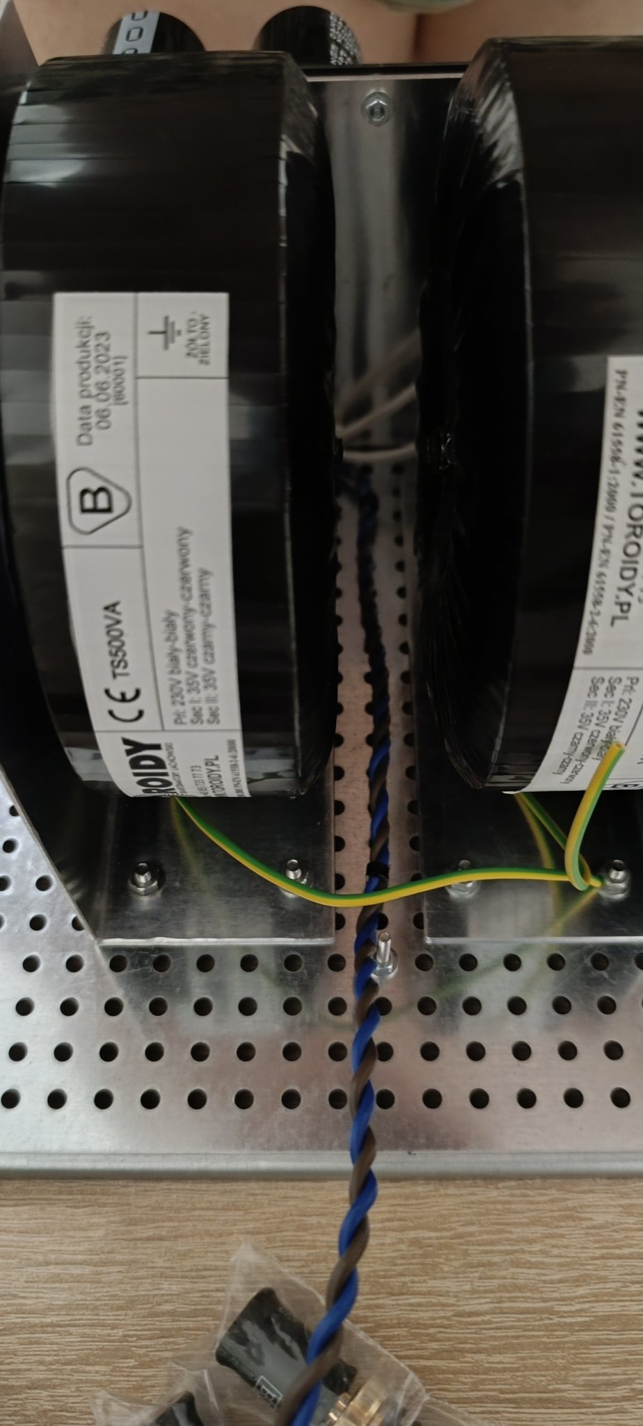

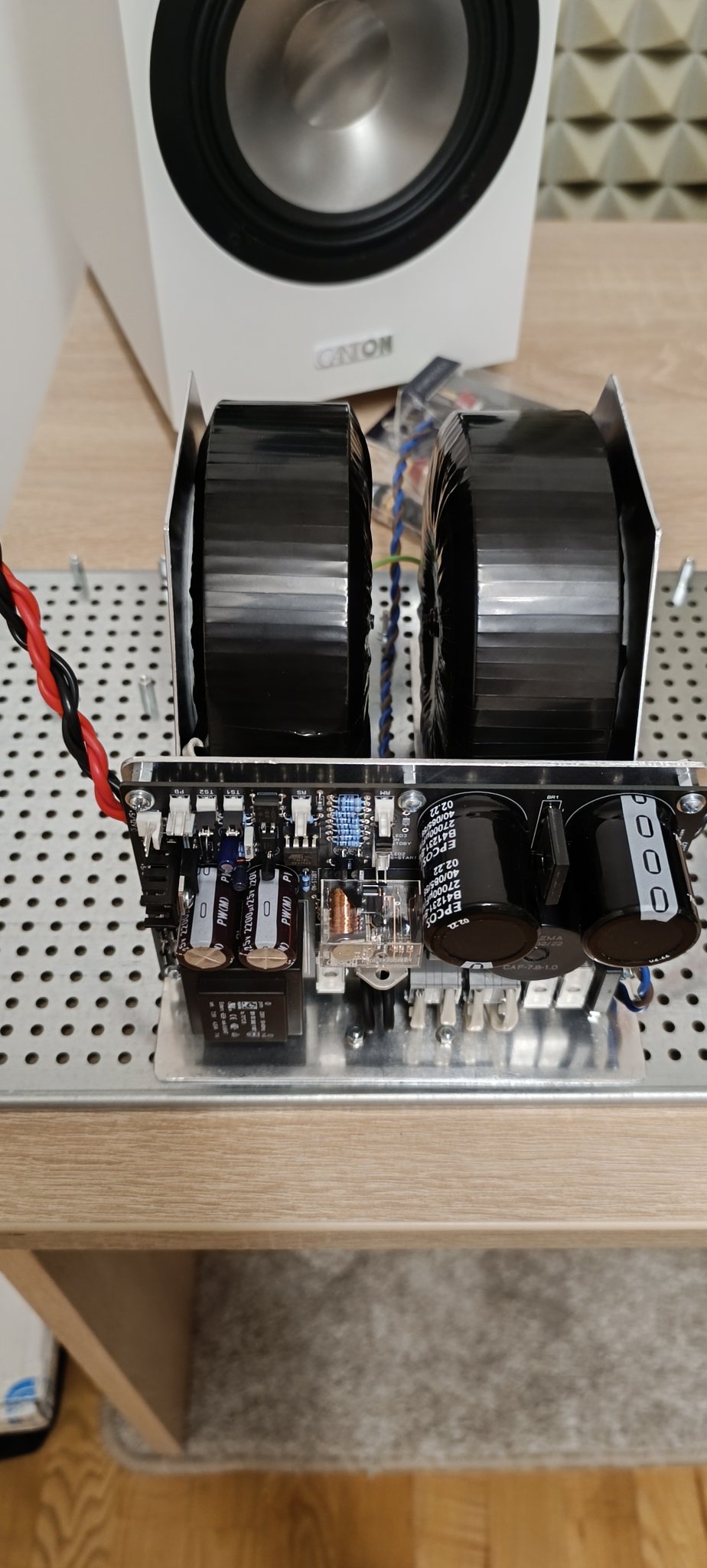

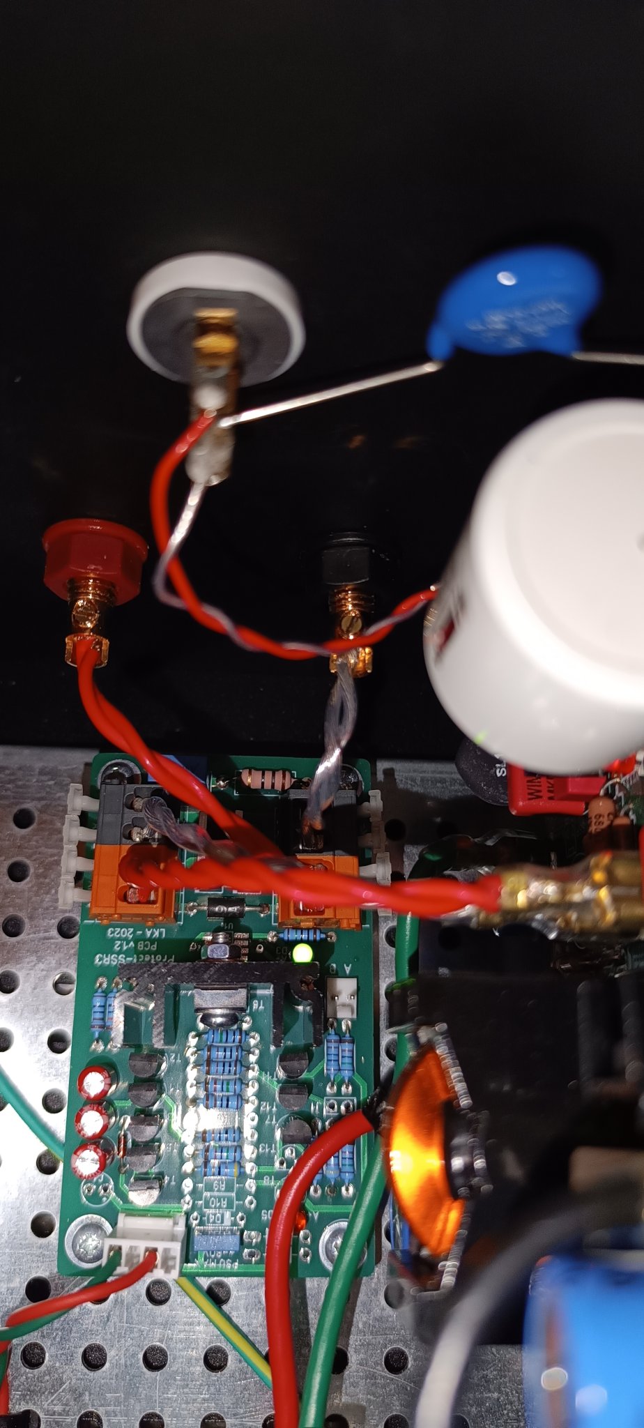

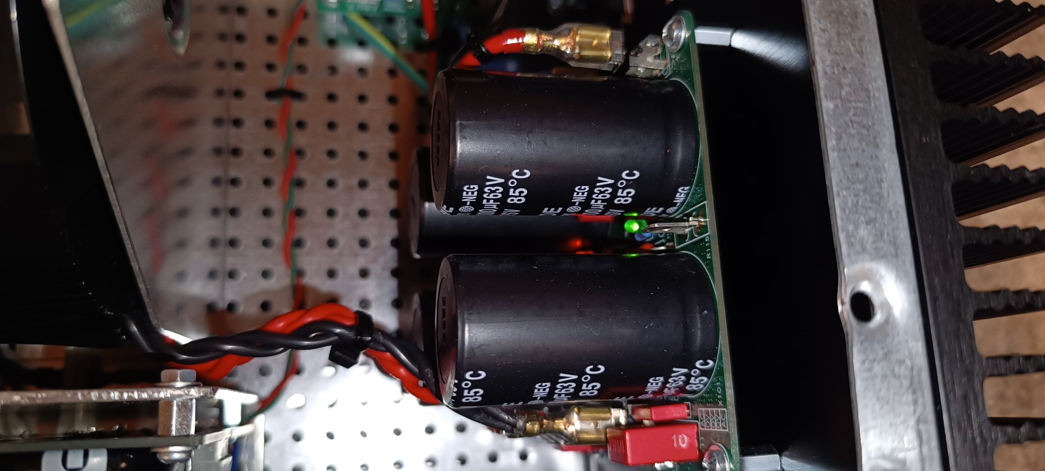

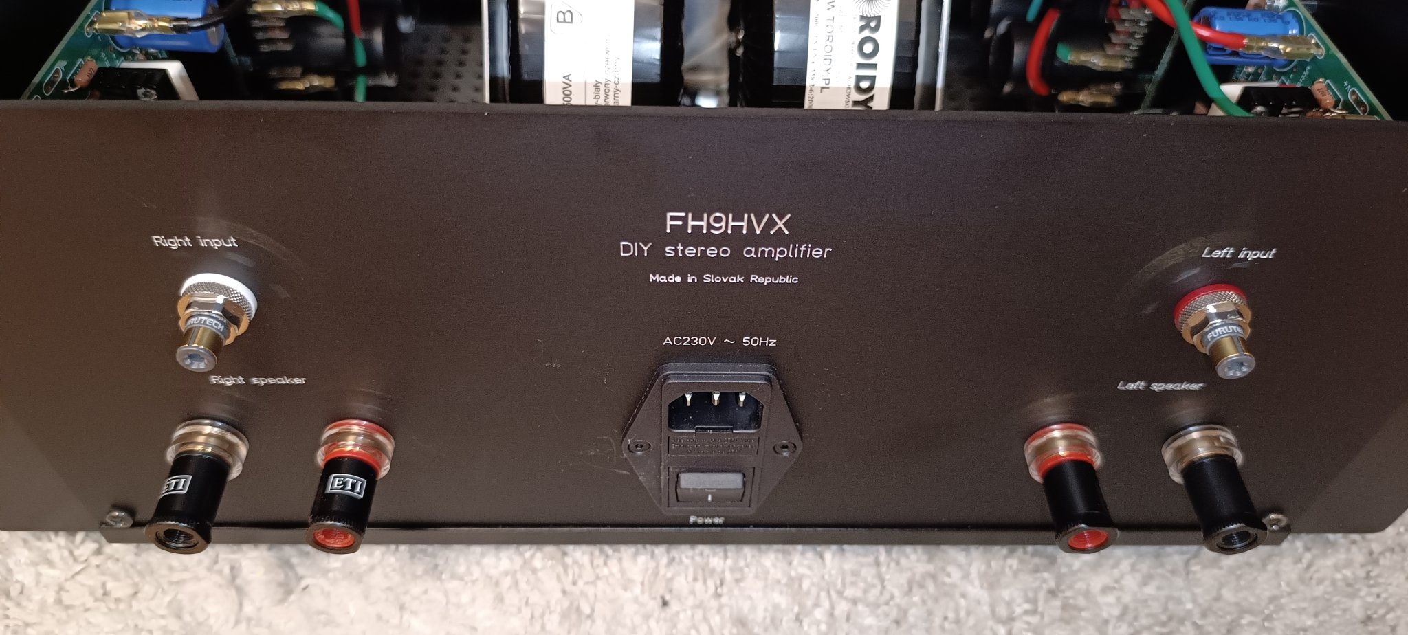

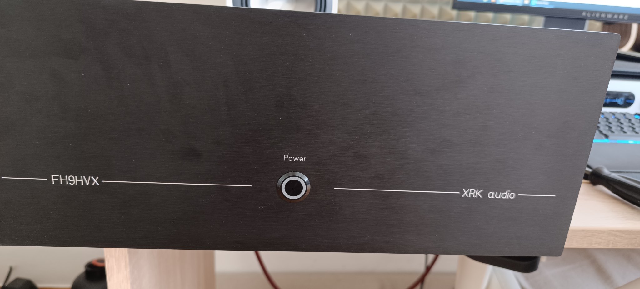

Friends, the front panel mounted, ...gave me a hard time as there is very little space. So far I am at a weight of 17,5 kg it will be a very massive companion.
I have yet to plug in PE. Just connect only the power supply to PE, or even the amplifiers themselves.
Thank You!
Thank You!
I like the sound very much, dynamics throughout the spectrum, ...mids and highs nice. Today I tested different genres on Amazon Music, I have nothing to complain about. The performance mosfets need to warm up a bit, about 200hrs and then it will have the right oomph.
PS: I compared with Audiolab 6000A, in a blind test I would probably miss which set plays
DC Offset: L (3mV), P (6mV)
Bias: 250mA
Hum: none is not heard, very weak noise heard only with the ear attached to the tweeter

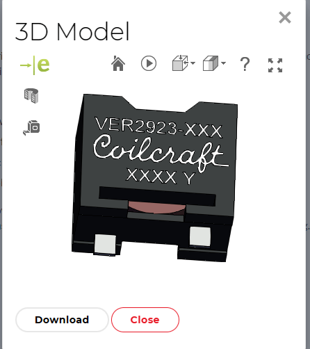

Coilcraft inductors don't work with this board.
Ask me how I figured it out.
I never used flat wire inductors before, and I was sure Coilcraft and Würth Elektronik coils will have the same footprint. I wonder why you didn't design this board to accept both of these brands.
Maybe next batch?
Maybe next batch?

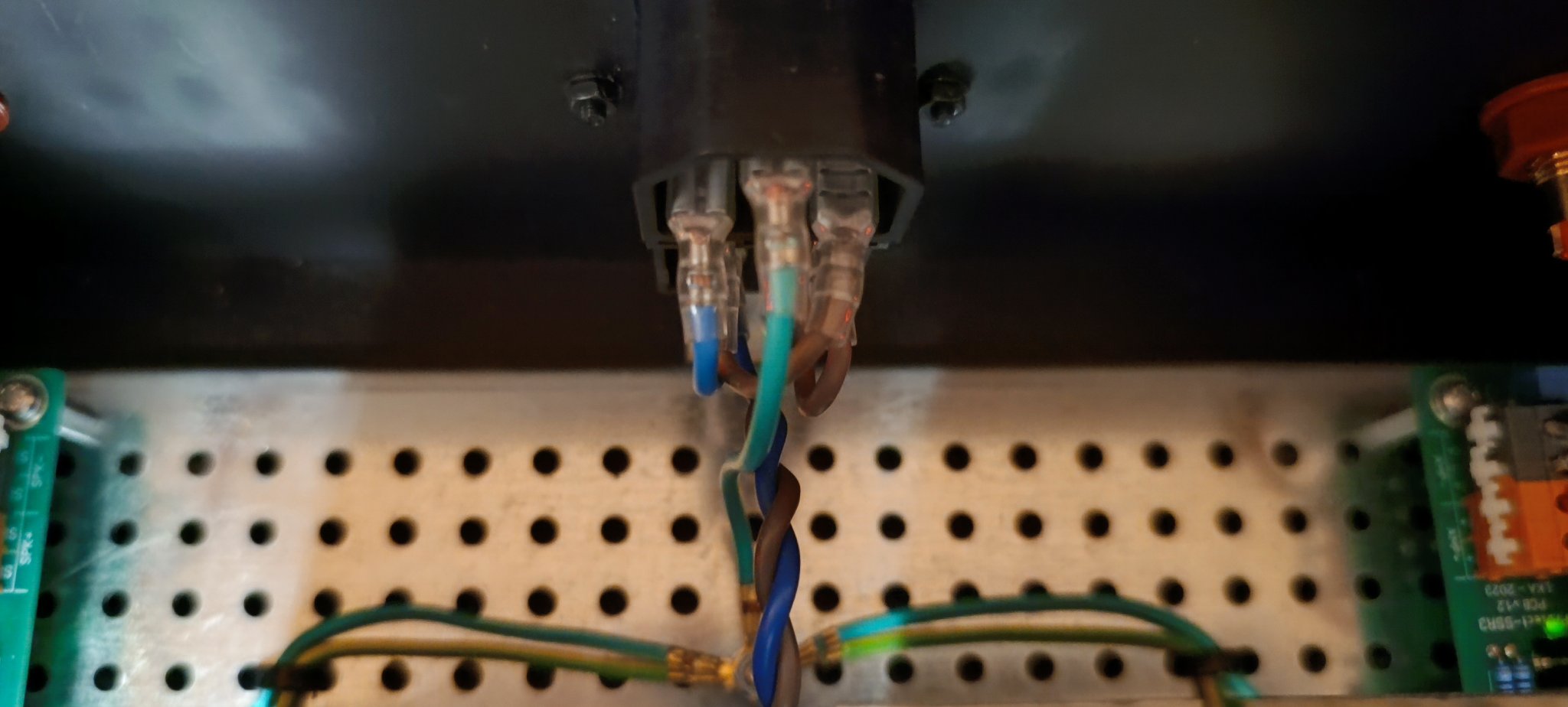

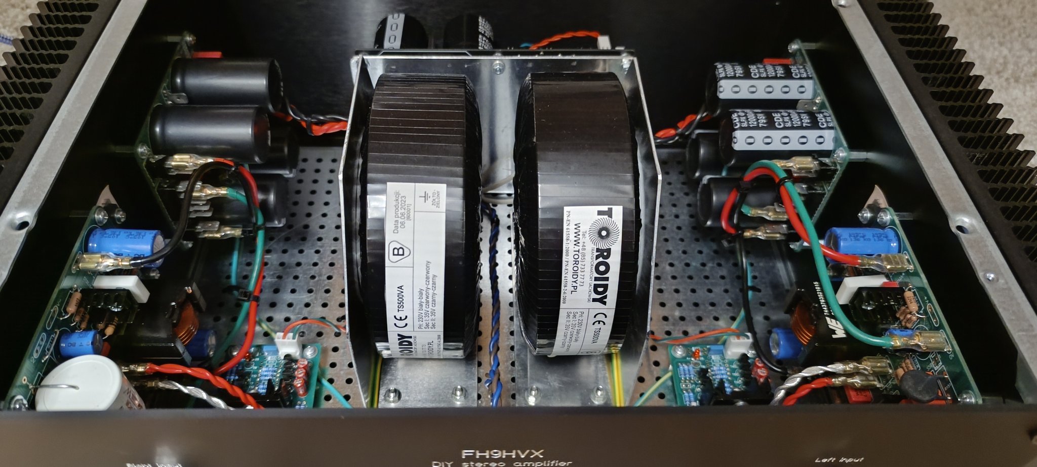

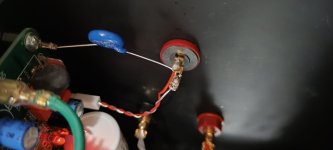

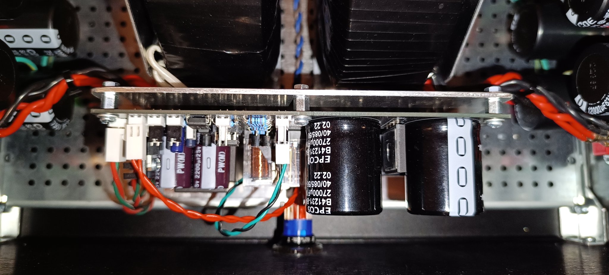

I did a little rewiring of my entertainment center yesterday, cleaned things up and removed a Behringer HD400 that I can't remember why I had in place initially.

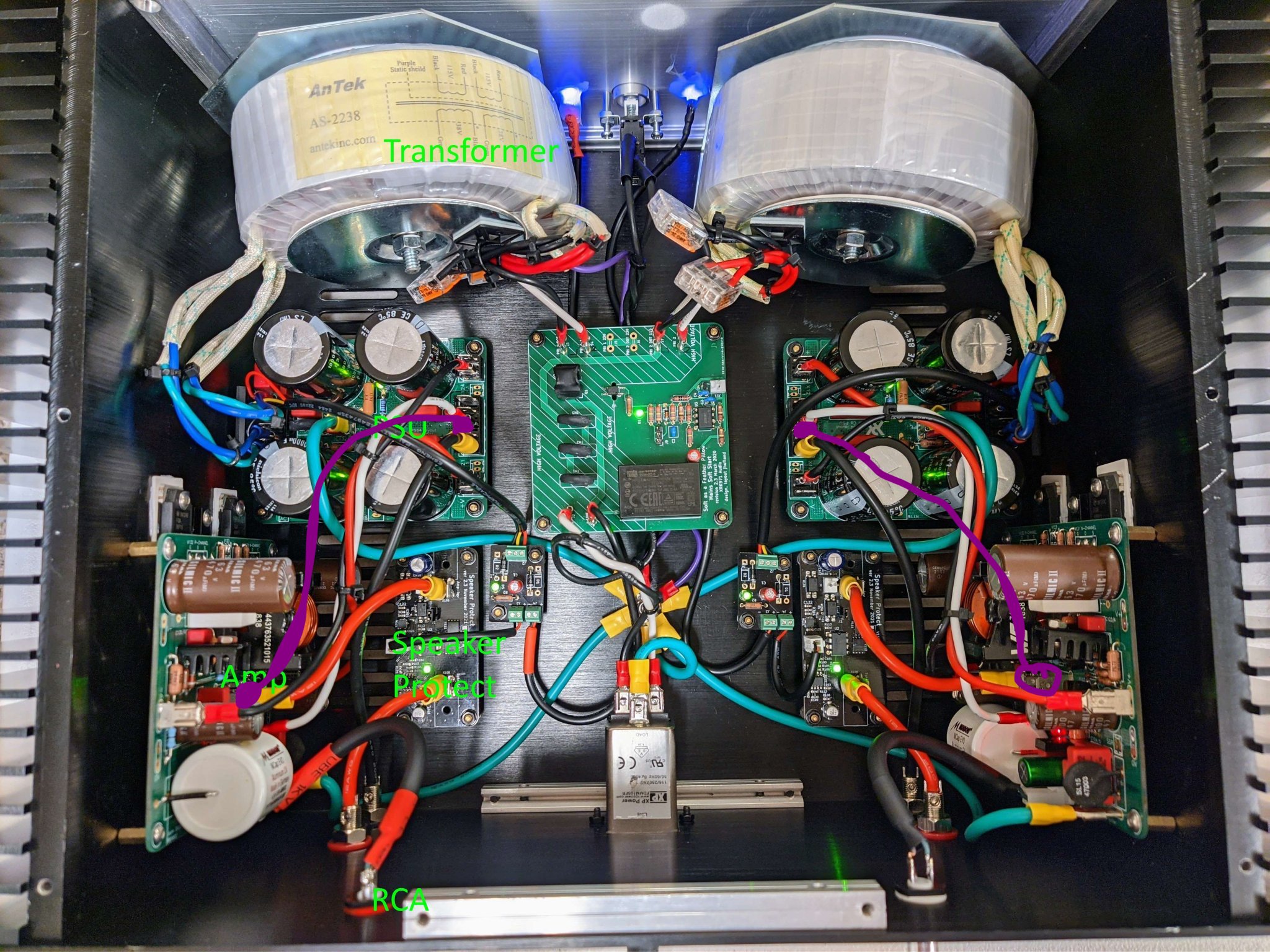

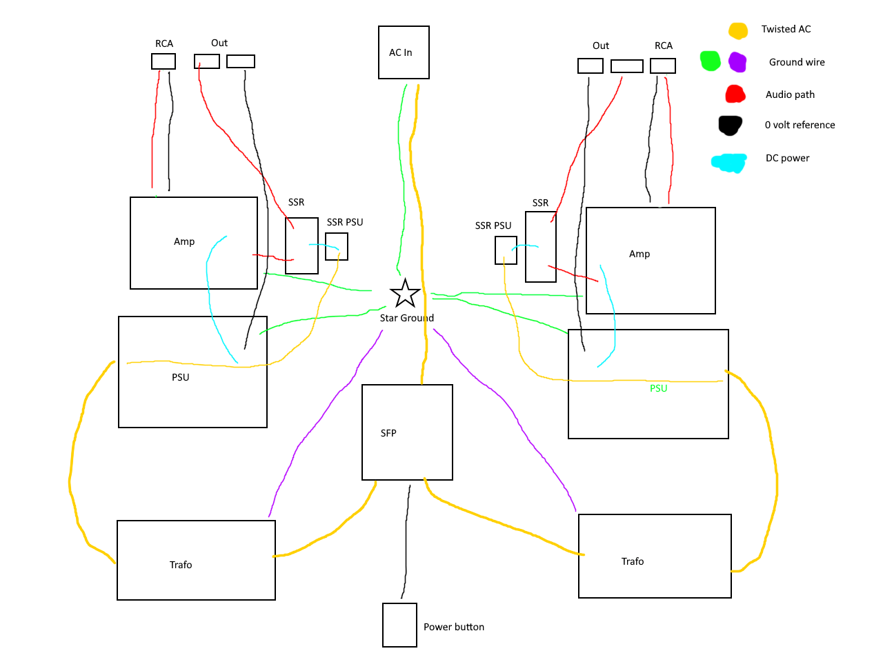

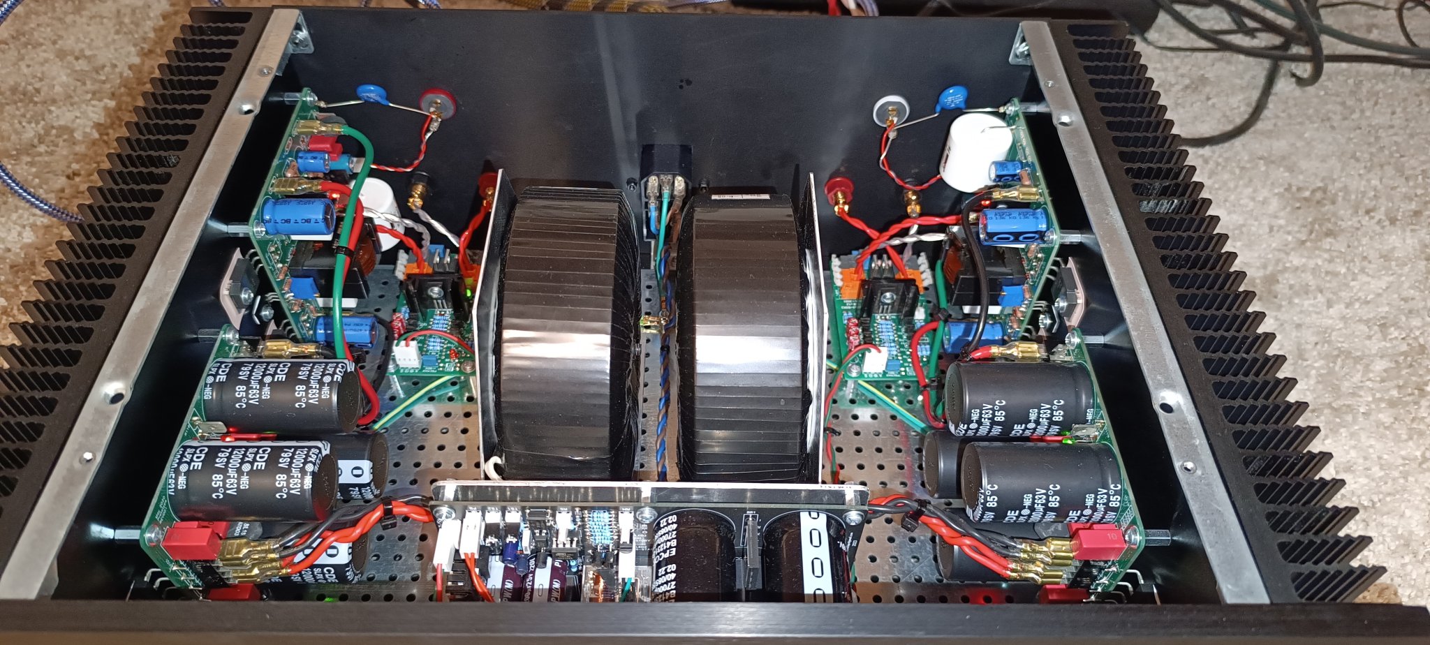

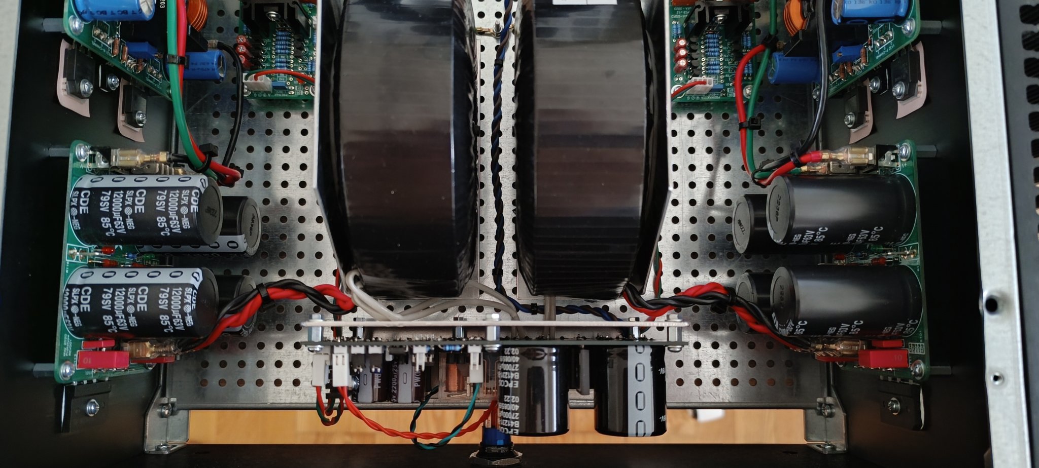

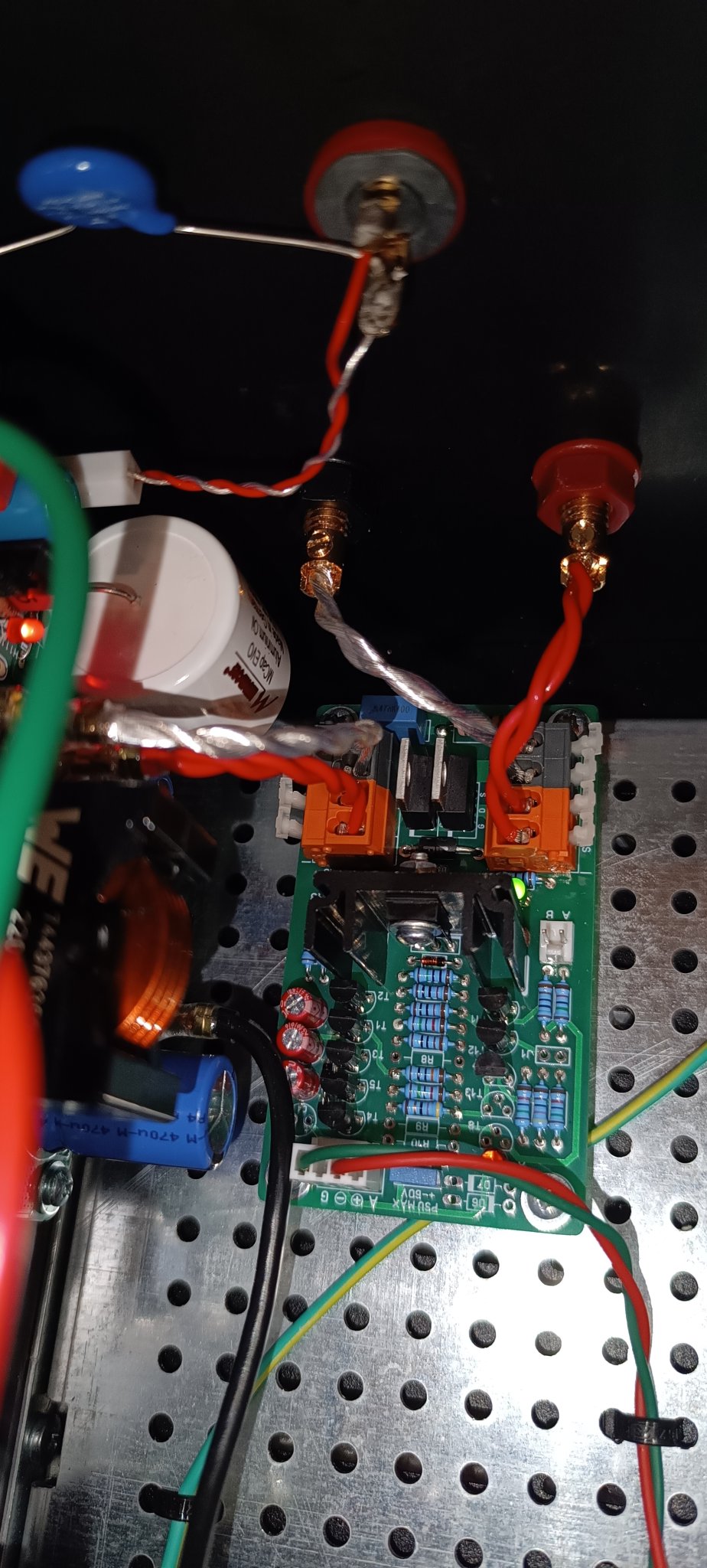

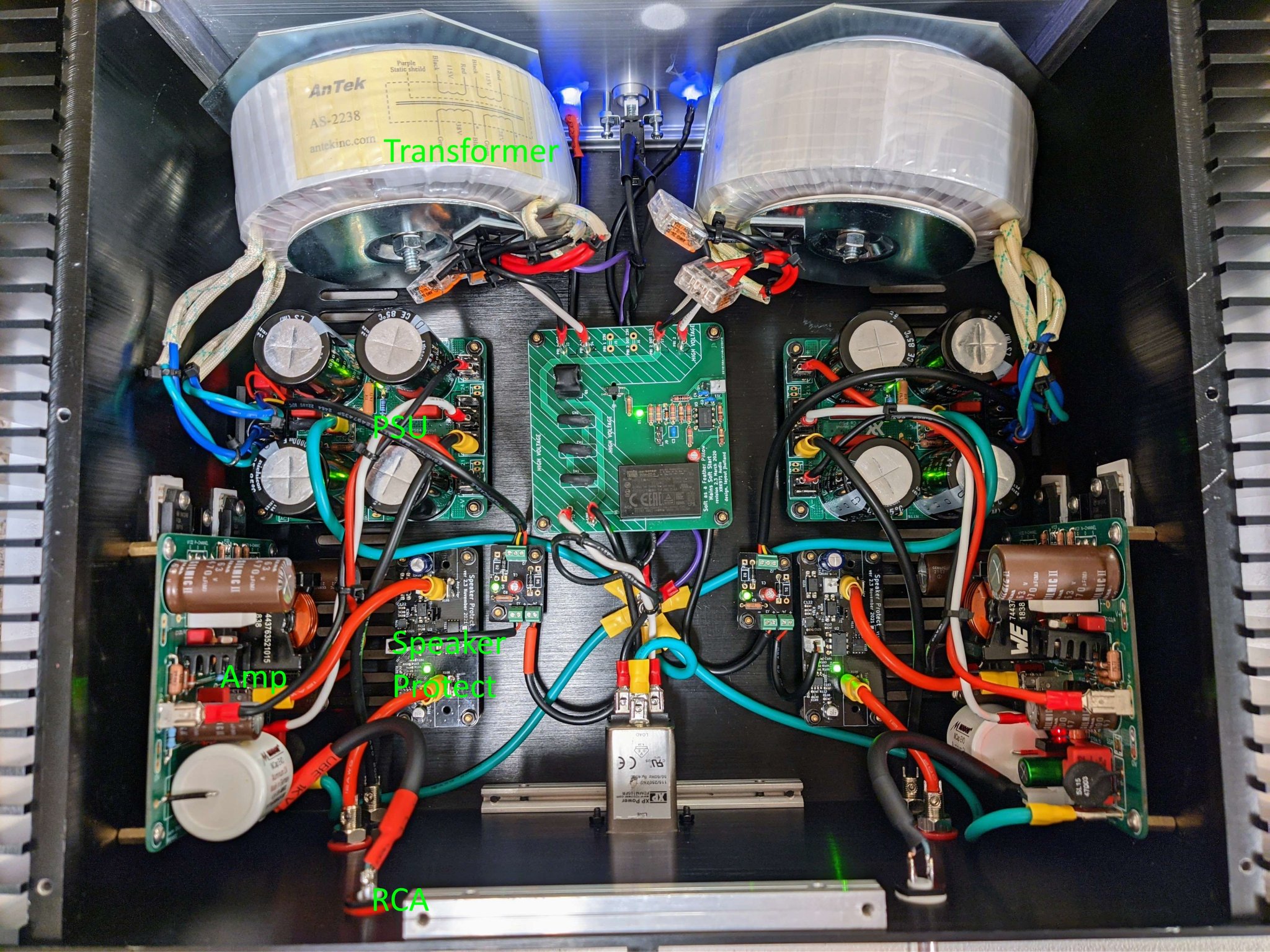

It turns out that my FH9HVX does have hum, and I am not really sure where to go in resolving it. I am hoping that some of the people here have some ideas or see something that I am not. Attached pics of my build as well as a block diagram. Listed out some initial troubleshooting, but not really sure what is next.
- Inputs shorted - no hum
- Inputs connected to each other - minor hum
- Any source (includes battery powered devices such as laptop or phone) connected without line transformers - hum
- Added 22R in series with RCA shield - no change to hum
You look like you have done everything correct.

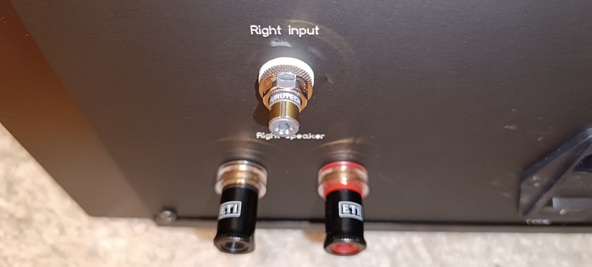

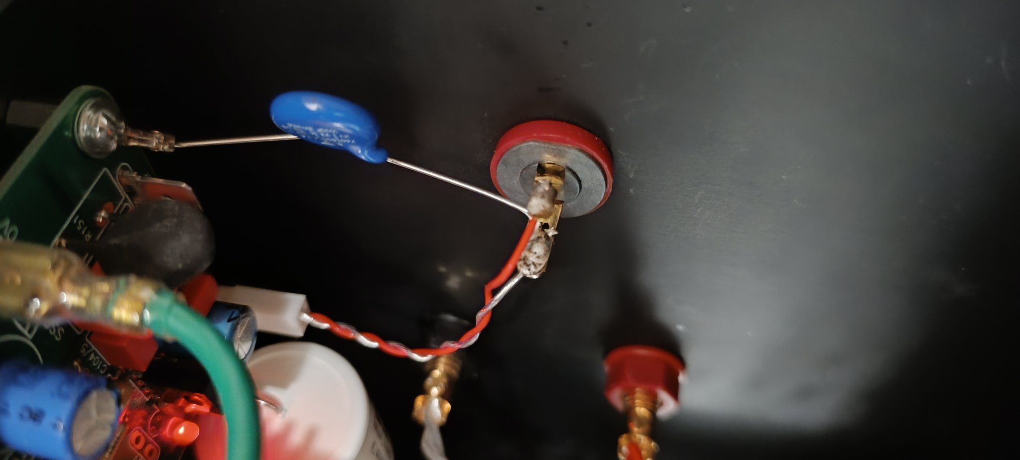

Try connecting the rca panel feed through jack GND left and right to each other.
Next, try disconnecting ground from one of the RCA jacks.

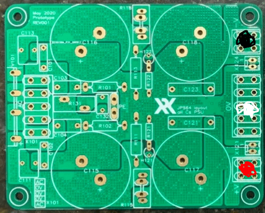

You might be missing the 0v GND between amp and PSU. You have PE from amp to chassis PE and PSU PE to chassis PE but that’s dirty GND. You need a clean GND from PSU to Amp - that gives RCA a low impedance common signal GND. Look at purple trace sketched below:
Thanks X, I will try the RCA changes and report back.
I do have the amp connected to PSU with the 0v ground, but it's maybe 16awg, I can't recall the gauge. Would that suffice or should I increase the 0v to something like 12awg? I color coded your etsy shop pictures of amp and all cee's with my connection points. Red for positive, black for negative, white for 0v. Let me know if I connected them incorrectly or if I should increase gauge of 0v.
BH,
I believe you do have psu gnd connected to the amp board.
Try disconnecting green amp board PE gnd wire from both channels. You already have a GLB connected from the psu boards to star chassis gnd.
Edit, no need for wire that thick, 16ga is fine. You don’t have an arc welder there
