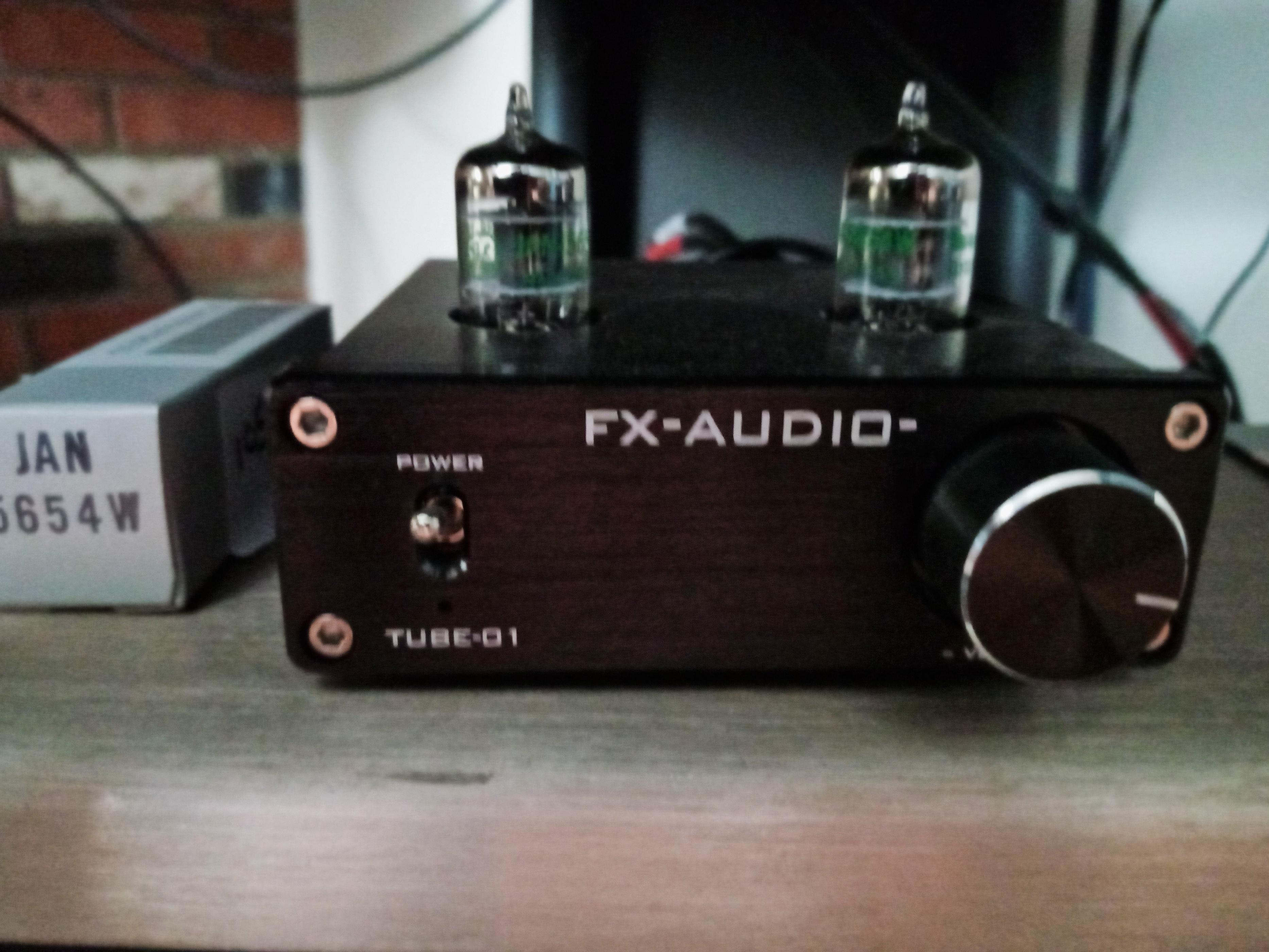

I don't know why I didn't think of this sooner
but today I inserted this little gem between the Akitika PR-102 preamp and my fh9hvx. Wow!
For what's supposed to be a buffer, it sure added quite a boost of creamy tube goodness into the signal chain. Later I may move it ahead of the pre to see what that sounds like but for now I'm really enjoying the sounds.
It's too bad this FX Audio tube buffer is no longer available because at about $ 38.00 it's another of my bang for the buck recommendations. If you can find a used one, grab it & swap out the Chinese 6J1 tubes for some matched GE JAN 5654W tubes for a vast audible improvement of the stock tubes!

Hi Legis, glad you got to try the tube buffer. Nice combo of warmth and bass grip all at the same time.
There are a lot of similar things around for budget tube buffers. The trick is finding one that is quiet. I have tried at least 4 of them in the $40 to $70 range and all had some noise. I finally had to ask Jhofland to design one for me - all DC/DC converters and powered from a 12v wallwart. It sounds superb. Basically an ECC88 interstage buffer inside a BTSB.

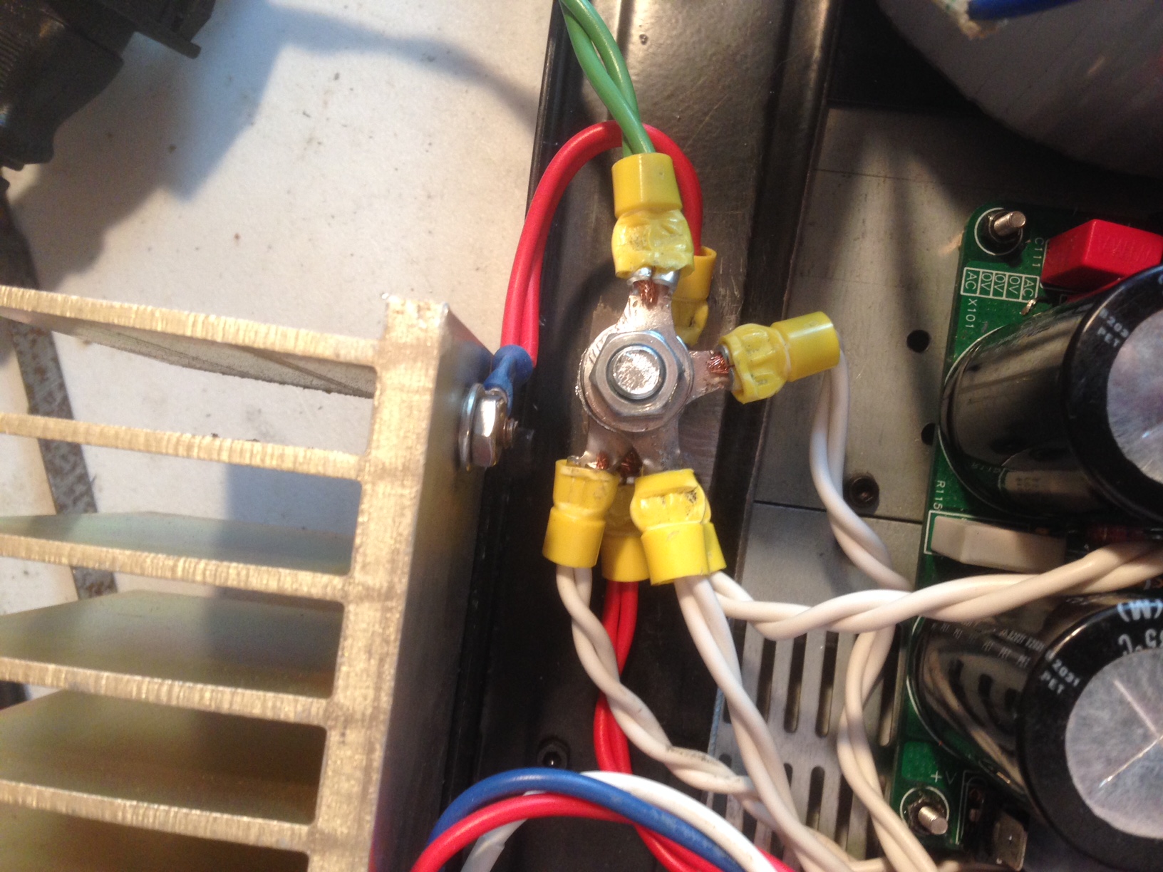

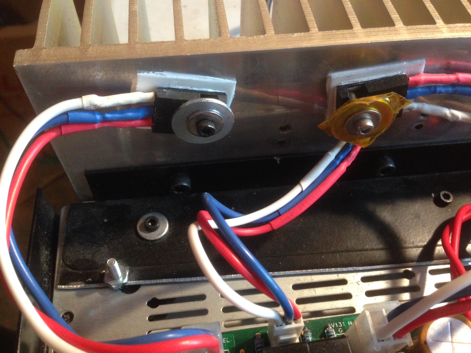

Hi to all builders. I have been having a hum problem when testing my FH9 amp. I think I have it isolated and have an idea of what causes it. Just need to know if I am trouble shooting correctly.
I installed a good ground post and removed the paint from where the post is attached to the chassis ( see pic below).
When powered, I have hum. I can grab the dirty power wires and touch my hand to the chassis and the hum quits. Also the hum quits if I touch the either heatsink.
I believe that I forgot to remove the paint from the chassis where my heatsink bolts attach to the chassis. (see pic below)
I think if I remove some paint it should solve the problem. Does this make sense?
Thanks for the help,
MM

MM…it’s always a good idea to remove chassis paint for the screws that attach structures (like heat sinks) to the general earth ground (if it’s necessary to do so for hum elimination). You can test if items are connected to the earth ground by using the continuity setting on your meter. Hold one end on the earth ground of the IEC (power line disconnected of course) and then touch everything else you want to make sure is grounded.
Cheers
Pete

Thanks turion64,
I am back to basics, One channel connected. I checked for continuity with the multimeter and got constanr beeps everywhere I checked (HSink, main ground with PE and IEC ground, HSink ground, etc.
Powered back up with same results: I can place my hand on the chassis, the ground post, the HSinks, the PS board, the amp board, the transformer, basically any item attached to the chassis, and the hum is drastically reduced.
I thought it might be the mains line, so I unplugged a lot of the items on the lines, but no change.
I also disconnected the soft start and the emi filters, but no change.
The only thing I have not done is sand the paint of the chassis where I attach the heat sinks. I did not do this yet due to their being continuity at all points on the heatsinks, including the bolt that attaches the heat sink to the chassis.
Any idea's as to why touching the chassis or anything attached to the chassis would lessen the hum?.
MM
