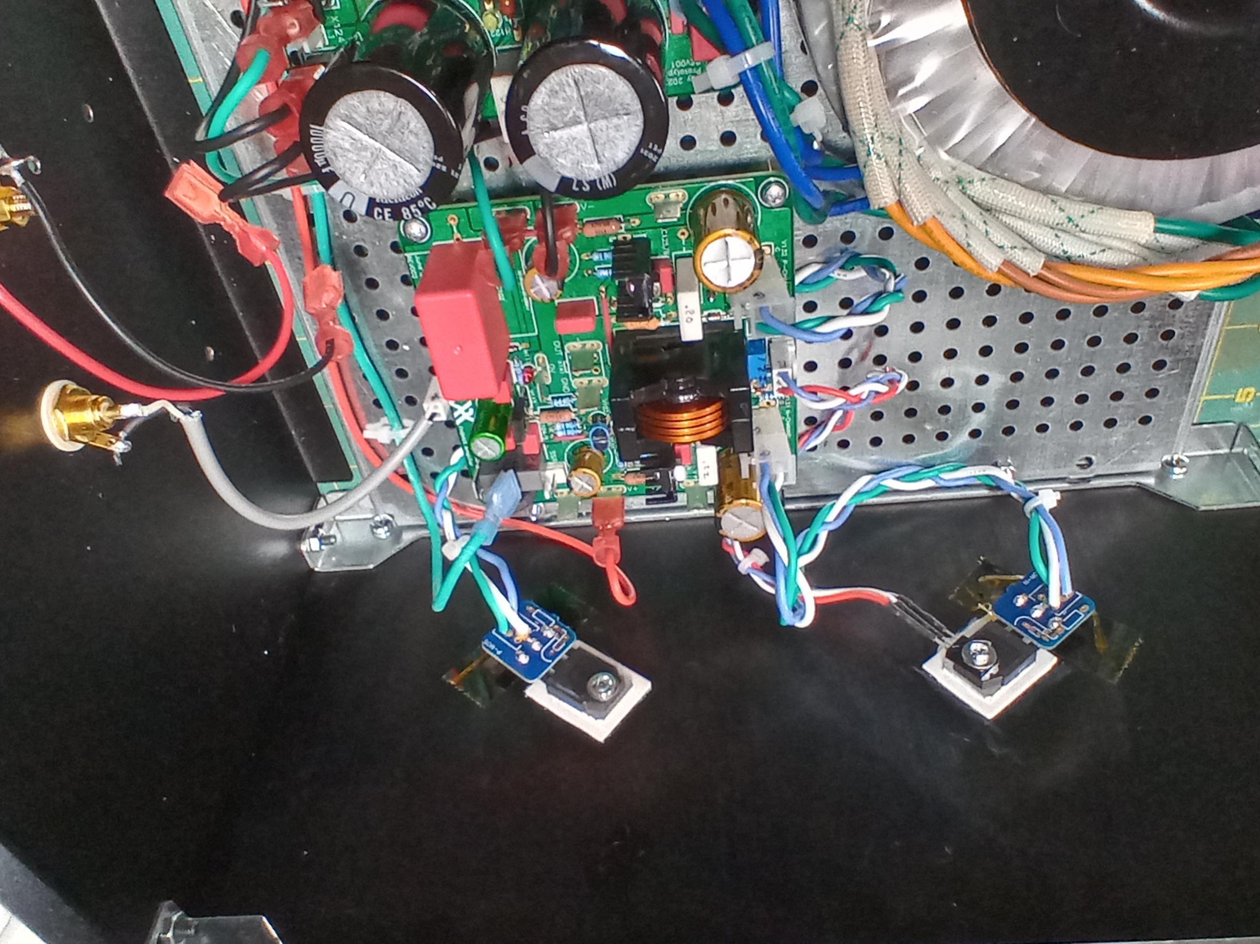

Hi X, Vunce, other builders
I thought I had everything good on the problem channel. All the lights were lt and I was setting the bias and watching the Vout. I went to move my heatsink about 1 inch and that when the smoke began. As far as I know, nothing moved. Shut down and investigated.
Found:
1. N & P MFets are toast. I have one pair of N&P Mfets left from test #1, so I measured them, and they measured O.L or in the Mohm range, so should be good to use.
2. Checked all resistors and compared to my good channel - looks good - except R144 the Dale CFP2 10 ohm 2 W resistor on both amp boards measures at 0.2 ohms. I removed from the bad channel and it measures 10.2 ohms on my LCR meter. Any ideas on why the difference when soldered on the amp board?
3. My Mfets have the wire soldered on the legs, so I will use them as is without the helper boards.
4. I checked my PS and it is operating as It should.
5. X, you asked me once if I had continuity between the Drain and my heatsink ground. I used my DMM and checked both channels. I put a probe on the Drain and one on the bolt on the heatsink with wire attached to ground. There was no noise (beep) from the DMM. I also put the probe on the ground block and had same result. Is this correct not to have continuity?
6. I will do some more investigating, and try my last pair of MFets after investigation is over. If this does not work, I think I may try to populate a new amp board.
If I can get some help with Q2 & Q5 above, I will be grateful.
Thanks,
MM

Hi Myles,
So sorry to hear this. Wow, it seems you have a pathological case here.
Q.2, if you look at the schematic, the R144 is part of the output Thiele network and is in parallel with a low impedance inductor. Hence you cannot measure its value in place. So when removed it measures correcty.
Q.5, the drain and heatsink should not have continuity. So that is good what you measure.
So why would MOSFETs fry if they are working well one second and then the next get smoked? That would indicate that either you are running into oscillations or thermal runaway. Both events can destroy the MOSFETs in about 1 to 2 seconds.
Oscillation should not be happening if you have the correct compensation capacitors in place, and you have the Thiele network (4.7R and inductor in parallel) and the Zobel network in place (that is the 100nF and 4.7R resistor to GND at the output).
So it suggests you may have thermal runaway - and thus might be caused by a bad Vbe temperature sensor transistor. The BD139 that sits on top of the MOSFET may not be telling the amp to slow down its bias curent when it gets hot. Try changing the BD139 to a fresh transistor. Also, mount it on the MOSFET that seems to get hot first. I generally mount it on the N-channel, but maybe the P-channel might be better.

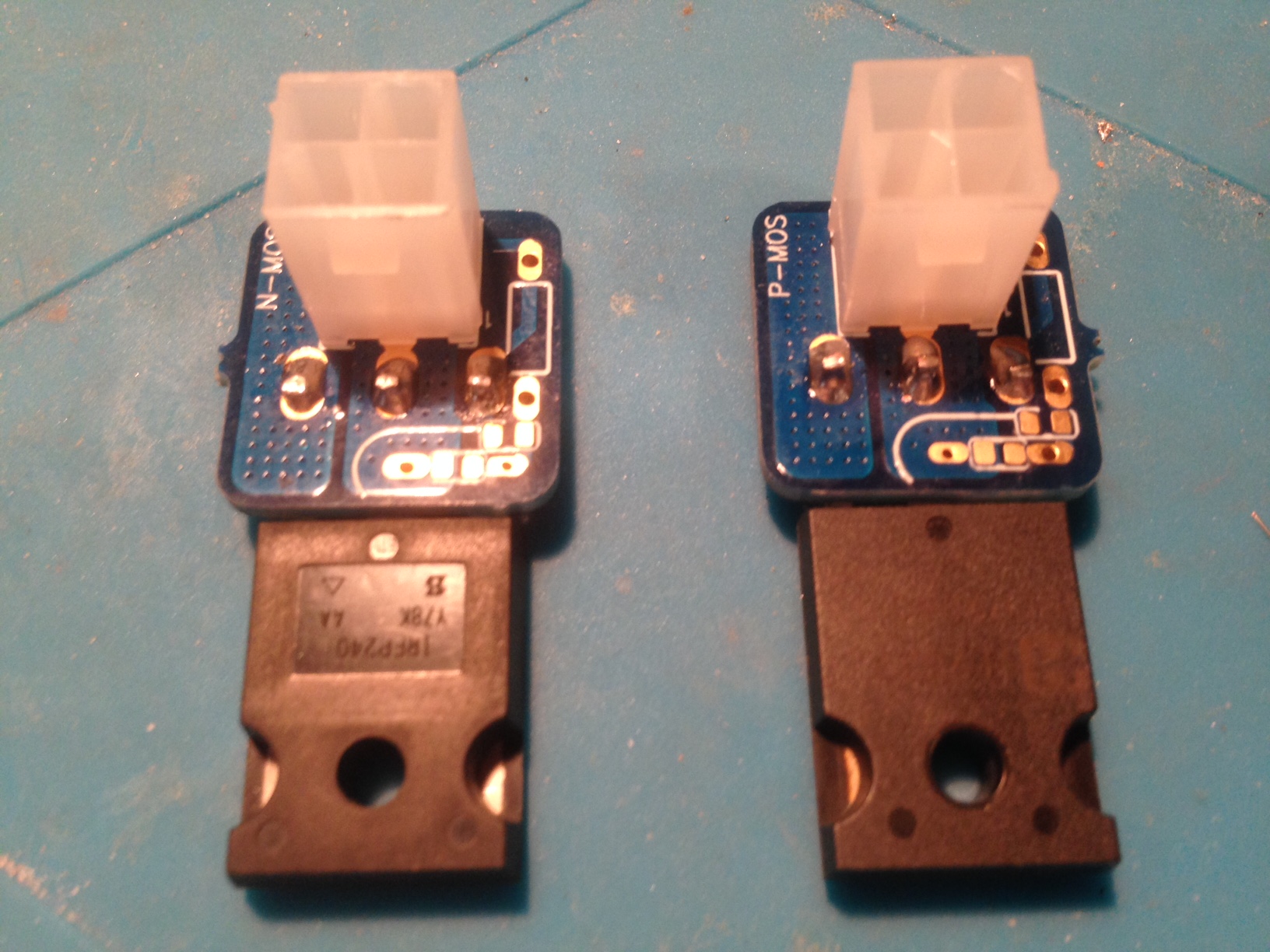

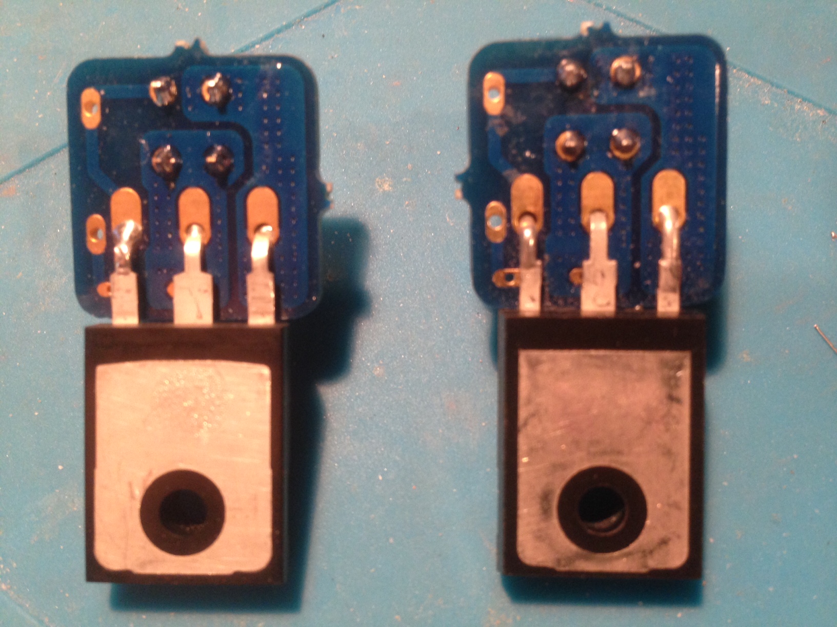

You can tell if the amp had thermal runaway by looking at the backside of the dead MOSFETs. Does it look like solder is oozing out of the metal to epoxy interface? Oscillation will look more like the MOSEFT bulges and wants to explode vs just melting.
Thermal runaway can also be caused by not tightening the heatsink mounting bolts securely enough and hence, heat is not removed effectively. So when you went to move your heatsink a little, it was enough to not let the MOSFET cool sufficiently and thermal meltdown occured within seconds. Try to screw the MOSFETs down with a good ceramic insulator pad and paste. If not use silicone spacer but screw it down securely.

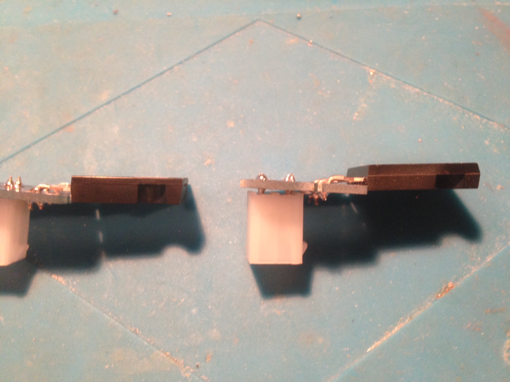

I have attached some pics of the Mfets, and they look good, no melting, bulging, just blown.

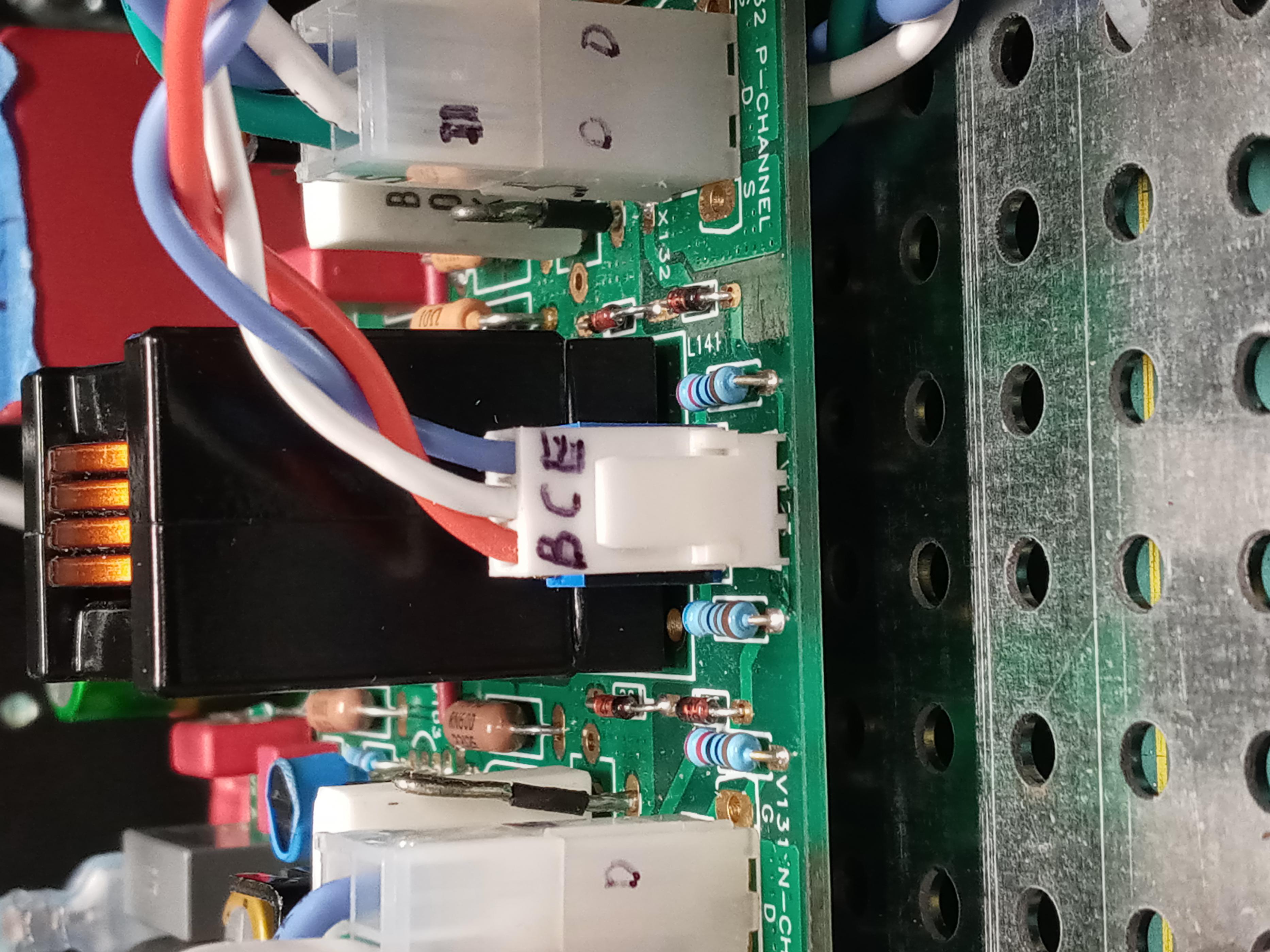

Hi X,
I am measuring at the red and black test points, just in front of the 0.22R resistors.
Is it common to have negative values for bias and output?
After the test, I was testing the Mfets, and 2 legs fell off the BD139 where it was mounted on the N channel MFet. This part may have been defective while testing, so I will replace and test again.

If your Bd139 had dodgy legs - that would explain why the bias current could not be adjusted, and possibly why your amp was not working earlier.
The positive and negative bias current depends on which resistor - but positive reading will result when current flows from positive to negative or from ground to negative rail with positive lead on the upper or higher voltage. The DC offset can go either way but should be under 20mV or less. Even 50mV is not a problem but I have found this amp to be very close to +/-5mV.
I suspect everything will work just fine once you replace the BD139 Vbe multiplier (temperature sensor).
