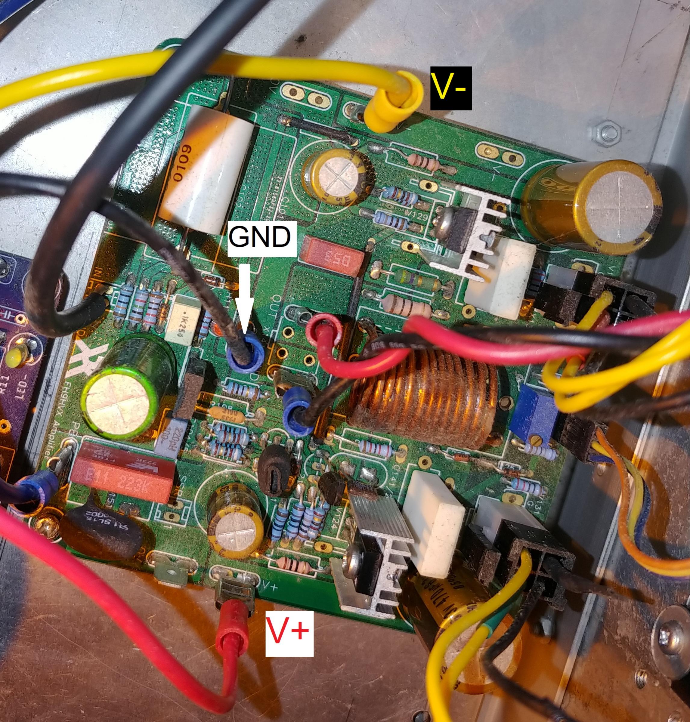

Hi X and others,
I powered up both channels and hooked up some speakers and received sound, but, the instruments were their and the vocals were recessed and faint in the back ground.
This is how I hooked it up:
PC > usb > iDecco. iDecco R & L preouts using rca with a/clips > FH9 input (one rca to in, one to AGND). Wired speakers with a/clips, Output GND to silver (-), Out to copper (+).
I then started thinking why have R & L preout to 1 channel, so I ran rca from Right preout to the IN on the input using a/clip, I then ran an a/clip from AGND on input to ground block. I just touched the a/clip to the speaker wire to complete the circuit, and received a bzzzt sound, so I knew this was wrong.
So I think I am close to jury rigging this to give proper sound, just need a few hints.
Would hate to blow something up at this stage.
Thanks,
Myles

Hi Myles,
I don’t know what you mean by A/clip?
Have you adjusted the speaker for the correct bias current without the 10ohm current limit safety resistors in place?
The current should be around 80mA to 120mA. If it’s too low you will get weak distorted sound.
The voltage across the test points should be 18mV to 26mV.

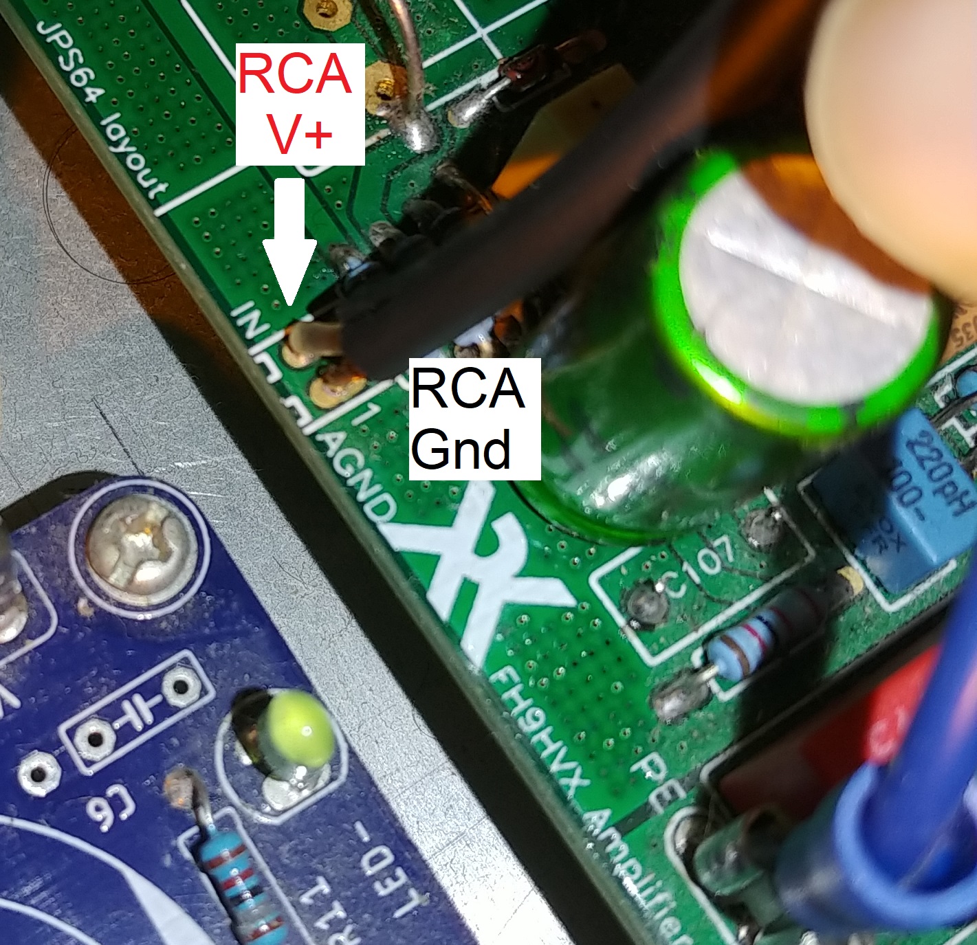

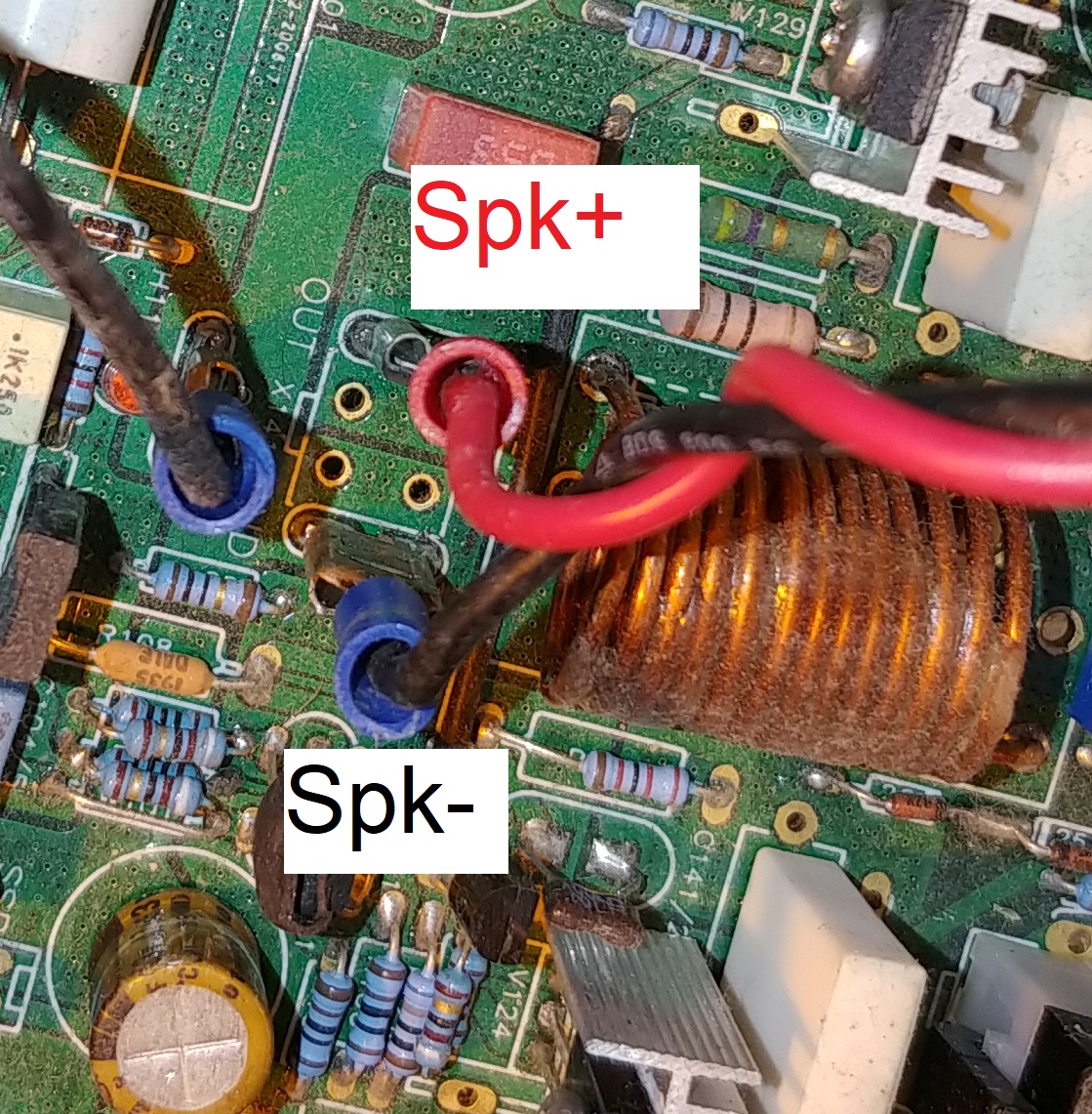

The RCA center connection should go to IN +ve. The RCA shield should go to GND pin. Speaker should connect Speaker out and GND. Try one channel at a time.
Draw us a connection diagram. It’s really quite simple. Audio in +/- , PSU in +/- and GND, speaker out + and GND.

MM,
Please find attached pics of the following connections to the PCB:
1. The V+, V-, Gnd Power connections
2. The + and Gnd speaker connections
3. The + (in) and Gnd connections for input (RCA)
Have you got then wired similarly?

X, Zman01,Vunce legis31,all others,
Houston we have lift off, Wahooooooooo 😀
My DefTech inwalls that I have put in an wooden frame have never sounded so good. The dynamics of this amp are really impressive, bass is great.
Thank you X for all the help you have given me on my first amp build. A few more things to do with power module, emi filter, soft start, ssr, and instant off module, but a great learning experience so far.
One question, is it normal for the bias to jump around a bit since everything is jury rigged for now. Wondering if bias will settle as the amp is played more and has the proper parts.

Myles,
Congratulations on getting the amp working!
After turning the amp on, the bias needs a some of time to stabilize. Maybe measure after an hour of running the amp and set the bias after that.
