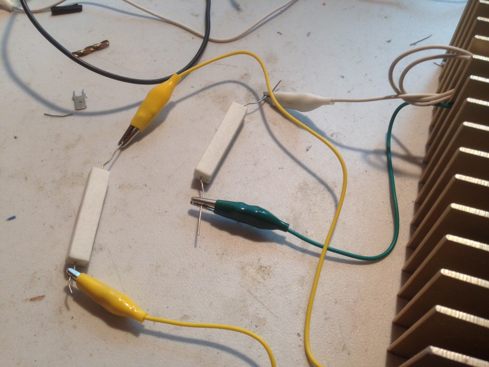

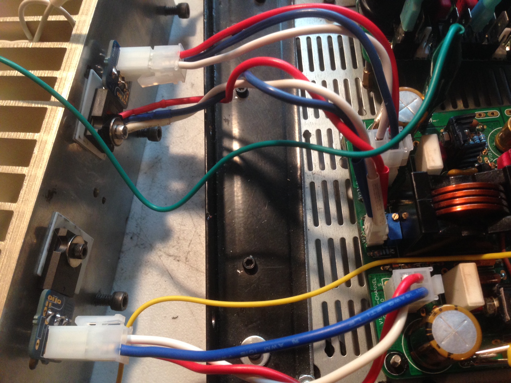

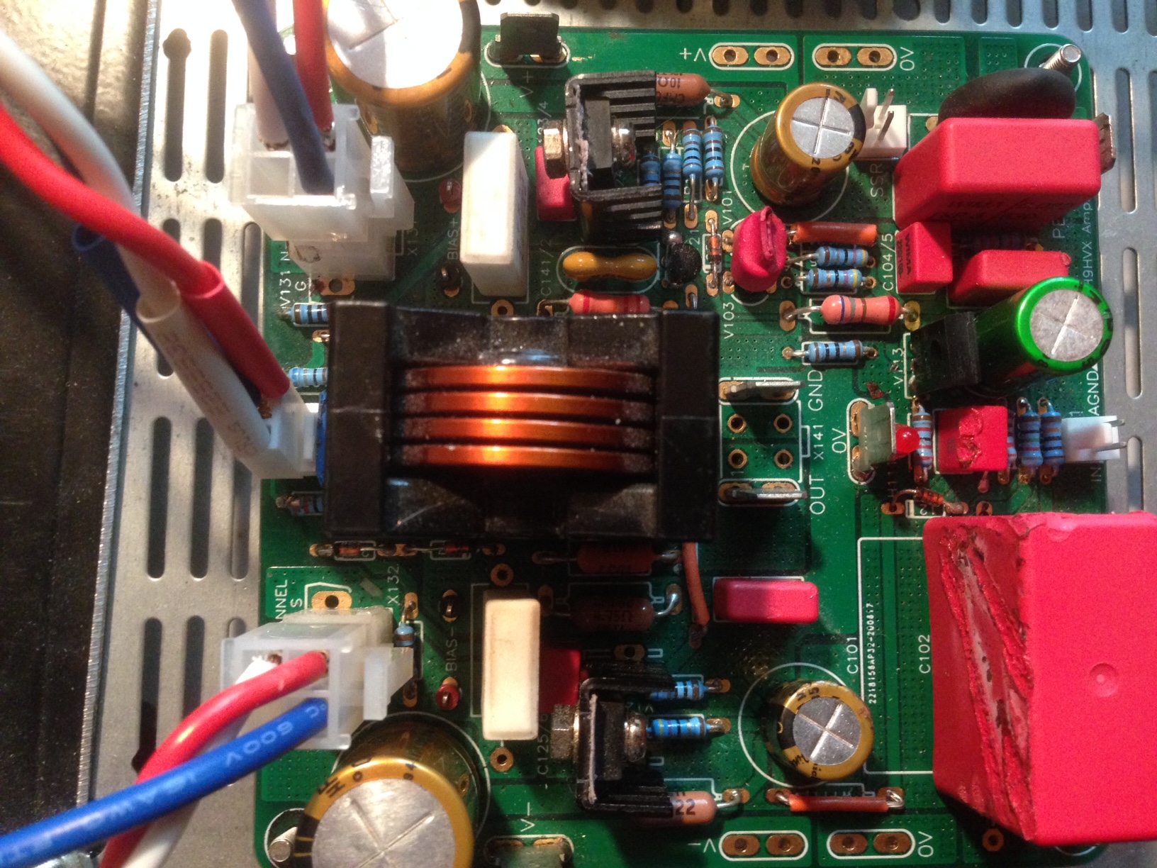

I have attached 3 pics: mfets on HS, mfets on boards, and 10W10R hook up with clips coming from the PS to the resistor and from resistor to the amp board.
Please have a look at the pics, and let me know if anything looks wrong.

Powered up for the 2nd time, and my bias readings and voltage out were all -DC readings. The bias before I shut it down (70VAC) was -380mV DC and Vout was 0.055V. The 10W 10ohm resistors between the PS and amp were hot. The trim resistor had no effect on the readings.
Changed out the resistors and powered up again. This time at 70V AC, I had Vout at -0.044V and bias was 266mV. The trim resistor seems to slip at the end of a turn, and has no effect clock wise or CCW. I must have got to aggressive with turning the screw.
I will change out the trim resistor. Any idea as to why I would be getting negative bias readings?

I think my GDS is Blue White Red on the helper board, which should match the GDS on the amp pcb. Could some one verify this for me from the pictures?

Hi Myles,
From what I can see, your photos show GDS on the main PCB as Blue / White / Red
and on the helper board you have GDS as Blue / White / Red. So that looks good.
Your temp sensor Vbe multiplier is White / Blue / Red and matches ECB on the actual unit.
So all this looks good.
Are you sure you have the correct KSA1381/KSC3503 installed in the correct places?
Finally, do you have the correct P-channel and N-channel MOSFETs in the correct places? P chan on left (IRF9240 etc) and N chan on right (IRFP240 etc).
Is LED H111 correctly oriented, does the LED light up? Cathode (flat) fces the 0V spade terminal.
