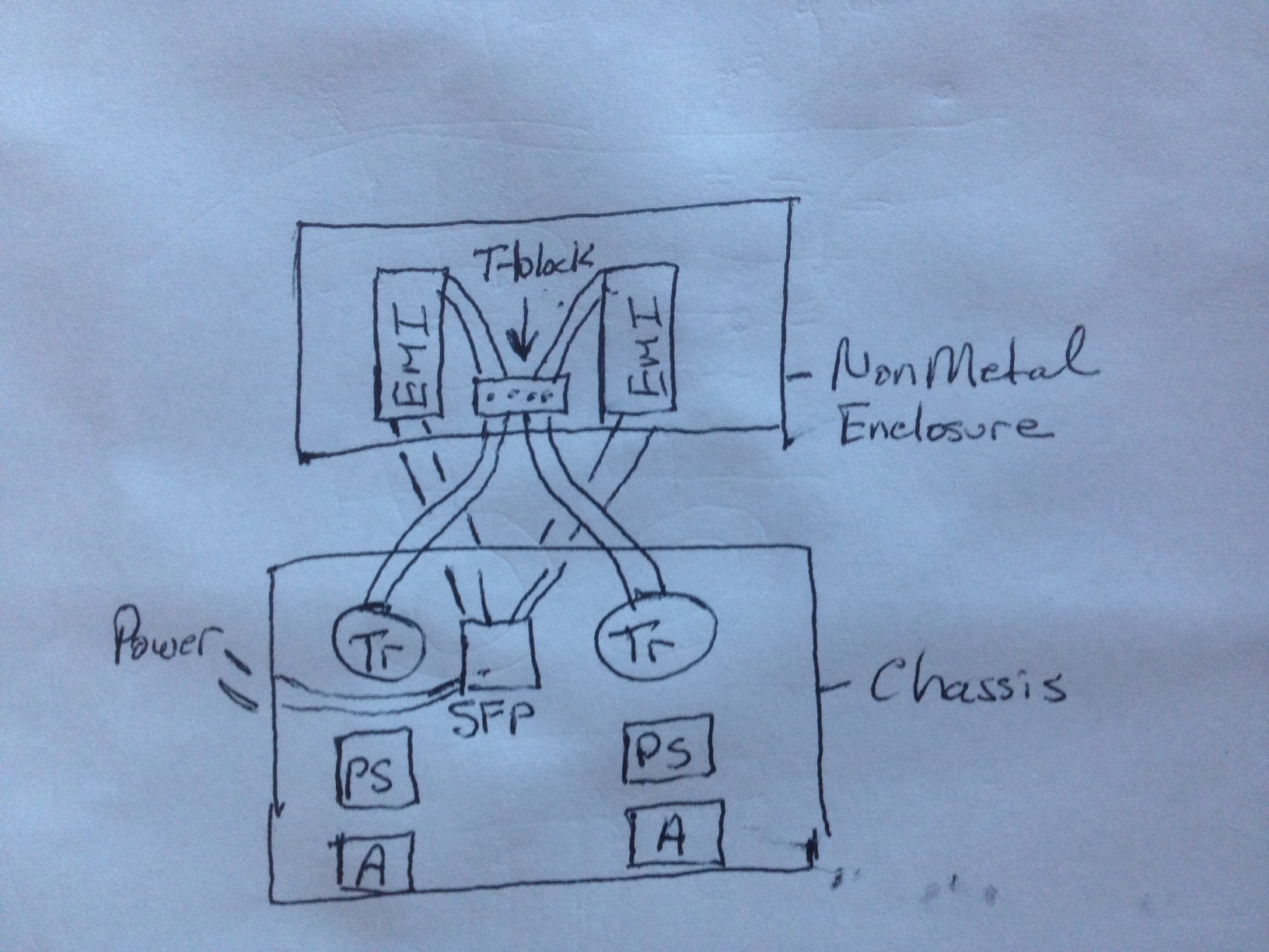

It is time to work on my enclosure, to mount peripheral components. I have a question relating to grounds again:
In my diagram below, the SFP will be mounted to chassis, so should not need ground wire to star post (Correct?). The 2 emi filters will be mounted to an "non-metal enclosure" and the outputs of the emi filters attach to the terminal block and then to the transformers.
Question: I should not have to ground the emi filters, due to connection to the SFP.

Hi Myles,
The SFP only deals with AC line and neutral return. There is no earth ground or protective ground connection on it. The standoffs are on isolated parts of the PCB. There is a ground for the remote control logic, but that’s not the same as a PE ground.
Why do you need external EMI filters? What are those filters? Usually the filters will be in same chassis as the PSU and metal case contains the EMI.

Thanks for the reply X,
Look at this : GB Round #8 Fo-Felix AC filter (Destroyer X). This is on page 2 of the GB's.
threads. Supposed to filter noise from the mains before transformers.

Your transformers are pretty hefty filters themselves. I suppose it doesn't hurt to have a common mode choke (CMC) as a filter - but that could also be done after the rectifier bridge.
So do you mean connecting the CMC between the PSU and the amp board ?. If so, with only Line and Neutral on the in/out of the CMC, how would I connect this?
MM
MM
Never mind - you would need either a balanced or two CMC’s. If the one on your FoFelix was made for single phase mains, that’s where you would use it.
