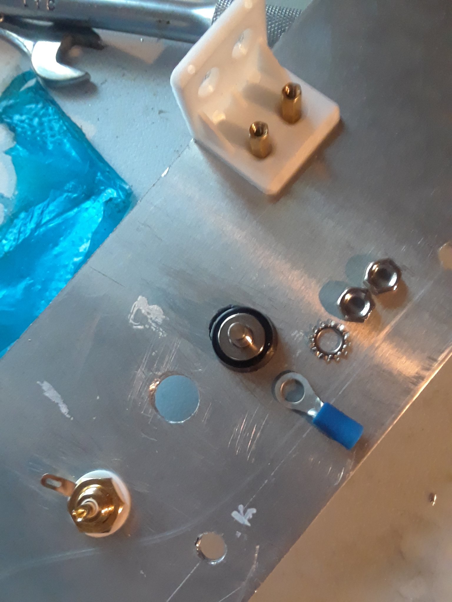

Back to building, and have a question about attaching output wires to a 5 way speaker binding post.
Plans are to remove insulation on the crimp eyelet and solder output wire to the eyelet. I will then slip the eyelet over the stud and secure it to the stud washer with the lock washer and the 2 nuts. Eyelet/wire connection will be insulated with shrink tube.
Reason for this: soldering a wire on the tip end of the stud means that I would not be able to unscrew the nuts in case of problem with binding posts.
If I cannot do this, please let me know another method.

That's how I would do it. Just curious, is there a reason your soldering the wire to the eyelet and not just crimping it? Either way should be fine. Just asking
@thirdicomplex Thanks for the reply. I have lot's of crimps in the build, just trying to eliminate possible loose wires where ever I can.
A proper crimp connection with crimp tool actually cold-welds the wire to the crimp ferrule and doesn’t make the wire solid with wicked up solder. That may reduce strain resistance. However, for an internal speaker binding post connection, soldering to the crimp connector is probably fine. Use 16ga high strand count silicone insulation “RC Drone” wire for the crucial PSU to amp and amp to binding post connects. This wire has superior amperage ratings vs standard wire. This can lower output impedance and improve bass authority.

Thanks for the info X, I have basic crimp pliers with the V or U shaped cup and the V shaped pin. One set of crimp pliers has 3 ranges for the guage of wire used, so may resort to crimping rather than soldering.
