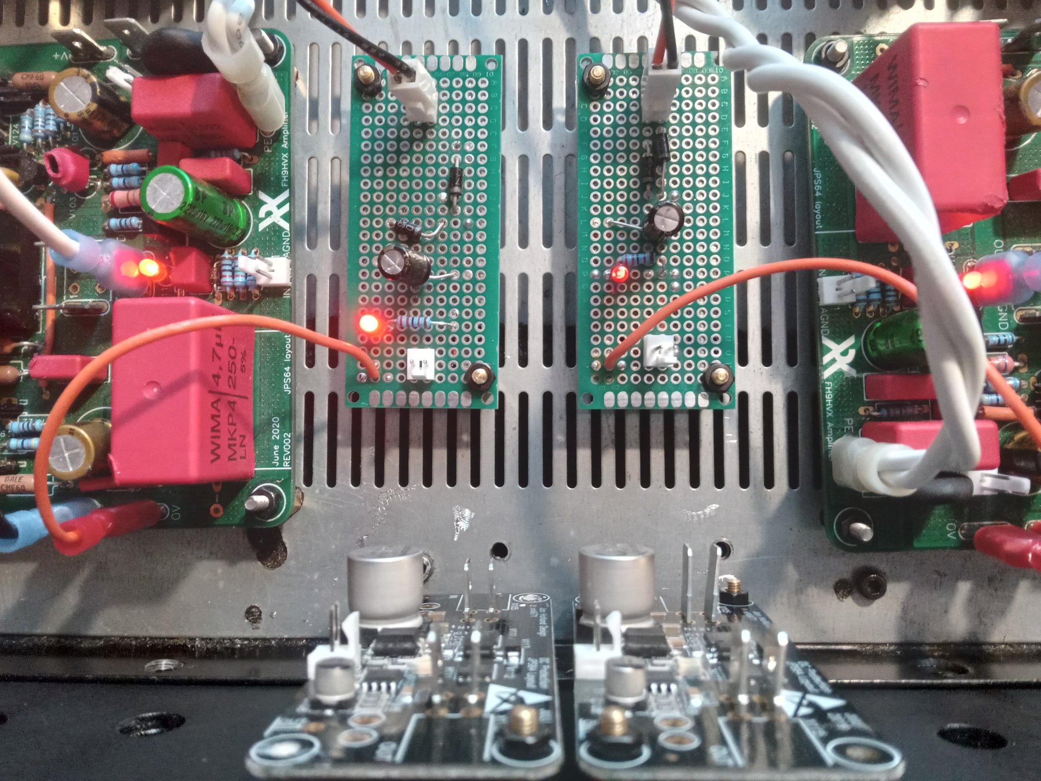

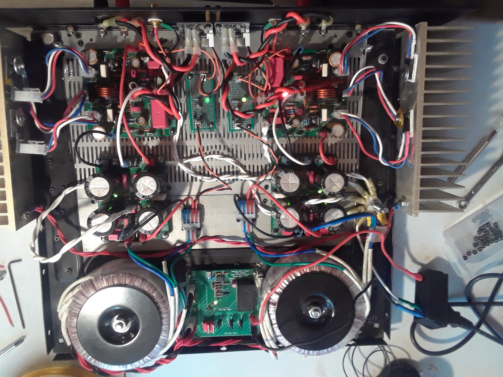

I hooked up the instant off modules (IOM) in preparation to wiring them up to the RTRSSR modules. AC was checked entering the IOM's and decided to check the voltage and polarities on the molex outputs. I got the polarities and the voltage was 0 Volts on both boards. Is this normal, or have I wired the modules wrong 😡 .
Thanks for the help, see pic attached.
MM

I thought I had er built this time. I powered up with a variac & dim bulb tester (100W bulb). With everything hooked up I watched in wonderment as all the led's lit up from the soft start, the psu the amp boards, the low capacitance psu, and the RTR SSR modules, no magic smoke. Dim bulb teaster showed only a faint glow at V> 100V. Pic below
I had checked the bias earlier, so I hooked up a couple of speakers and I received glorious sound, but only from one channel. I started visually checking things on the problem non channel, but everything looked good. The bias is good on the channel with no sound. I tried the following :
I swapped out speaker, no difference. Swapped speaker wires, no sound from problem channel.
I unhooked the low cap psu which turned off the RTR SSR modules on the problem channel, and ran wire to the speakers from the amplifier, still no sound from problem channel.
Tomorrow, I will try to swap the inputs.
Any other trouble shooting techniques I can try ?

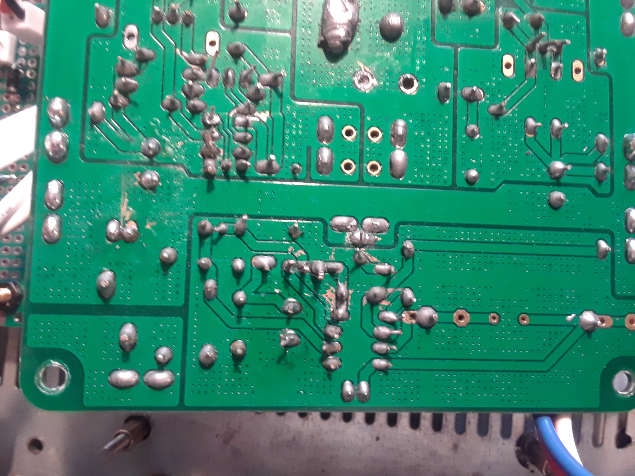

I have attached a pic of the underside of the amp board. The molex tab is solidly attached. Surrounding soldering looks good also. Is it possible to have a bad pin in these molex components?

Looking at the PCB there seems to be several areas where the solder mask has been scraped off or damaged, look at these areas and check for solder bridges. Use eye magnification, and clean the flux off so you get a better look. Cleaning the flux will also show you areas where you need to retouch with the solder iron. (Cold joints)

Please check red circle areas for solder bridge. Use continuity check between the two adjacent pins. Touch up with soldering iron and flux. It appears your iron may be under powered as the fillets are not smooth and wetted. I use a 70w iron with a big fat chisel tip. Real Pb solder with rosin core.

I spent some hours on the weekend reflowing solder joints and cleaning up the board on the channel that is not working. I checked continuity all over the board, and it checks out really well. So I fixed up my wiring on the BD139G transistor and put it back together:
I did not receive any sound from the speaker, but I did receive a hum from the speaker using the finger test.

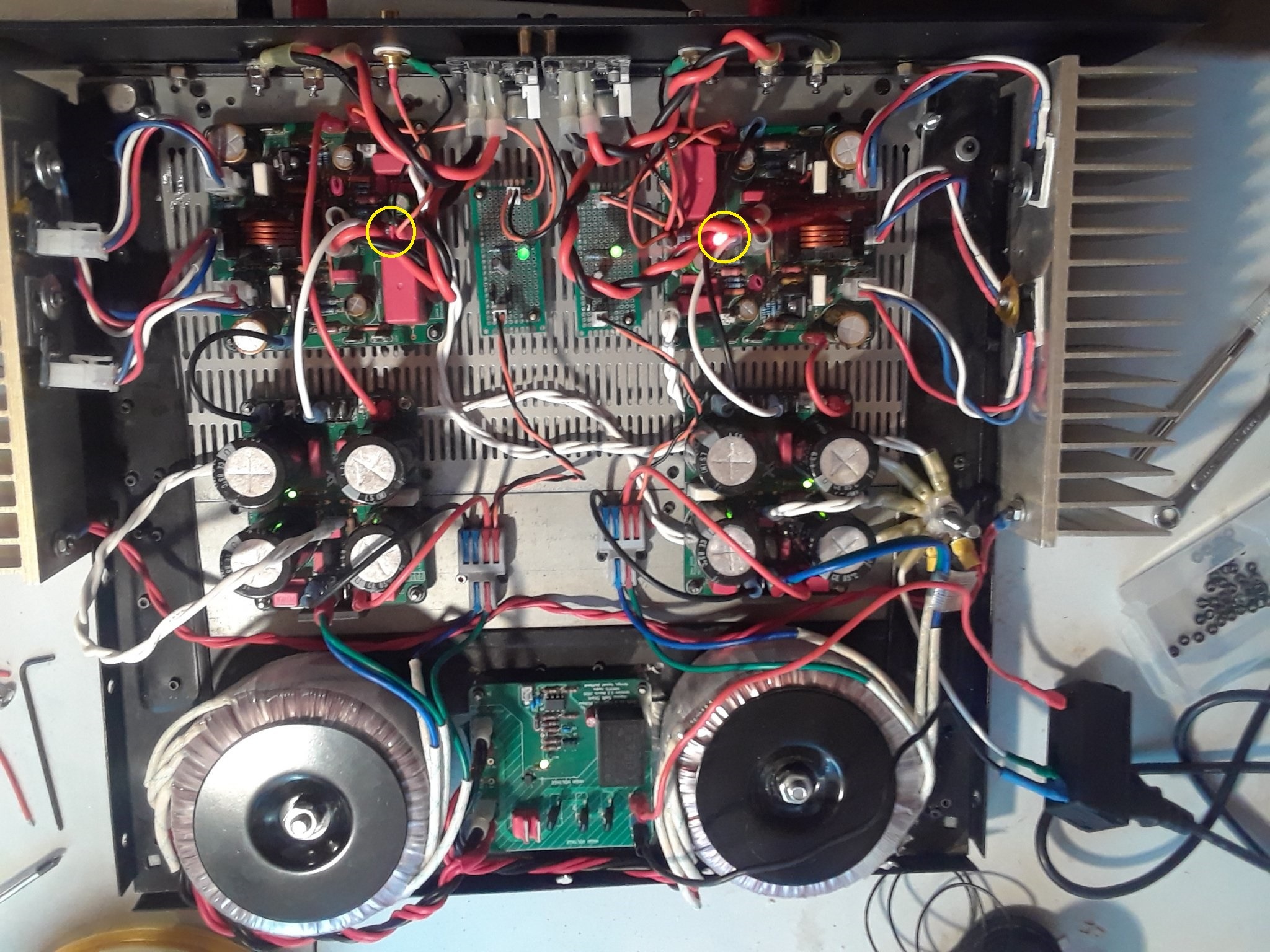

I had to hard solder the BD139 to the board. To gain access to the bottom of the board for photo's, I will have to unbolt the BD139 from the NMFet. I will do this if your suggestions from post #1037 do not work. I will let you know tomorrow what happens.

X,
1. Connected input from the working channel to the non working channel and music played from the correct speaker. This is good. Shows no problem with molex connector.
2.Connected the input from the non working channel to the working channel and received no sound. When I disconnect the gnd wire from this test I receive hum, attach again and no sound.
3. Checked continuity from rca to wiring harness on the non working channel. Continuity on both + and gnd wire from rca input to end of molex harness.
4. Checked continuity from rca input to molex pins. Continuity on gnd from rca to molex gnd pin. No continuity from rca + pole to molex + pin
So #1 points toward no problem with molex connector on non working channel and suspect input wiring.
#2 points toward to suspect input wiring.
#3 points toward no problem with input wiring to end of molex harness.
#4 point towards bad molex connector on + side.
Maybe the suspect wiring is influencing points #3 and #4 and need to be corrected. I am inclined to agree with point #1
