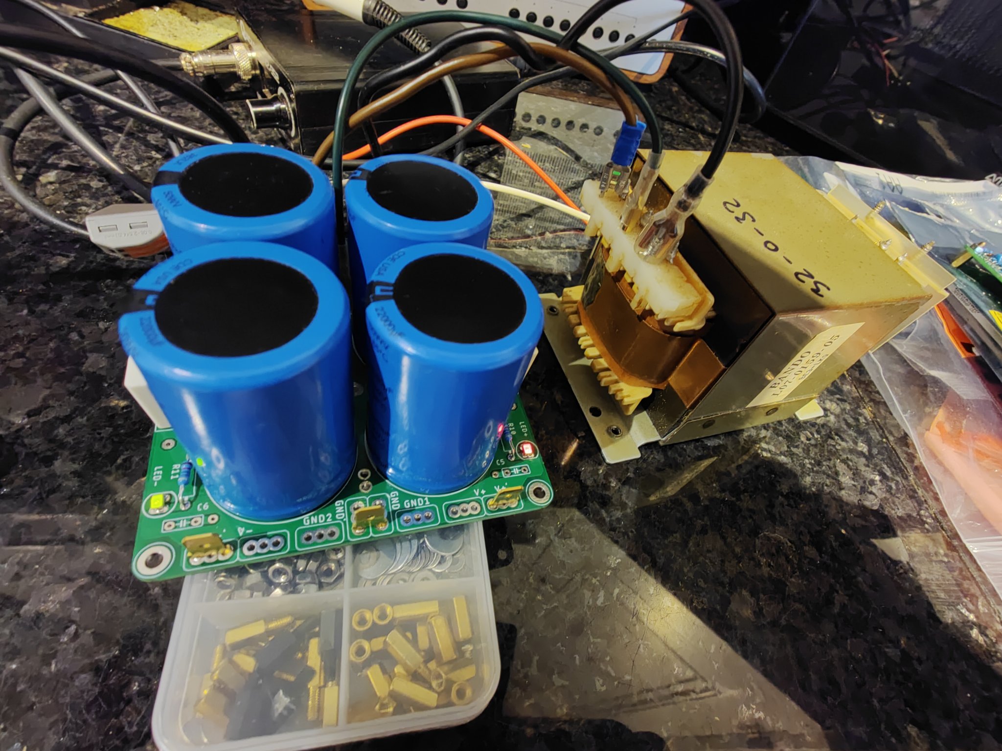

Built a PSU today using an old trafo from a Kenwood integrated amp of the 90's. 32vac CT. I don't know it's power capability and don't have the correct resistors to load it with at the moment. It is fairly heavy thing.
Gives me 43vdc unloaded through a 22mf/0.22R/22mf per rail. This to be shared over the stereo board.

This looks like a fine PSU you are making. +/-43v is probably good enough for 80w. Plenty of power for most speakers.

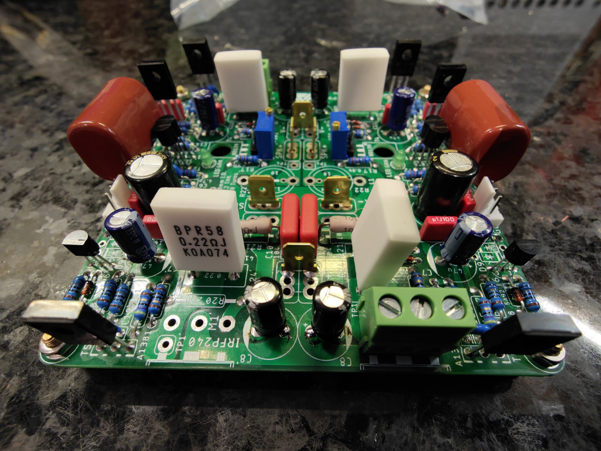

Finishing my board and decided I'd mount the main transistors remotely. Started to fit 3 term connection. I needed to move a couple of the 220r into the irfp stations . I measured them for some reason and I have 47r in there. Did a quick search to see if I'd followed some protocol but couldn't find anything. have I just made a mistake there ?
