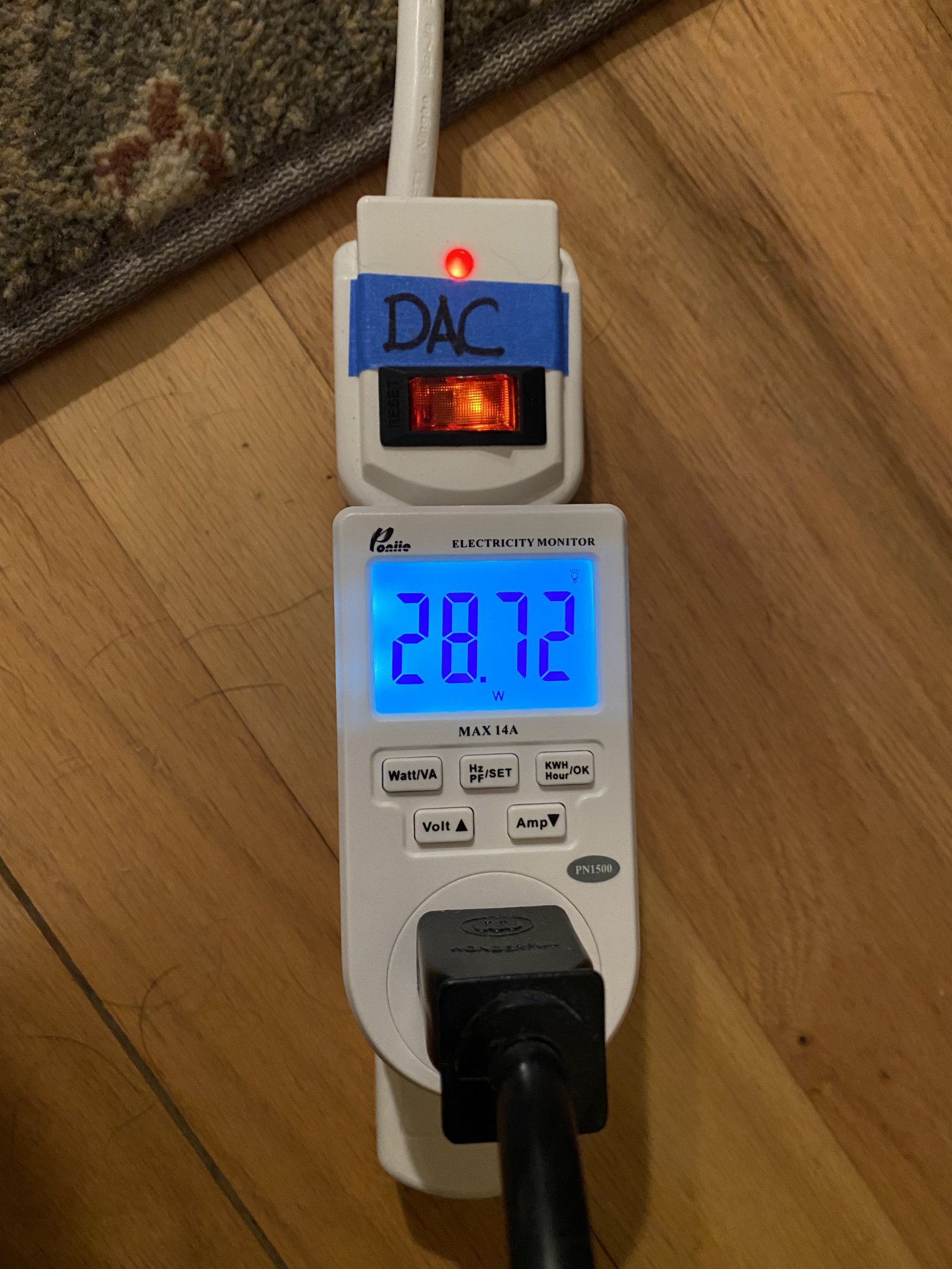

I am actually using my FH9HVX for TV audio right now. It’s using less than 29W from the wall. I don’t know how much more efficient you can get than that for a Class AB with potential for 100W@8ohm??
I think “scaling down” psu requirements is more appropriate for class A amps that run full throttle all the time.

Thank you, Vunce! This is very helpful, and point well taken. A touch under 29 watts is pretty solid, indeed! Was this taken while playing music, or at idle?

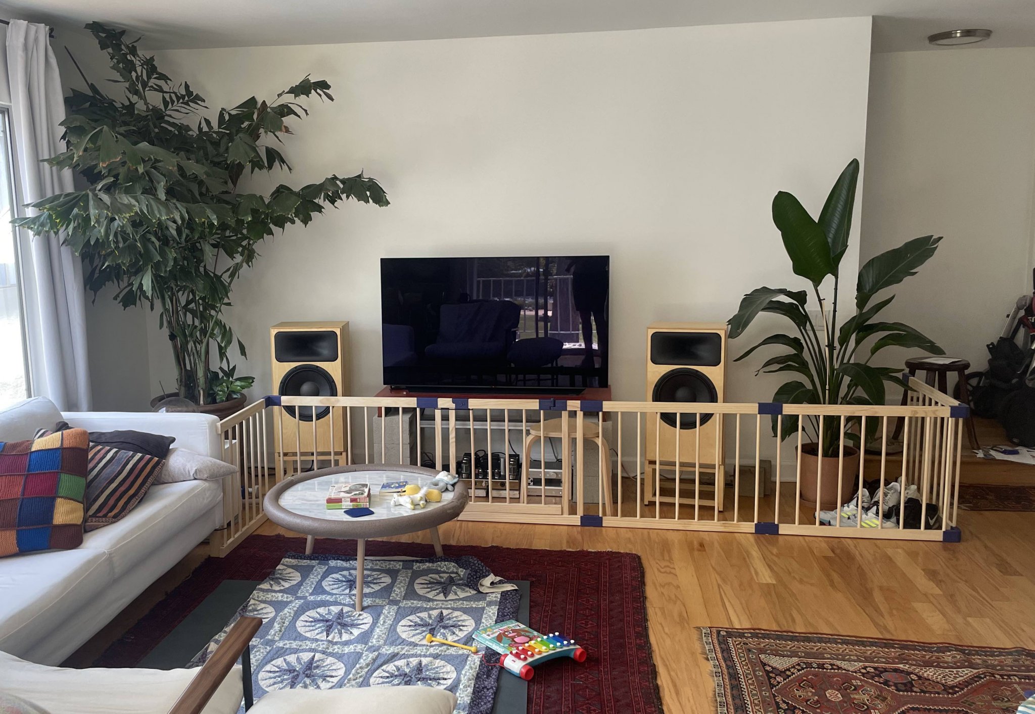

I hear great things about the ACA. Looking at building an ACA mini myself - push pull for a little more efficiency in Class A. Only issue is the heat, live voltage on the heatsinks, and my 10 month old. Current solution is "holding," but...
Great Setup! I’d say you have a few months before the “fence” becomes a guardrail for a walking toddler, LOL!!
The FH9HVX was playing at low/moderate volume driving 90dB 8ohm speakers during the meter reading in the above picture.

Ha! Thanks, Vunce! Yes, I expect the "fence" will need some buttressing in the coming months. A whole new level of DIY - protecting your other projects!

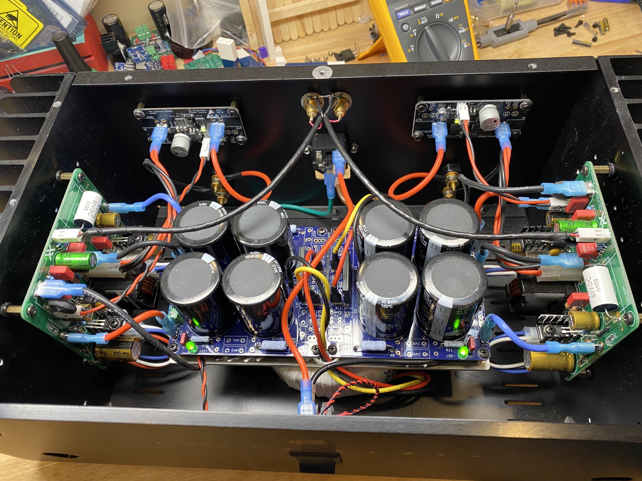

Topless FH9HVX!
Single 500va trafo with dual 32v-0-32v center tapped secondaries. Each channel gets its own Compact CRC psu board that was designed by DIYA member Prasi. Mine are set up for straight CC operation, jumpers were installed in the R positions. This combo yields +/-42V rails and bias current is set to 160mA. Heatsinks are barely warm after all day/night operation, perfect summer amp 🙂
Thanks Jim! These psu boards enabled the use of this center tapped trafo for essentially a dual mono power supply in a very compact chassis.
VERY nice, Vunce. Kudos. What is that compact chassis from? You have some great finds for donor chassis.
Vunce, your FH9 is a BRICK! Compact, dense, and cool - especially with the heatsinks having a slight curvature a la Hafler DH-220. Thank you for taking the time to investigate the PS and share a photo. VERY helpful!
I assume Prasi's CRC PS boards are smaller than the All Cee's, and it also looks like you have 60,000uf per channel in your dual PS arrangement, if I'm reading correctly? I'll save you from the wide eyes emoji, but that's pretty wicked. Is the plate between the trafo and PS boards purely for structure, or to also mitigate magnetism issues?
I am considering using a Dynaco stereo120 chassis as the base for my build (already own) - with a pair of "really big heatsinks." Maybe I can get sneaky and integrate 2 PS boards as well. I also noticed XRK did a point-to-point PS capacitor arrangement for his Griddle Amp not dissimilar to the old Dynaco's. Has anyone attempted, or have references/links to, building something like this for all caps? (You can also tell me it's too much work and not worth my time. Ha)
